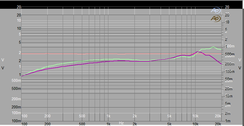

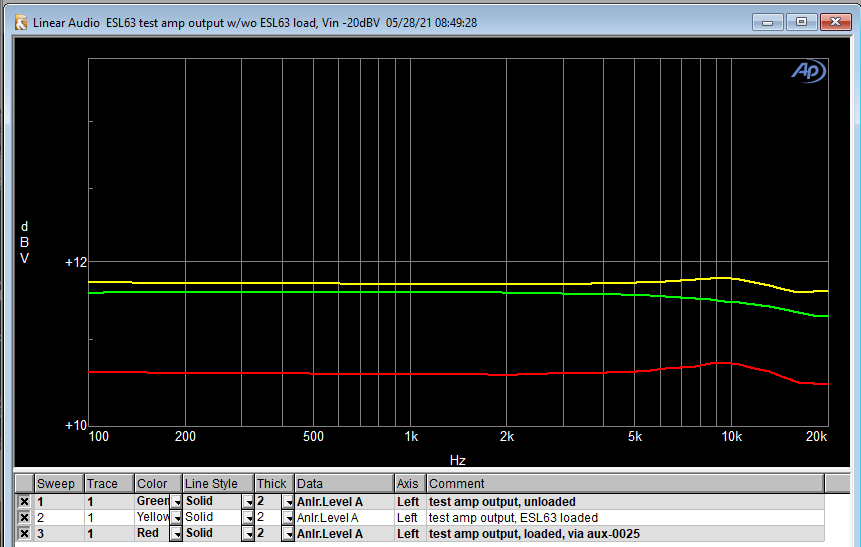

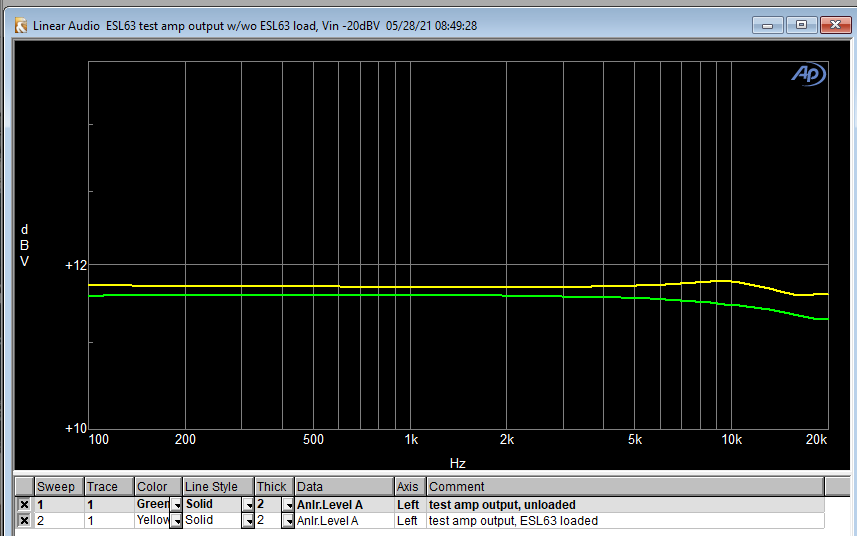

@Hans: I did a quick check on the test amp, looking at it's output response while loaded with the ESL63.
So the effect you mentioned (dropping drive voltage at high frequency) is there, but it is much less in magnitude than what I see at the secondary of the xformer. Interestingly, with load, the amp output is about 0.1dB higher in the lower band, 0.2dB at higher freqs. Weird.

Small addition: I realized that the power amp being class D might upset the AP, so I ran it again through AP's purpose-designed AUX-0025 class D measurement filter.
It does change the level by about a dB, but not the response shape.

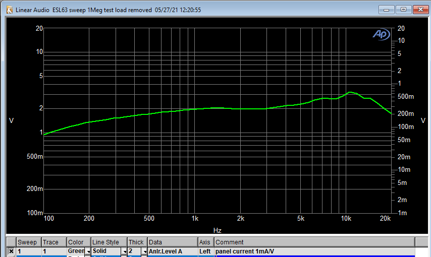

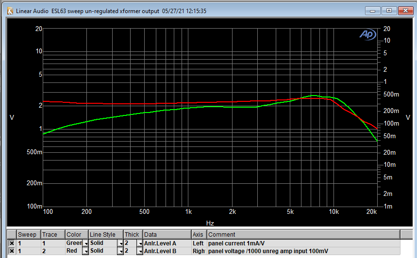

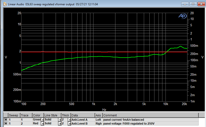

Hi Jan,
Well, when it's not the amp, there must be another reason for the 19dB drop at 20Khz.
The 1Meg load places a significant load on your secondary as can be seen in your first and second recording below.
With 1M load, current drops 12dB from 2.8m@8Khz to 0.7m@20Khz, while without this load current drops 3.8dB from 2.8m@8Khz to 1.8m@20Khz.
So when you tried to regulate the secondary voltage to a constant level by measuring at your 1Meg/1K divider in the third image, you get wrong results of ca 12dB-3.8dB= 8.2dB@20Khz changing your current curve quite a bit.
When projecting the recording without 1Meg on top of the recording with a "constant" 250Volt, correcting the just calculated 8.2dB error will change the the currents at 20Khz to land exactly on top of each other.

Hans, I understand what you are saying, but you assume that the secondary voltage remains the same with or without the 1M/1k divider. That I do not know, especially not at the high frequencies.
Also, I agree that the 20kHz currents become the same in magnitude, the curve is still quite different I think.

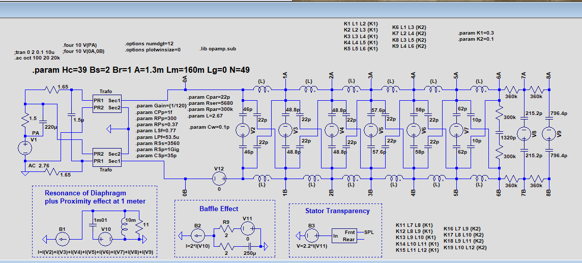

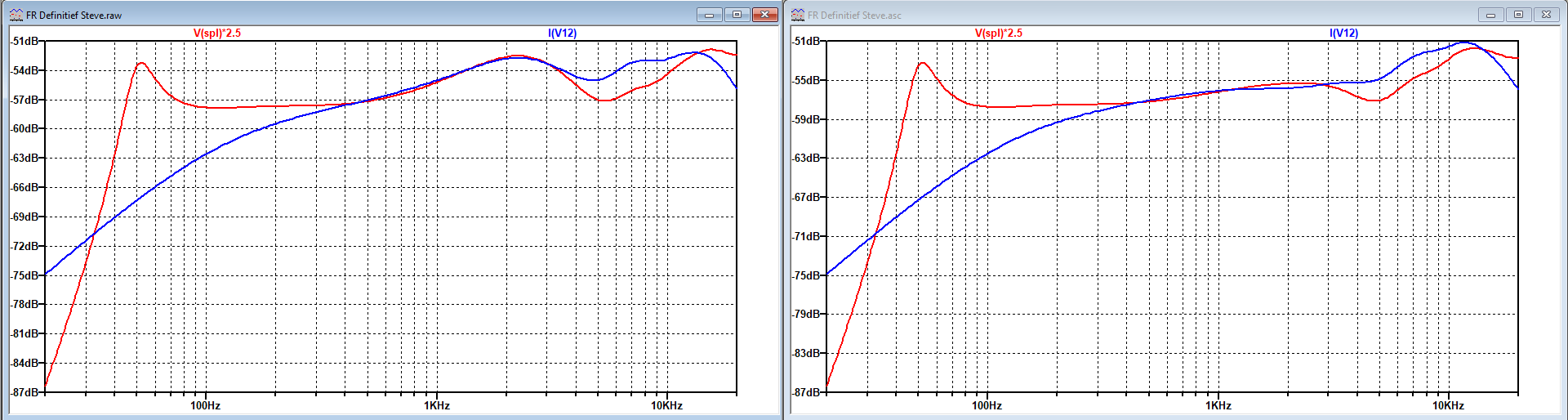

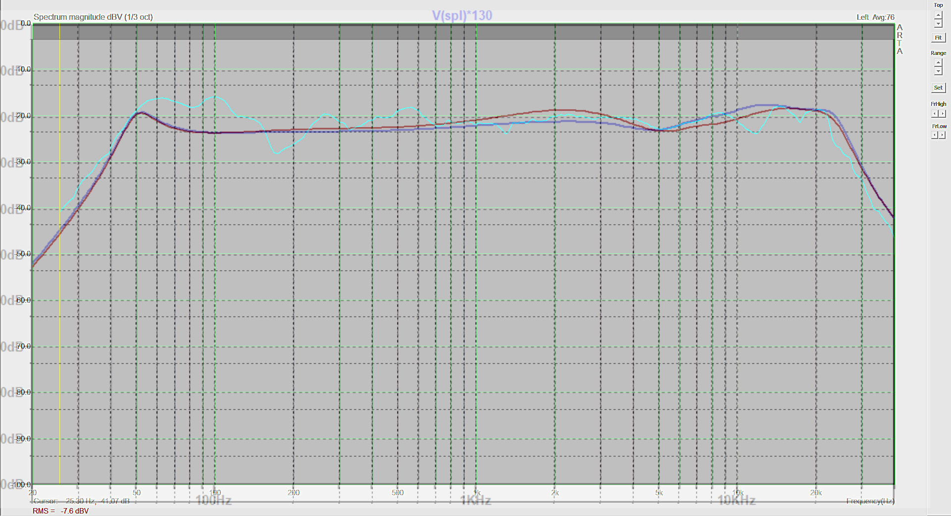

Here is the version when cross-coupling the inductors with K=0.3 for the adjacent and K=0.1 for those one place further.
I didn't have the time to further experiment with these two factors, but the model is attached for further experimenting.
The first image shows at the left resp. in blue the transformer current and in red the SPL output in front of the speaker without these inductor couplings, and at the right with the mentioned couplings.
It has definitely a positive effect on the FR between 5Khz & 8Khz.
Hans
Hans

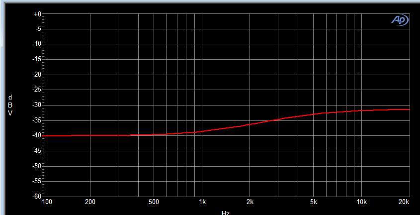

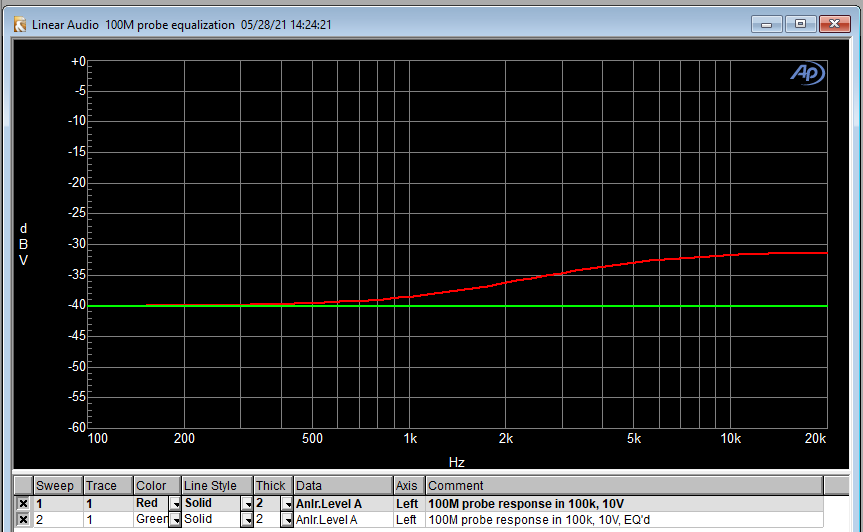

I tried another way to measure the high voltage. Connected a 1:100 probe, 100Mohm, to the AP input set to 100k (cannot be higher). Input is 20dBV.
At low frequencies it is very accurate at 60dB attenuation, but increases at higher frequencies. I will have to learn how to turn this into an EQ file and apply it to the measurements to correct them.
And so it goes ;-) .
