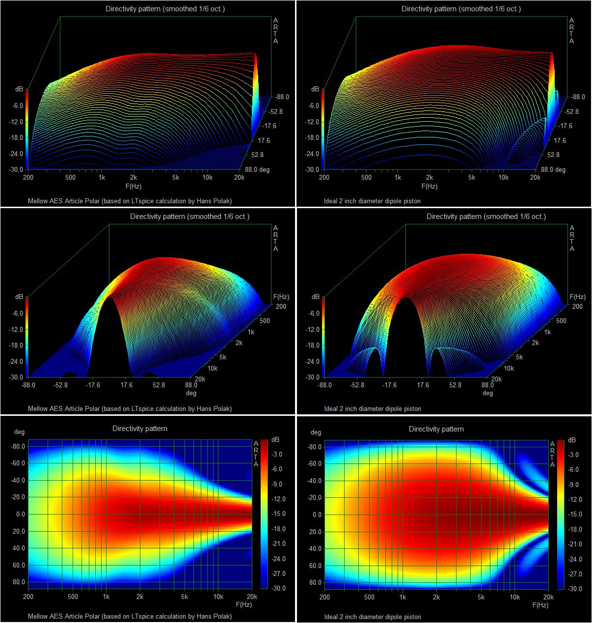

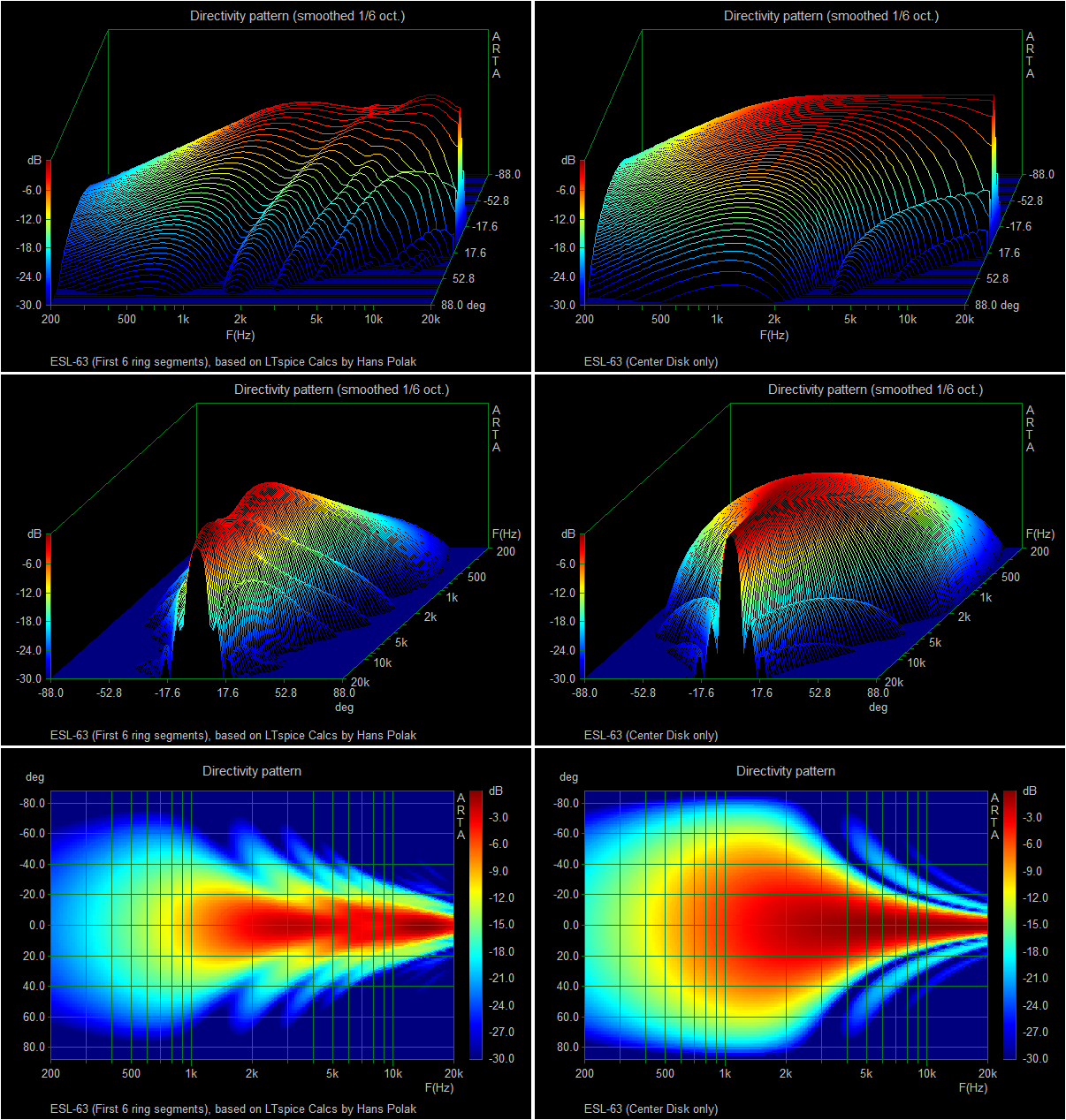

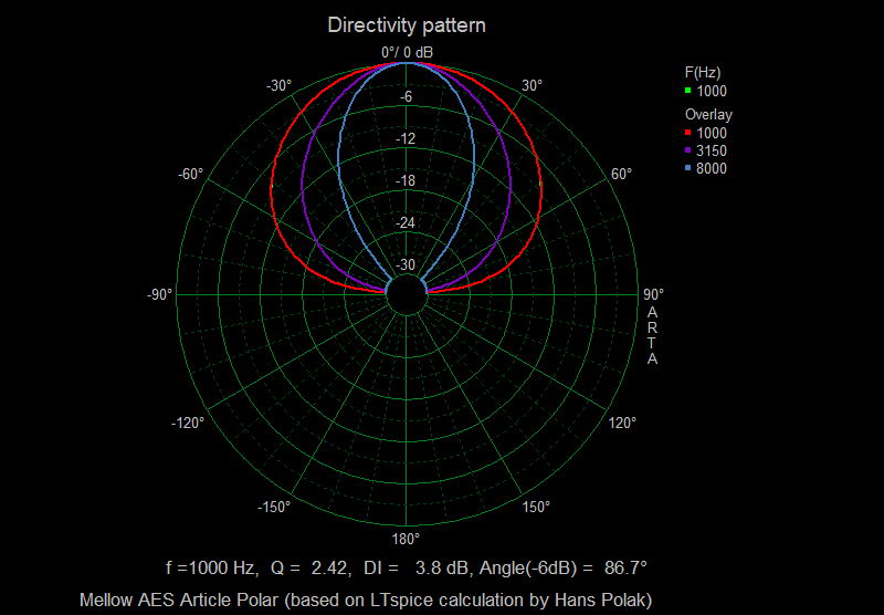

For grins, I took the currents from you model and applied them to rings to calculate the polar response.
Attachment #1: This is the traditional polar plot which matches Figure 13 from the AES paper.
Attachment #2: The polar response for the Hans’ FrontRo model is shown in the 3 plots on the left side.
For comparison, the polar response for an ideal 2 inch diameter piston is shown on the right side.
Attachment #3: Because I know somebody would ask The polar response for the first 6 rings of Hans’ ESL-63 model is shown in the 3 plots on the left side. For comparison, the polar response for just the center disk of the ESL-63 is shown on the right side. This basically tells us that the directivity of the whole ring system at high frequency is not that much different from that of just the inner disk, but it can play 15dB louder.

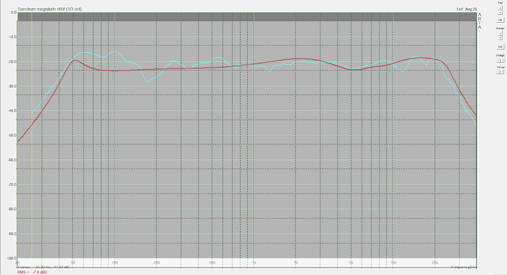

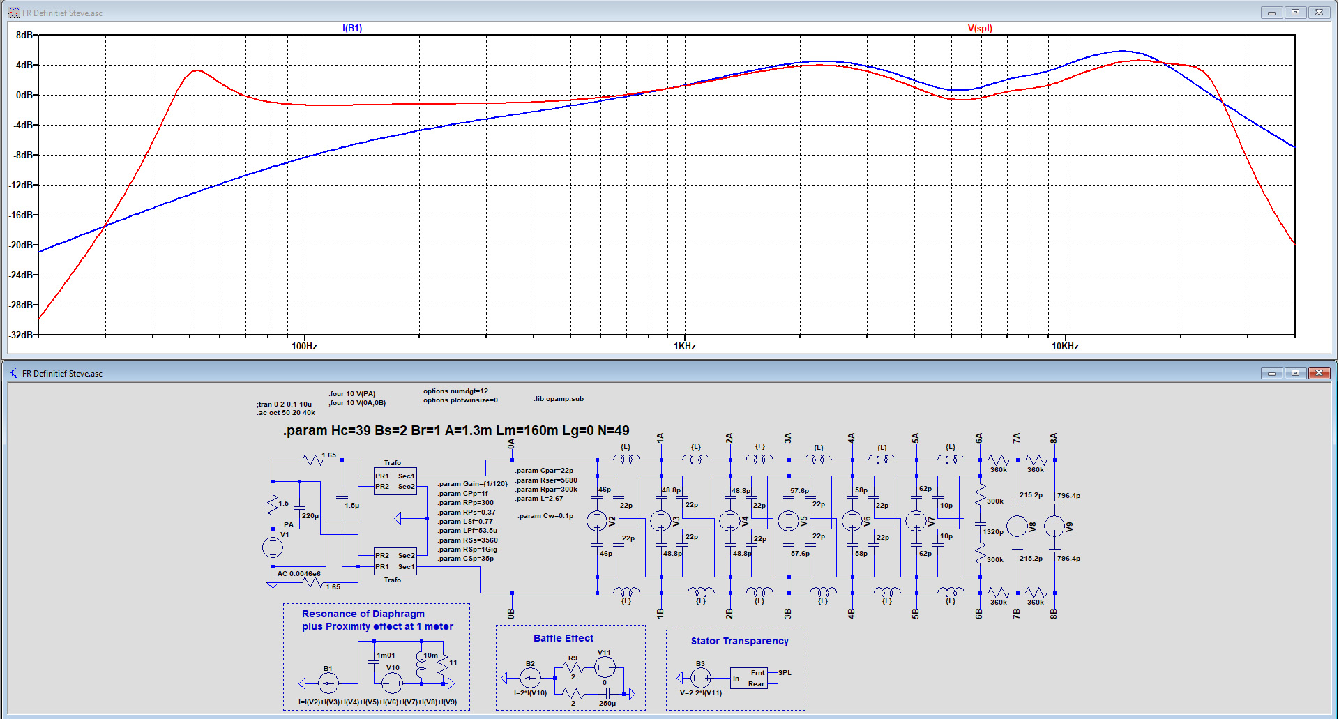

With Steve Bolser's and Demian's fantastic support, I could bring my LTSpice model to an end.
After having added all currents, currents that are directly proportional to the produced SPL, I added all the necessary acoustic corrections.
First image below shows in blue the sum of all currents and the red curve shows the end result after having applied the various corrections, such as:
Membrane resonance at 50Hz, Proximity effect a 1 m distance, Baffle effect and stator transparency.
Second image shows an acoustic recording with om the top the final result from LTSpice.
Be aware that all this applies only to the on axis response.
Hans

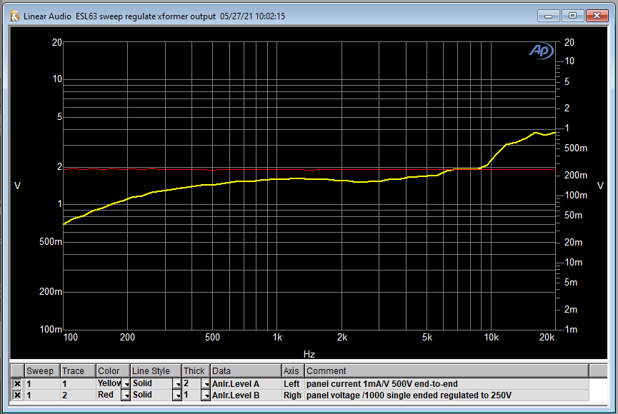

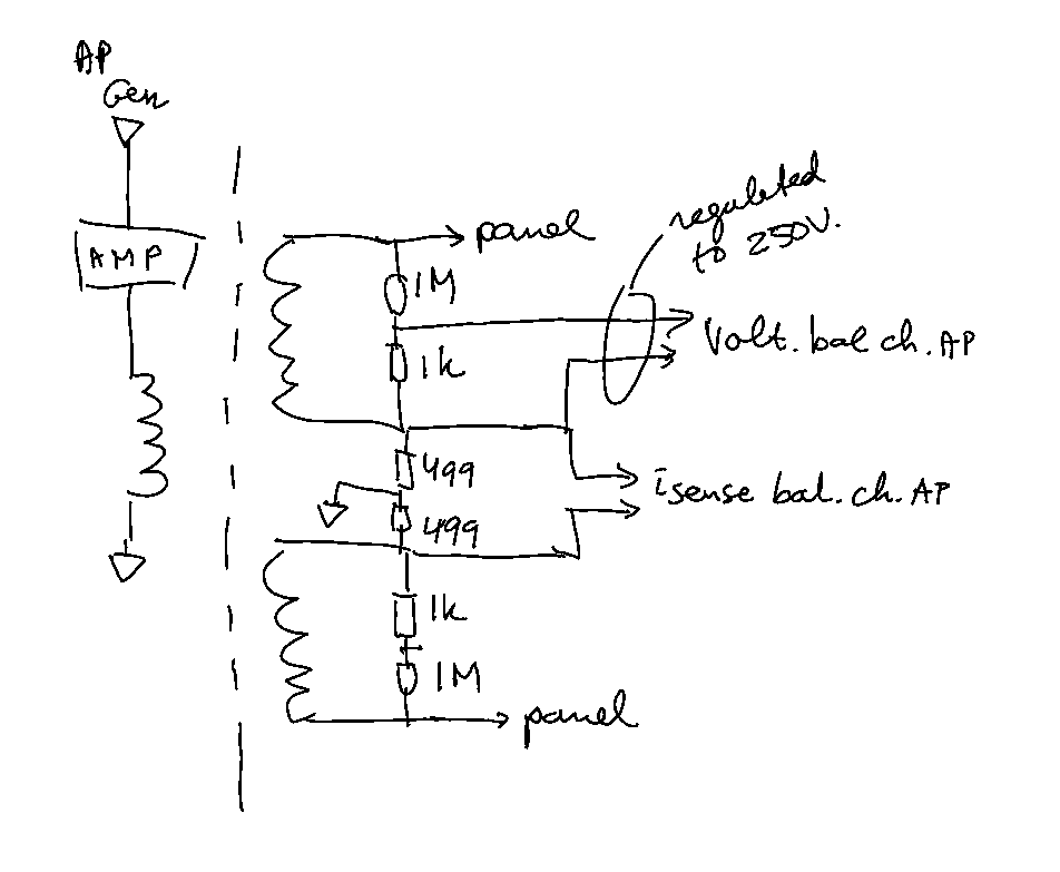

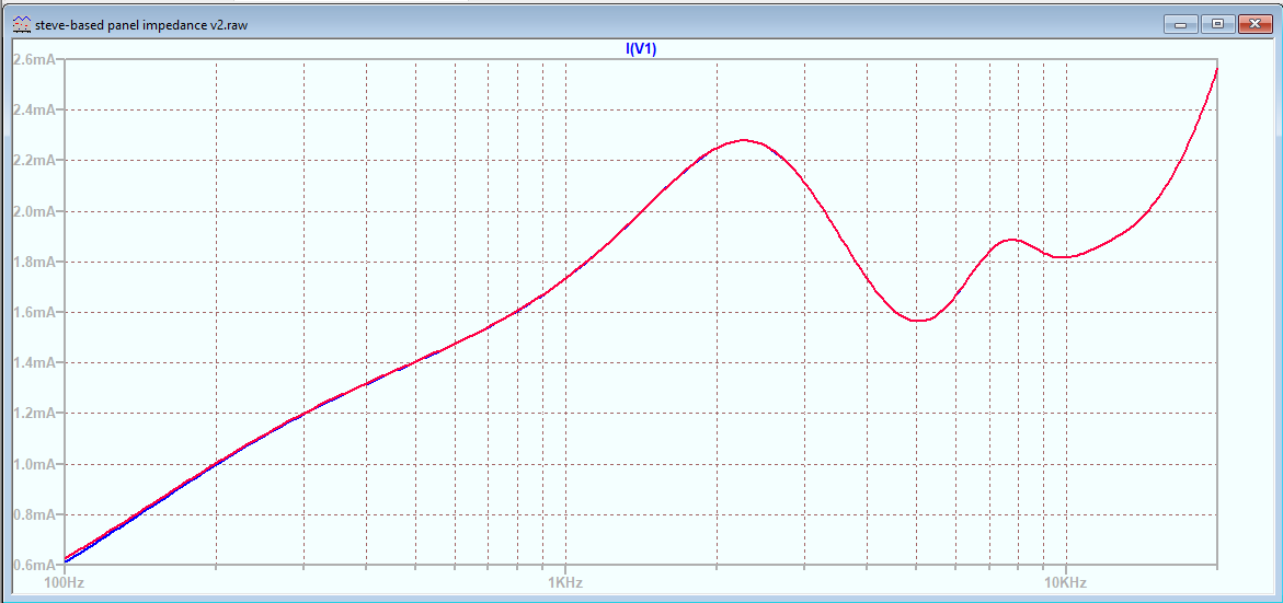

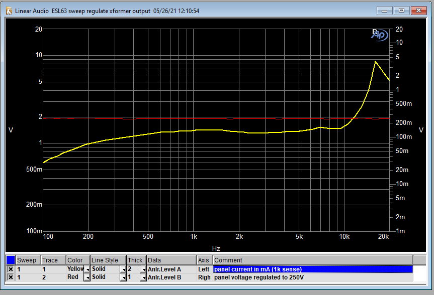

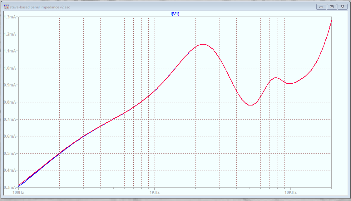

I wanted to know the actual panel current which would have to be provided by a direct drive amp, so I decided to try to measure it on one of my spare ESLs.

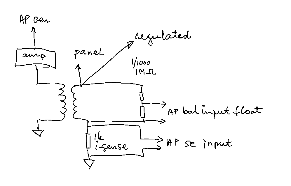

The first attachment shows the test setup. I drive the speaker (one channel) from the AP generator, through a power amp. I feed a sample of the hv transformer output to one channel of the AP and use the 'regulate' option to make sure that the xformer output voltage remains constant with frequency, here I regulate to 250V.
I have a 1k current sense resistor in the ground leg of the secondary and measure the voltage representing xformer current into the panel.
The 2nd attachment shows the measured current, and the 3rd shows the current as 'measured' by the simulation of the latest panel model as the 4th attachment. What you see is a large discrepancy between measurement and simulation. So first question: is my measurement setup kosher?
Jan
Jan
In your drawing, you don't specifically show what you have done with the other panel connection. Is it still connected to the output of the other step-up transformer? or have you moved it to ground for the measurement. From your measurement results, I would guess it is still connected to the other output transformer.... is my measurement setup kosher?

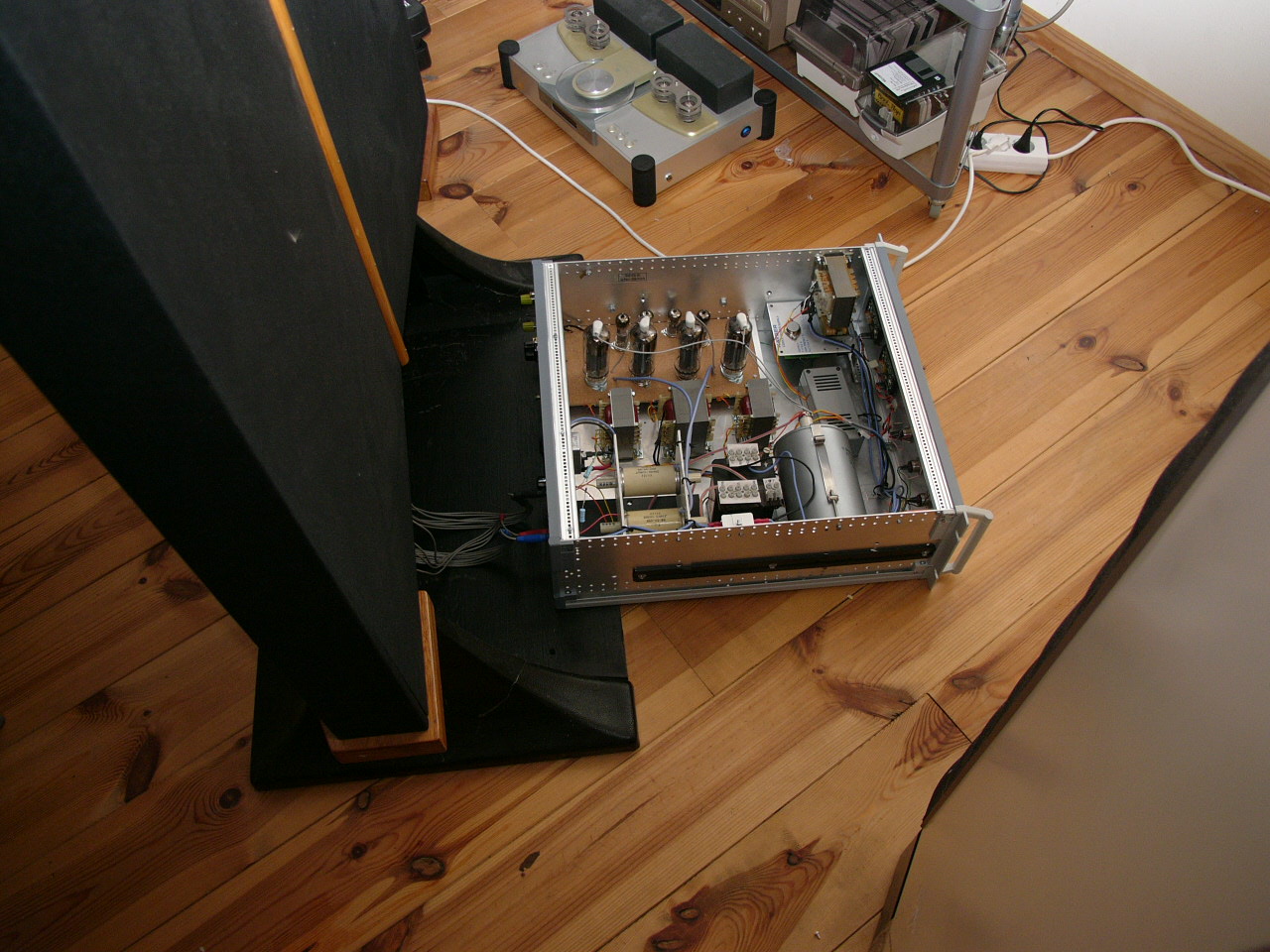

Anyone tried a direct drive amp on one of these?
Your amplifier looks familiar to me. Can it be that I saw this several years (many years?) ago at a meeting of the Dutch ESL club?
BTW I am working on a DD amp, hence my measurements/questions.
Jan

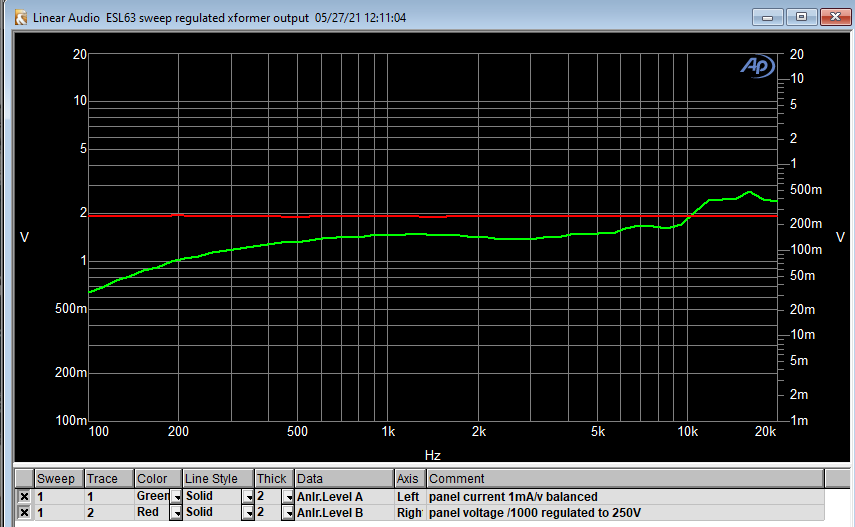

Measuring the drop across a resistor should work but you may have a common mode issue. Easy test- short the resistor and sweep. You should get nothing. Any output is an indication of common mode errors. You are trying to measure millivolts in the presence of 100V. Not easy.
I can duplicate your measurements with a current probe, but it will be a week or two before I'm able.
I could also just drive a panel from a HV amp and measure the current. I thought I made some measurements but have not found them.

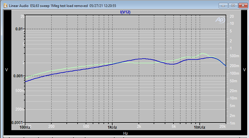

OK, re-done, balanced. There is still a discrepancy between measured and simulated, but it gets closer.
Up to a kHz it is pretty close, but of course we are interested in what lies above.
It's also reasonable close above 5kHz. The big elephant is the bump at 2.2kHz.
Edit: measurement is done with speaker close (<1 ft) to a wall. I redid the measurement moving it further away (3ft), no change.
Comments?
Jan

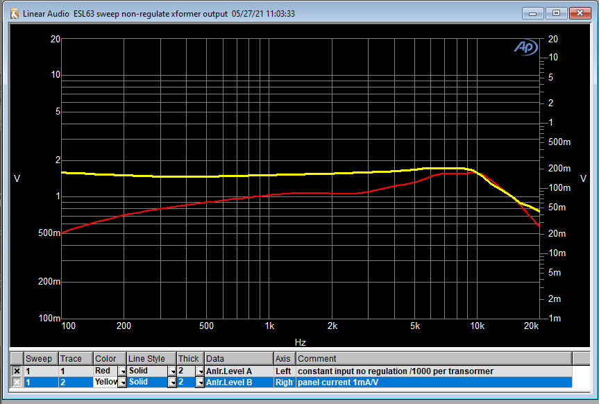

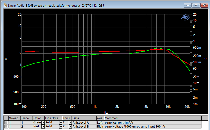

The plot thickens. This is the same measurement, but now with the panel voltage not regulated, i.e. constant level input to the speaker input, so the measurement now includes the effect of the input crossover filter & transformer. The 1.5R//220u has a xover of around 500Hz, and then there's also the xformer non-flat response I guess.
RED is the voltage on the panel, with constant input voltage to the speaker. There is a dip exactly at the peak that is shown in the simulated panel current.
Also, above 10kHz the panel voltage drops, with the result that the measured panel current is much lower than in the simulated panel current with constant panel voltage.
I believe that in the case of direct drive, the drive voltage should be equalized according to the RED curve, which then also significantly lowers the maximum drive current requirement.
Am I right?

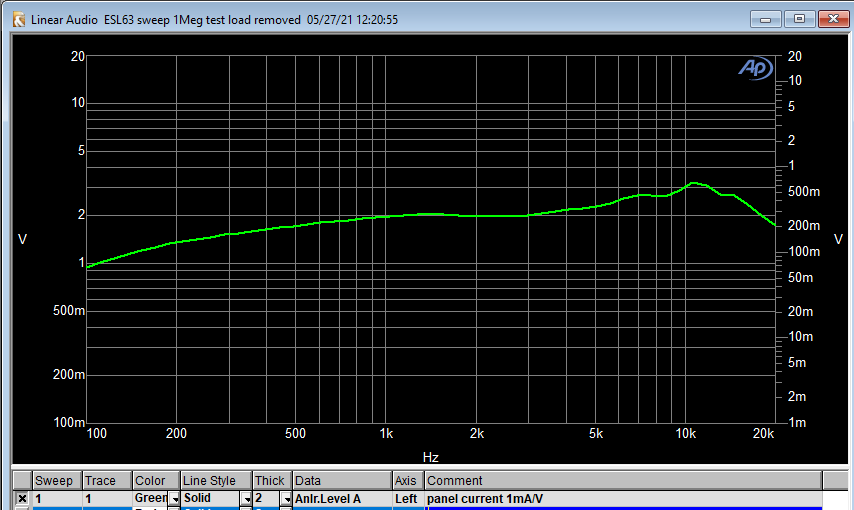

My face is red - I made a hook-up mistake, so the previous graphs are incorrect. Here the correct ones - but not significantly different.
First one is with panel voltage regulated to 250V per panel (500V total).
Second is without regulation, constant input to the amp, and panel voltage varies due to xover and xformer non-linear response.
Third is as the 2nd but with the 1Meg measurement load across the panels removed. The panel current is a bit higher, as expected due to higher panel voltage, but exact panel voltage not known.
Fourth is again the test setup.
Sorry for the confusion, I think I've got it right now.
Jan
