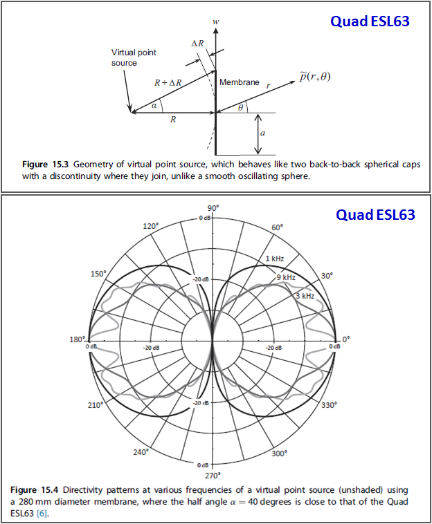

… I'm still not sure what they did in the delays that is so different from Quad. The delay line construction is different being cascaded LP filters instead of all pass networks

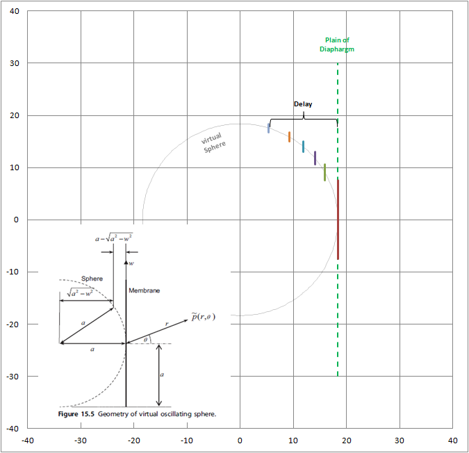

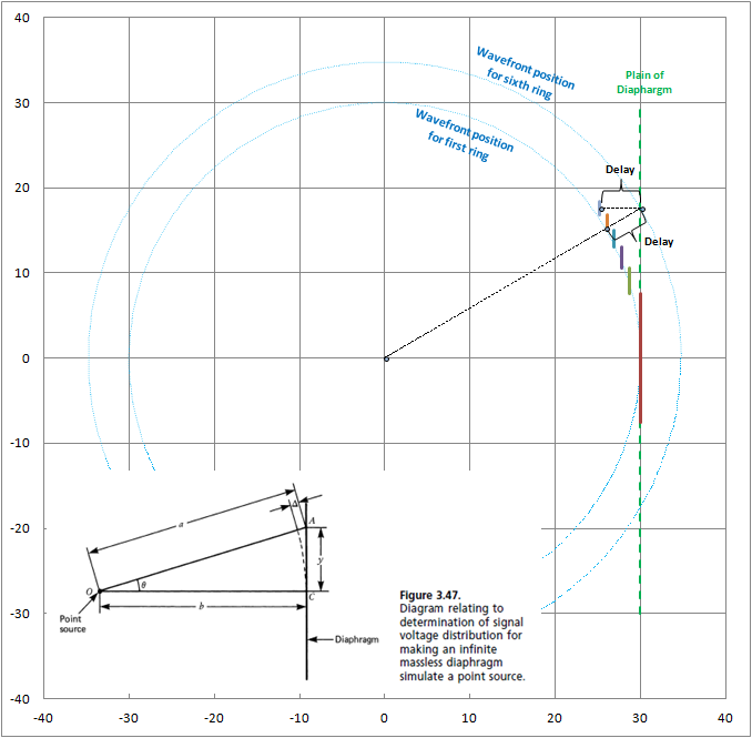

The difference is in what virtual source is trying to be emulated. For the Quad, it is a virtual point source placed some distance behind the diaphragm. The virtual wavefront is still curved/expanding as it passes thru the diaphragm, which the rings and uniform delay per section attempt to match. The wavefront stretches well beyond either side of the diaphragm, which is only capturing a section of the expanding wave. Often the virtual source is described as a section of a pulsating sphere, rather than section of expanding wavefront from a point source. Either way, since only a section of the source is captured, even in the idealized case, the polar response is not uniform with increasing frequency or smooth with angle. Walker, added losses to the delay lines to address reflections at the sectional termination.

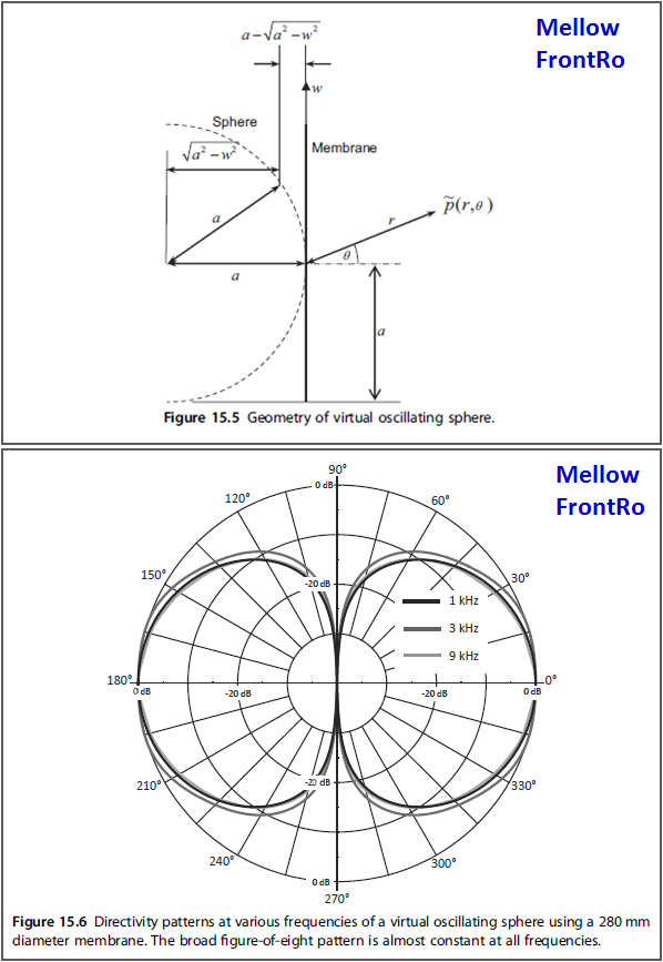

Mellow’s FrontRo ESL is based on a similar virtual source concept, the difference being the source he is emulating is an oscillating sphere. A physical oscillating sphere source has uniform dipole directivity at all frequencies. In theory if the virtual source is built with many rings and delays increasing with ring number the surface of the sphere is completely captured(ie no termination issues), and it too will have uniform dipole directivity at all frequencies. This is the big differentiator from Walker’s concept, where even a theoretically perfect implementation of the section of a pulsating sphere still has directivity that is not uniform with frequency or smooth with angle. The original concept documented in JASA and Patents involved active delays and multiple amplifiers. The passive implementation in the FrontRo loudspeaker used only a few rings, resulting in the need to add some low-pass filtering to the delay networks for the outer rings to keep the polar response smooth at higher frequencies where wavelength approaches ring width.

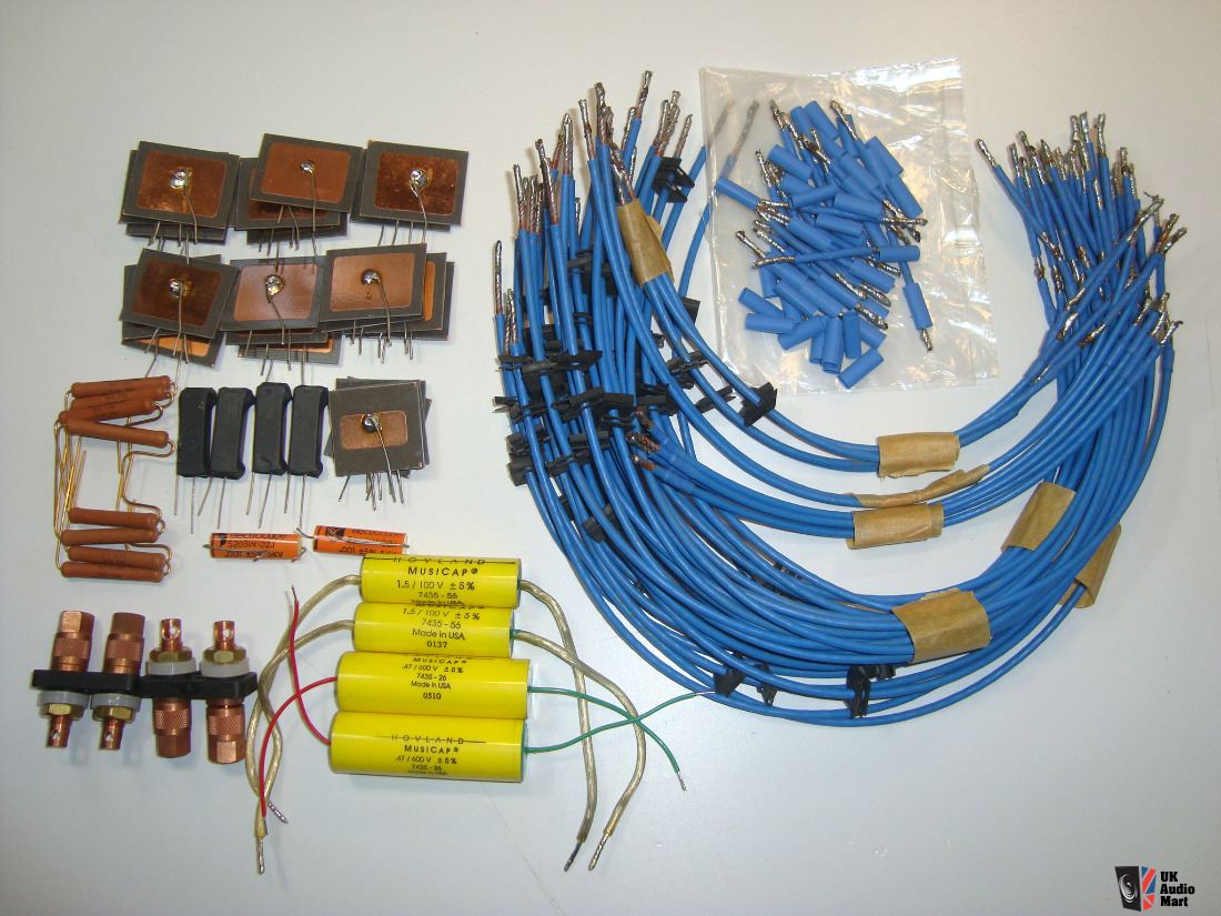

Now that you bring up the Crosby mods for the 63,
What was accomplished with these mods ?

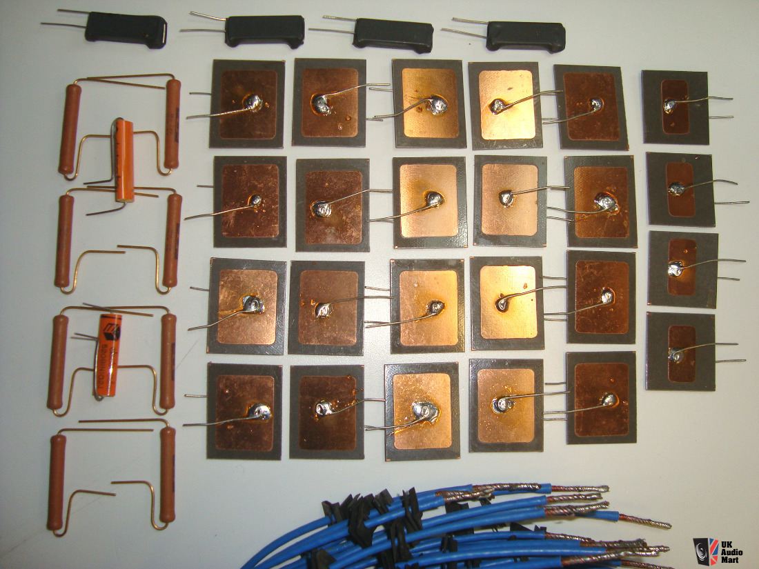

Well the silly and worthless wire was melted into the panels slots making an ungodly mess of the panels, but maybe this was done by another party. I don't know I just buy the speakers without knowing their history. The workmanship I've seen from these mods is not great either, lots of soldering iron melting of the stator supports. I generally pay LESS for a set of crosby modified speakers than I would for a stock set because I have to clean up the mess. The holes I've seen cut for the silly binding posts weren't always lined up well etc.
Mechanically the new resistors and caps don't fit well and are not well supported.
In contrast I turn down the shoulders on gold plated 5-way binding posts on my lathe so I don't have to cut the metal on the quad itself.
There's some value to the more open grilles, thinner dust covers. Stiffening up the internal panel supports and such. But the last foot of wire after miles if thin magnet wire is just plain silly.
Sheldon
I spotted this for sale along with a Crosby sheet showing different levels of mods
availble.
The price was too high for the set and might have bought it had it been cheaper
Someone got it
It looked interesting and would have liked to hear how it changed the speakers.
It appears some serious thought might have gone into these mods though
Regards
David

Walker envisioned the spherical wave propagating from a point source towards an ESL diaphragm. If he sectioned off the ESL into ring stators he could delay and reduce the amplitude of the pressure generated by the ring to match that of the propagating wave as it passed thru the plain of the diaphragm. To capture the whole wave you would need an infinitely large diaphragm.
Attachment #1: illustrates delay for the 6th ring
For each ring -
Delay = sqrt(b^2 + y^2) – b
Attenuation Factor = b / sqrt(b^2 + y^2)
Mellow envisioned an ESL diaphragm sectioned off into rings that could be delayed and driven at uniform pressure to emulate acoustic radiation from the surface of an oscillating sphere. The ESL need only be as large as the oscillating sphere.
Attachment #2: illustrates delay for the 6th ring
For each ring -
Delay = a - sqrt(a^2 - w^2)….using variables from Figure in Attachment #2
Delay = b - sqrt(b^2 - y^2)….using variables from Figure in Attachment #1
Attenuation Factor = 1.0

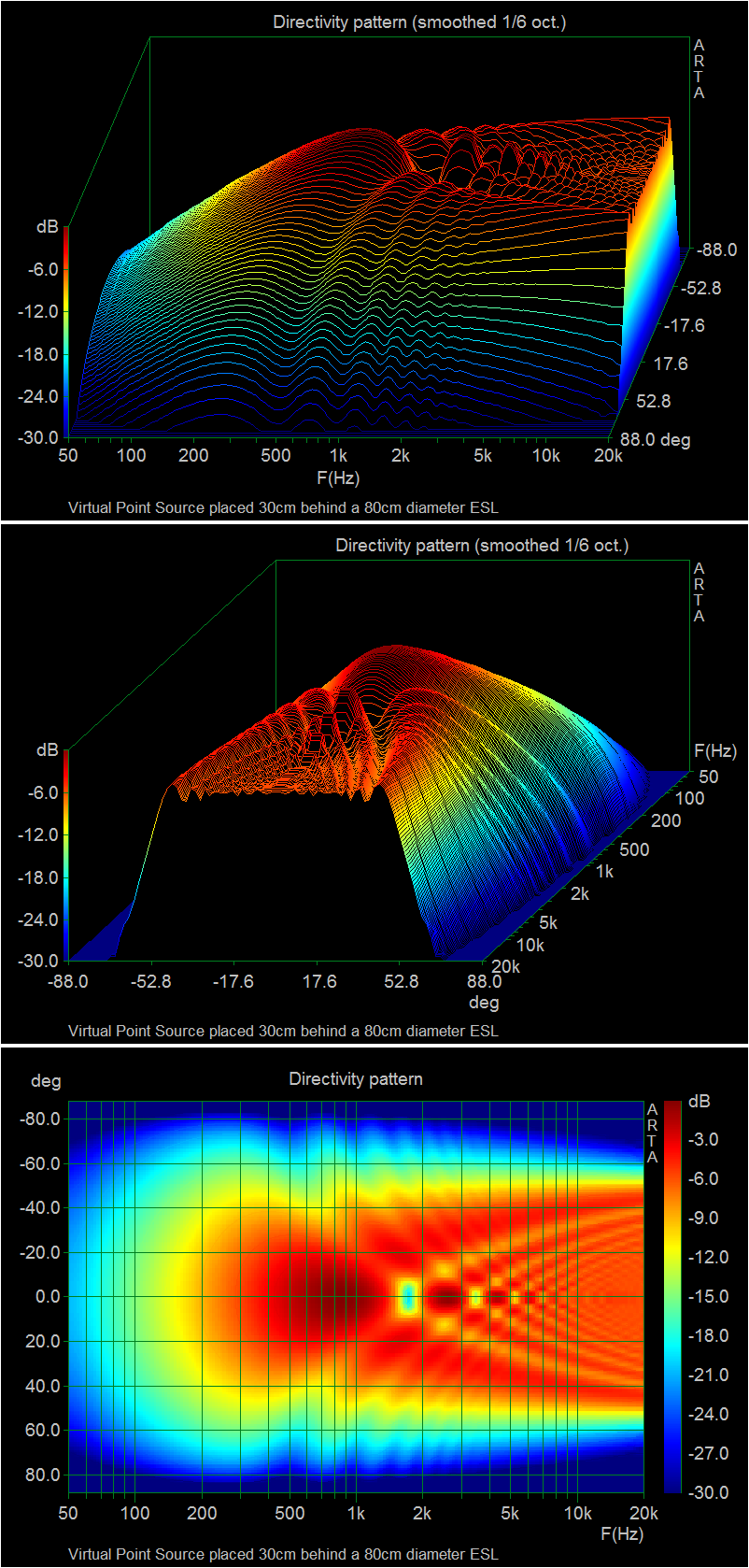

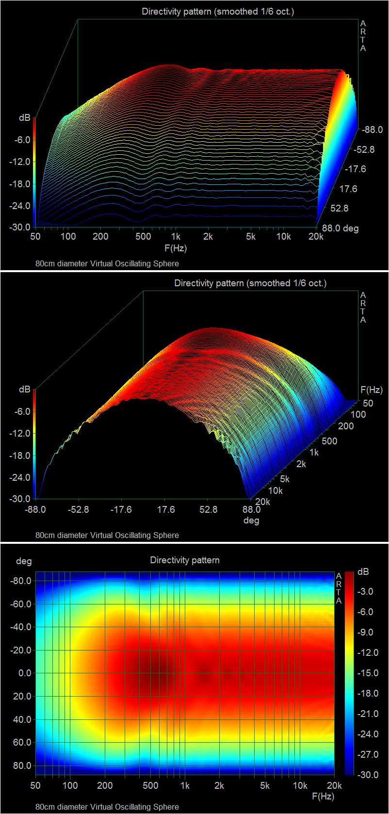

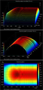

Years ago I made many analytical comparisons of the two techniques. Here is one comparing polar performance for a 80cm diameter ESL divided into 100 ring segments using the two techniques. No losses or low passing added, to clarify the differences in the two theoretical concepts.
Attachment #3 shows the virtual point source placed 30cm behind the ESL. Recall a point source provides flat response at all off-axis angles. The 80cm diameter section of the point source wavefront does provide flatish response out to a reasonable off-axis angle, but is marred by ripples. If you could build one with theoretically ideal delays and drive levels, it would be provide you with this less than ideal acoustic behavior. In the ESL-63, Walker utilized lossy delay line as well as segment 7 to smooth out the ripples and polar response trend. Never ceases to amaze me what he was able to accomplish without the aid of modern computer simulation.
Attachment #4 shows the oscillating sphere provides the near uniform dipole polar response as advertised. If you could build one with ideal delays and uniform drive, it would provide you with a very nice smoothly trending acoustic behavior. Easier said than done though, with those large and increasing delays.
NOTE: Plots are shown in ARTA, but these were based on theoretically calculated impulse responses, not measurements.
Just to be clear, I am not saying that the practical implementation of either of these concepts is by default superior to the other. I was just trying to point out a relatively recent theoretical design concept that seems to hold at least as much promise as Walker’s brilliant idea.
