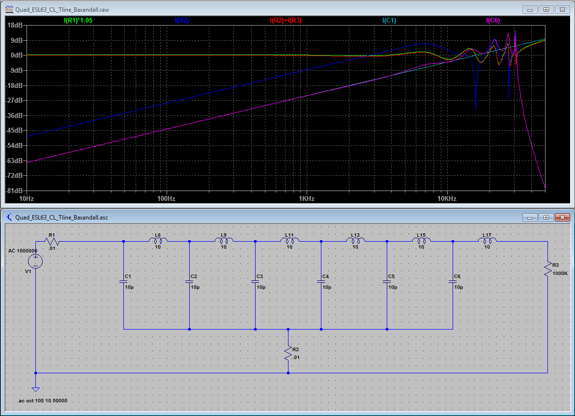

The total current feeding a lossless, terminated LC transmission line is the same for all frequencies, but the current thru each of the ring segment capacitance still increases proportional to frequency. The current thru the termination impedance must be added together with the sum of all the segment currents to get the frequency independent input current. As described in Section 3.4.2 of the Baxandall ESL chapter, the ESL-63 adds segment 7 (and 8 really) as part of the termination impedance to recover the portion of the total current required to get a flat response.…By segmenting the ESL and connecting the capacitive segments with inductors, he converted the ESL to an LC transmission line which behaves as a pure resistance, and now the stator current is the same for all frequencies, and you can use any audio amp without the need for special equalisation circuitry. Check wikipedia entry for transmission line - and see the characteristic impedance entry.
The attached LTspice simulations illustrate.(Values for L & C chosen to simplify math)
Attachment #1: The total current into the transmission line is I(R1) and is seen to be flat with frequency(ignoring the wiggles at the upper end due to descretization of the TL). The sum of the currents thru the ESL segment capacitances I(R2) is seen to increase with frequency. Add the current from the termination resistance I(R3) to the segment currents and you get the flat total current. But the far-field response is only due to current in the segment capacitances, so is not flat but increases with frequency.

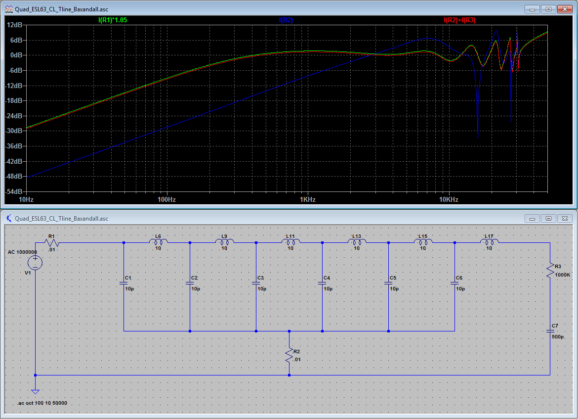

Attachment #1: Inserting additional ESL stator area (C7) in series with the termination resistance and the response is flattened down to frequency where the termination impedance starts to increase because of the capacitance of the inserted stator area. This is in essence what is being down with segments 7 & 8 on the ESL-63. The tricky part is that the TL in the ESL-63 is not lossless and includes additional capacitive load per TL section from the compensation capacitors, so an additional shunt capacitance component C13 is used to help equalize the currents flowing thru the termination segments to match the sum of the currents in the ring segments to produce a flat response. The Walker equation relationship between stator current and far field pressure response made it possible to work out a compensation scheme for the real-world circuit with all its losses and parasitic components without lifting a microphone.

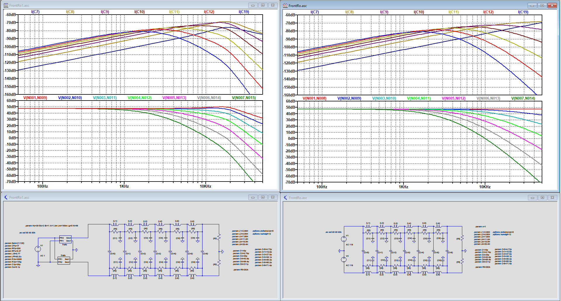

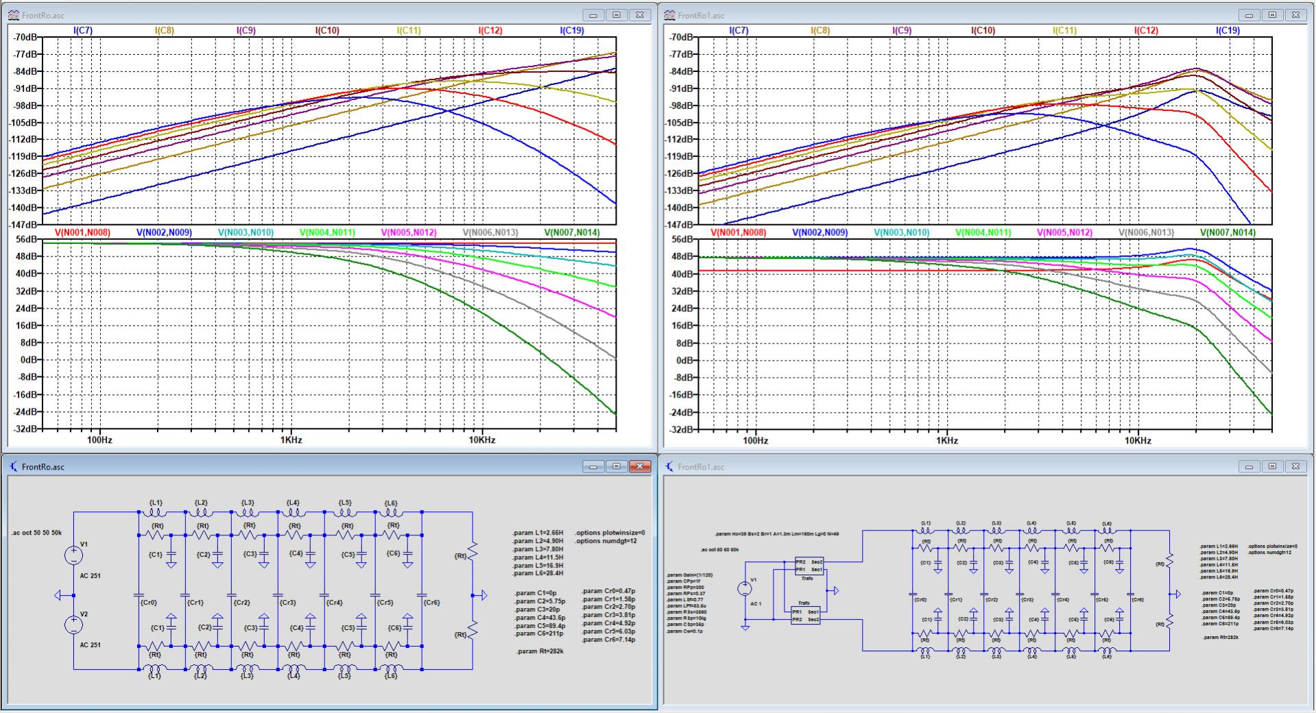

Here is an initial LTSpice model that I have made for the FrontRo ESL.
I have used 3mm gaps between the rings, to prevent a short circuit between them.
The delay lines I have inserted are without any of the Rser, Rpar and Cpar that I used for the ESL63.
Two models were simulated, the one at the left direct driven without step up transformer and in the simulation to the right the EL63 transformers are used.
For both situations I have shown the currents through the membranes Rn0 to Rn6 and also the voltages over these 7 elements.
Hans
Hans

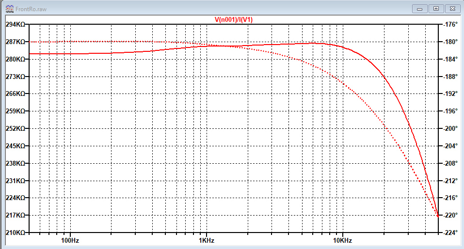

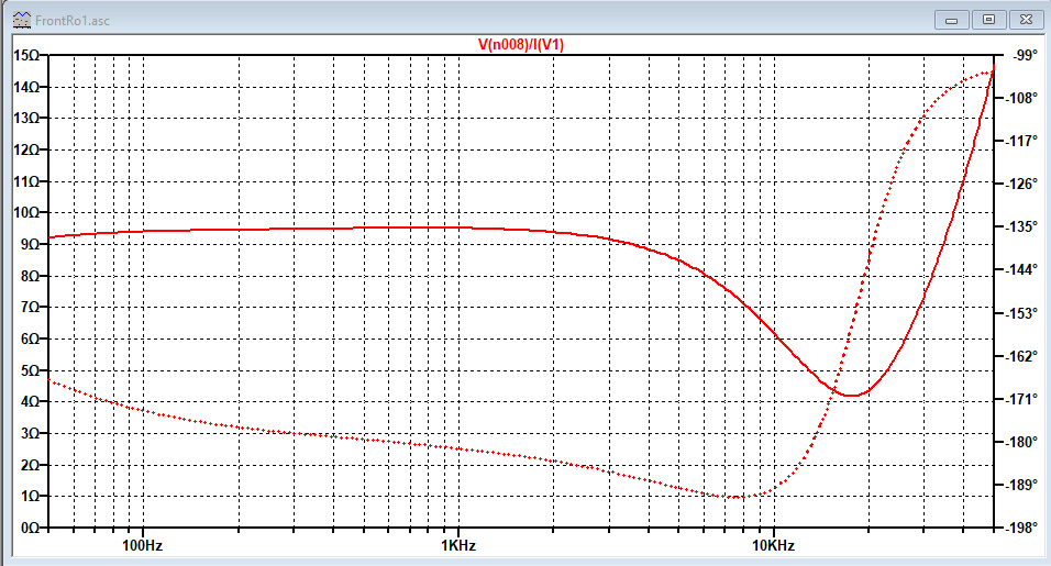

I was surprised with the immensely small membrane capacitances, starting at 0.57pF for the centre ring, which is almost impossible to achieve with the wiring leading to this element, but it turned out that I had made a factor 10 mistake for all capacitances.
But even then, 5.7pF will still be hard to achieve for the first membrane plus wiring.
Fortunately with LTSpice it's almost a hit of a button to correct the error.
So here are the newly calculated currents and voltages for the membranes in the first image below.
Sorry for the earlier mistake.

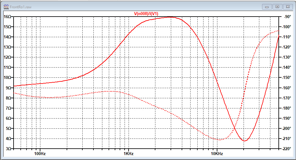

The impedance curve is nice flat without the step up transformer in the second image.
With the step up transformer from the ESL63 a 4 Ohm dip shortly before 20kHz is created meaning that this is probably not the right Xformer for the job, see third image below.
The turnover frequency in the Mellow paper fits quite well for the turnover frequency f1, but all the others are up to 35% lower.
I checked whether this had to do with the 3mm gap between the rings that I have used, but this hardly has any effect on the turnover frequencies.

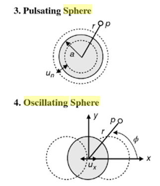

One last thing: the terminologies pulsating versus oscillating spheres are still confusing me. Can somebody explain what's behind these words.

Think of a pulsating sphere as a sphere whose diameter increases and decreases at an audio rate....the terminologies pulsating versus oscillating spheres are still confusing me.
Think of an oscillating sphere as a sphere of fixed diameter that shakes back and forth at an audio rate.
O.k., got it, but does this apply to any of both systems or is it more of a commercial statement to keep them apart ?
Seeing the ESL63 as an pulsating sphere is not the first thing that comes to my mind.
Hans
Steve,Inserting additional ESL stator area (C7) in series with the termination resistance and the response is flattened down to frequency where the termination impedance starts to increase because of the capacitance of the inserted stator area. This is in essence what is being down with segments 7 & 8 on the ESL-63. The tricky part is that the TL in the ESL-63 is not lossless and includes additional capacitive load per TL section from the compensation capacitors, so an additional shunt capacitance component C13 is used to help equalize the currents flowing thru the termination segments to match the sum of the currents in the ring segments to produce a flat response. The Walker equation relationship between stator current and far field pressure response made it possible to work out a compensation scheme for the real-world circuit with all its losses and parasitic components without lifting a microphone.
