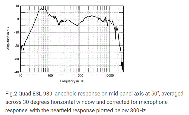

The extra panels gives a big hump as seen in stereophile measurement:
It´s however easy to double the R6 and R8 as i mentioned before and flatten out the response.

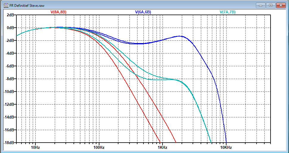

Adding two extra bass panels changes remarkably little to the signals on the inner six rings.
In the first picture below, you see resp. the electrical signal on ring # 6, 7 and 8 without and with the extra 2 bass panels.
The first 5 rings do not show any difference and are omitted.
Ring #6 shows only a very minor drop of 0.2dB between 100Hz and 300Hz, which will very unlikely lead to a noticeable difference in sound.
The first bass panel #7 however drops 1.8dB around 300Hz, which seems a lot.
The bass panels in ring #8 do drop from zero dB at Lf to 4dB at Hf.

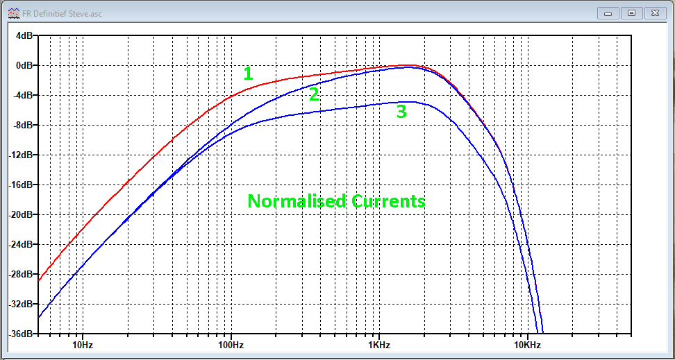

According to Peter Walker's formula, power/m2 is directly proportional to the current flowing through the panel, so in the second image I have shown these currents to give a better view on the situation.
Three curves are visible.
1: current with added bass panels
2: current without added bass panels
3: current through the original bass panels when the extra bass panels are added.
From these curves one can see that above 1kHz the same amount of power is produced with and without the added panels.
The diminished power radiated by the original bass panels is corrected to the original level by the two added panels
Going down in frequency from 1kHz, up to ca 6dB more, or twice the power is produced, which is partly corrected by the lesser output of ring #7, so most of the added bass seems to be produced below 100Hz.

I don't have a lot of faith in Stereophile's measurements. You can see by that measurement in the high frequencies that they are not on axis with the speaker, or they have an issue with their measurement setup at the high frequencies. Getting that low frequency response right can be quite tricky unless they are in a very large space or outside.
I wonder if that measurement is correct, it may just be the proximity effect. The graph says that they plotted the near field response below 300 Hz, which is where you see the hump, but a flat-panel ESL designed for a flat far-field response has a -20 dB/decade slope in the near field.
This is how Stereophile measures speakers.
And the data above that 300hz point is averaged over 30deg. Averaged with what weighting?
I stick by my earlier postulation that Stereophile measurements are worthless.

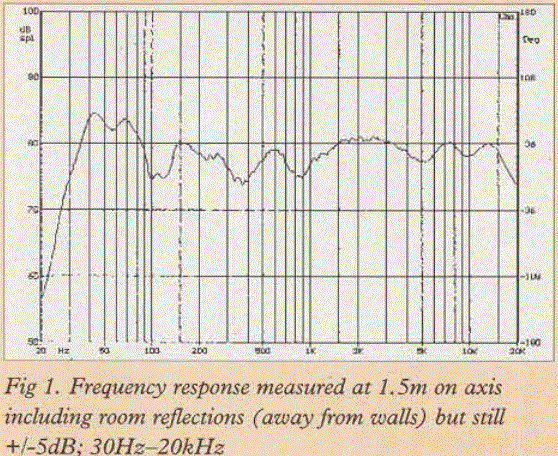

David Berriman at HiFi World did this measurement and it follows my reasoning that you get both an amplification from the larger pathway and boost from the panels. However the leakage out from the sides can be reduced by "wings".
Electrically you increase R6 and R8 to 720kOhms. Have tried this and this works very good. Deep punchy bass, totally free from distortion and coloration.

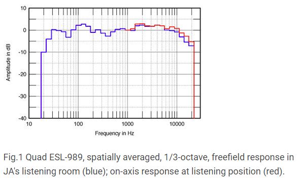

I don't think there is any weighting involved.
There was a serious caveat in the original ESL-989 review regarding the near measurements. They are usually very good at warning readers that large speakers present problems for them and that their standard quasi-anechoic methods do not accurately reflect in-room response for large speakers at greater distances. They are trying to maintain consistency across reviews though, so present the standard data set.
In a later review, Atkinson showed the in-room response, which is much flatter.
Measuring Loudspeakers, Part Three Page 3 | Stereophile.com
"The curve is actually a composite, consisting of the seven spatially averaged responses taken with a 30kHz bandwidth from 1kHz to 30kHz, a separate on-axis measurement taken with a 5kHz bandwidth from 312.5Hz to 1kHz (this makes the graph look more presentable, but the true frequency resolution is unchanged), and the complex sum of the speaker's nearfield port and woofer responses below 312.5Hz"
Quad ESL-989 electrostatic loudspeaker Measurements | Stereophile.com
"Interpreting the measured frequency response of a fairly large panel speaker like the ESL-989 is not straightforward. First, the assumption that the microphone is in the speaker's farfield at my routine 50" distance is no longer true, which means that there will be a slight downward trend with frequency, due to the proximity effect. Second, my usual nearfield measurement of the low frequencies will not show the effect of the dipole cancellation, as the antiphase backwave increasingly wraps around to cancel the speaker's direct output with decreasing frequency. The peaked-up bass shown in fig.2 will therefore tend to be more flat in the farfield than it appears in this graph"
Quad ESL-989 electrostatic loudspeaker John Atkinson May 2003 | Stereophile.com
The diaphragm is acoustically transparent, so why does a larger diaphragm result in a larger pathway? Isn't it essentially zero with an acoustically transparent diaphragm, no matter how large the diaphragm may be?

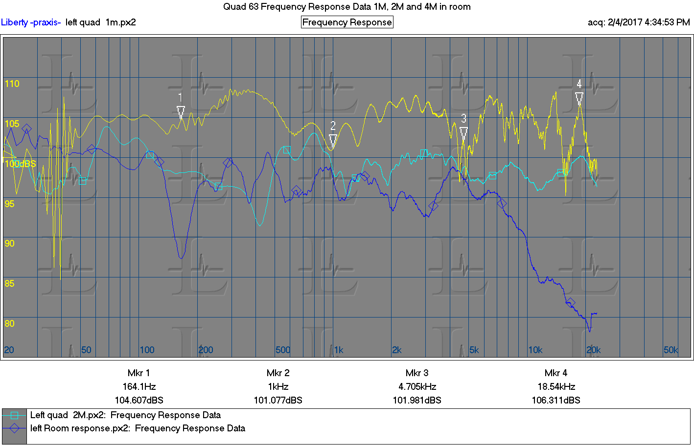

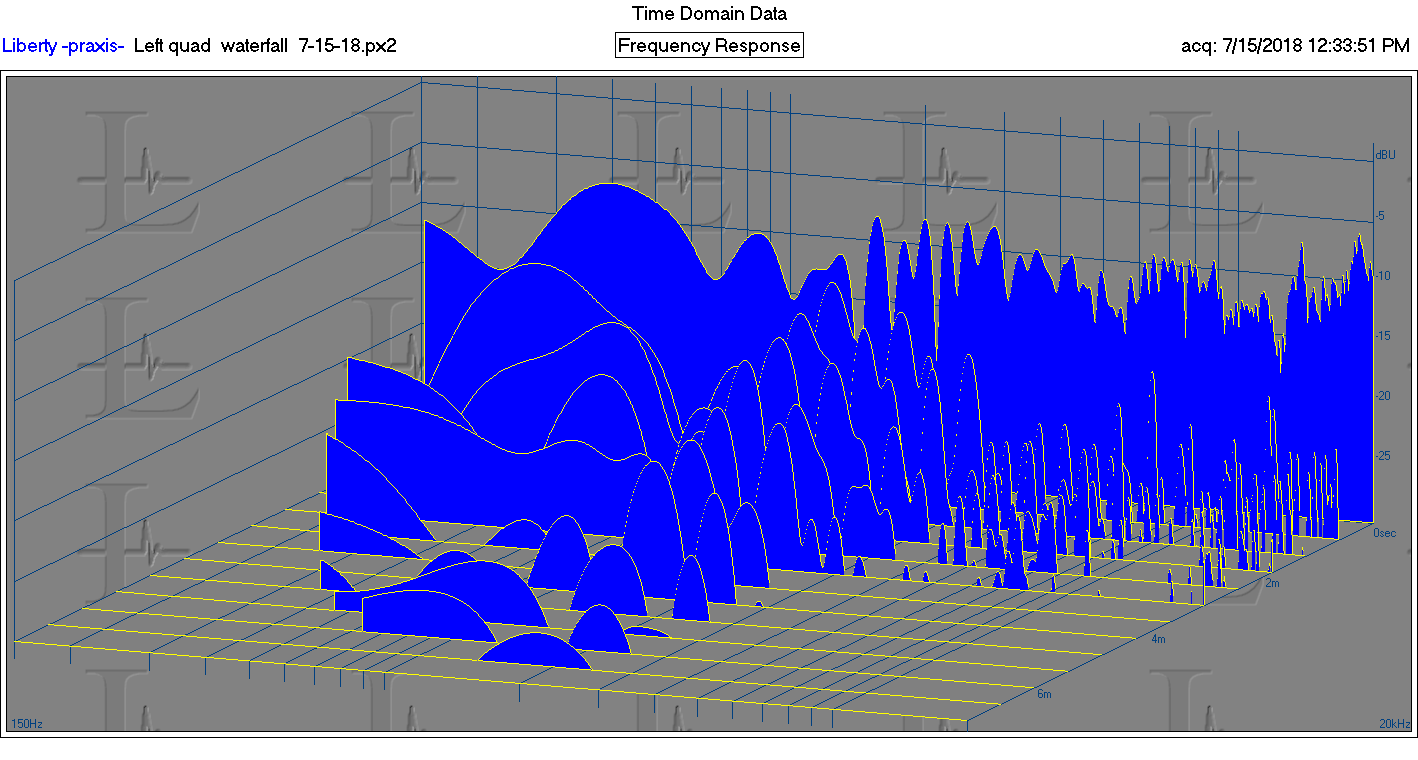

Some Quad measurements
First are two measurements at two different distances and then a windowed measurement same location with the first arrival windowed out to see the energy bouncing around the room. These are not smoothed and pretty high resolution so much messier than the usual published plots
They all show significant energy below 50 Hz but that may even be ambient noise.
The second is a waterfall from the same location.
The quad is not stock, but a Crosby mod so different dust covers, grill, caps in the delay line etc.
