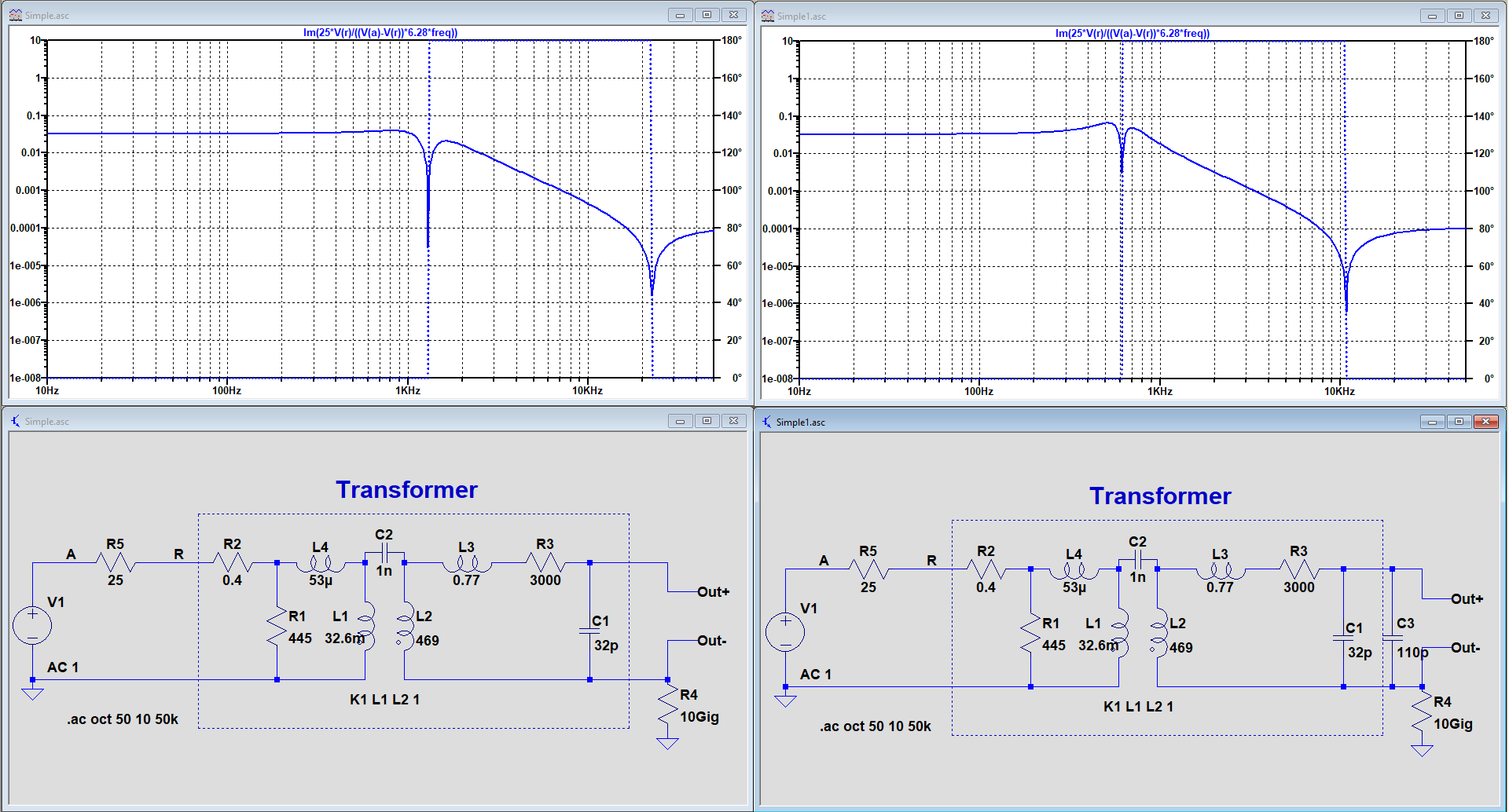

Using the primary inductance value from 10Hz to back calculate value for winding capacitance(C1) from resonance frequency is problematic. Unfortunately, the primary inductance isn’t constant because the BH curves are a function of frequency(for Freq > 100Hz), and for any given BH curve the permeability is a function of applied current which falls for increasing frequency because of the inductance. Looking at the data the value of L1 looks to have fallen by factor of two by 1kHz.
I will post a summary of my conclusions later today on the 1st order parasitics. I have never investigated 2nd order parasitic in much detail as they don’t generally affect the response in the audio band. But, I have a few papers on the subject I will need to read up on. Attached is one of the proposed models that is supposed to better define the impedance behavior of the distributed capacitance and leakage inductance.
O.K. So long story short, what you are saying is that calculating C1 with L1 is unreliable because of the changing value of L1 versus frequency and just using LSf is more reliable.
Given 107uF * N^2 = 1.54H for LSf and a resonance at 22.7kHz gives a value for C1 of 32pF.
This means that the resonance peak at 1.3kHz is caused by a value of L1 of 32.6mH instead of the 65mH that I used.
That makes sense, I can live with this explanation.
I have adjusted my model accordingly with L1 to 32.6mH, LSf to 1.54 and C1 to 32pF.
Both peaks at 1.3kHz and at 22.7kHz are there again, and by adding 110pF to the secondary, it matches Demians measurement with 100pF, but this might well be a tolerance issue of his used cap.

Another check for the 100pF case is the series resonance frequency between leakage inductance and (C1=32pF + 100pF).
Adding the 100pF moves the series resonance from ~23kHz to ~11.4kHz with good match between model and measurements.

You probably missed my graph in #183, the one at the right, because that's exactly how I got the 110pF, by matching the second resonance peak with Demian's graph in #179.That makes perfect sense
Hans

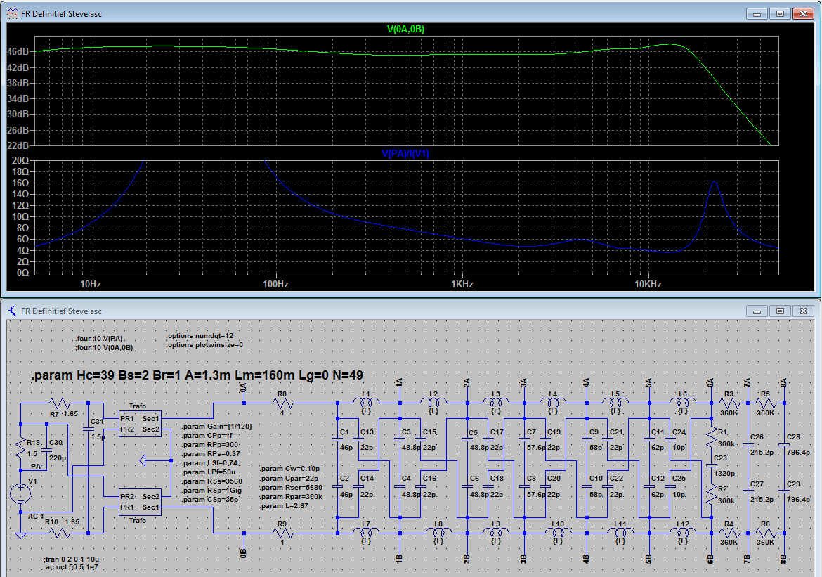

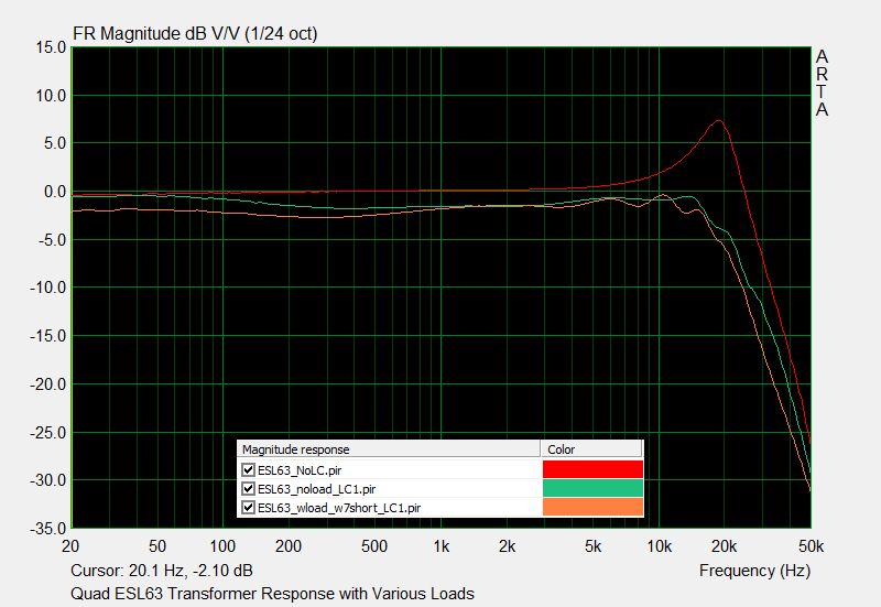

I just encountered a nasty problem.
At the point where the 1R65 resistors on the primary side are contacting the transformers, a 1.5uF cap is placed between them, which I completely overlooked until now.
This Low Pass filter has a serious effect on the FR at the secondary side of the transformer.
Even the slightest CW only worsens the restricted FR problem.
So further experimenting is needed to compensate for this.
Hans

I did see the graph, but misunderstood your text concerning matching of series resonance.You probably missed my graph in #183, the one at the right, because that's exactly how I got the 110pF, by matching the second resonance peak with Demian's graph in #179.
Nasty problem? Or maybe mystery solved.I just encountered a nasty problem. At the point where the 1R65 resistors on the primary side are contacting the transformers, a 1.5uF cap is placed between them, which I completely overlooked until now. This Low Pass filter has a serious effect on the FR at the secondary side of the transformer. Even the slightest CW only worsens the restricted FR problem.
Add the 1.5uF cap and set Cw to a very low value seems to provide reasonable match for measured impedance and response. I know I was skeptical about how such a large value of Cw was needed to match the impedance peak just above 20kHz when there didn't seem to be a physical reason for it. This is a more satisfying answer, relegating Cw back to the 2nd order parameter list. What do you think?

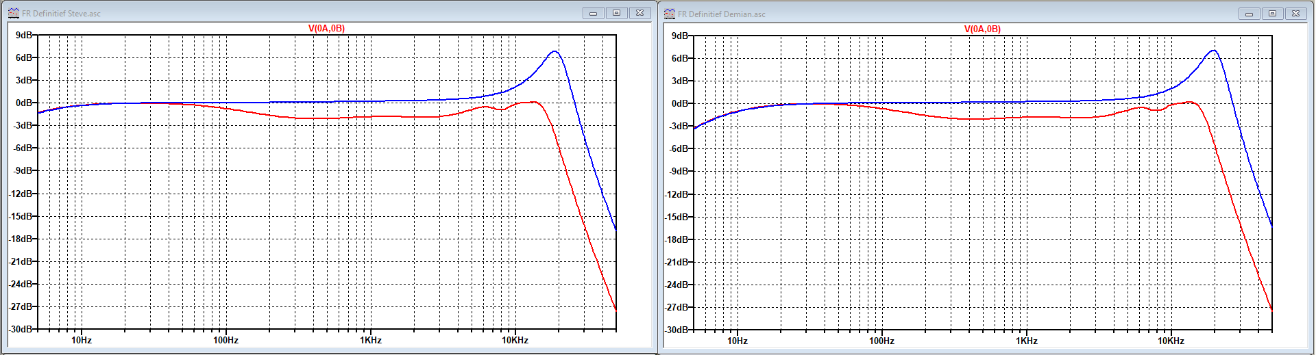

Steve,
Thank you for this contribution and it looks promising.
Unfortunately Demian's transformer responds differently.
So I need a bit more time to capture both under the same conditions.
And what I don't like so much is a FR that is down 4-6dB at 20kHz.
Cw still seems to be necessary, and almost directly when Cw is applied, it comes very precise how the leakage inductance is divided over primary and secondary.

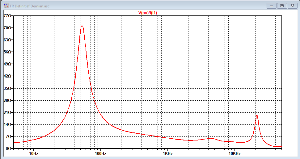

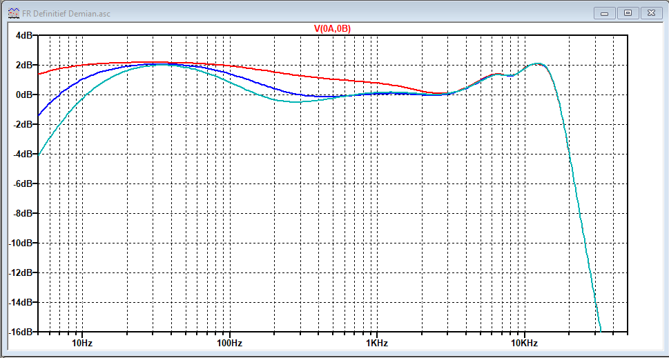

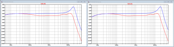

When playing again with the files, I noticed that in Demian's model I had added 1.5nF instead of the 1.5uF in Steve's model.
That caused the differences that I saw, what a silly error.
I went the whole way back to Steve's recording in #19, showing the secondary response without and with different delay line loads when loaded with a 2.7Meg//5pF differential probe, see first image below.
To replicate that as accurate as possible, I had to add a serial resistance of 50k to the secondary Csf to limit the peak to somewhere between 7 and 7.5dB, see second image below.
But as it turned out later with the complete model, this 50K resistor has hardly any influence and could just as well be left.

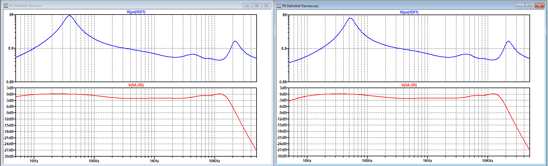

Now with everything in place I made the third simulation of the full model, Primary Impedance curve and FR directly on the secondary.
As can be seen, the difference between both transformers from Steve to the left and Demian to the right is just the FR below 10Hz, that's it.
And yes Steve was right, the 1.5uF did not create a problem, but completely solved the 20kHz impedance mystery peak.
No Cw isn't playing a role anymore and I think we can call it a day with the final LTSpice models added below
Hans

The only visible effect of the 1.5uF at the input network is the impedance peak slightly above 20kHz.
On the FR it has hardly any visible effect.
However, there is often discussion about the 1R5 // 220uF at the input.
Philips had this resistor shortened in their Studio Monitor, but some do the opposite and increase the value to 3R // 220uF.
This has definitely effect on the FR as can be seen in the Image below, resp. from top to bottom, shortened (red), 1R5 (blue) and 3R (Cyan).
Hans
