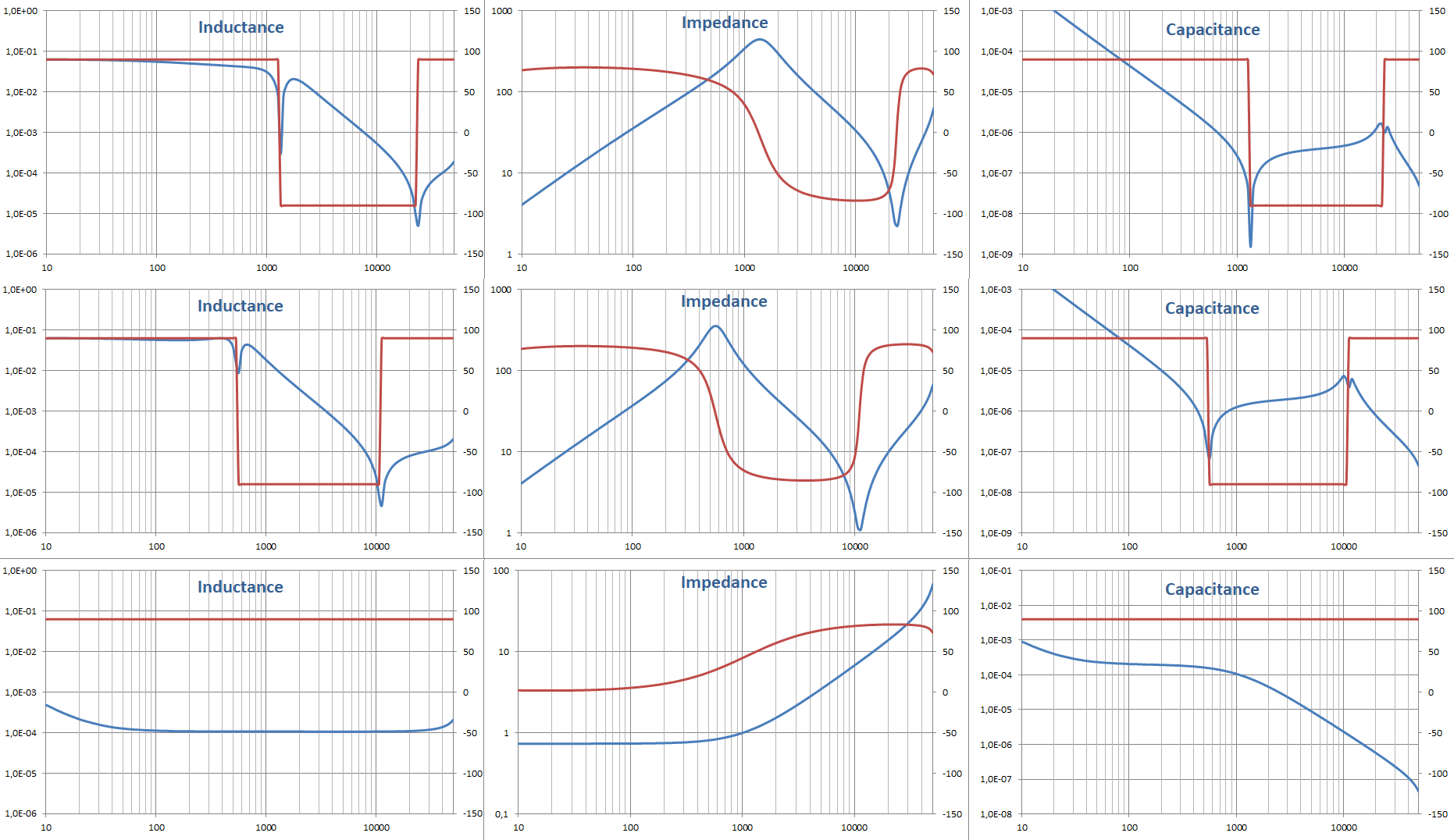

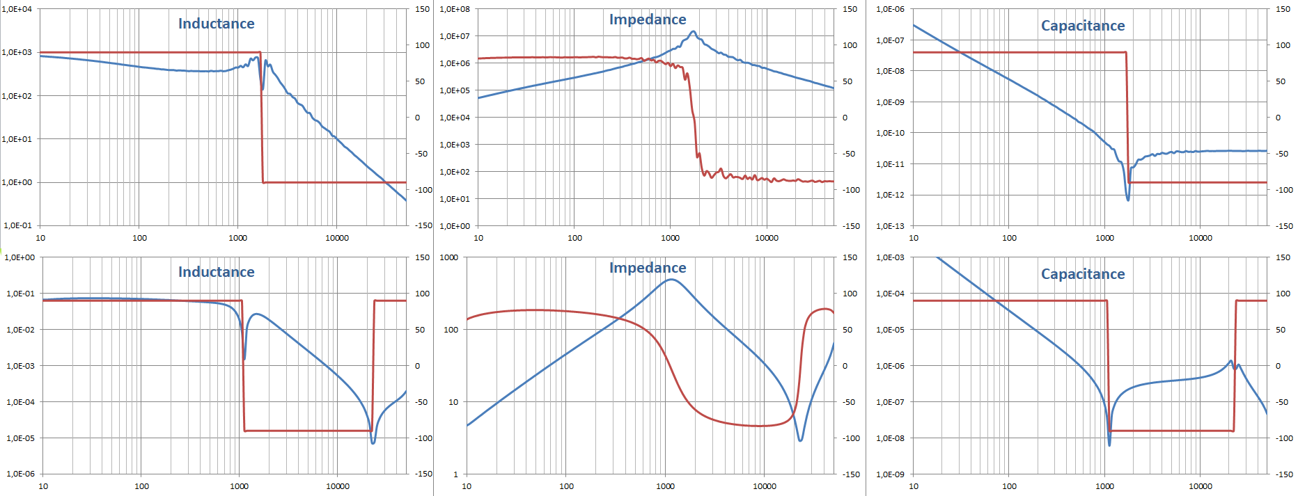

I have the first results from Demian's measurements with his Bode 100.
In the first image, the primary side is connected to the Bode in shunt mode (Rsource=25R), with resp. from top to bottom
Secondary open
Secondary loaded with 100pF
Secondary shorted
The second image has the secondary side connected to the bode in series mode (Rsource=100R), with resp from top to bottom
Primary open
Primary shorted

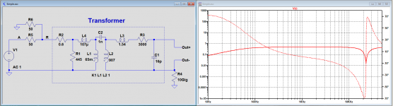

The next step was to extract all parameters from these images.

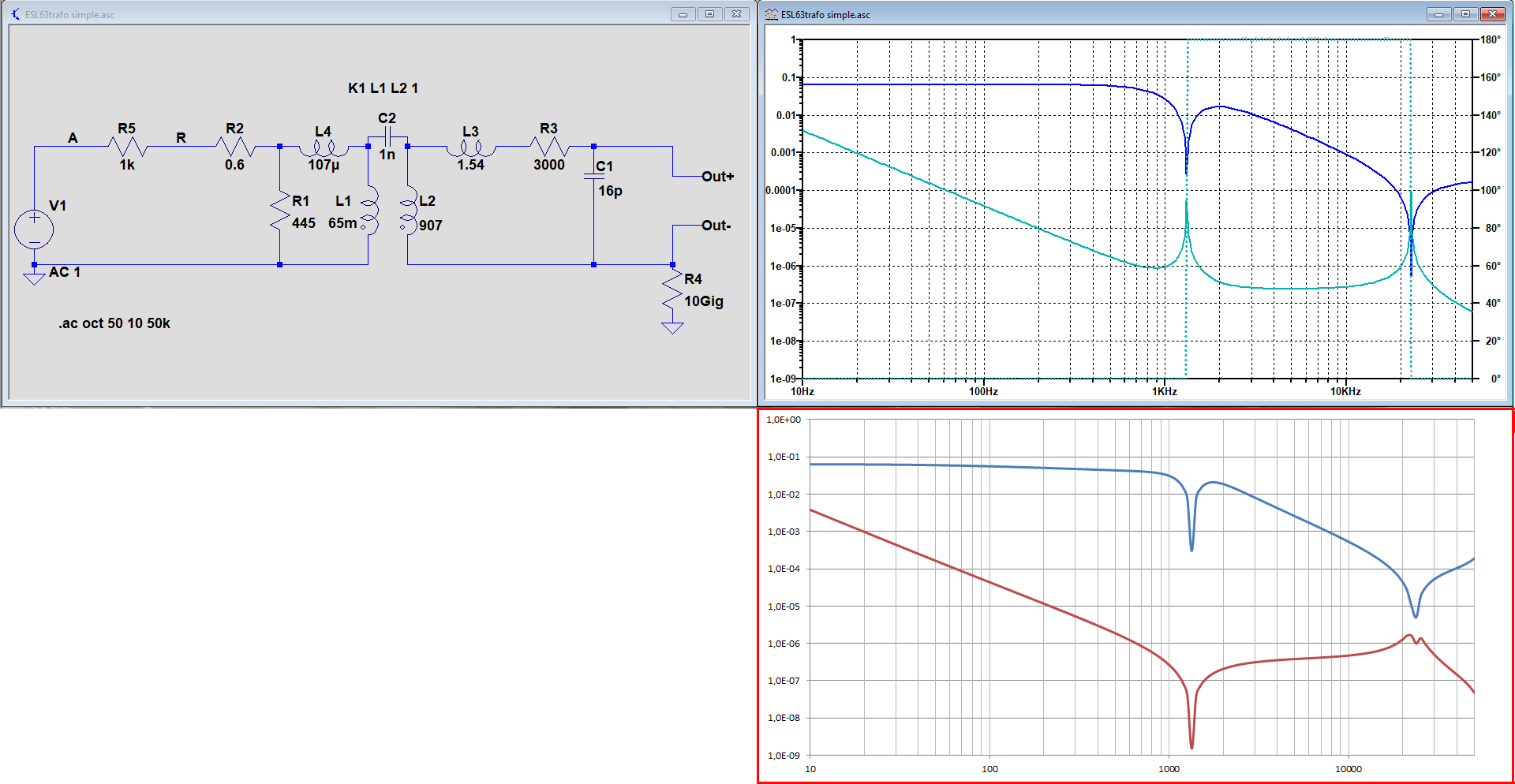

What I have achieved is a combo of reading the measurements and transferring the data to LTSpice to check the results.
In the thirs image below you see the conformity of what's been measured against the simulation using all the extracted data, Inductance as well as Capacitance.
From the measurements came a transfer ratio of 120 = sqrt(907/0.063)
Hans

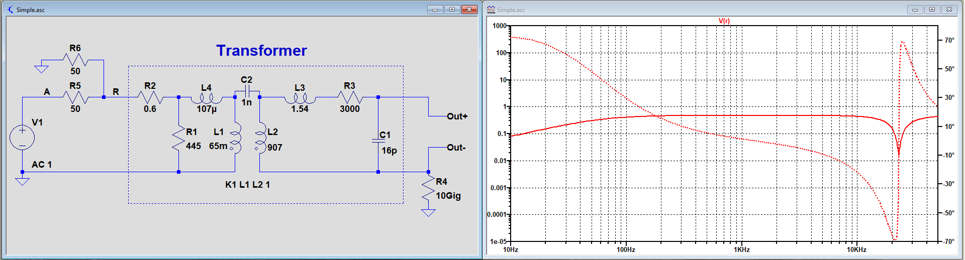

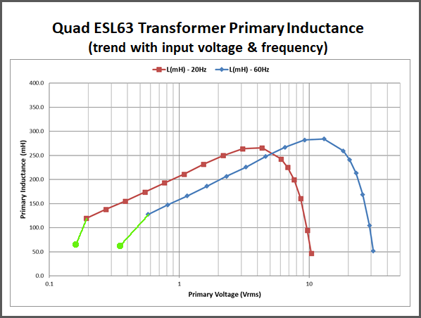

Because the inductance is dependant on the applied level, as Steve has shown, I placed the just created model in LTSpice in the same shunt setup as Demian used with his Bode 100.
Result can be seen in the first image below.
At 20Hz level is 150mV with 63mH and at 60Hz it is 340mV with 59mH.
Inserting these points into Steve's graph, shows that the differences aren't too big.
But it also shows that measurements in future with higher levels should be welcome.
Hans

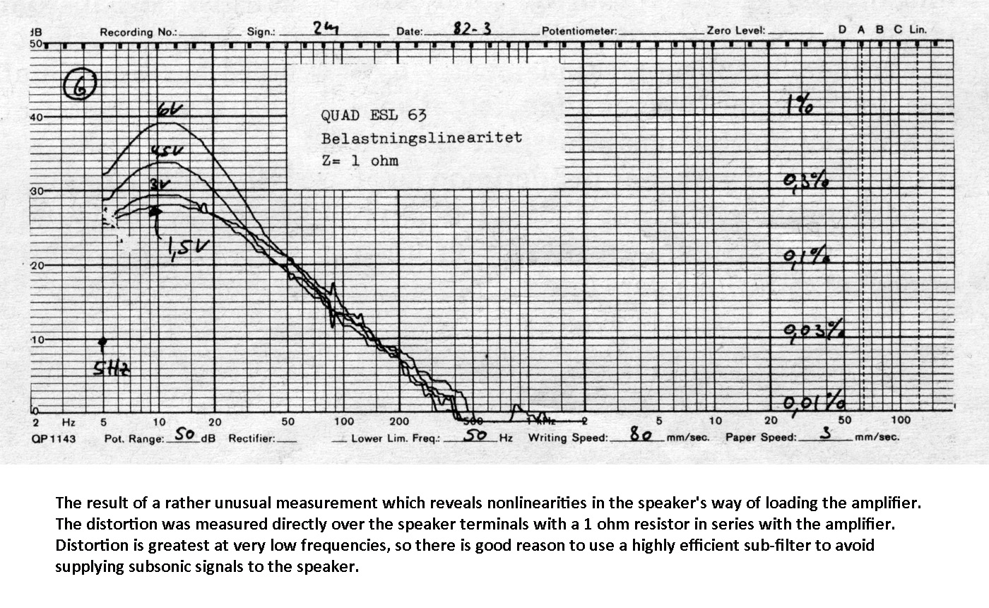

I have planned to redo the Danish test in the image below, because I have the feeling that their Amp was also to blame for part of the distortion.
You could do the same, so we can compare results.
Hans

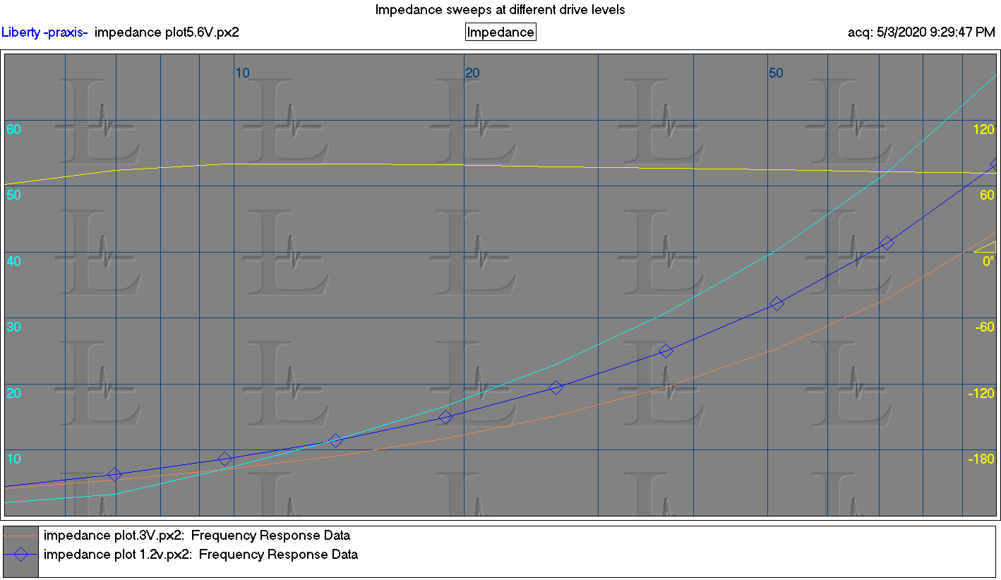

Amp is repaired (needed an LM12CLK) and I needed to add an output fuse (after 30 years!). A quick duplicate measurement to the one you posted shows significant distortion on the transformer primary at low frequencies which should be no surprise.
Attached are impedance plots at different levels, both graphic and as a table. On my test resistor there was no change with level so I'm reasonably confident in these numbers but there still may be some gremlins. The change in impedance with level may map to a change in distortion with level.
I'll post the distortion plots tomorrow.

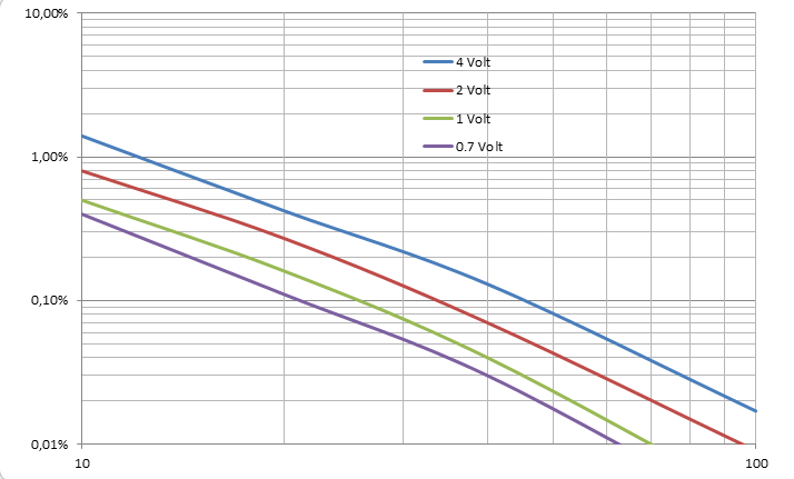

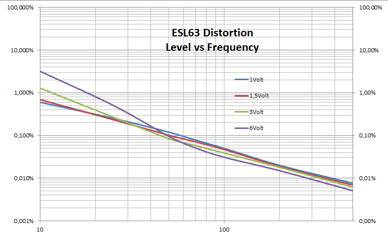

Here are the measured distortion figures of my ESL 63, measured the same way as in the Danish test in the first image below.
I have the impression that their system had a rumble filter, because in my system the distortion keeps going on below 10Hz.
The main cause why the distortion increases below 50Hz with 6Volt applied, is that H2 starts to take over the dominant distortion level from H3.
From 50Hz to 500Hz, the largest distortion component is the 3rd harmonic.
Both graphs are quite similar, except the distortion at 10Hz@6Volt where my system shows 3% versus their test at 1%, most likely caused by the attenuation of their rumble filter.
Hans

It is surprising that distortion, when measuring this way, is only dependent on frequency and not at all level dependent.
I think to have built a reasonable replacement circuit, but when simulating in the same set up as I just measured, results do not correspond.
Most notably is that the measured curves are having a slope of 20dB/dec while with LTSpice I get 40dB/dec slopes that are also level dependent.
No idea what is causing this difference.
Hans

I suggest checking the harmonics that your model produces. If your model is symmetric then it will only produce odd harmonics. The third order harmonic will fall at 40 dB/dec whereas second order will fall at 20 dB/dec.
Second harmonic will occur when the magnetisation curve is assymmetric - perhaps there is a dc current flowing or residual magnetism in the core.
R

Here are the HD2 and HD3 measurements vs level for 10 Hz to 100 Hz. The actual signal levels are quite low so they may be compromised by noise but you can see the trends. There is a lot of data to manage so I think the table will be the most useful.
HD2 seems to be close to the effective residual on all the measurements. HD3 does change with level.

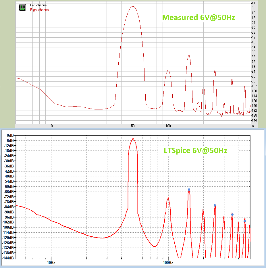

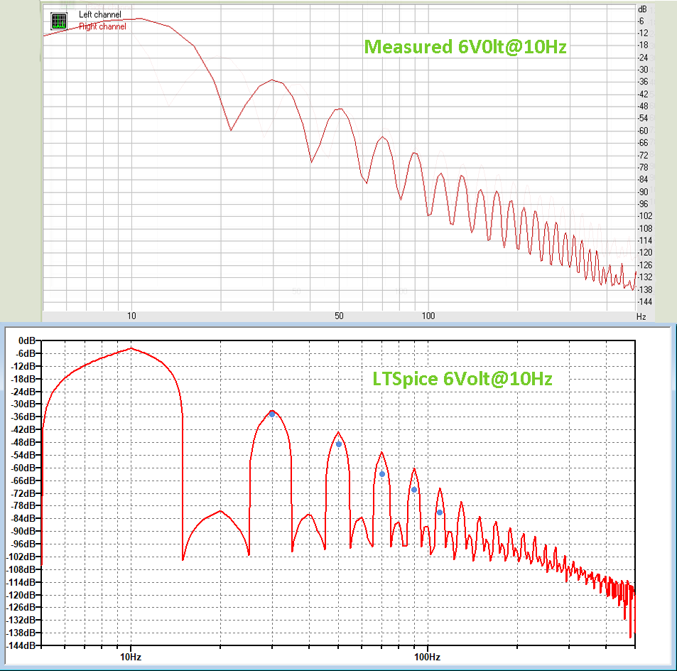

I was wrong with HD2, I misread the data.
In all cases HD3 is dominant.

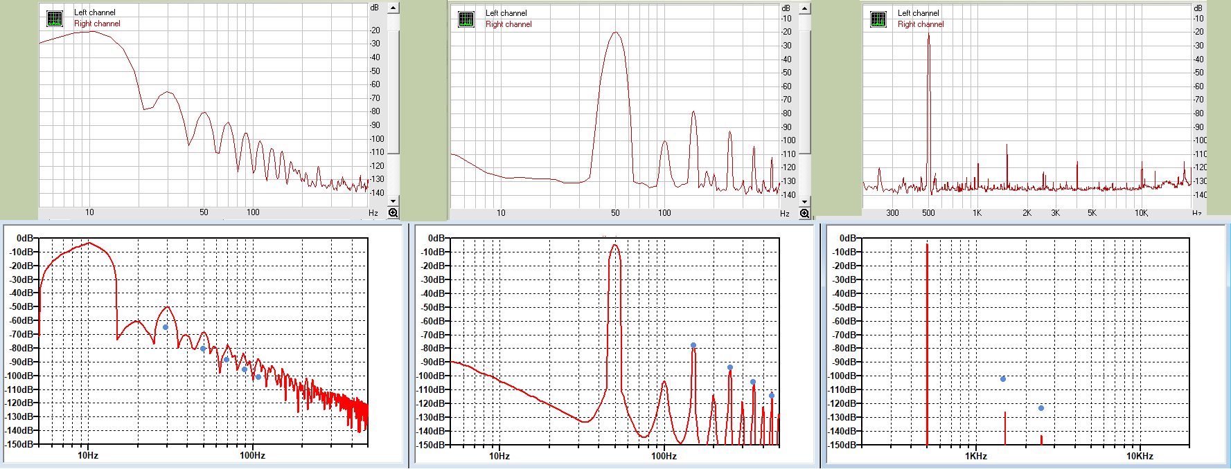

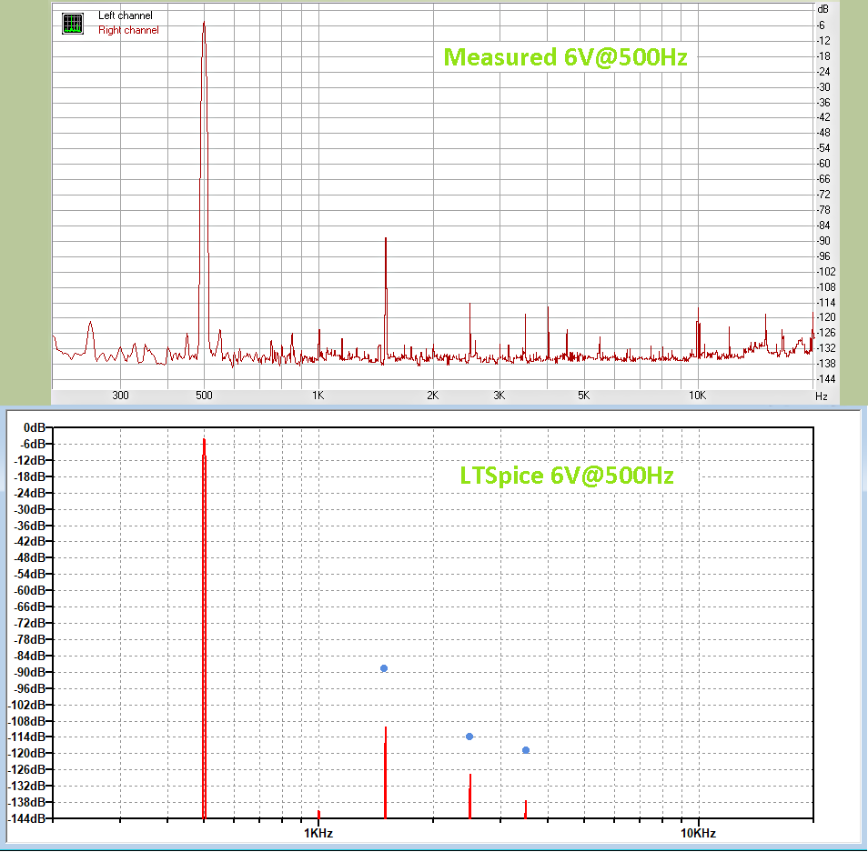

Below 3 images comparing measured vs LTSpice spectra, all taken from the same 400mSec window with a 6 Vrms input signal.
Spectra from 10 & 50Hz are remarkably similar.
However the LTSpice graph at 500Hz has ca 15dB less distortion, although the ratio between the harmonics is still similar as in the measurement.
With blue dots I've marked for the uneven harmonics the measured value in the LTSpice graph.
Hans
