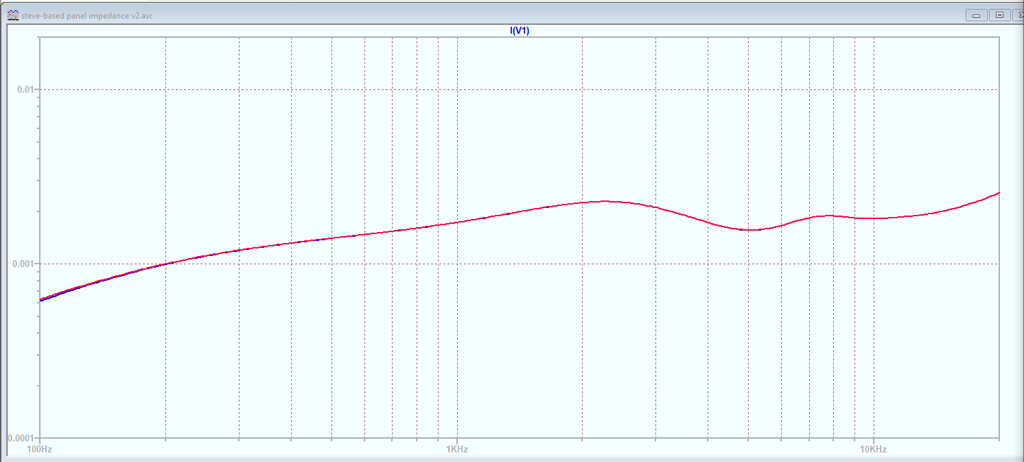

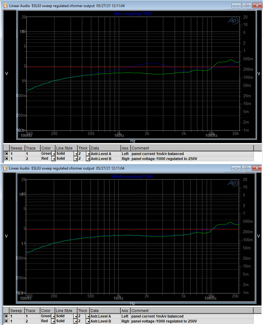

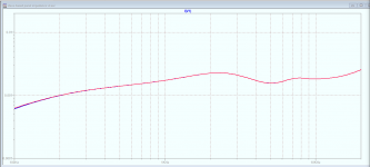

Sorry, the previous image was for a constant voltage from the Amp, giving 2*250V at 1Khz.
Here is the current for a constant 2*250V secondary from 100Hz to 20Khz.
Hans
OK, but this is still a reasonable confirmation that we're on the right path.
Thanks for this Hans.
One thing I have been thinking about is internal leakage currents in the transformers, but I don't really have an idea how that would look like.
And I still wonder why that 2.2kHz hump comes from.
Edit: I guess we use the same spice model for the panel ;-)

Jan,
Yes, we are using the same model, the one made by undersigned, except for the addition of a somewhat strange diaphragm resonance circuit.
Is there a specific reason why you want to go in more detail?
Your original goal was motivated as to find out how much current should be provided by your direct drive amp with no transformers.
Aren't these plots giving a pretty good answer to this ?

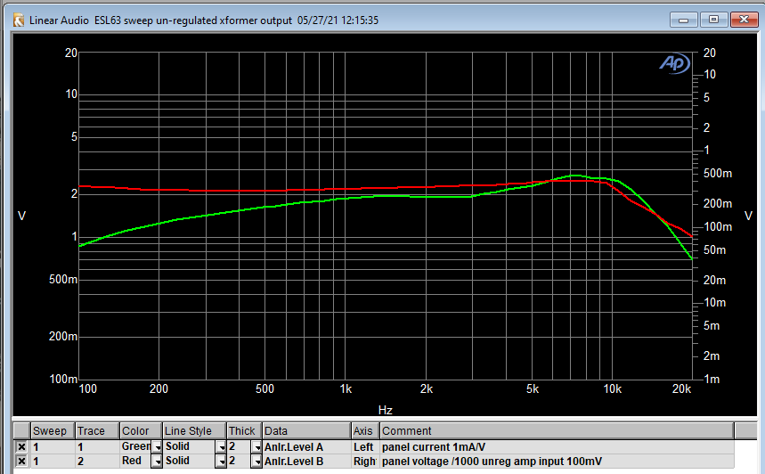

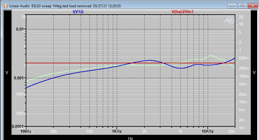

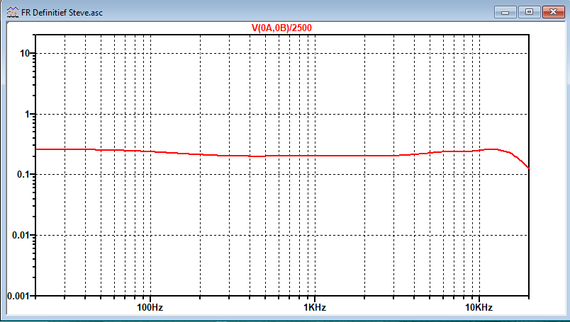

I have a bit of a problem with your voltage plots.
First image shows your voltage recording in red when driven from an amp.
Voltage has dropped from 350Volt@1Khz to 40Volt@20Khz, almost 19dB when I correctly read your plot.
When running the simulation in the second image, there is a voltage drop of slightly less then 4dB.
This wasn't just the outcome of the simulation, but was backed up by many real measurements made by Steve.
So something in your voltage measurement is not correct.
The current on the other hand that you have measured does correspond quite well with the simulations for this situation as shown in #280, so nothing seems wrong with your ESL.
Hans

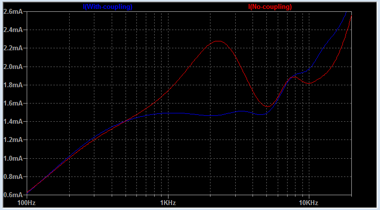

…And I still wonder why that 2.2kHz hump comes from.
I believe the 2.2kHz hump in the modeled current is due to lack of including 2nd order parasitics in the model. The most prominent would be the stray coupling between the air-core inductors used in the transmission line which are placed quite close to each other. I seem to recall either Baxandall or Walker making mention of the coupling as have a smoothing effect. To test, I took the model Hans Polak developed and added a small amount of coupling (k=0.3) between adjacent inductors (1-2,2-3,3-4,4-5,5-6), and even smaller amount(k=0.1) between ever other inductors (1-3,2-4,3-5,4-6). I based these coupling factors on measurements of some 1mH aircore inductors of similar size and shape when spaced per the ESL63 PCboard.
Attachment #1: You can see that this does indeed flatten the hump in the current curve
Attachment #2: Multiplying current by 1000 to represent voltage measured across 1Kohm in your measurement setup, a visual overlay with your plot from Post #279 shows much improved agreement.
(top is no coupling, bottom is with coupling)
NOTE: I’m not saying the k-values I used are correct, but I believe based on my measurements they should be representative. I was mainly interested in seeing if this small amount of coupling would move things in the right direction. Another indication that this coupling is on the right track, is that the modeled impulse response at the segments now have the pre-ringing seen in the measurements shared in Post #19
@Hans Polak,
If you incorporate this stray coupling into your model, the minor midrange hump in your modeled response shown in Post #265 should flatten out to match measurement even better.

Hans, yes good catch. What I haven't done is to look at the amp output with constant input. It's an nCore class D module that I use as a test amp. I will look into that, but it will take a few days as I'm going to spend a few days at the beach ;-)
OTOH, if the current looks OK, the voltage should also be OK.
Jan
@Hans Polak,
That's great Stephen, we get another step closer to match simulation to measurements!
Jan
