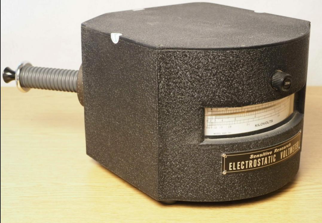

I have been looking at electrostatic voltmeters (the non-contact type Frank) but it's not clear whether they measure DC or AC or both, or whether there are different types for AC and/or DC. There's almost no data on the Trek units to be found.

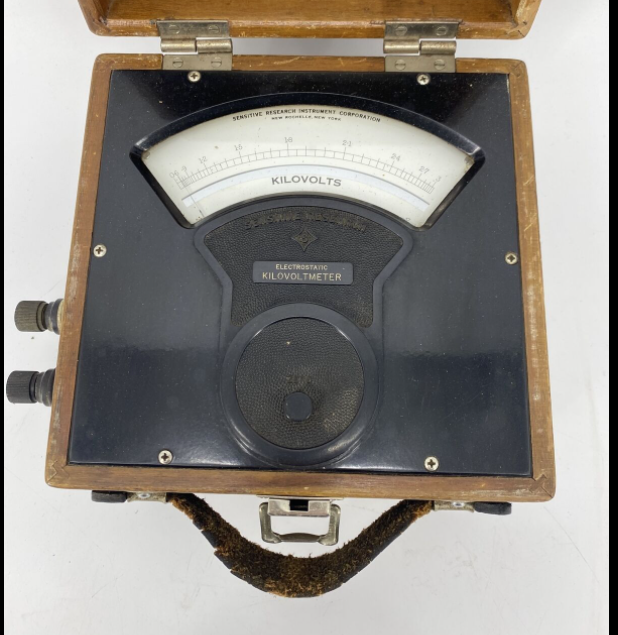

That's a high voltage probe that needs current from the HV. An electrostatic meter sense the electrostatic force and uses no current. You need one to check the bias supplies. I have several- 300V good for condenser mike bias supplies, 5 KV for Quad bias supply and one of the ESH that goes to 30 KV. I have collected these over many years. They are also AC/DC and accurate to 1 MHz. Not that I want to be anywhere near 30 KV at 1 MHz. Here is a little more (but inly a little) Electrostatic voltmeter - Wikipedia
That's useful! I was also looking at the 346 and 347.
Some of these have a monitor output useful for signal processing, but they are also very slow, like 25mS to go from 0 to 2kV. But that can be solved in the sweep setup.

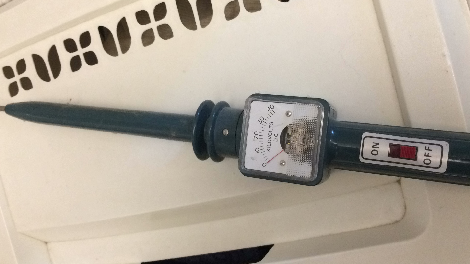

The surface charge meters seem pretty common on eBay. Lots of copiers needed them. And they can be pretty cheap. However I can't say of they are useful for measuring a bias supply. And no AC.

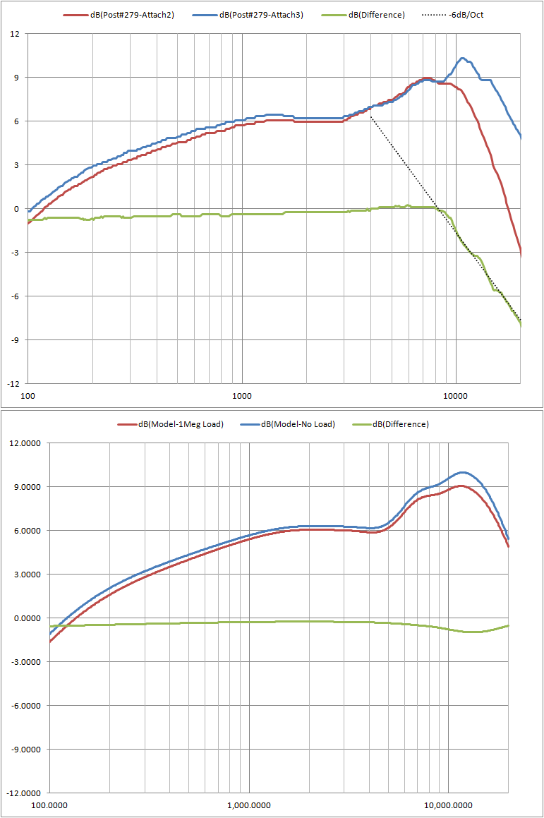

I don’t think the 1Meg load is a particularly significant load for the transformers, and a resistive load should not change the slope of the HF roll-off. Taking the 2nd and 3rd measurements from Post #297 and importing them into Excel using VituixCAD curve tracer, you can overlay them and compute a difference. This is shown in the upper plot of the attachment. You can see there is the expected 0.5-1.0dB decrease from the 1Meg loads, but above 10kHz, there is an abrupt change to a downward -6dB/Oct slope. The lower plot show LTspice results for the same measurements. LF trends have good agreement, but there is no abrupt change at HF.…there must be another reason for the 19dB drop at 20Khz. The 1Meg load places a significant load on your secondary...
It is possible that there is some capacitive loading from the probes (usually ~100pF – 200pF to ground), but since you are measuring across a 1k resistor this doesn’t seem likely. More probable is the possibility of some common mode errors that 1audio mentioned in Post #274, especially with the primary and secondary of the transformers sharing ground runs. Perhaps 1audio can suggest some tests for isolating this contamination.

Nice analysis with the 6dB roll off.
You get the same ca. 8dB@20Khz in current difference between the two curves as I got in post #305.
I cannot think of any way how this can happen with such a sharp transition.
