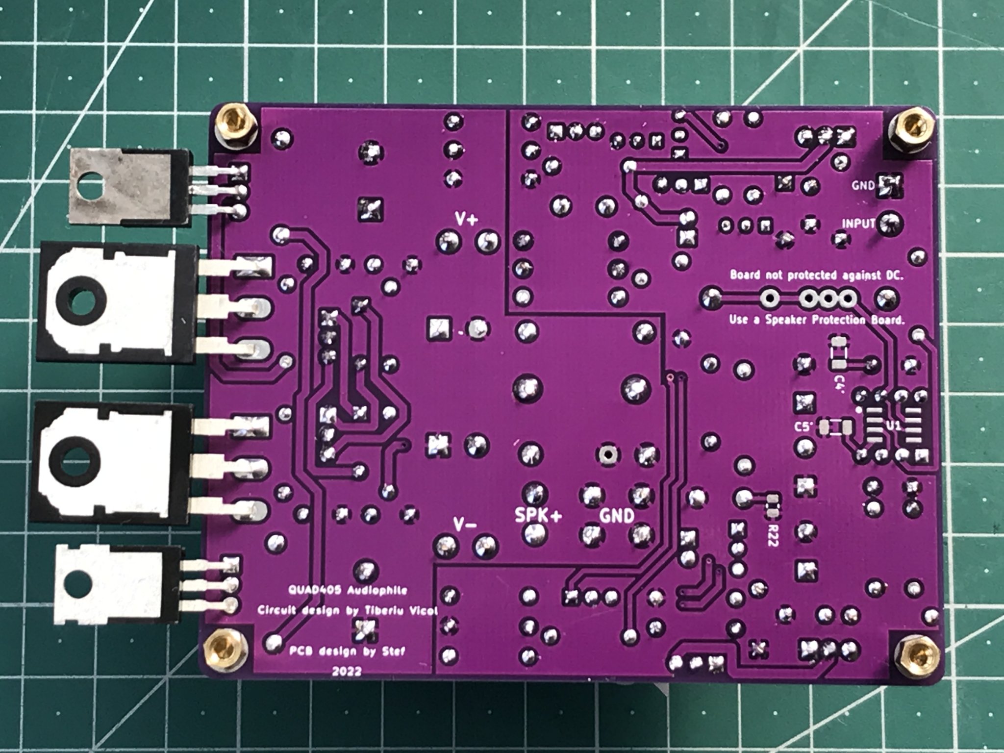

My reasoning is if quad make amps work in this way to be able to drive the esl’s with a margin of safety why are we not looking to include this in the mod. Surely many 405-2 mod’rs looking for the best will have what is questionably one of the best affordable speakers sh (ESL63’s) to listen to the best version of this amp.
It’s a bit like saying let’s rebuild a mustang into a Shelby but not upgrade the breaks cos we only ever want to drive fast, not stop. And if we crash we can repair the damage after! !
I could build external relay protection, but it isn’t the same as effective current limiting. Perhaps help identifying the required circuitry and how to include this effectively would appeal to some builders as an option?

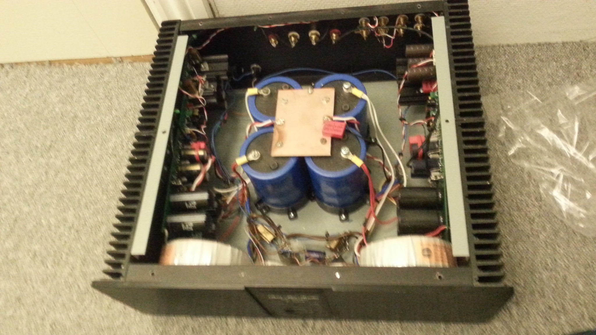

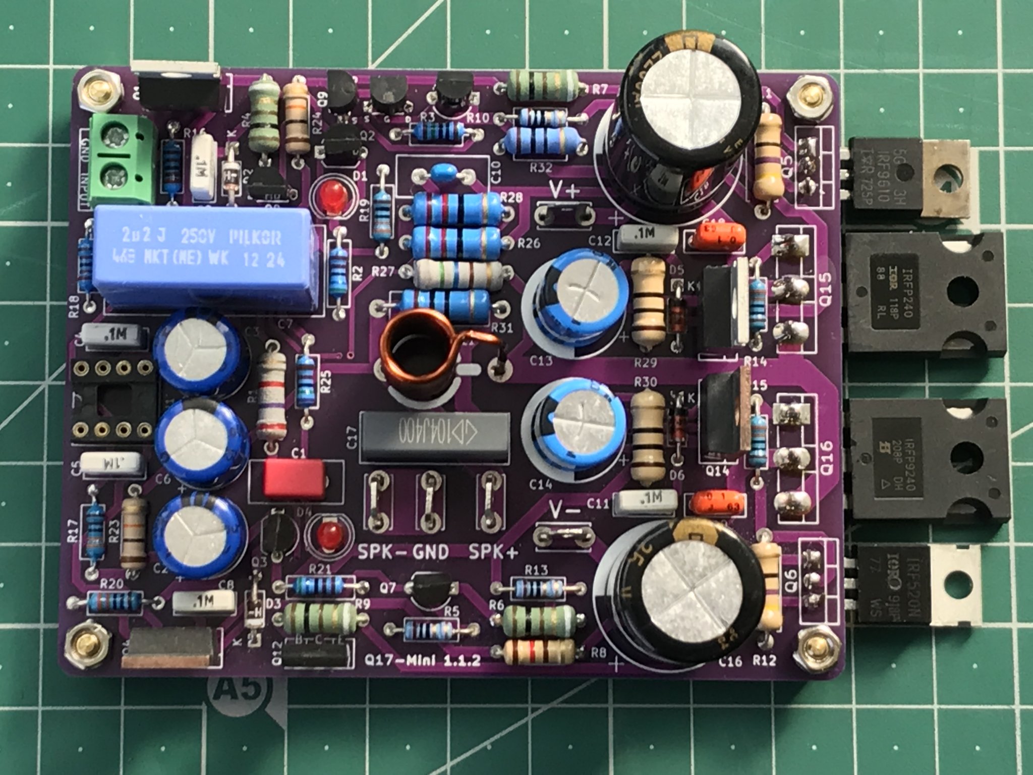

1.1.2 pcb version. Finally finished. Excellent sound. Thank you to those who contributed.

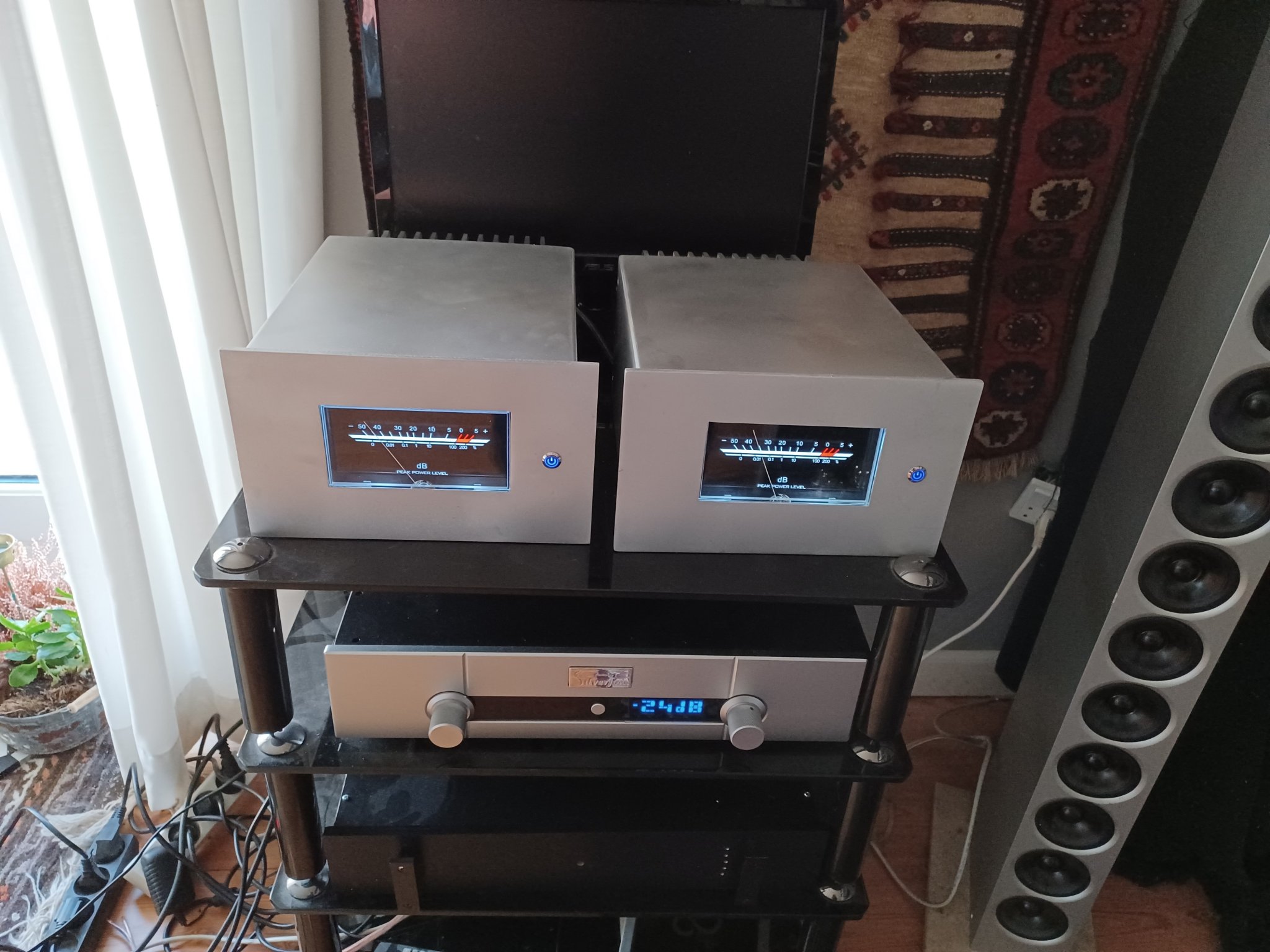

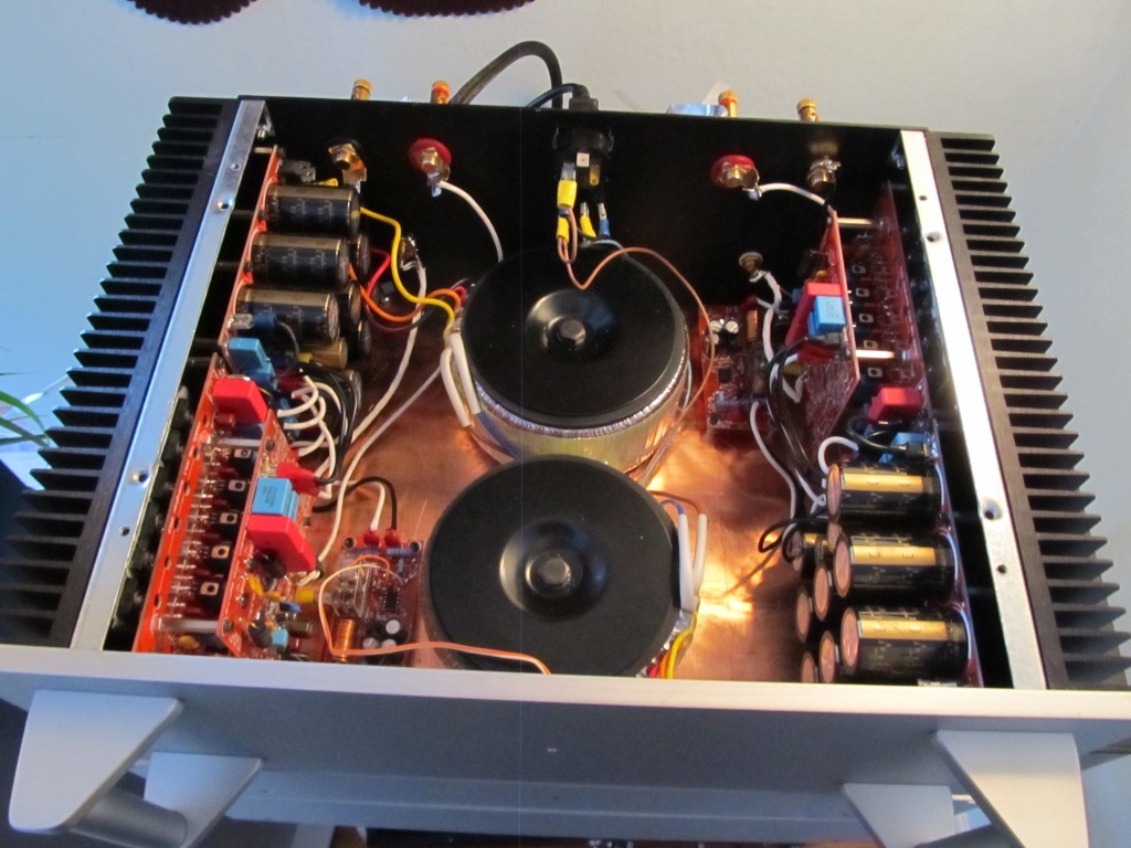

Hi Tibi
Finally my two Q17 are finished, well I need some additional mechanical work, but the electronic is working.
A lot of trials and tribulations though, but nothing to blame the Q17 or you.
First the substitutes for 2sc2240/2sa970 had different pinouts. I know you said that should be checked , but I forgot. I always use a vario transformer to slowly start up new circuits, so no smoke...
I had some original 2sc/2sa that I used instead. Still the amp didn´t work. After a lot of measurements and head scratching, I came to the conclusion, that the BS250 didn´t work properly.
Mouser did not have BS250 so I sourced them from another supplier. A Chinese source. I shouldn´t have done that! It turned out that the BS250 they sent me was not MOSfets but bipolar npn transistors!!!
I was fortunate enough to find some BS250 in a Danish supplier and now the amp finally worked.
I finished the other channel and gave them a listen. Very promising indeed! I use a DSC 2.0 with potato chips and reclocker and with lifepo4 batteries as PS. Suddenly one of the lifepo4 ran out of charge and the DSC 2.0 went into a stage where it sent out full level digital noise!. That killed the two Q 17 ;-(
Now finally I changed all the defective parts and the amps are working again. I changed the PS for the DSC 2.0 to a traditional(but high quality) PS and it performs actually even better now.
I must congratulate you with your work on this amp. They are truly great! On an overall basis the best I have made! And I have made many:
Almost all of the PASS designs
FetZilla
Fet circlotron
RMI-FC1000 single stage amp by Roender
A Goldmund Telos 350 clone (a powerhouse and still delicate. Beats the Q17 in sheer power and is very good sounding )
My_ref Fremer edition (at first I thought this was great, but in the long run boring an artificial)
An OTL with 6C33 tubes (a near clone of the Novacron from Atmasphere) 2X60 Watt out , but uses 700W constantly to produce that. . The OTL is not a traditional sounding tube amp, because of the missing transformers. It has powerful and precise bass and is very transparent.
And a lot of others, that I don´t recall right now
The OTL has been my preferred amp for quite a while, but Q17 will replace it now.
The thing is that the Q17 has all the best from Goldmund and the OTL. It has the same way to make the instruments sound real as the OTL and it has the crispness and HF extension of the Goldmund and NEVER sounds harsh. Bravo! And thanks. Now I can listen to music without being in a sauna. And I don´t have to wait half an hour before the sound is great!

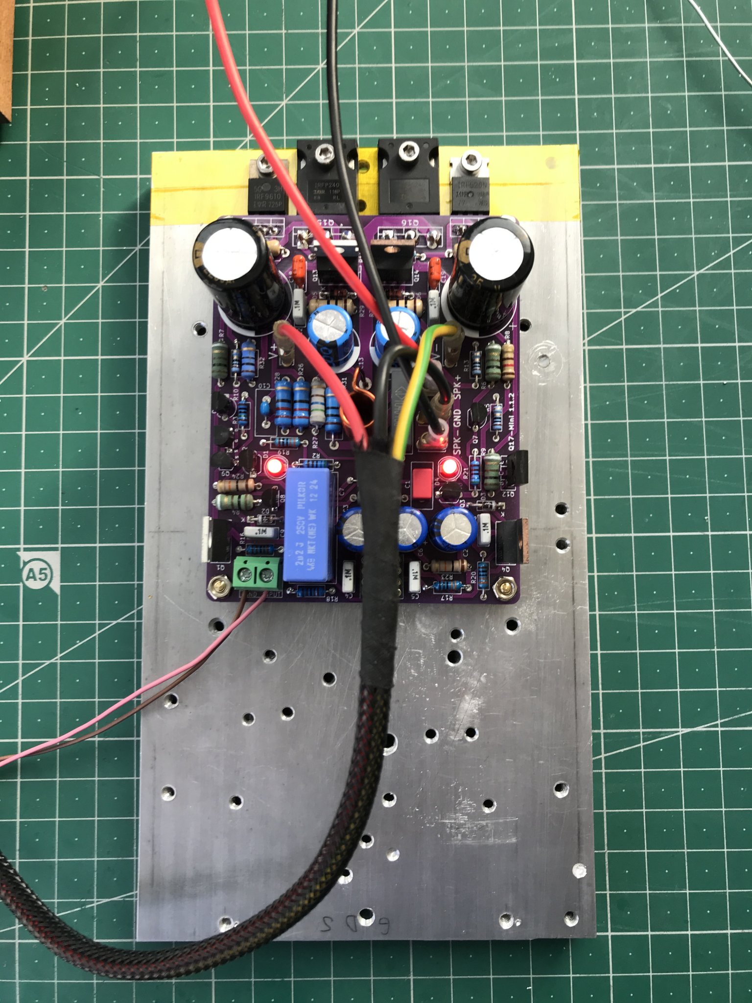

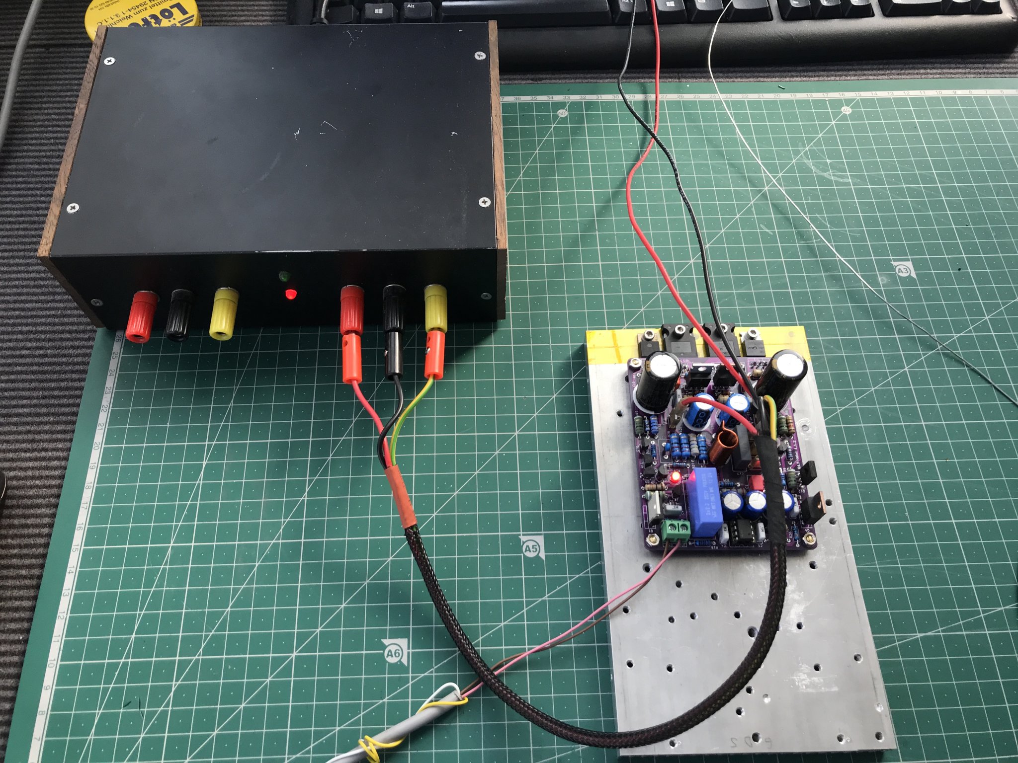

I can only speak for myself, I started with the original, had problems with soldering the tiny details and with oscillation of the amplifier. Therefore, I have developed this further, tried many individual details, made many mistakes and from time to time recorded successes. Now I am in the process of polishing the sound image to high gloss, this may be pointless in many uses of the amplifier, but it is a challenge for me and gaining insight into the relationship between technology and subjective acoustic perception.

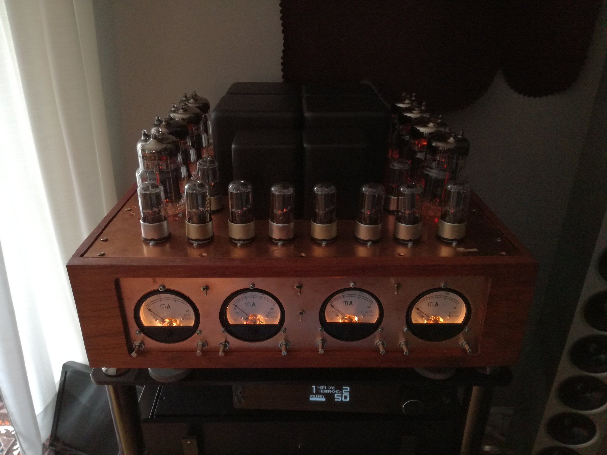

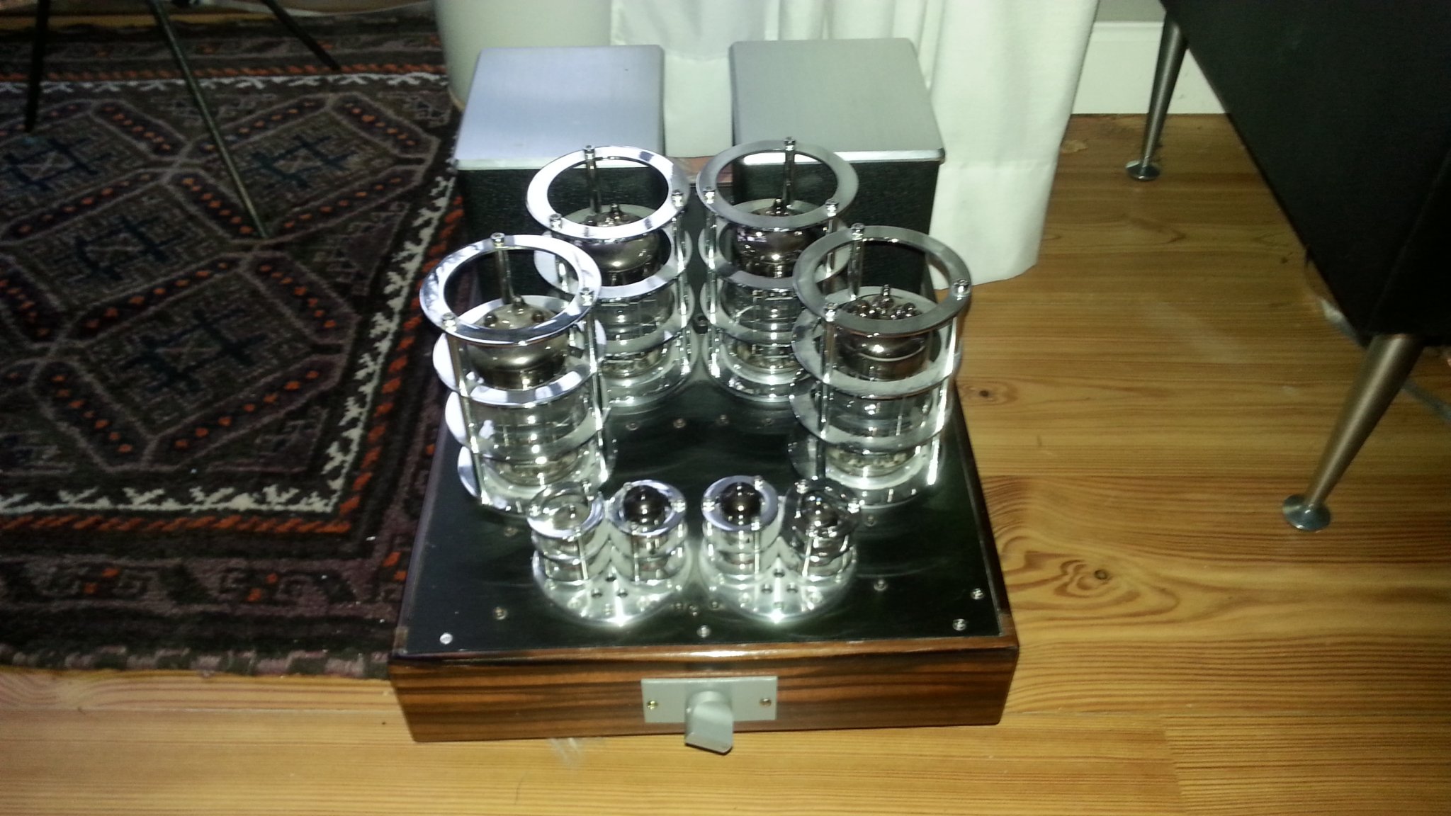

Here are a few of the amps I build
