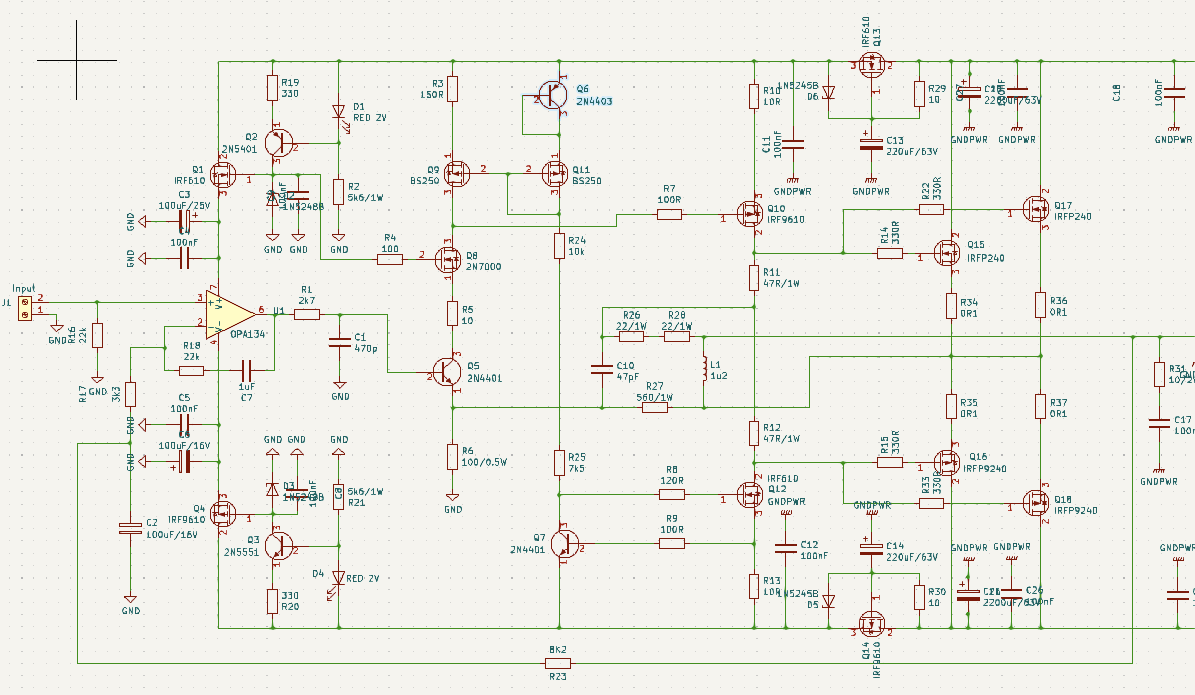

This is normal. I have a slightly warmer channel on my amp as well. To get perfect simetric temperature operation you need to match Q12 on right/left channels and output mosfet's Q15 ... Q18 as well. But thanks to feed forward error correction this not matter much.
Regards

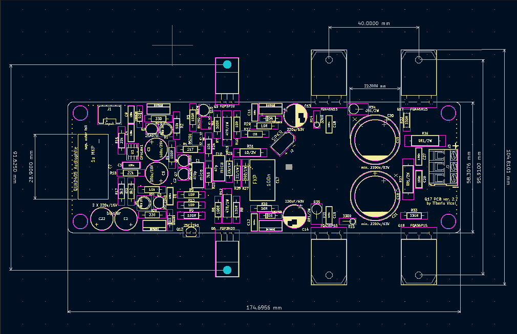

Hi Tibi,
I'm looking for a case that fits the boards, but I couldn't find information about the size of the boards (including the MOSFETs lying both sides on the radiator).
Alternatively, do you have a recommandation for a case?
I need sufficient ground space to host a 500VA toroid trafo (diameter 115mm).
Best regards
Christophe
Hi Christophe!
The lenght of the single output board is 155mm. 60mm wide.
The length of the double output board is 175mm, 60mm wide.
With the mosfets mounted, you can fit the amp on a 100mm high heatsink. (with suited bending of the mosfet's legs).
Succes with finishing the beauty!
Ed

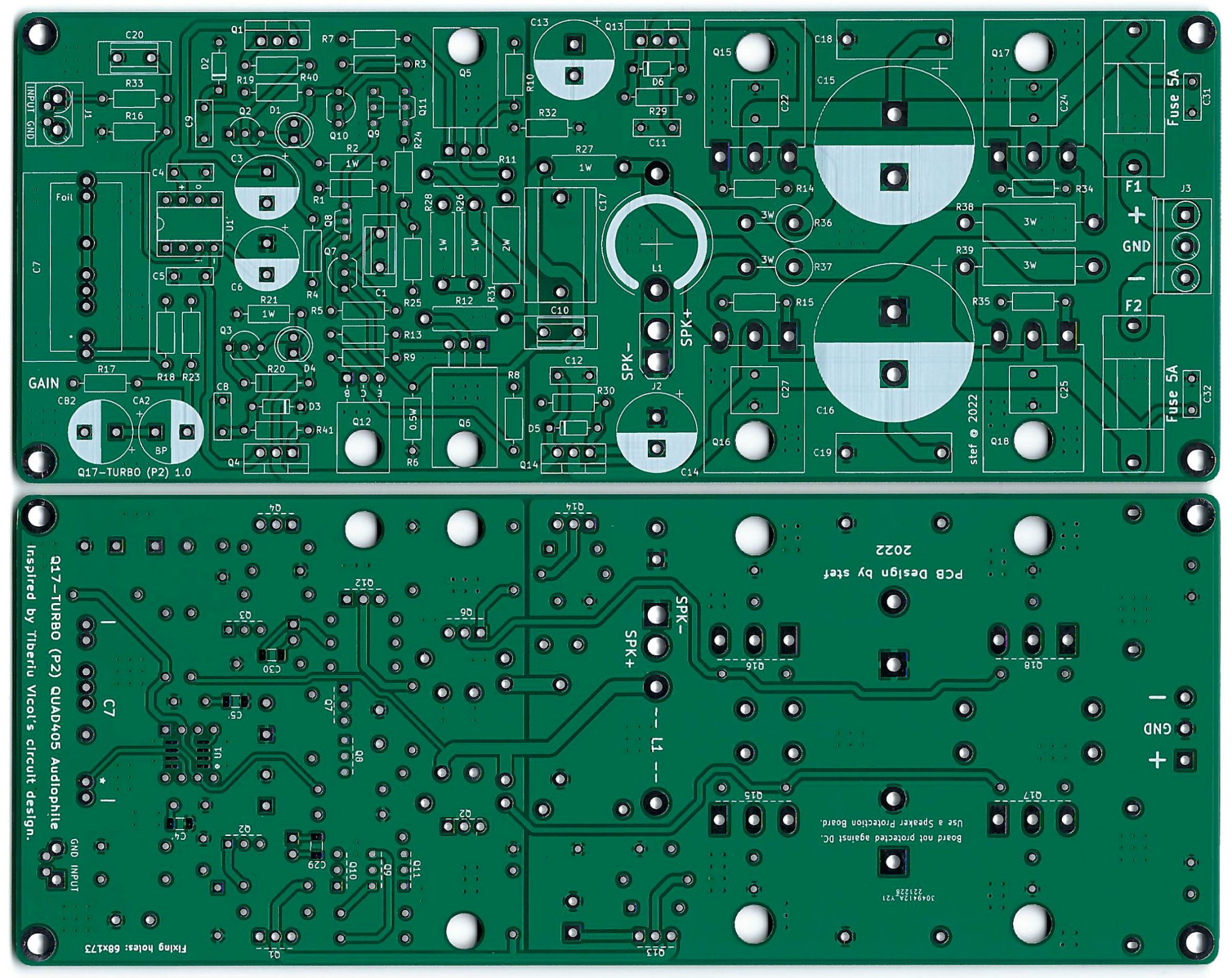

Hello,
Happy New Years everyone!
To celebrate the new year, I printed a new PCB design of the Q17 P2 that I called Q17 TURBO. This is my third attempt to build a working Q17 P2. Hope this new year will bring happiness.
PCB size: 190 x 75 mm
I need to find the time to assemble a board now. 😎
Steve.
