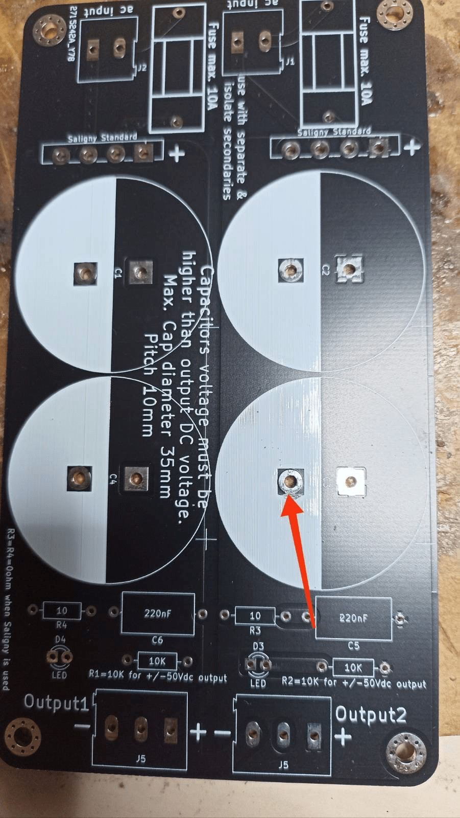

I noticed something strange on my Power Supply PCB's : On both still unpopulated boards I measure a full short between the plus and minus connections of C2 and C3 as well as the output of the associated bridge rectifier between plus and minus....... I have the Gold plated PCB's

Last batch of Active Power supply boards is bad and those who have purchased will get a replacement.I noticed something strange on my Power Supply PCB's : On both still unpopulated boards I measure a full short between the plus and minus connections of C2 and C3 as well as the output of the associated bridge rectifier between plus and minus....... I have the Gold plated PCB's
Please check if you have a short at positive rail, between V+ and GND. If so, then you have a board from latest batch.
Issue may be corrected by cutting the short as indicated in attached picture at C3 negative pad.
Apologise for trouble !
Brgds
