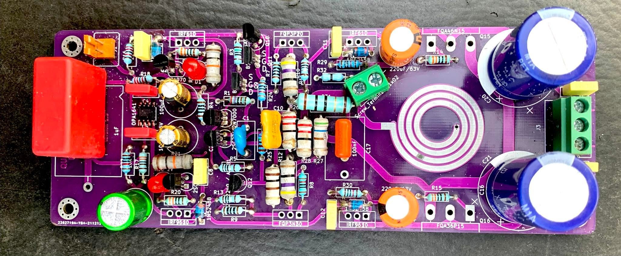

Who have tested this amp could you please comment about this Q17 amp sound? Comparing to FW J2, F5, Aleph J, UDNeSS v2 some other amp?
Do I need to make any changes besides transistor pin out order to use ECW20P20, ECW20N20 or MJL1302A, MJL3281AG or IXFK220N20X3, IXTK120P20T? What changes?

I can only speak for myself, I have now set up the 13th variant of the amplifier and am enjoying the sound to the full.
I recently heard one of the test candidates from my variant 12 on Ubiq Audio model one speakers, which is an acoustic delight. Previously, the speakers played on a Mark Levinson No. 383, which sounded a bit restrained. On the Q17, the Ubiq Audio model one played deeper, much more lively, ultra accurate - the localisation in the acoustic stage is sensational with these speakers, despite the richness of detail - the details became audible, or rather, it was noticeable what the Mark Levinson was muddling up - the amplifier was in top condition, only more is not possible there.
My friend has had many amps in the top league over the last few years, but his favourite is the Q17, which is the most fun he has listening to music.
Regards Tim

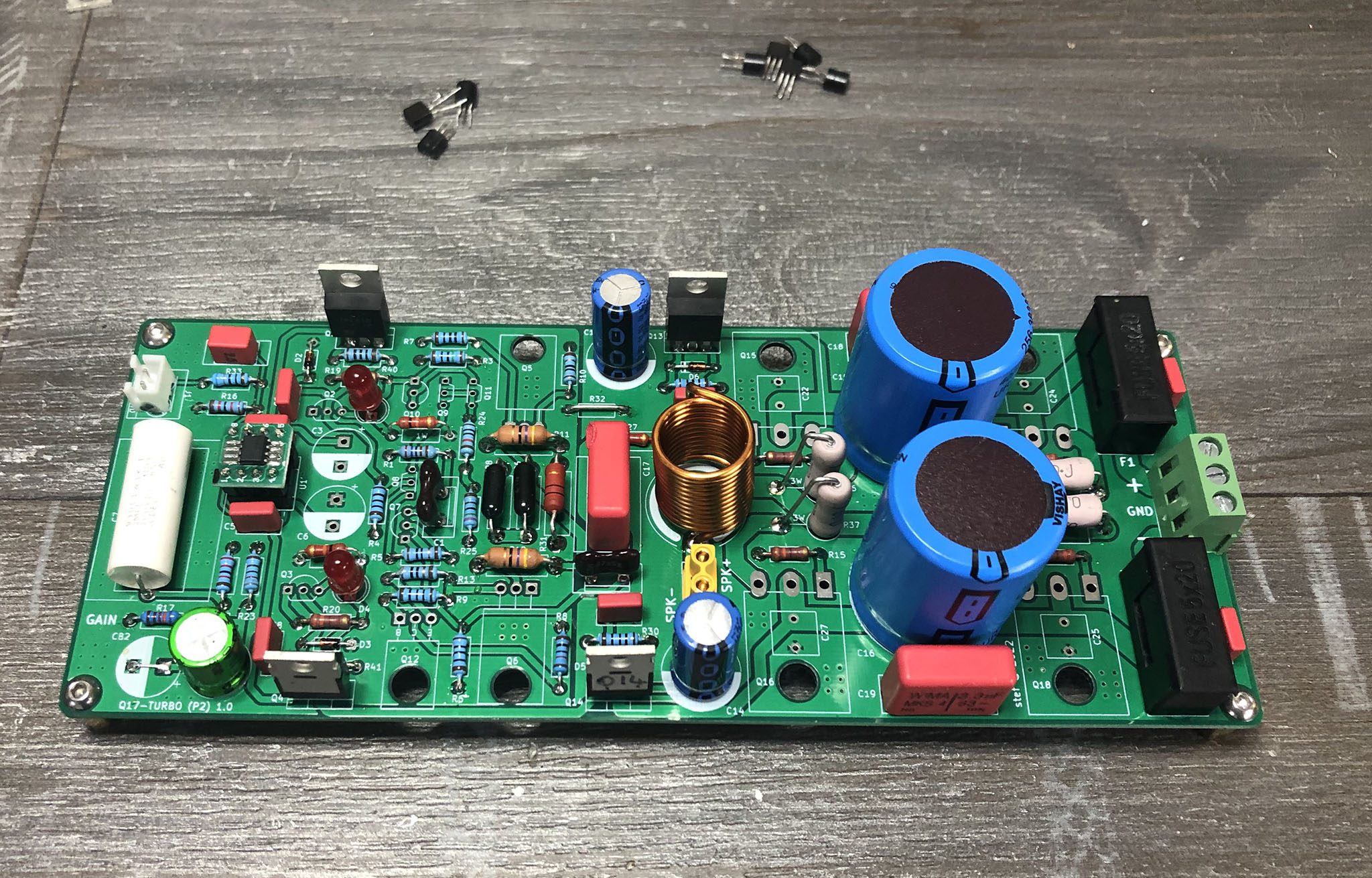

Hello!
Good news!
I plugged it on for few minutes and the Q17 Turbo didn't explode. I have zero DC offset. It consumes 18W idle.
I haven't done anything more so far.
Stef.
EDIT : no wobble et sinus is here. 😉

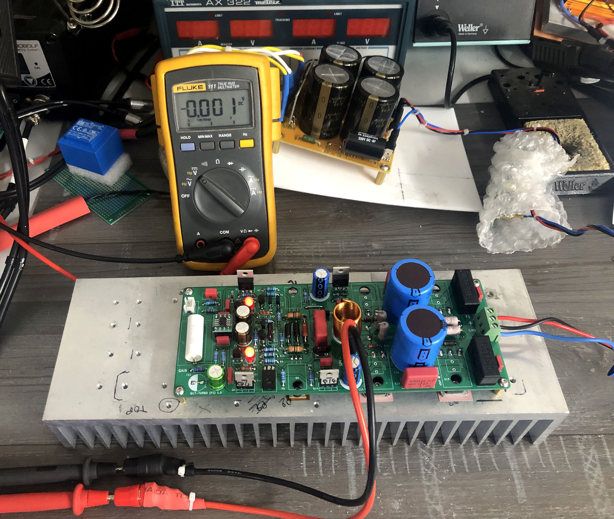

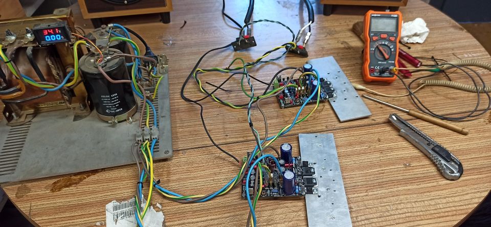

Good morning,
I have a problem with the new Q17 P2 prototype.
Apparently it works fine. I have zero DC offset and if I send a sine to the input with the generator, it's good on the scope.
However, I have a problem with the voltages.
I supply the board with 50V. On ignition, the voltage is 50V on the positive and negative terminals. After a few seconds, the positive voltage drops to 46v and the negative voltage increases. If I measure the negative it starts from 50V and steadily increases 50v, 52v, 55v, 60v, 62v. There I cut so as not to destroy anything. The positive falls to him in mirror with the negative. Consumption does not move around 18W.
I really have the art of coming across problems.
I have checked everywhere but I don't see any component errors at first sight. Each component has been checked before being welded.
Does anyone have any idea where the problem is?
Stef.

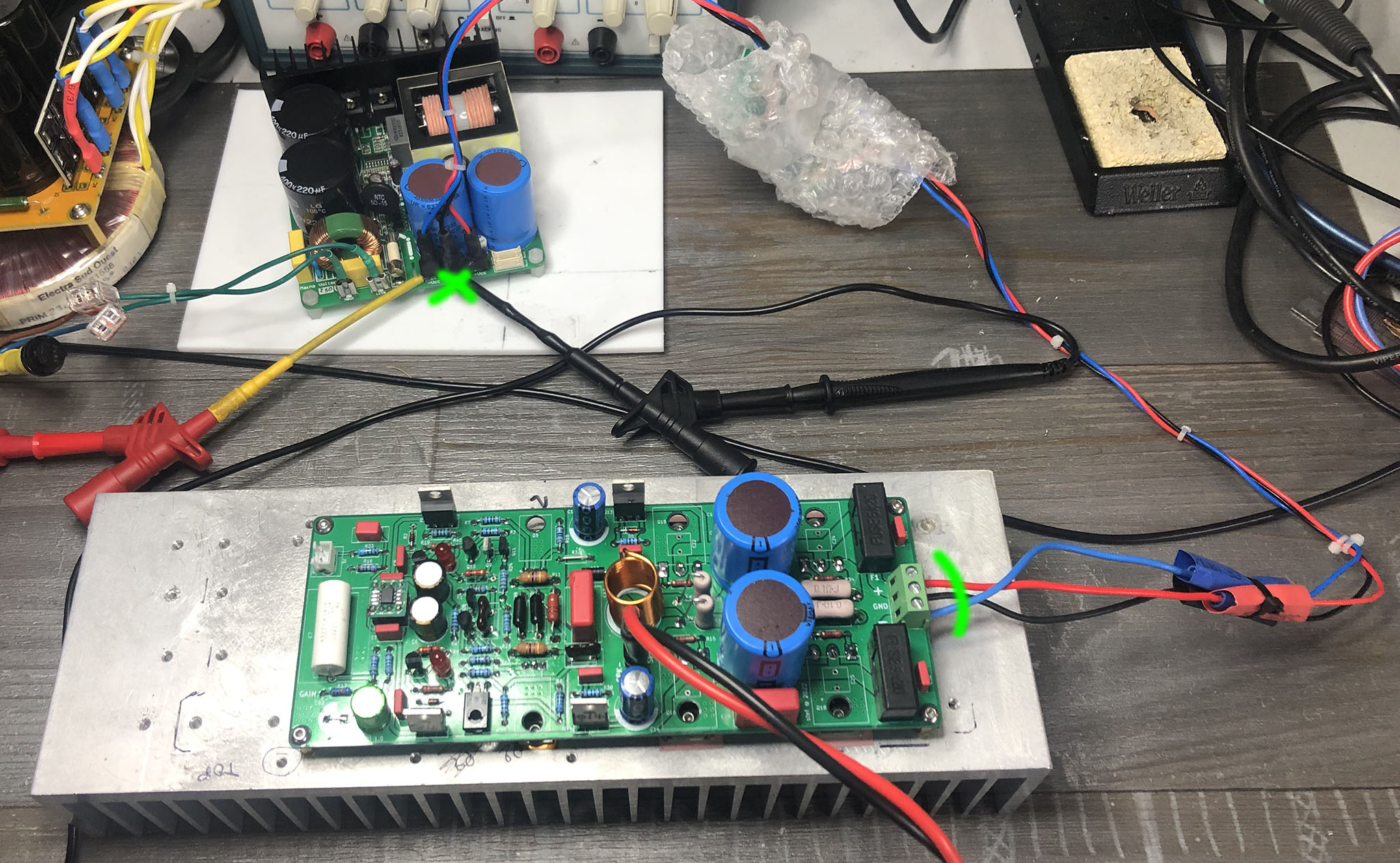

I've found. It is a measurement problem. I think it comes from a potential difference that falsifies the measurements. It's probably due to the length of the power cable. If I take the GND from the power supply, everything is ok. If I measure with GND at the connector terminals on the board, it's wrong.
I switched the board to a 60V power supply to do the final measures et test temp.
Stef.

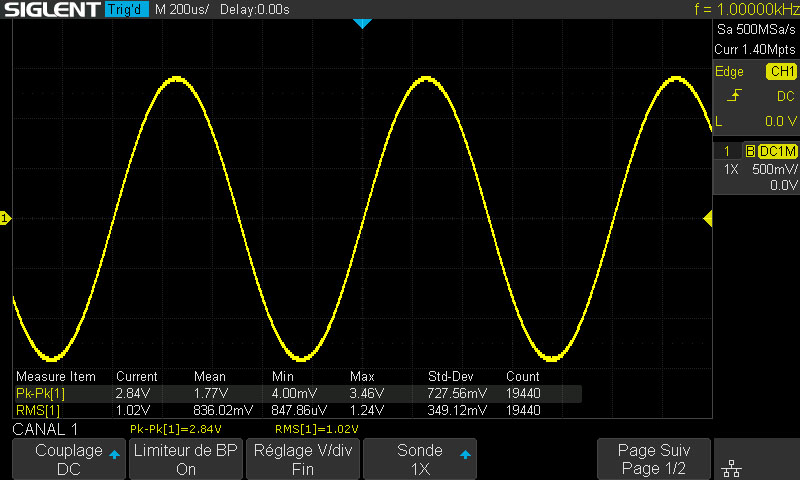

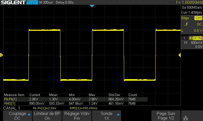

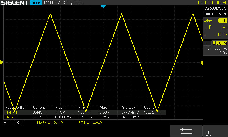

Some pictures at 53v.
R3 = 77mA
R13 = 62mA
Nothing very hot.
I leave it on for several hours like this to do an endurance test (with a 1vRMS output sinus).
Schematics is here : Q17-Turbo 1.0.
Stef.
