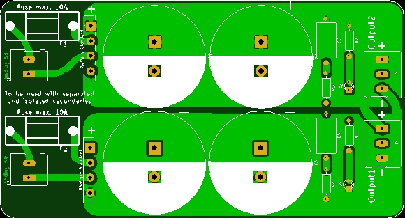

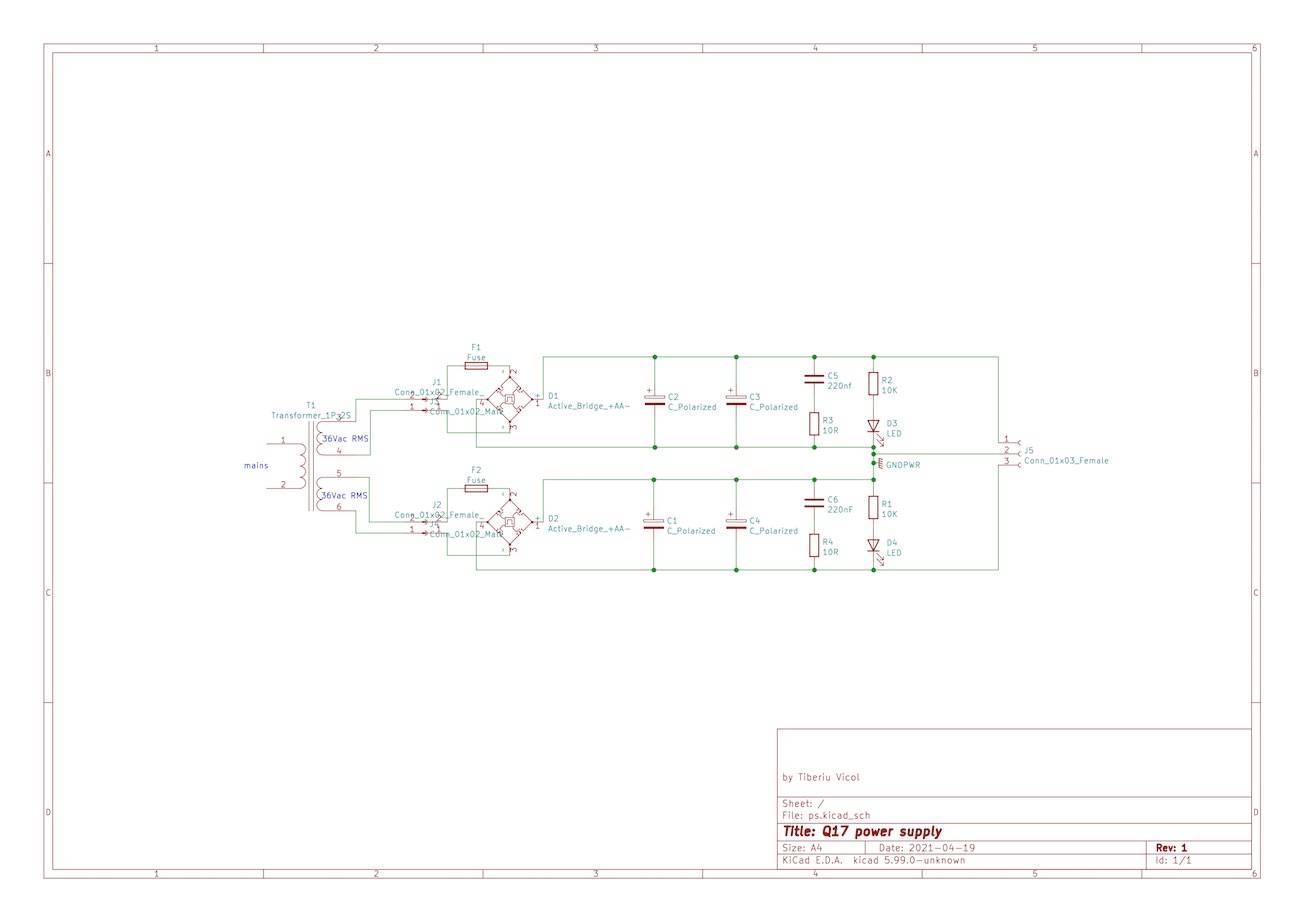

Archive contain everything. Full amplifier description and operation. Ltspice asc file for simulation. KiCad source for Q17 and his power supply. Gerbers zipped, so you may pick and drop on your favourite PCB manufacture. BOM with current active parts for Q17 and power supply.
Detailed description on how I made the PCB inductor and more, is also incuded in zip.
Inside zip:
LTSpice - contain asc file
ps - power supply KiCad source files
Q17 - amplifier KiCad source files
Spiki - inductor generator - python script to generate inductors in KiCad
Q17project_presentation.pdf - detailed presentation - bill of materials included
Q17 is on GitHub under GPL3 - Q17 is an open-source hardware project

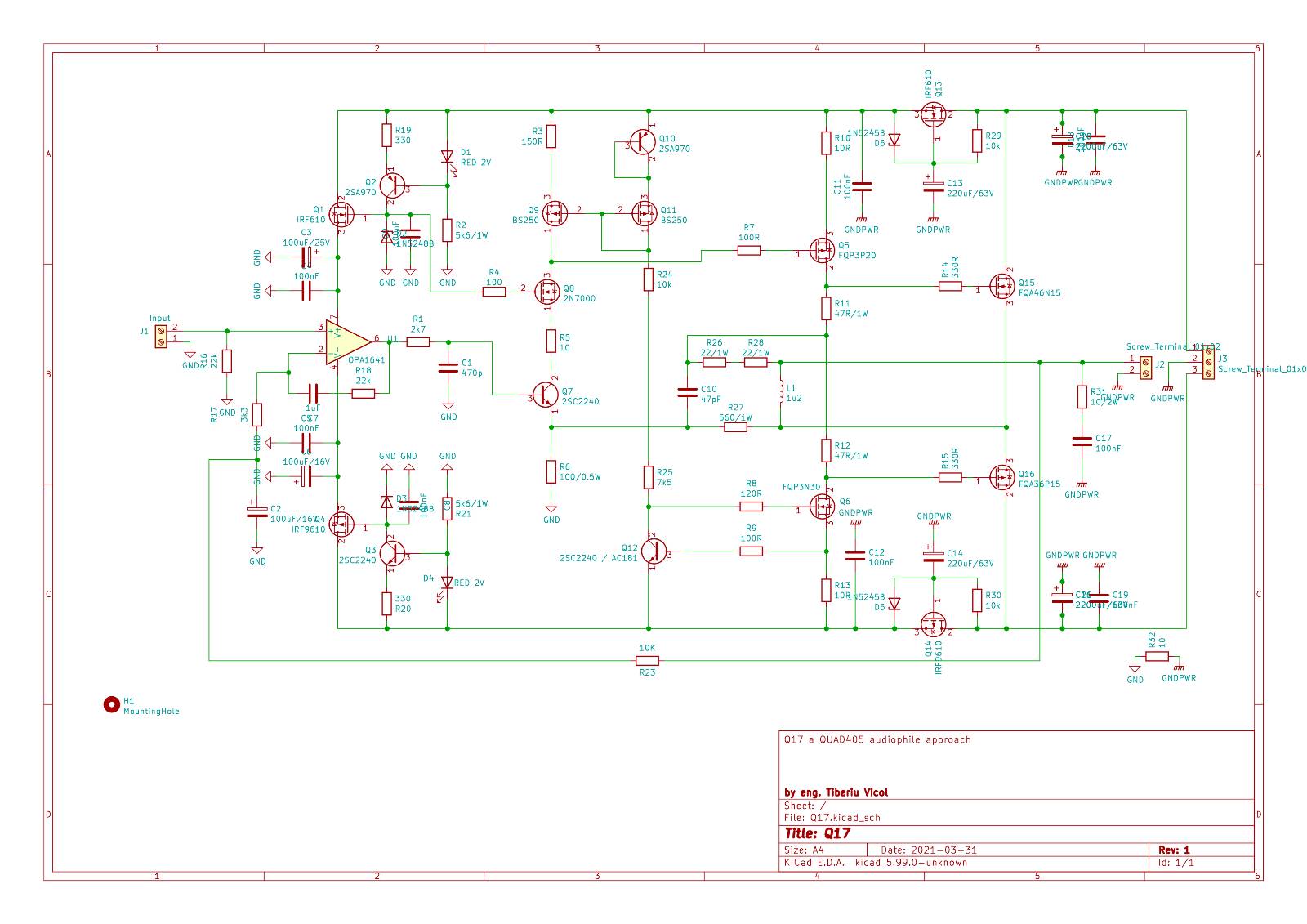

Nice! Still I would use a bipolar capacitor for C2, a DC blocking coupling cap and RC input filter at the input certainly with OPA1641.
Coincidentally I have a defective and mistreated 405 with 1 blown channel in front of me but do these boards fit in an original Quad 405?!
Reactions: Ton
Yes, a bipolar for C2 is the best choice and I mentioned this in my dissertation.
Q17 board will not fit original 405 boards, but design is open. Fell free to design your own.
Embedded coil will take some space and to preserve original 405 PCB layout this must be made with smd parts.
THT is more diy friendly, hence my choice.
Tibi
Correction on R29 and R30. These must be 10K instead 10ohm.
Also in class A stage formed by Q5 & Q6, instead IRF610 & IRF9610, FQP3N30 & FQP3P20 can be used as a better pair.
Tibi
@piersma I made measurements, but I did not record them as I care much more on how the amplifier sound. As soon I made a modification, my first thing to do is to listen and not measure. IMD/THD have only been simulated and you may use ltspice file to make you an idea. The single measurement for which I fire my scope is square at 10KHz or higher. As soon I have time I'll measure again and post here.
@chat72 The PCB in the first post was for prototype, therefore several issues have been corrected and since then it was 2 times partially redesigned. Even so, there is room for improvement, especially on component description.
Tibi

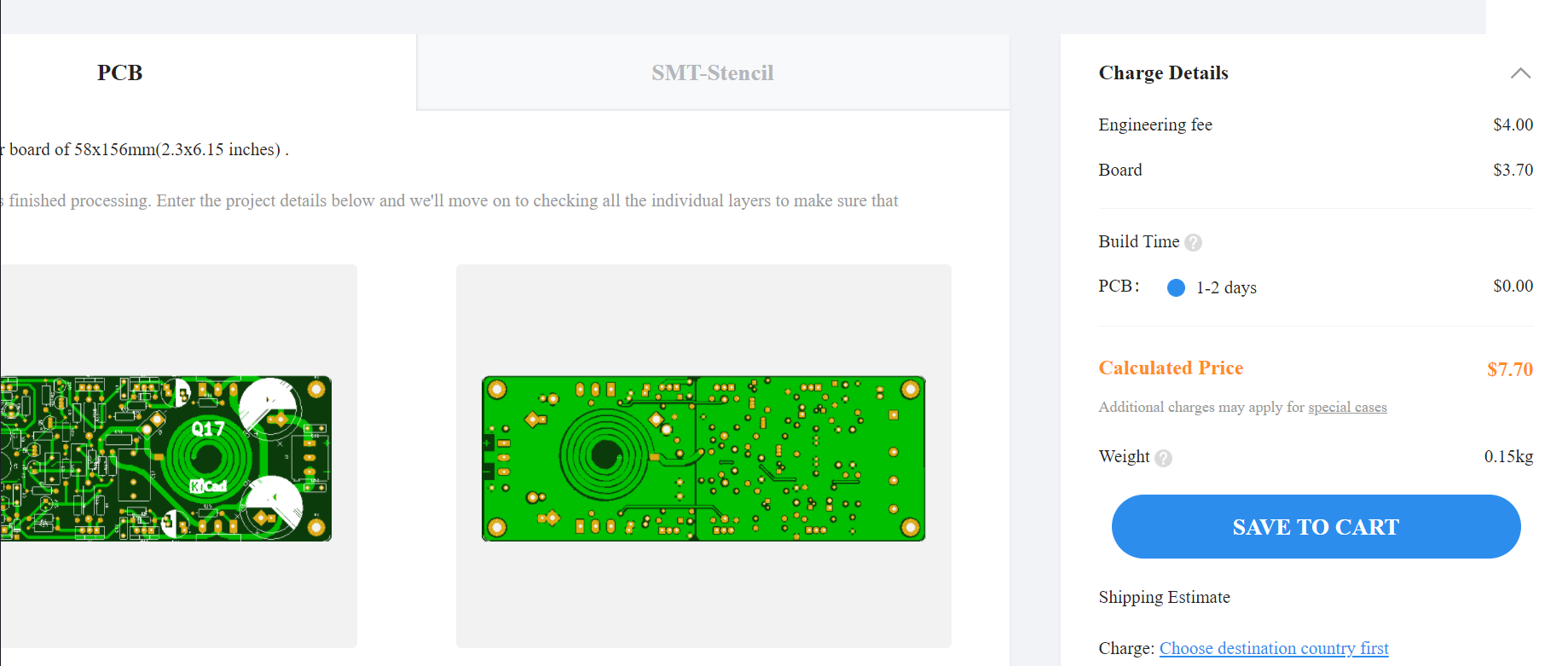

I do not sell PCB's. You may drop the gerber zip file on jlcpcb and get 5 boards for under 10$ including shipping to EU.
On other side, I know that someone in Romania started to redesign the PCB and will conduct a GB. If here is any interest in this this project, I'll ask him to post here as well.
I have OPA1611 in one of my dac's and is sounding very good.
If you like it, use it.
Tibi

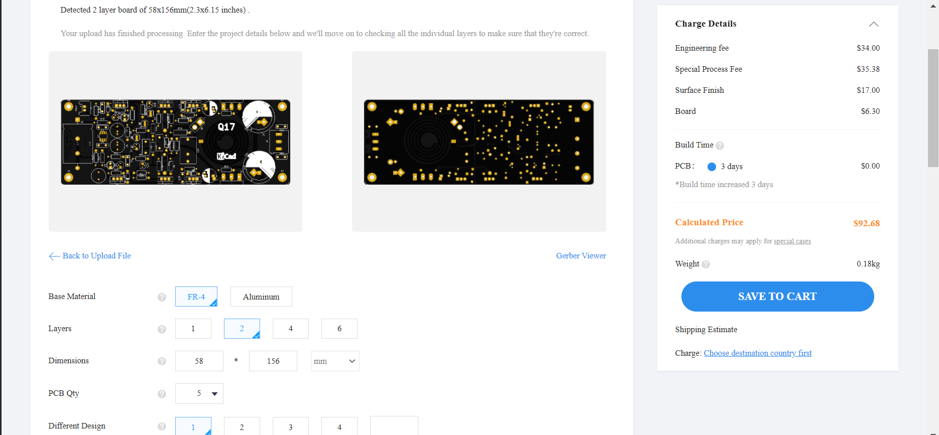

Inside Q17.zip, under Q17 directory, are another two zip files. One GerberQ17.zip for amplifier pcb and one gerberPS.zip for power supply.
Upload each zip file separately to jlcpcb. Jlcpcb will process one file at a time.
5 standard boards - 7.7$
audiophile boards with 2oz, enig, black finish - 92.68$ 😀
Tibi
