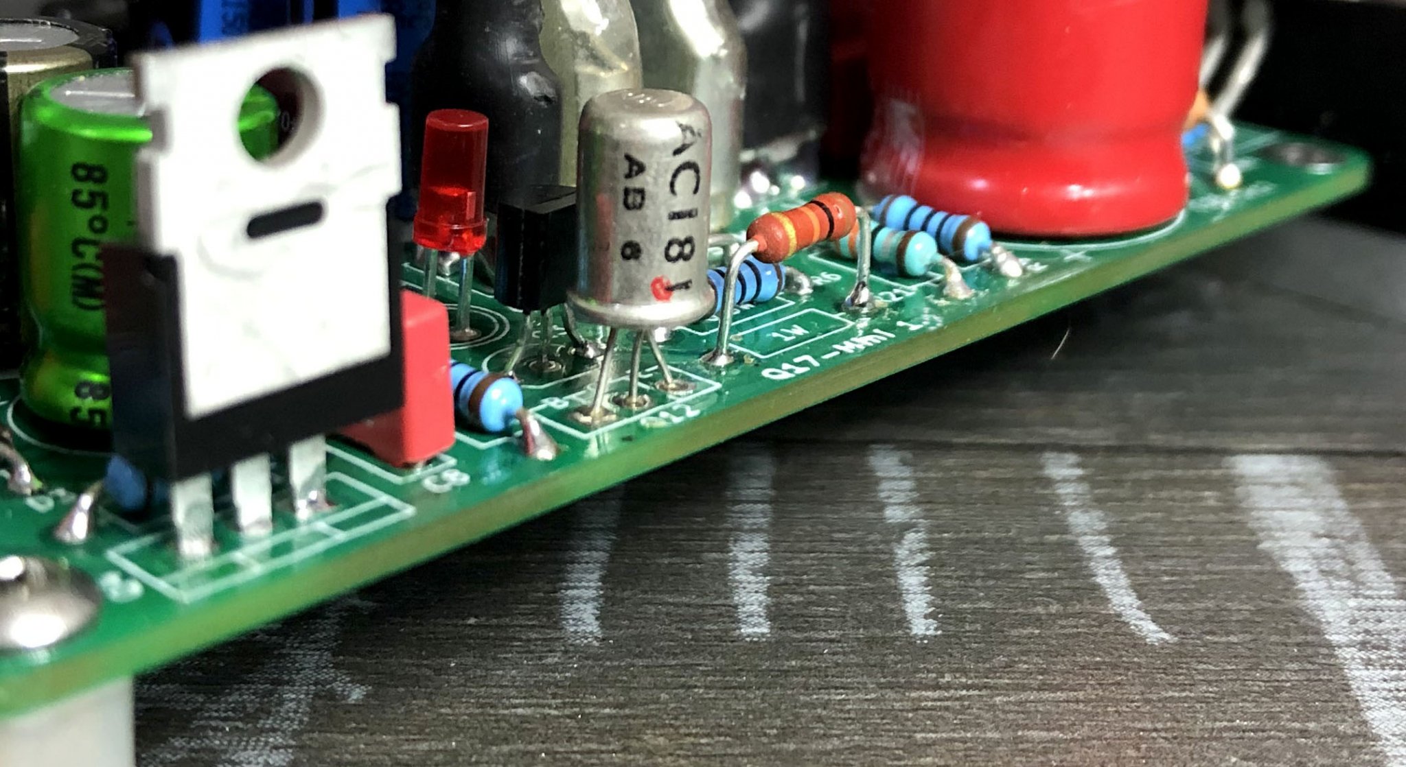

I return to the AC181.
With a Vbe of 0.201V, what resistance value should be expected?
I don't have a 2R in stock anyway.

For Vbe of 0.201V, R10 = R13 = 3,3ohm
Tibi
Hello Tibi,
I tried on my proto the AC181 on Q12 with R3/R13 = 3R3. I got only 0.124v on resistors. It doesn't seem to work.
Stef.
EDIT: oops, R3 or R10?
In fact 120mV is a value more close to what I expect on a Ge transistor. Use R13=2 ohm
Also, you may need to remove R9.
Tibi

Hi Tibi,
What are the good mA values (target) to have for R10 and R13 with AC181?
Currently, I got this:
Power=51v
R9=100R
R10=3R3 ----> 0.180v
R13=2R4 (10R&3R3) ----> 0.136v
Stef.
The CCS must deliver around 60mA, therefore 2R4 should be the value to consider.
Tibi
Tibi

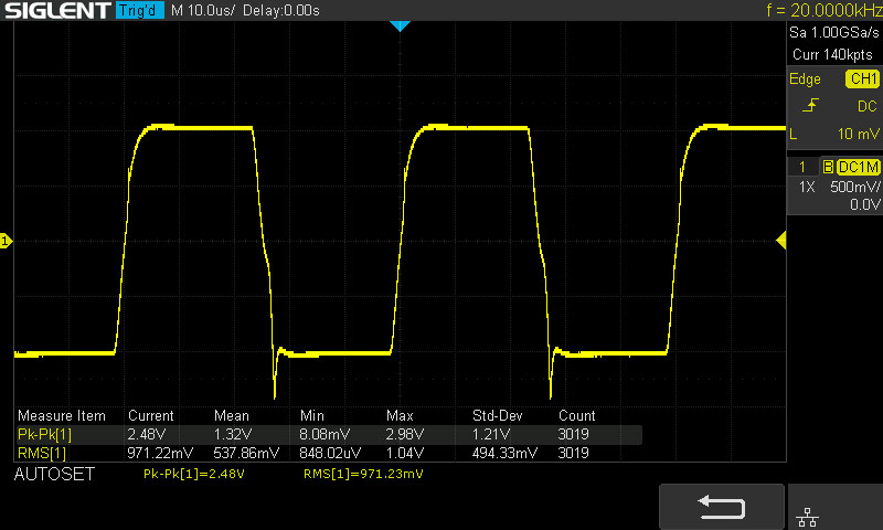

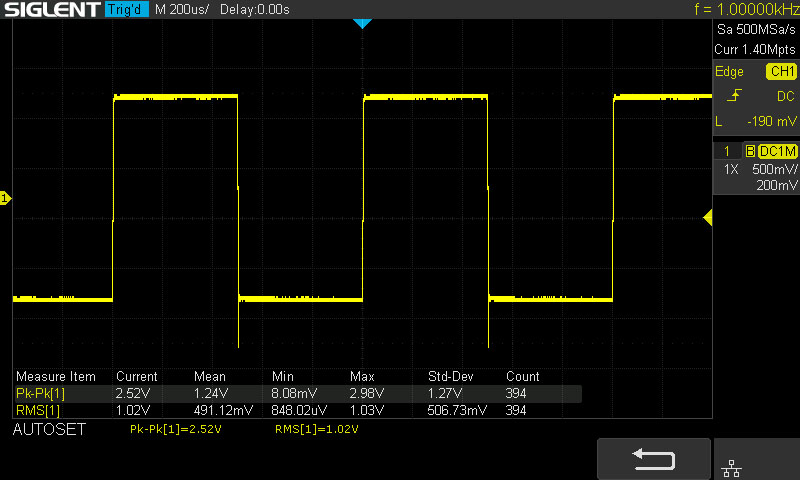

Hi Tibi,
That's what I thought, but I preferred to be sure. So I have about 60mV with R10=3R3 and R13=2R4.
On the other hand, it is not good at scope. I have 1mV more than the normal DC offset (+55%) and the square wave is crap.
Stef.

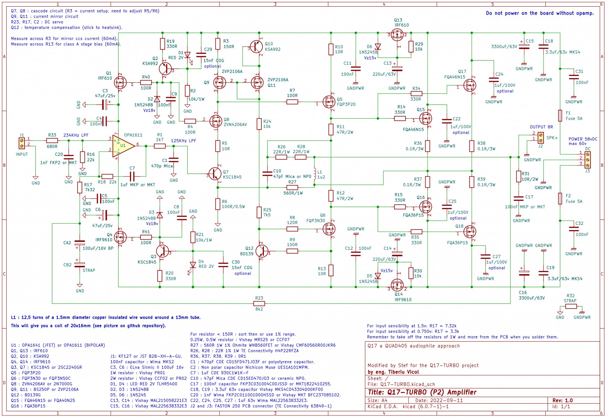

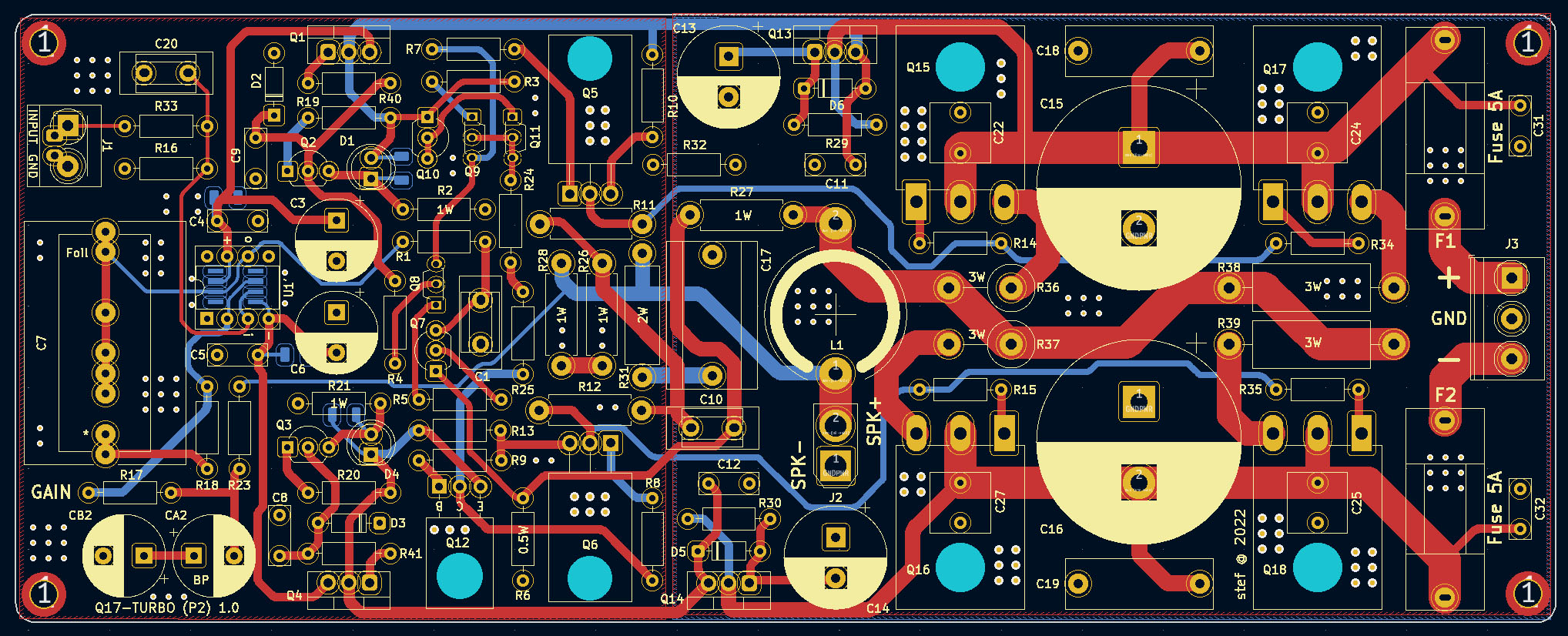

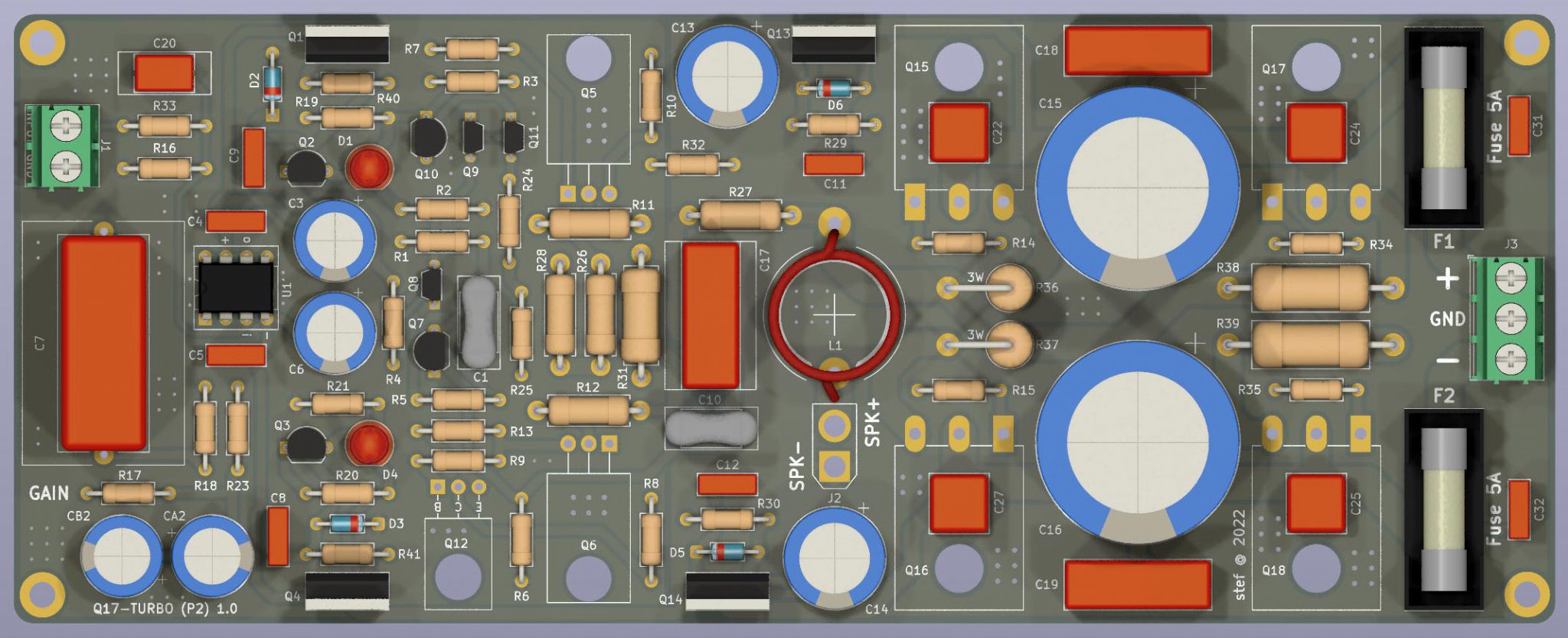

Hello,
I made a new version of the P2 PCB.
https://github.com/stefaweb/Q17-a-QUAD405-audiophile-approach/tree/main/Q17-TURBO 1.0
I don't plan to have PCBs made at the moment but the files are available if you want to test it yourself.
Stef.

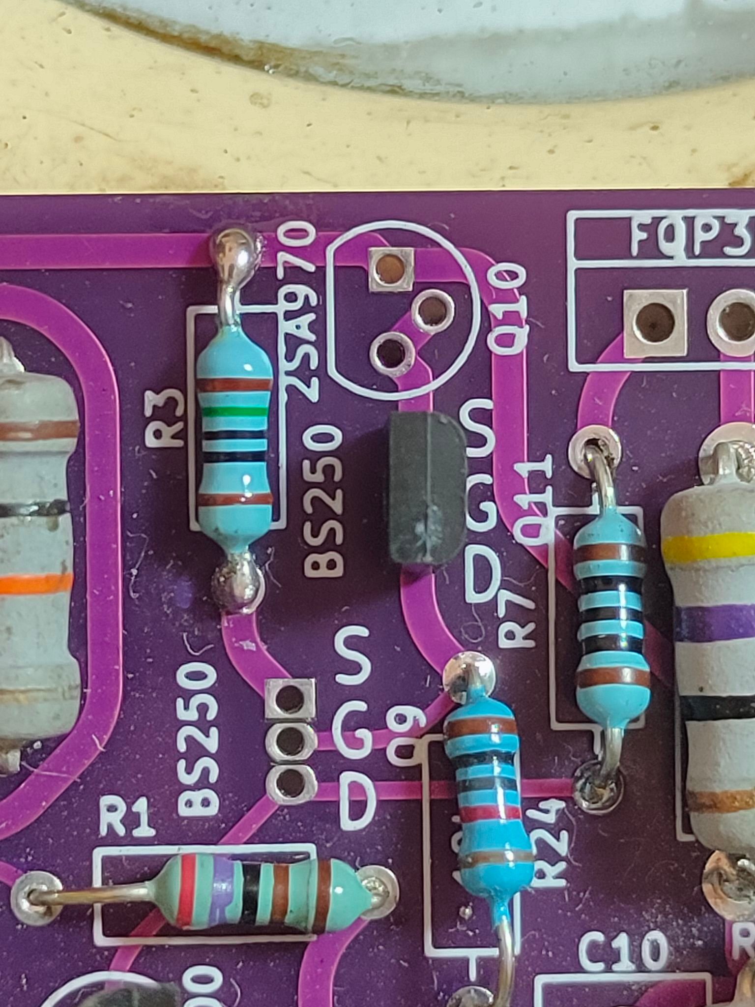

Hi Andrew,Hello Tibi
greetings is this the correct orientation of mosfet
BS250P.
warm regards
Andrew
Please have a good look at at the quality of your soldering job. Very bad flown through. I can garantee a lot of problems when trying toget music out of the build.
Try more heat or better suited soldering material. Clean wires of the parts and/or use some good flux.
I wish your labour ends up successfully, it is certainly worth it!
Ed
Pinout BS 250:
The position depends on the make of the part. Ones you know that, you're able to find out its position. Tibi has written about this in this thread somewere.
