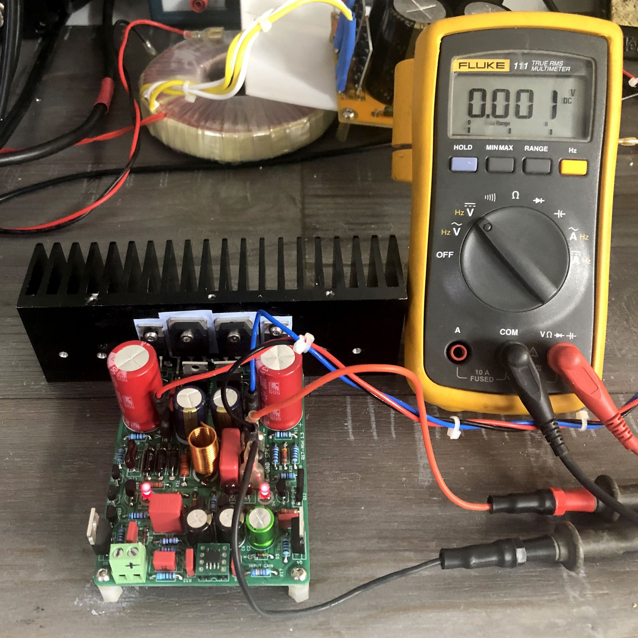

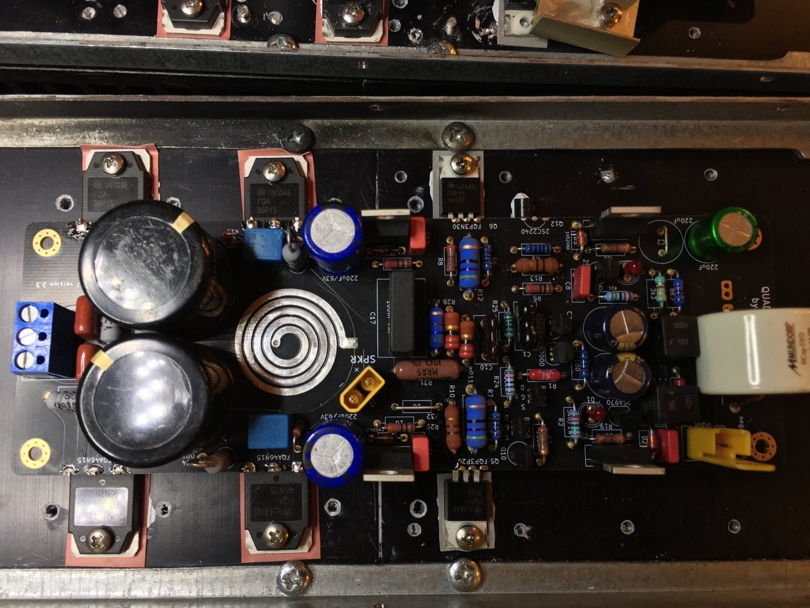

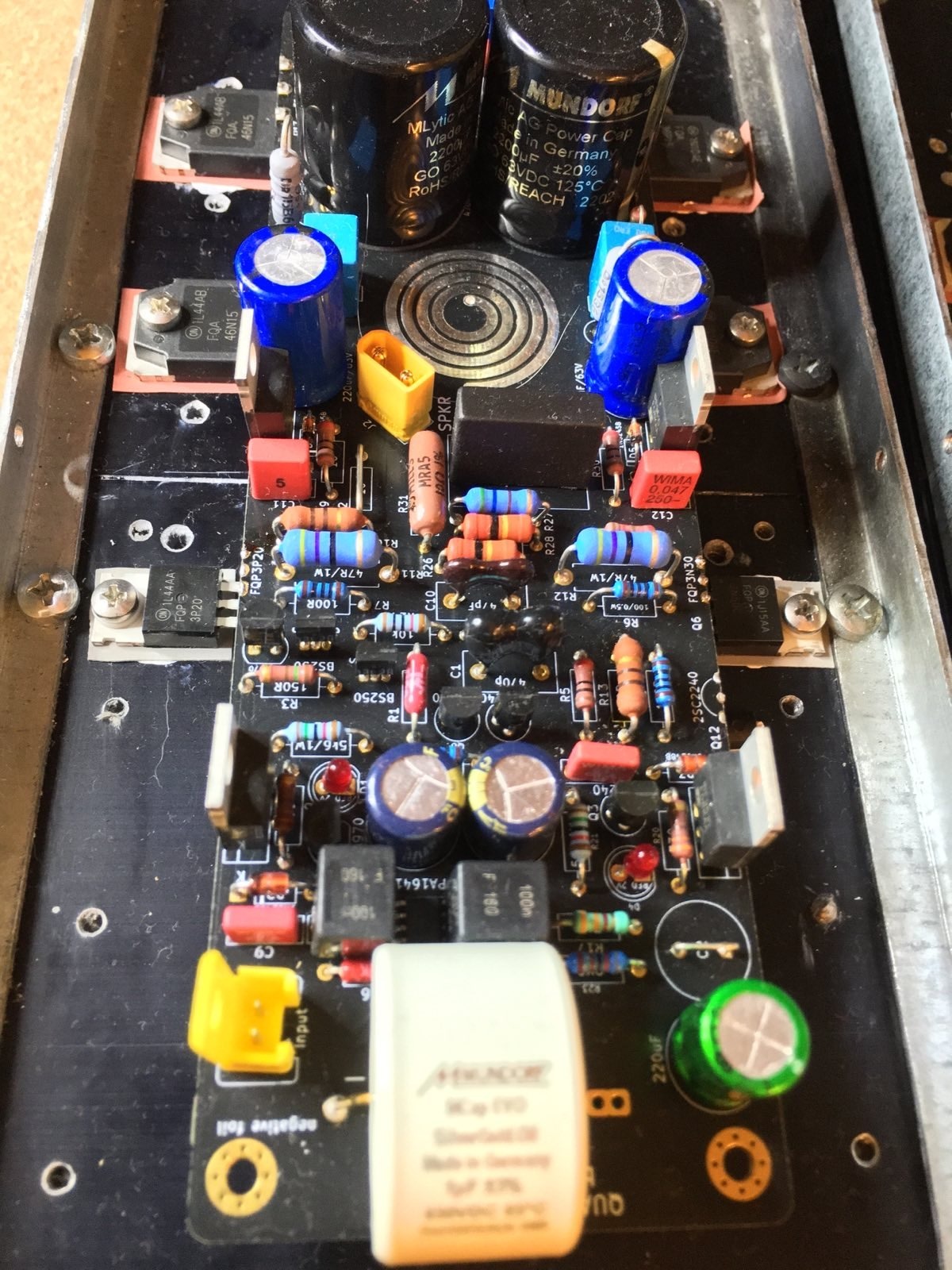

Another Q17 pair I finished last week.
I have increased R2 and R21 to 10K @ 0.5W. this will reduce LED current to 5-6mA and power dissipated by R2 and R21.
Amplifier is more stable with R32 = 0ohm, therefore R32 was replated with a straight wire.
FQP3N30, now obsolete, was replaced with FQP3N50C.
Tibi

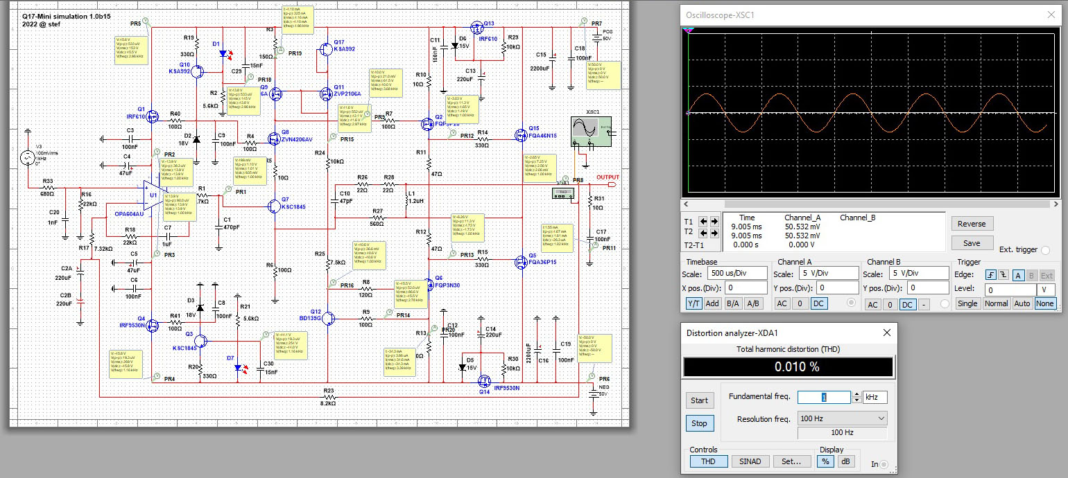

Hello Tibi,
I was wondering if it's really useful to have two ground planes: GND and GNDPWR. If we connect the two ground planes with a strap, it's like creating two islands, which isn't very good.

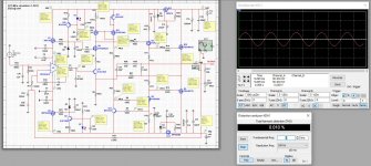

Concerning the simulation under Multisim that I put on my Github repository. I can't get the circuit to work with an OPA1641. For now, the only one that works is an OPA604U.
Stef.
Stef.

You are really funny.
It is clear that R32 is responsible for the Q17 having an old scool sound and that R32=0 Ohm eliminates this issue.
With your current mod the amp should have an offset of about 0V, have you measured that?
I have recently been investigating the switching pulses of the output MosFET via the feedback loop of the amplifier, there is a transfer via R6 to the input GND and thus a feedback into the input. You have now stabilised this with R32=0 Ohm via the power supply. All you need now are high-quality capacitors to reveal the full acoustic potential of the circuit.
I would be interested to know, how does your new modification sound with your loudspeakers relative to older versions of the amplifier?
Regards Tim

Even with R32=0ohm, power plane still need to be separated by small signal plane, in order to avoid high current return into small signal plane.Hello Tibi,
Stef.
Regards.
Tibi
Offset is ~0,1mV and the sound is terrific.Hello Tibi,
Regards Tim

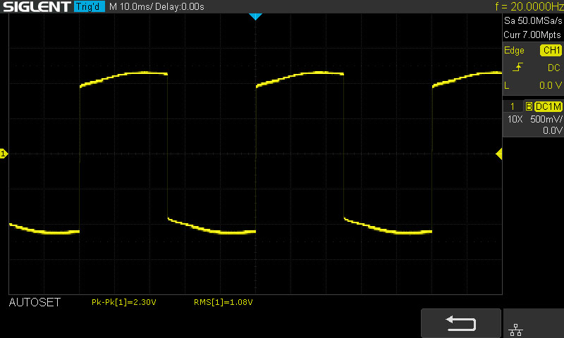

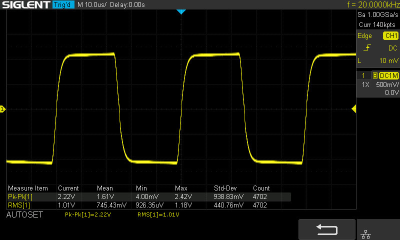

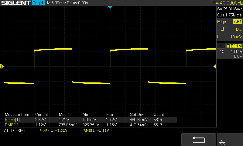

Tibi

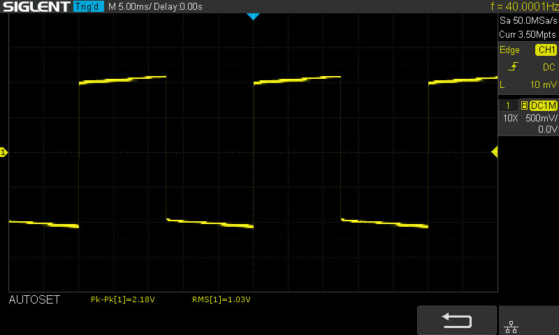

Same here with/without R32 with Mini 1.2. At power on, the DC offset is directly less than 2mV now.
And scope curves seems better...
Not yet tried with a speaker.

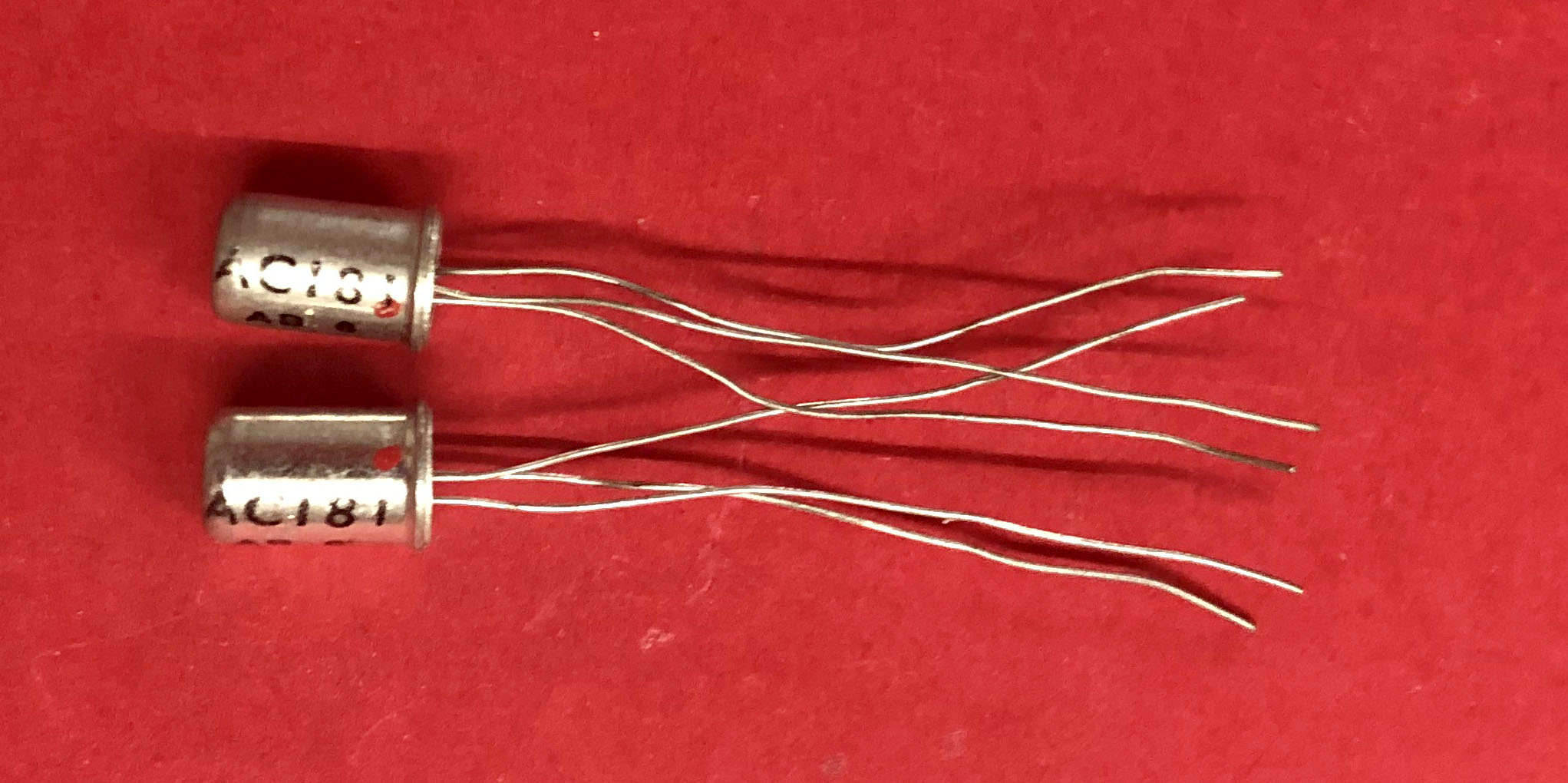

Good evening,
I found two old things for Q12.
Worth a try? They work and would be new.
Is it 2R for R9?
Stef.
Is it 2R for R9?
Stef.
If AC181's Vbe is around 120mV, than R10 and R13 = 2ohm.
First measure Vbe (at room temperature) and then choose R10 & R13 for ~ 60mA
Tibi
Tibi

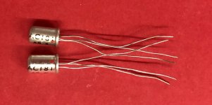

Hello Stef,Good evening,
Is it 2R for R9?
Stef.
according to the simulation, the Q12 still works at the switching pulses for the Mosfet, which is a frequency of about 16 MHz. The AC181 is reported to have an fT of 3.5 MHz, so it can't do any more amplification in this frequency range, this significantly changes the operation compared to the 2SC1845 with fT > 50 MHz.
Regards Tim
Q12 is part of a CCS with Q6. The main role of Q12 is to provide constant voltage across R13. There is no high frequency amplification involved.
The advantage of a Ge transistor here is that will have a higher thermal drift than a Si one.
Tibi

Hello,
I measured both AC181s.
Unit 1
hFE=132
Vbe=0.201V
Unit 2
hFE=93
Vbe=0.208V
How old do you think they are?
Stef.
