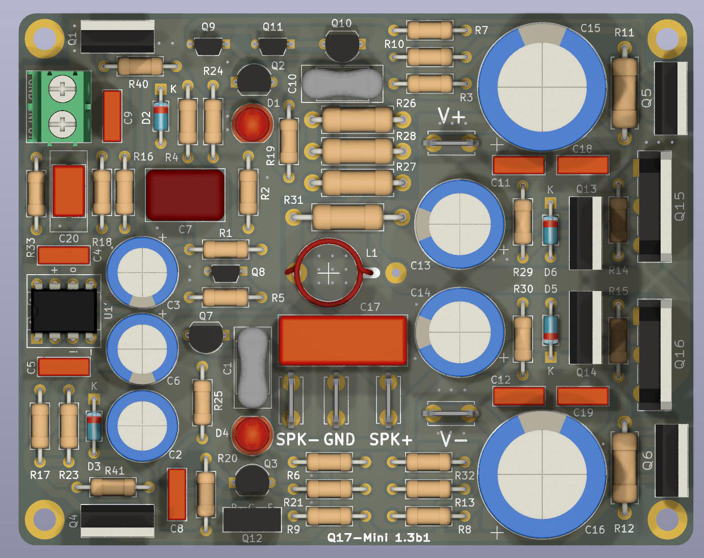

Hello!
I built the prototype of Q17-P2. At first sight, the card works but it oscillates alas. This is the sinus with see on the scope screenshot below.
I have 35mV of offset at the output with the voltmeter connected directly to the HP terminals. More if I connect an 8R load connected with the scope.
Nothing is very hot.
I have to find where it comes from which is not an easy task. 😆
Stef.
By having such huge distance between n and p output finals, you add an important parasitic inductance that may alter current dumping bridge operation and induce in all PCB lot of signal from output.
Tibi
Hi Tibi,
Can you be more specific?
Stef.
1. Keep current dumping bridge away from other small signal traces.
2. coil must be away from cascode
3. use gnd plane and guard, where possible, small signal traces
4. tight placement of output stage with thick traces.
5. keep some space between output transistors and class A stage made with Q5 and Q6
6. avoid pcb islands not connected
7. gate stoppers must be as close as possible to gate mosfet pin
8. keep decoupling caps as close to mosfet drain or opamp pins.
Tibi

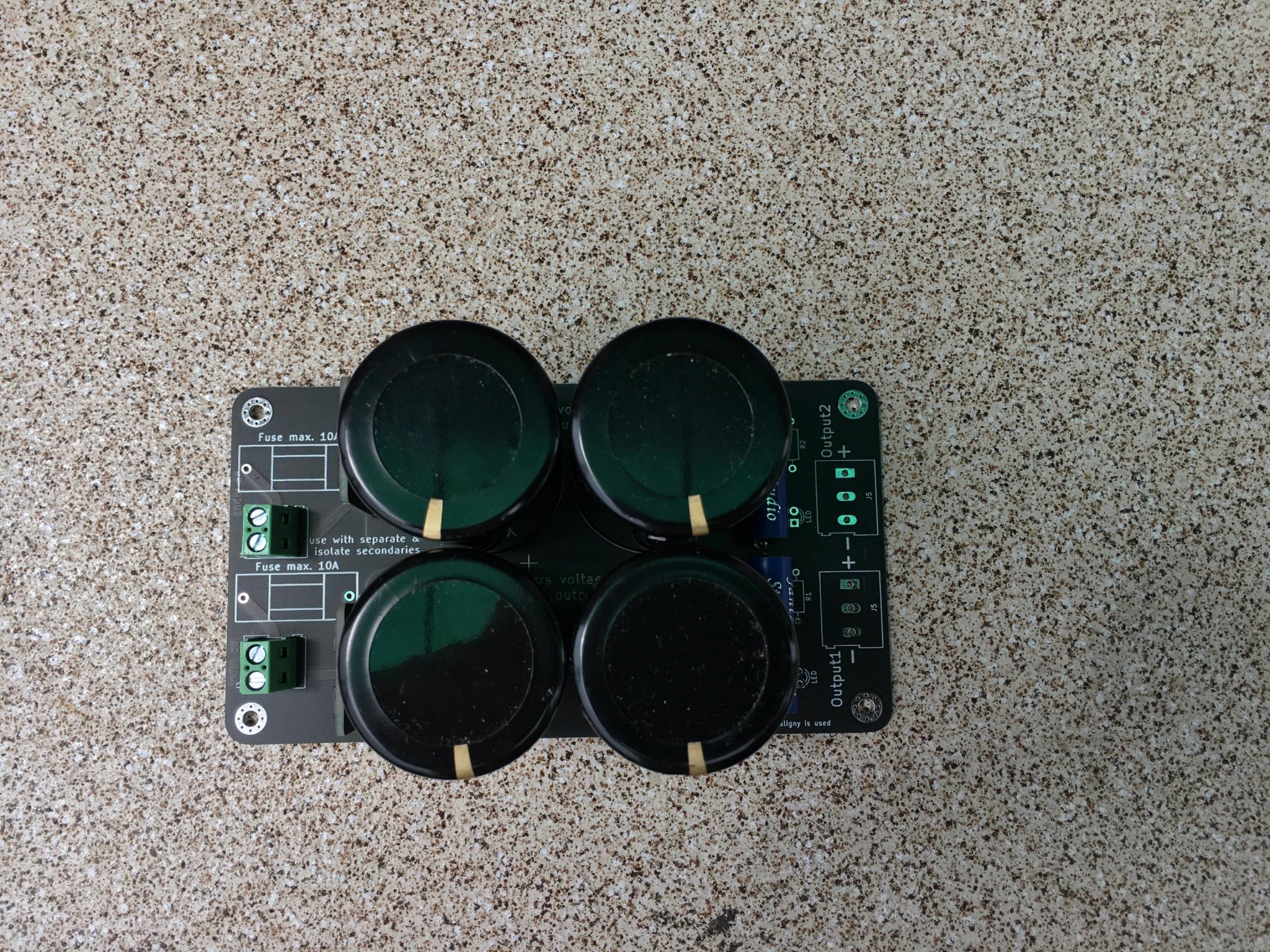

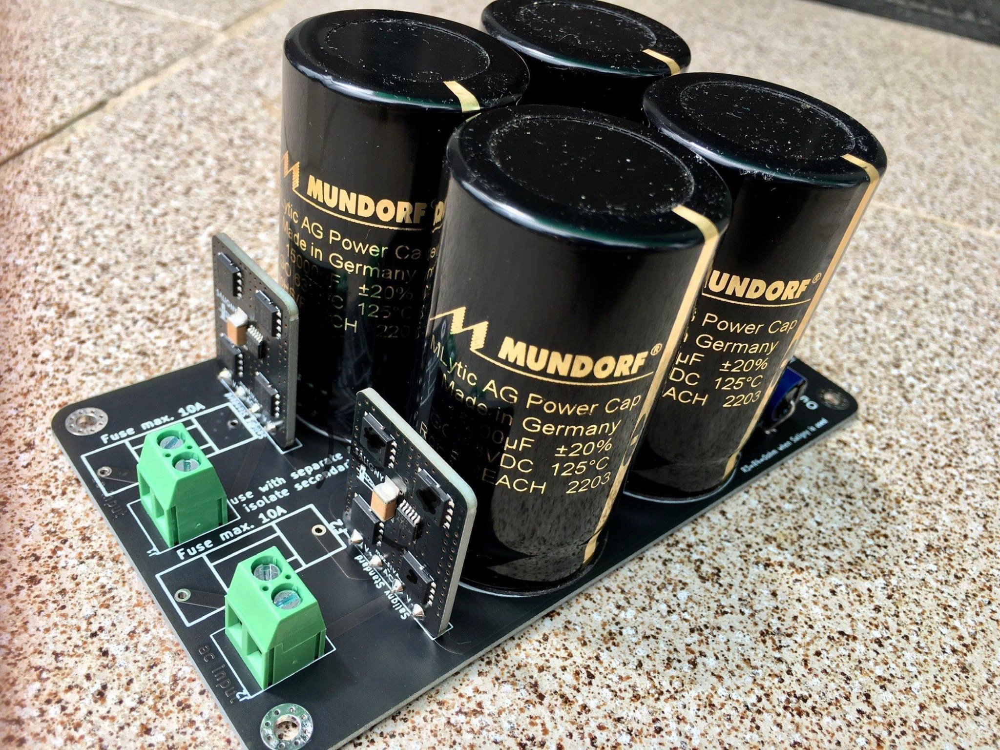

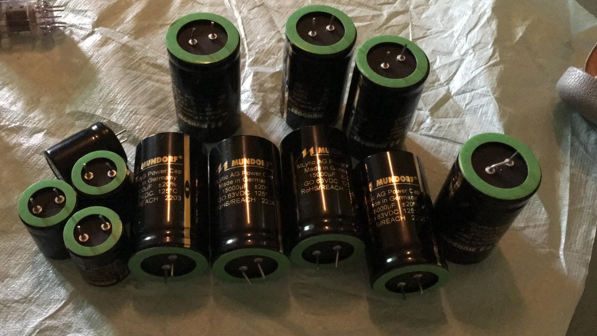

  • on bard filter capacitors have been increased to 4700uF. I think this is maximum value for this footprint. In terms of sound, this caps matter a lot, so you may voice your amplifier by changing them.
Is there a recommandation for this capacitor with a lifespan of more than 2000 hours?
Thanks.
Mundorf MLytic. 2200uF/63V will fit on Q17 pcb and 15.000uF/63V will fit perfectly on active power supply pcb.
Tibi

HI!
Let me know if you modify the circuit. As I have finished my stock of Q17-Mini 1.2 PCB, I am working on a new 1.3 version with some changes to the PCB (moved Q8 close to Q7). I can incorporate changes if you want with the first batch.
Stef.
