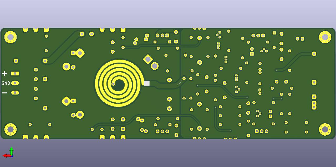

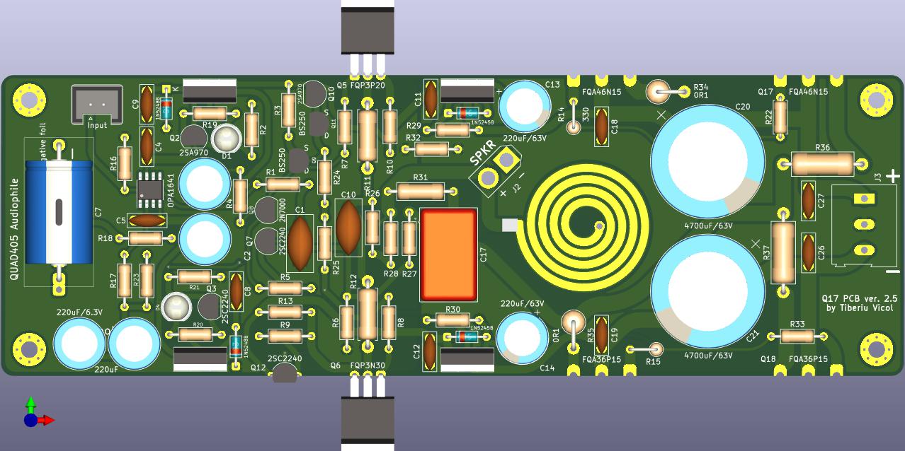

Github was updated with latest KiCad files and gerber for 2 pair output.
PCB modifications are mainly aesthetic as follow:
  • a new top ground plane was added. This will slightly improve power supply and output section
  • some traces have been enlarged
  • all traces have been rounded
  • component marking is now clear and visible making mounting a breeze
  • on bard filter capacitors have been increased to 4700uF. I think this is maximum value for this footprint. In terms of sound, this caps matter a lot, so you may voice your amplifier by changing them.

ps: My own version of the Q17-P2 is still in the works but I've done a lot of mods on the PCB lately. C7 footprint can fit a Auricap capacitor now.
Q17-P2
https://github.com/stefaweb/Q17-a-QUAD405-audiophile-approach/tree/main/Q17-P2
Hey Stef, any idea when this layout will be ready? Really excited at the layout with different options as well as spread of the mosfets on longer side of the PCB 🙂 Very well thought out ideas being implemented.

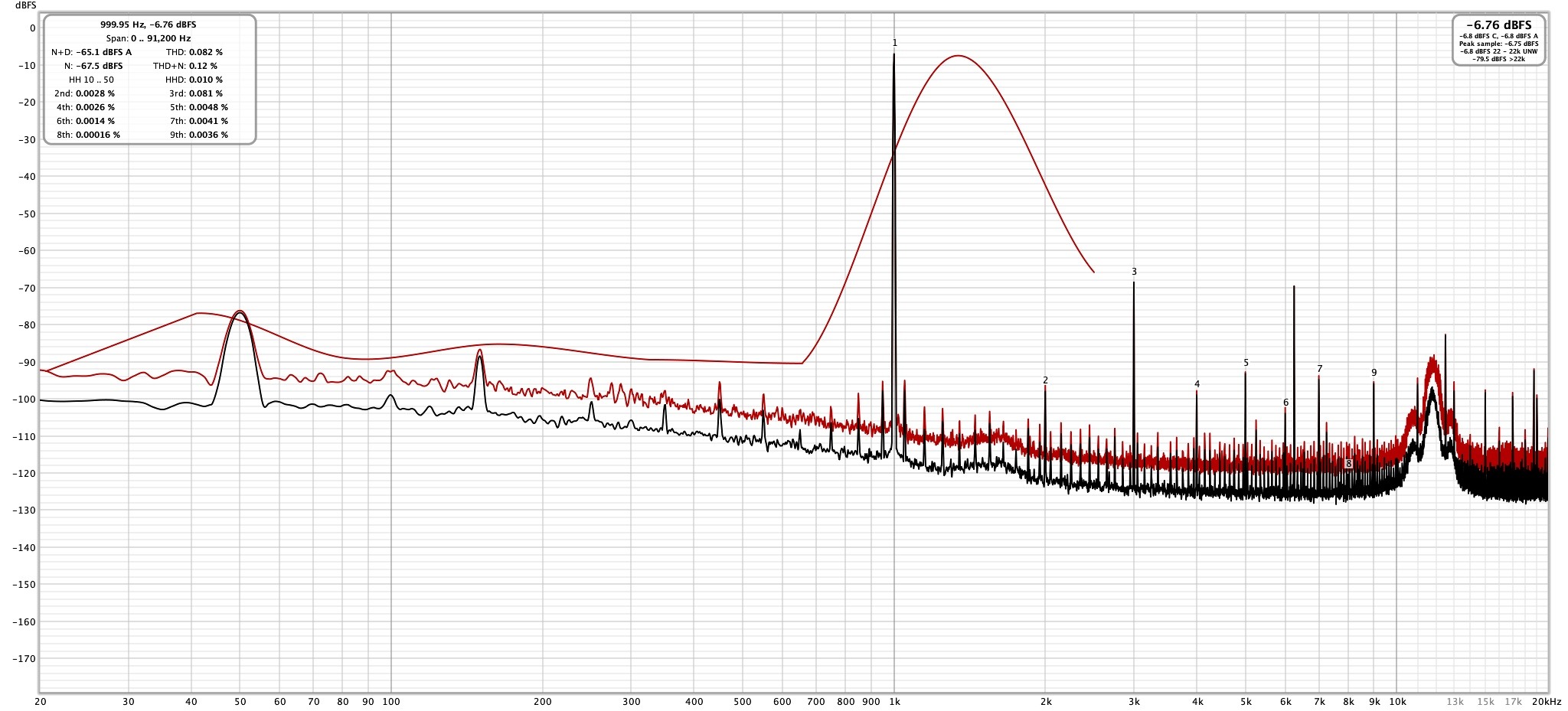

Hello!

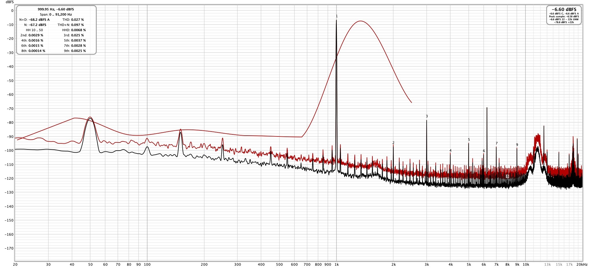

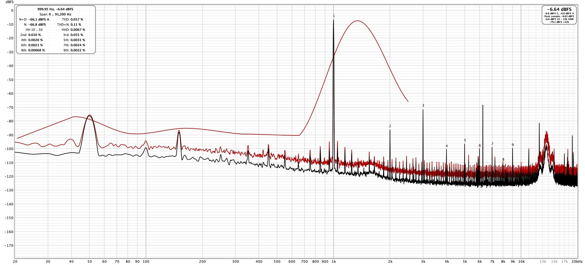

I did a test with a Q17-MIni 1.2 card with and without LPF at the input. The settings are exactly the same. I send 40 mVrms 1KHz sinus at input and I got 1 Vrms at output.
The first curve is without LPF.
The second curve is with an LPF (R33 = 100R and C20 = 680pF FKP2).
Resistor R22 is strapped.
We notice that the THD values are better with the LPF. There is also a big level difference on harmonic number 3. Less on the others harmonics.
Stef.
EDIT: I forgot too. Without the LPF, I have 39mV of DC output and with the LPF, I have 3mV of DC output. The opamp is on a DIP socket. May be this cause a problem.

Another curve.
1MHz LPF (R33 = 100R and C20 = 1.5nF FKP2)
I analyzed the behavior of the output DC offset a bit better.
Without LPF at the input, the offset remains at 39mV. With the LPF, when I turn the board on it starts at 39mV and slowly drops to 3mV in a few seconds (6/8 secondes). After that it doesn't move.
Stef.
