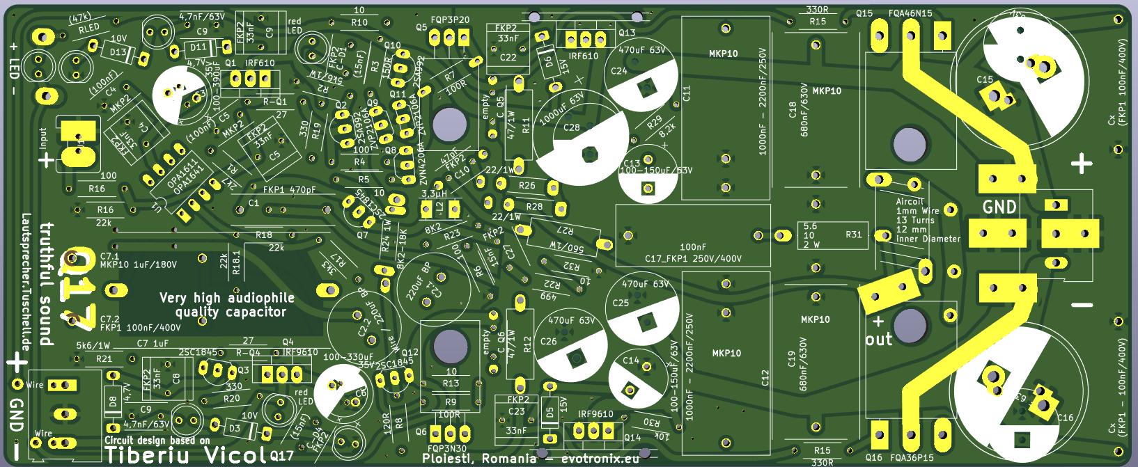

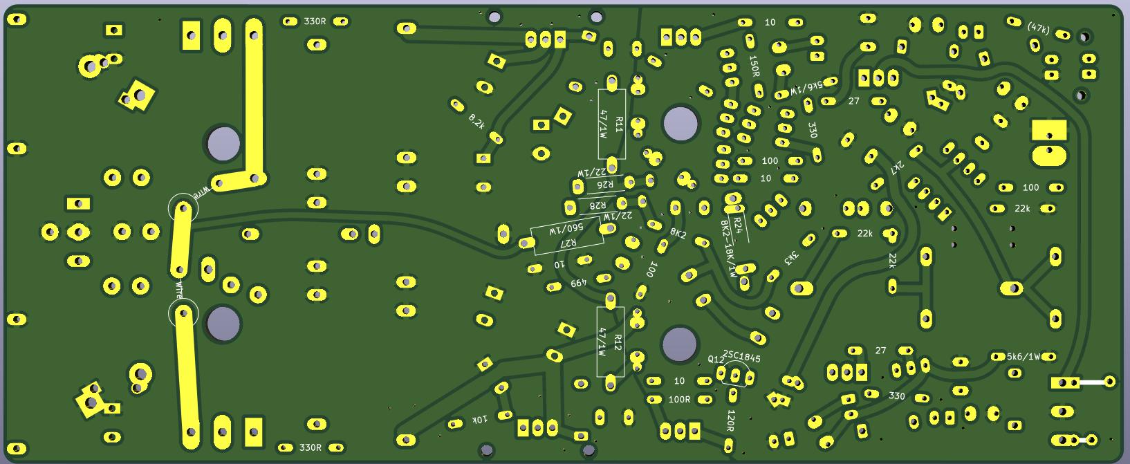

I have now applied the findings from my DAC development to the Q17 and added two more capacitors. The reason is that the Z-diode noise is dependent on the Z-voltage, so I have now modified the current smoothing so that 14V is smoothed to ground via a FKP2 4.7nF before the last 4.7V Z-diode follows.
Also, for the more budget conscious, I added solder locations on the PCB for normal capacitors for C7. Here it is a combination of Wima MKP10 and Wima FKP1, which I could determine as very high-quality in my experiments.
Gerber file: http://lautsprecher.tuschell.de/DIY/Q17/GerberQ17-V12-194.9x79.9mm.zip

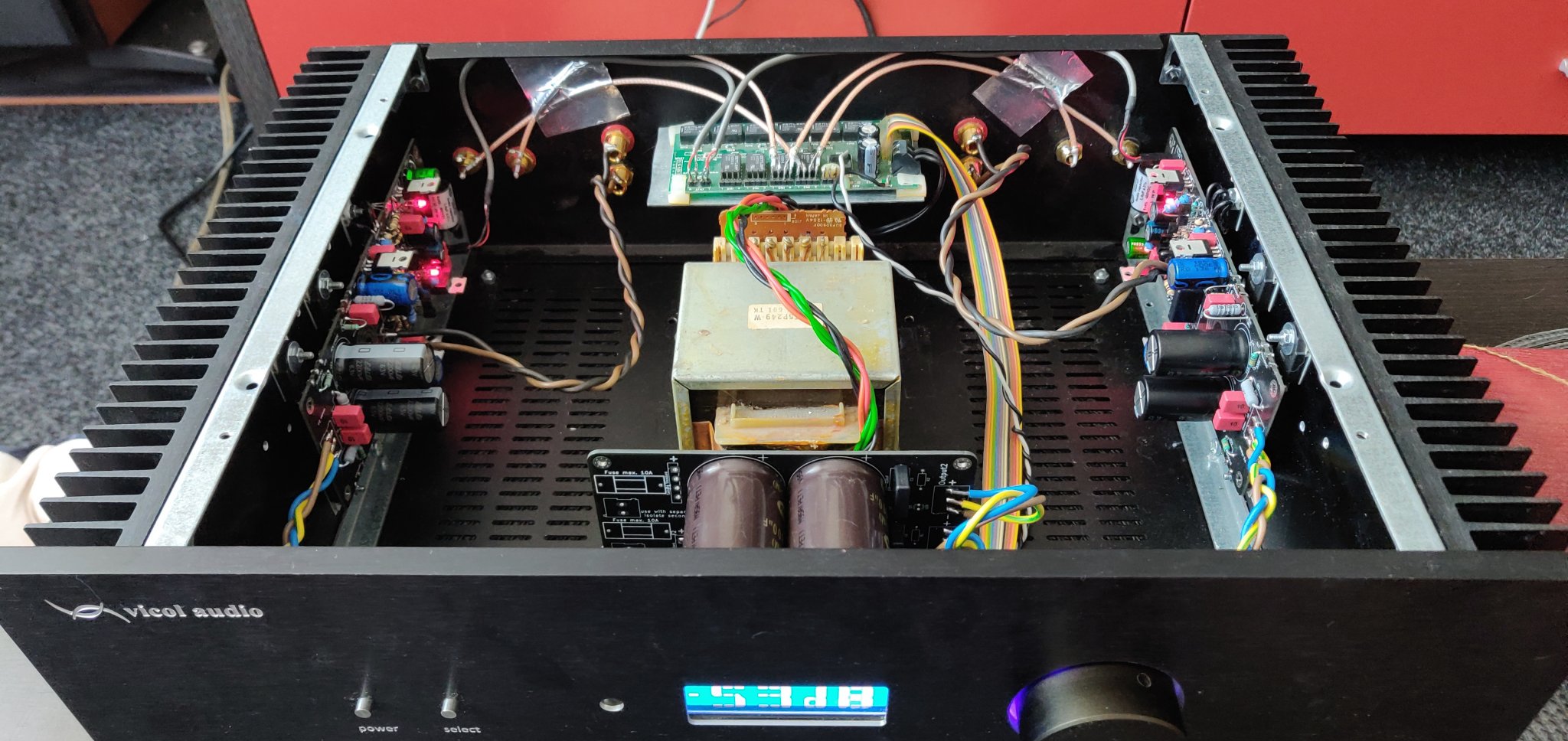

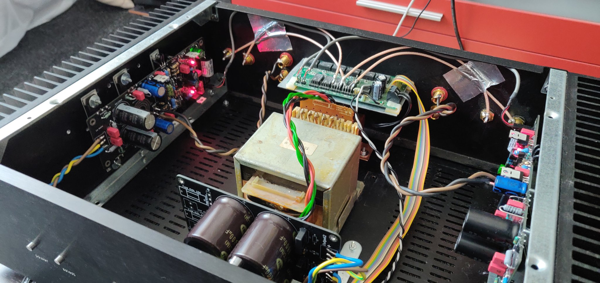

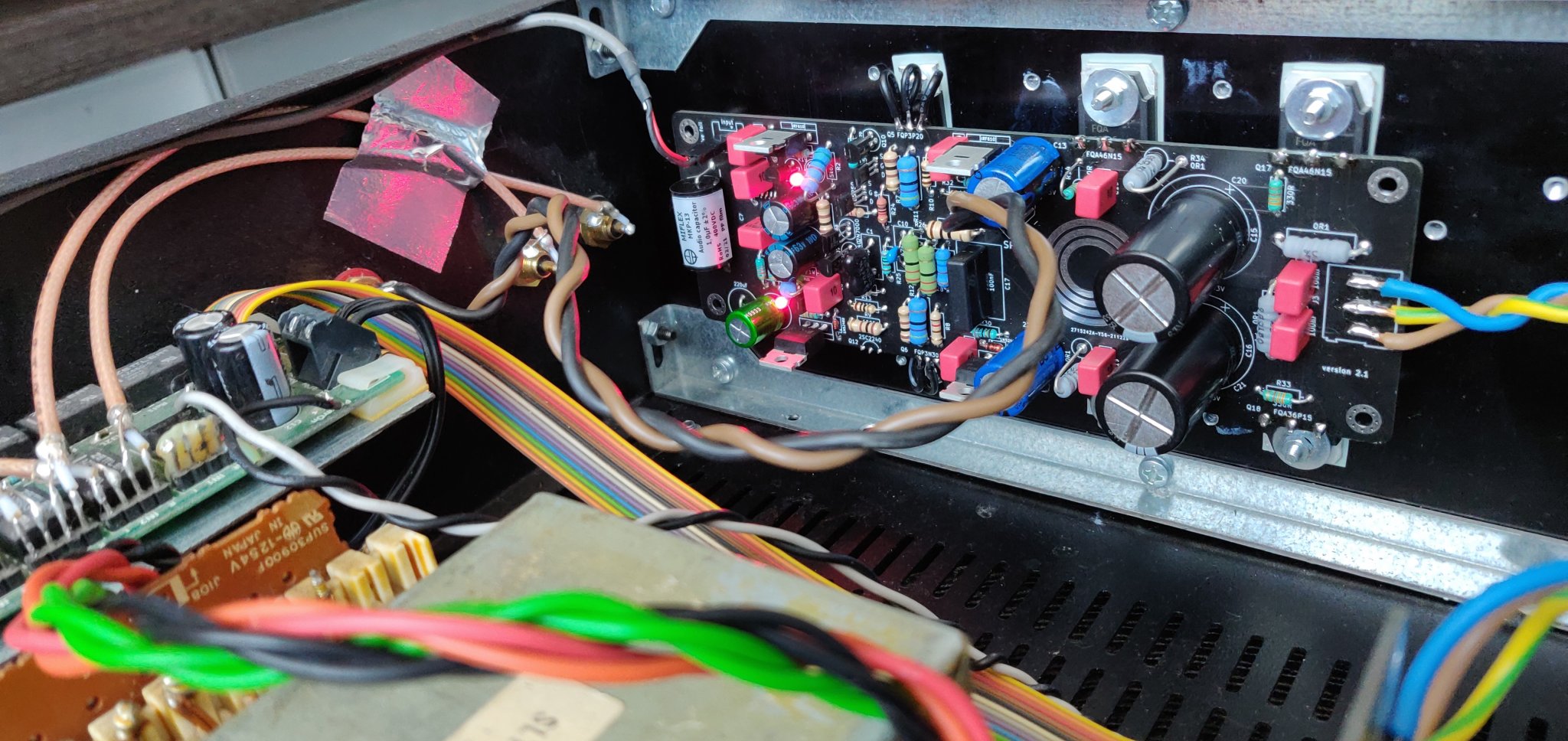

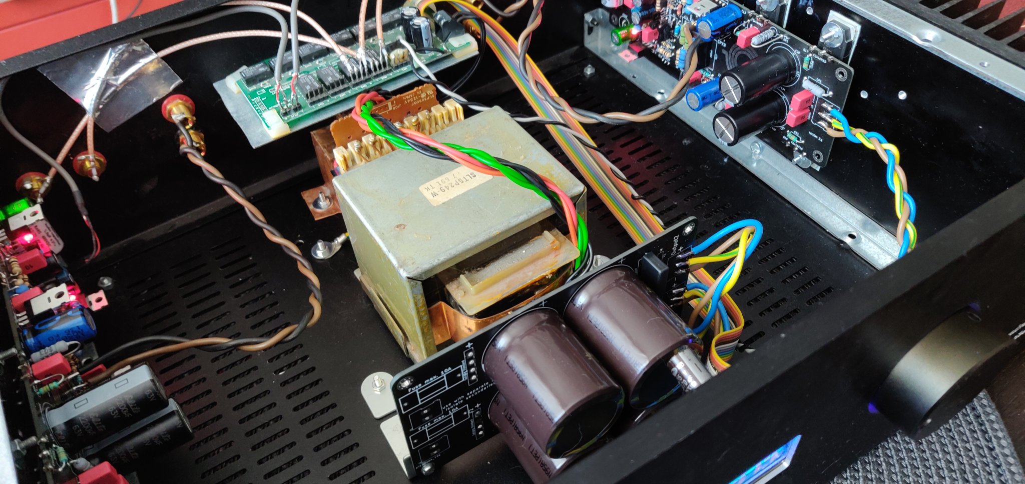

Hi Tibi - ive just ordered my boards, cant wait! Just for interest, what is going on with 'C2' in your attached pics?? Many thanks... TonyFew pictures with latest Q17 pcbs with two output pairs.
Modules have been tested and are performing exceptionally well.
Tibi
View attachment 1053071View attachment 1053067View attachment 1053066View attachment 1053068View attachment 1053069View attachment 1053070
On the two ‘C’ spots you can use one non-polar capacitor or two normal C’s in a previously showed confuguration. Here the non-polar is used and the second one (C2) is bridged.
