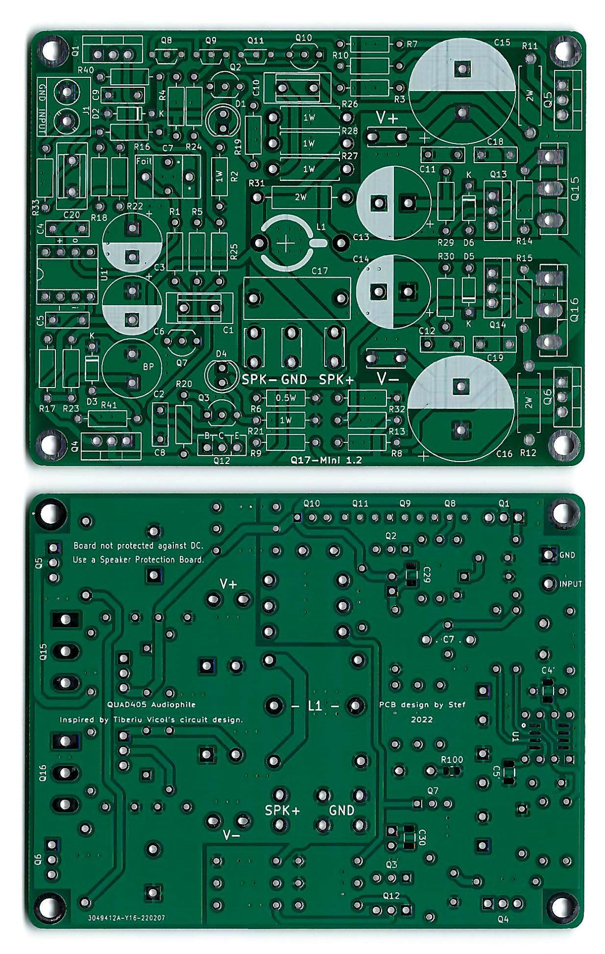

Hopefully last question 🙂
C15/C20 & C16/C21 - all four mentioned on bom - but only footprints for 1 of the pairs? and C26/C27 not on bom - just the same values as say C18?

Hello Tony,
C15/C20 are two footprints accommodating only one cap
Same for C16/C21.
The value of these capacitors can be as high as 10.000uF if you find ones that fit.

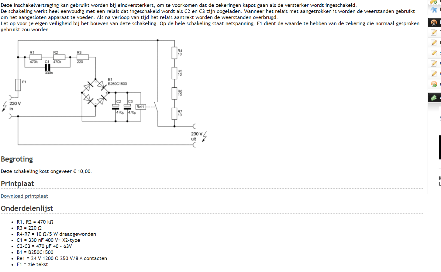

Is there a recommended soft start for this amp? I remember some having problems with fuses blowing along this thread,
regards, E

This one is very simple and works on my 300 VA tranny. You can put the thing on a small 'vero' board or hardwire it maybe.

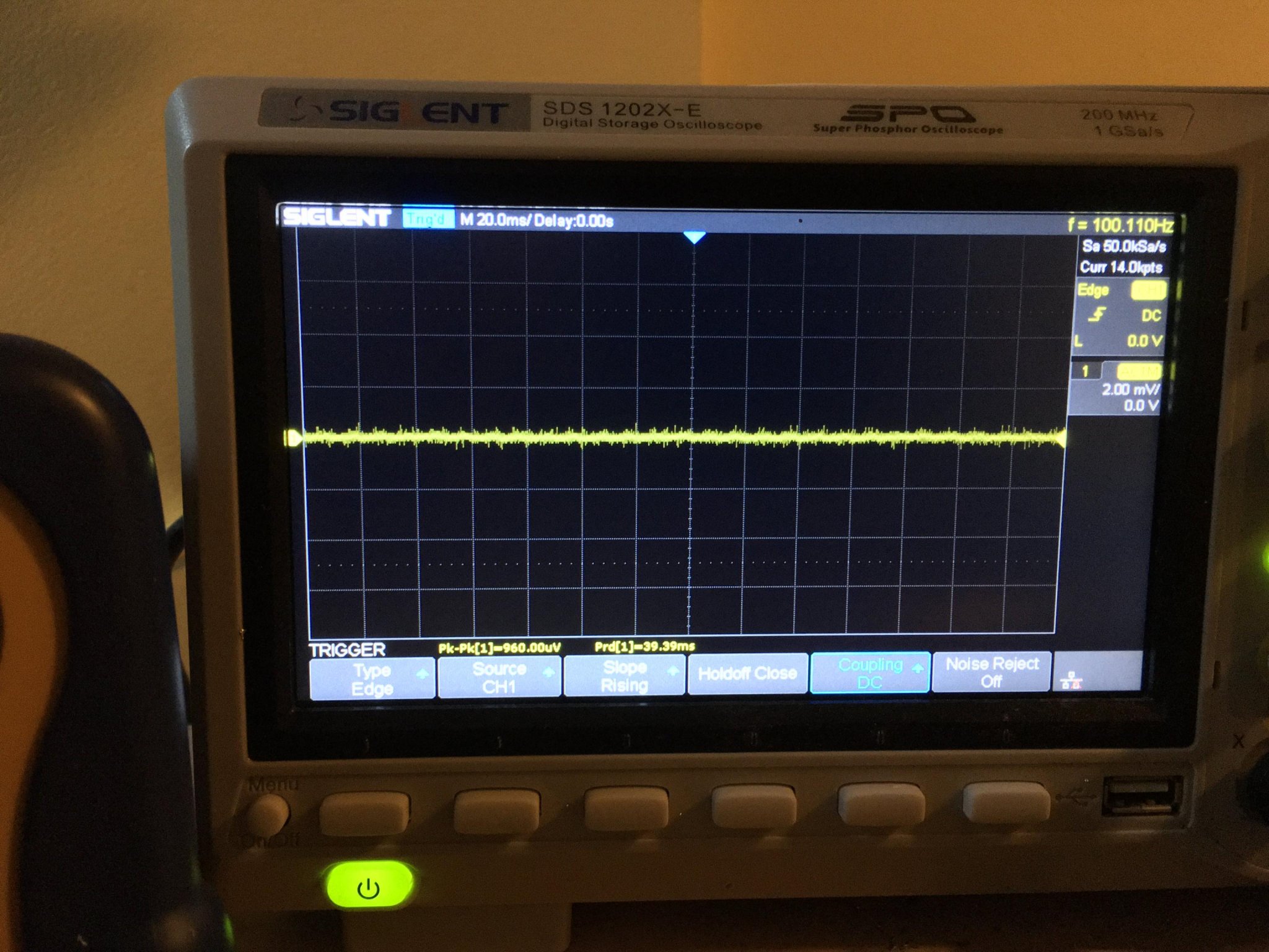

Very cool project and results. Just a tip: you can get your DSO to dump the screen contents to a USB key. Alternately by using the Ethernet connection, you can dump the screen to your computer directly.
Thanks Ed.This one is very simple and works on my 300 VA tranny. You can put the thing on a small 'vero' board or hardwire it maybe
My gerbers for a 2" x 2" board of that Elektor softstart circuit if anyone's interested 🙂

ps: My own version of the Q17-P2 is still in the works but I've done a lot of mods on the PCB lately. C7 footprint can fit a Auricap capacitor now.
Q17-P2
https://github.com/stefaweb/Q17-a-QUAD405-audiophile-approach/tree/main/Q17-P2

Hi Tibi!
Beautiful gear!!
By the way, I redid the measurements for the Q17-Mini 1.2. The spectrum is virtually identical to the first version.
On the Github repository, you will find other curves.
There is a 50Hz bump because the power supply was wired in the air without a box and too close from the board.
