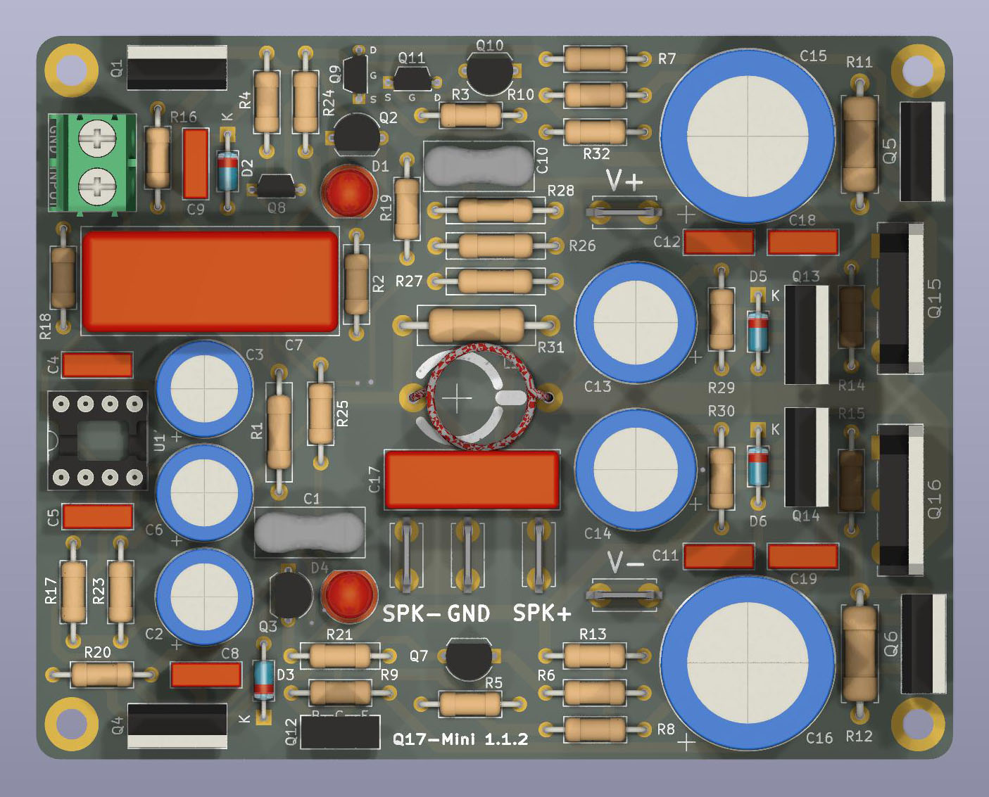

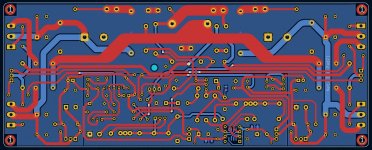

I have released a new version of the Q17-Mini PCB with some improvements.
Have a good day,
Stef.
Q17-Mini-1.1.2 release
https://github.com/stefaweb/Q17-a-QUAD405-audiophile-approach
Have a good day,
Stef.
- New vertical footprint for coil
- New SMD footprints on back PCB
- Update C7/R18 circuit position
- Some tracks optimisation
- New 3D and PCB pictures
- Archived version 1.1.1

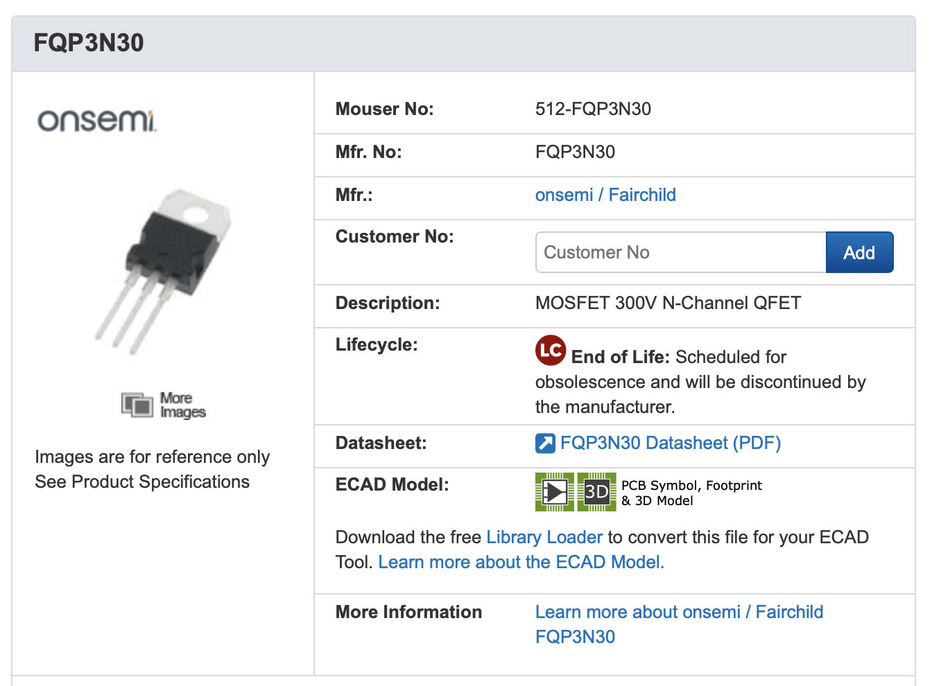

This is the case with all parts.

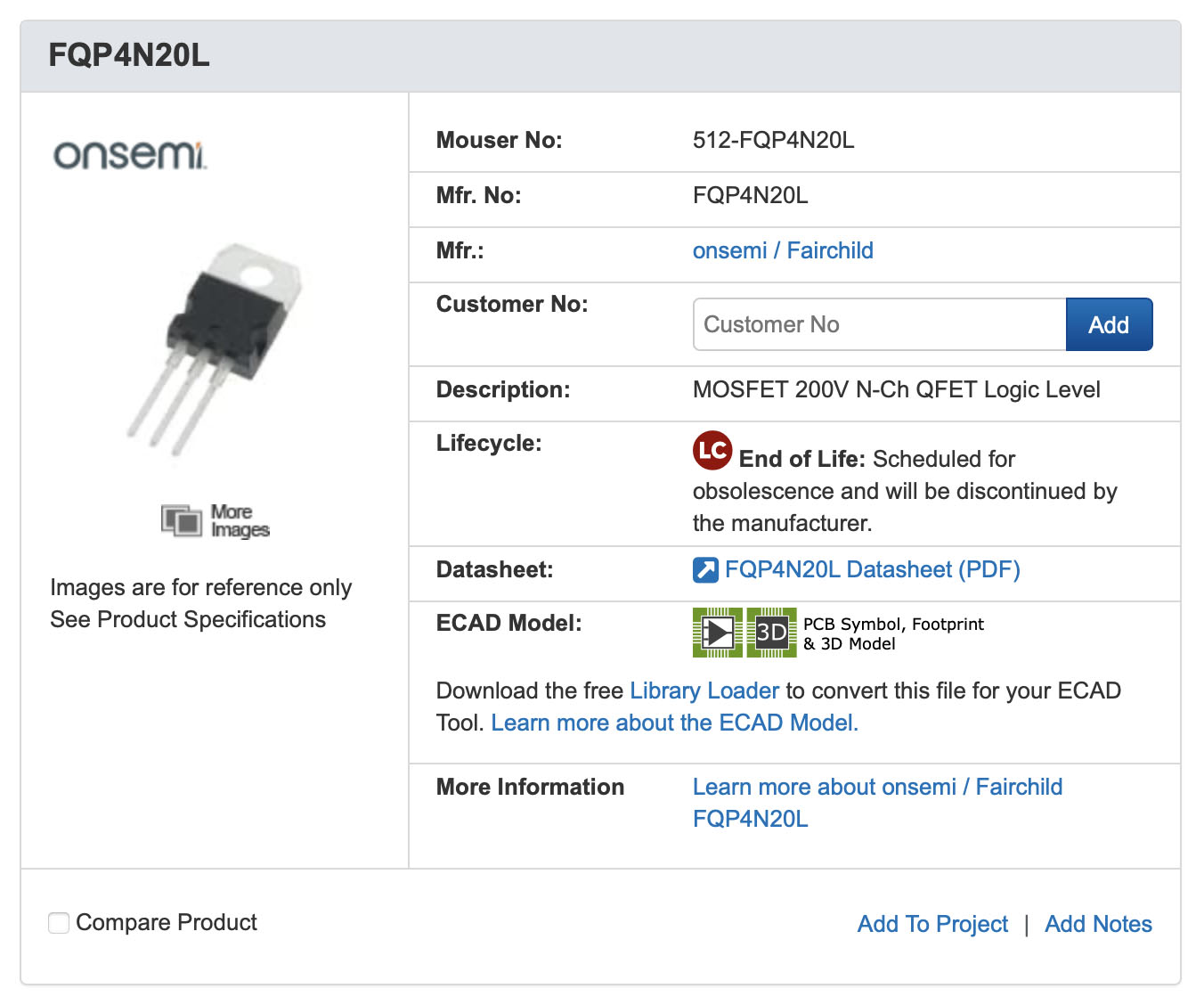

I'm running low stock on parts for Saligny bridges as well and I have few new products not able to put in production.
However, Farnell still sell FQP3N30. https://uk.farnell.com/on-semiconductor/fqp3n30/mosfet-n-channel-300v-3-2a-to/dp/2575365?ost=fqp3n30
Tibi
Tibi
Here you can see worldwide stock. https://www.trustedparts.com/en/search/FQP3N30
FQP4N20 may be a replacement.
Tibi
Tibi
FQP3 and FQP4 from ex Fairchild sound really great and took me lot of tests (read time and money) to find them.
Is a shame that almost any audio part, that sound good, get obsolete after few years.
There are some Toshiba new mosfets, that may fit this application, but I need to simulate, measure and finally listen a lot.
To design a good amplifier you need to listen and compare for each critical part.
Parts matter a lot for those who know how to listen and this take lot of time.
Tibi

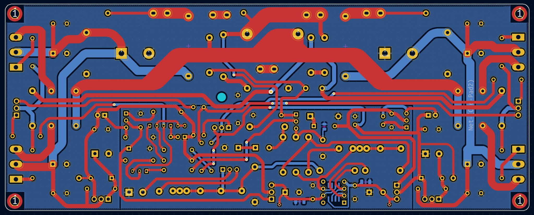

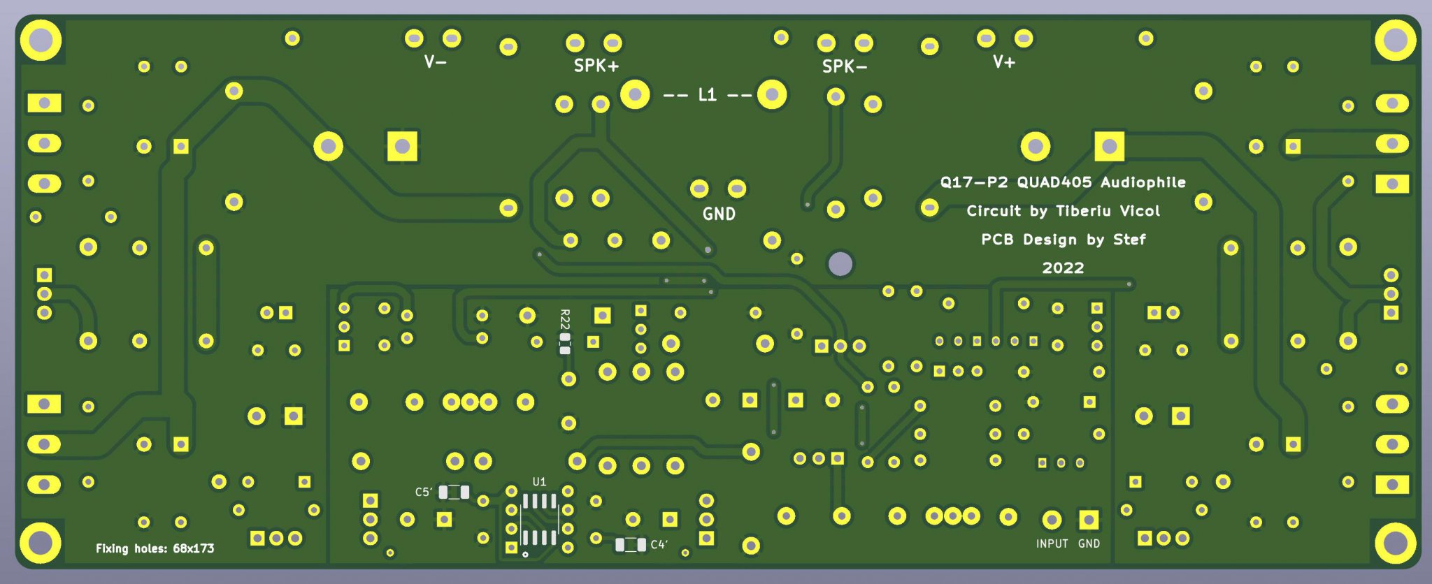

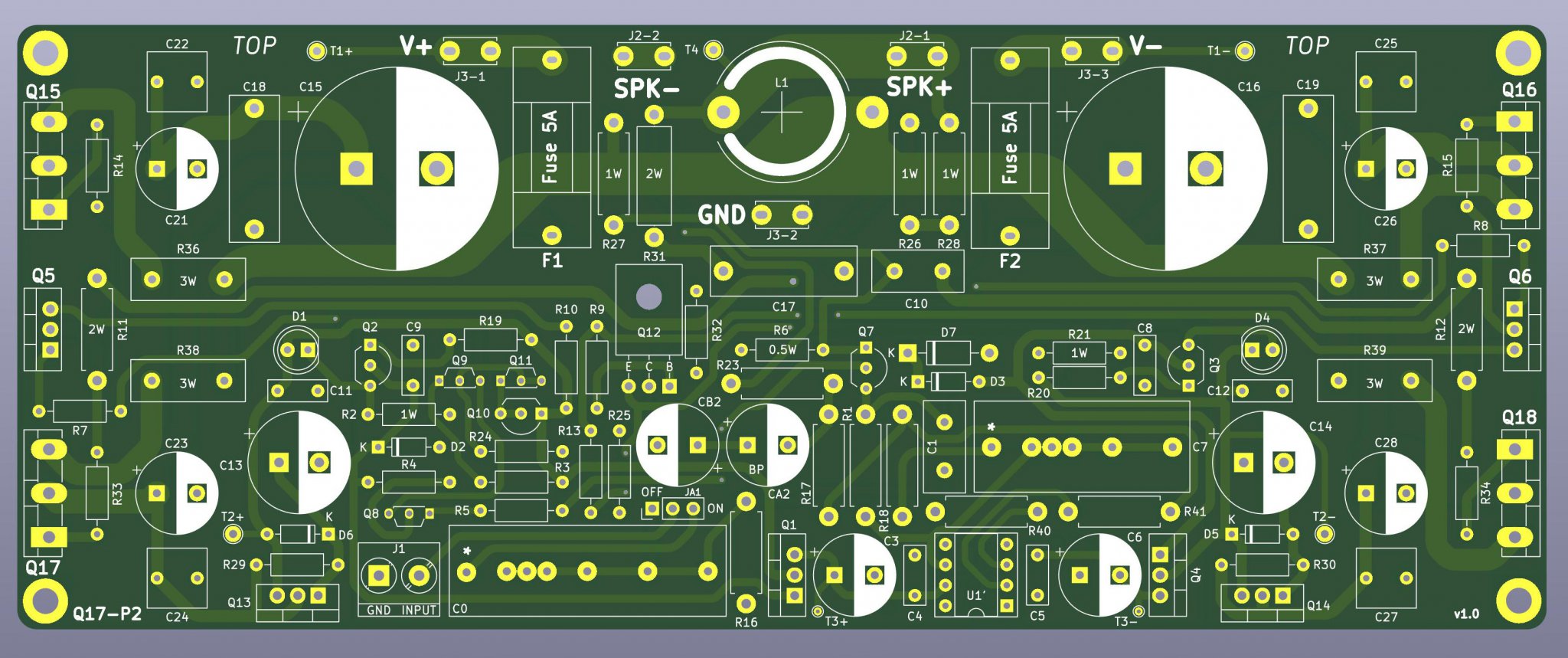

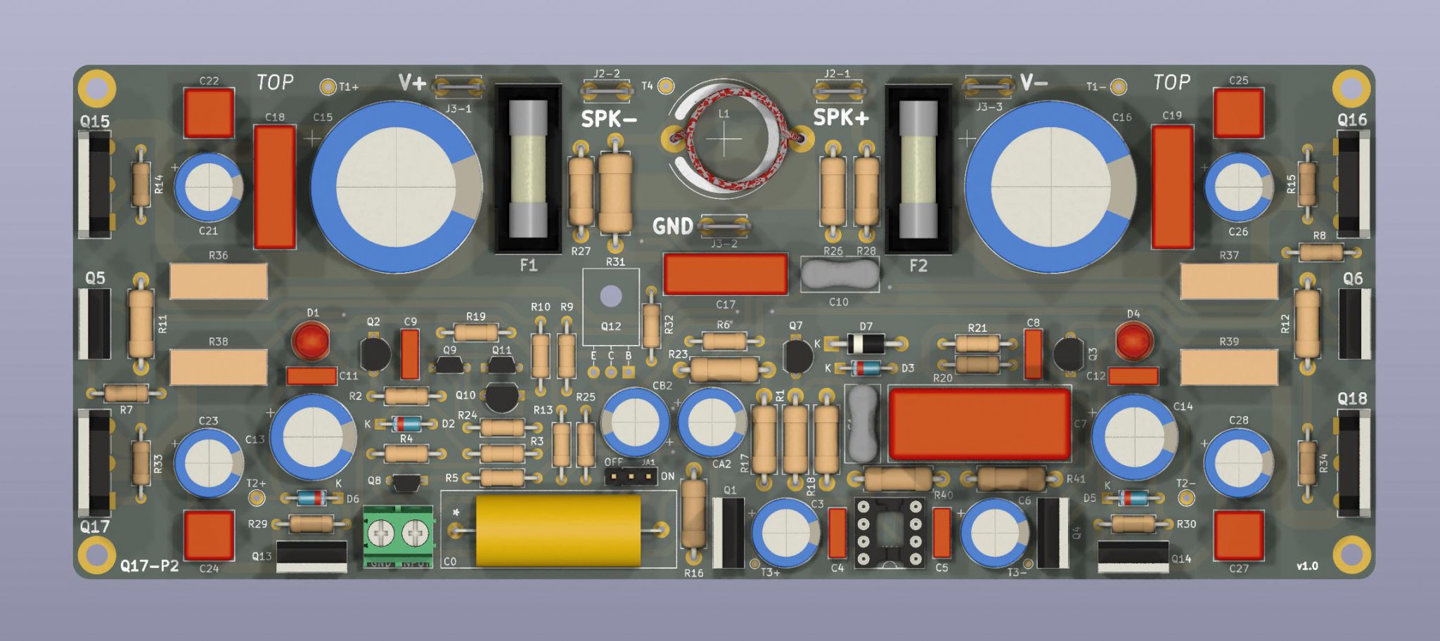

Hello,
I am pleased to announce the availability of the Q17-P2 PCB.
Gerber files, dedicated diagram and pictures are available on my GitHub repository.
https://github.com/stefaweb/Q17-a-QUAD405-audiophile-approach/tree/main/Q17-P2
The Q17-P2 is a more evolved version of the Q17-Mini that I previously made based on the Tibi diagram.
The Q17-P2 in brief:
Enjoy!
Stef.
- Two pairs of FQA Power MOSFET at output.
- PCB size: 190 x 75 mm (230 mm with soldered power resistors).
- DC Fuses incorporated on the PCB.
- Power capacitors of 25mm diameter up to 4700uF.
- Big footprint for most of the important resistors (can fit Dale).
- Big footprint for important film capacitors.
- Optional SMD footprints for C4 and C5 on the back.
- Optional capacitors at the bottom of the FQA transistors.
- New optional resistors to protect opamp inputs.
- Two footprints for C2.
- New C0 footprint capacitor at input to protect against DC.
- Integrated jumper to bypass C0 capacitor.
- New optional D7 Schottky diodes (opamp psu regulation).
- New 13mm 1.2uF coil using 1.5mm wire for better thermal and current performance.
- New test points for power lines and speaker output.
Enjoy!
Stef.
