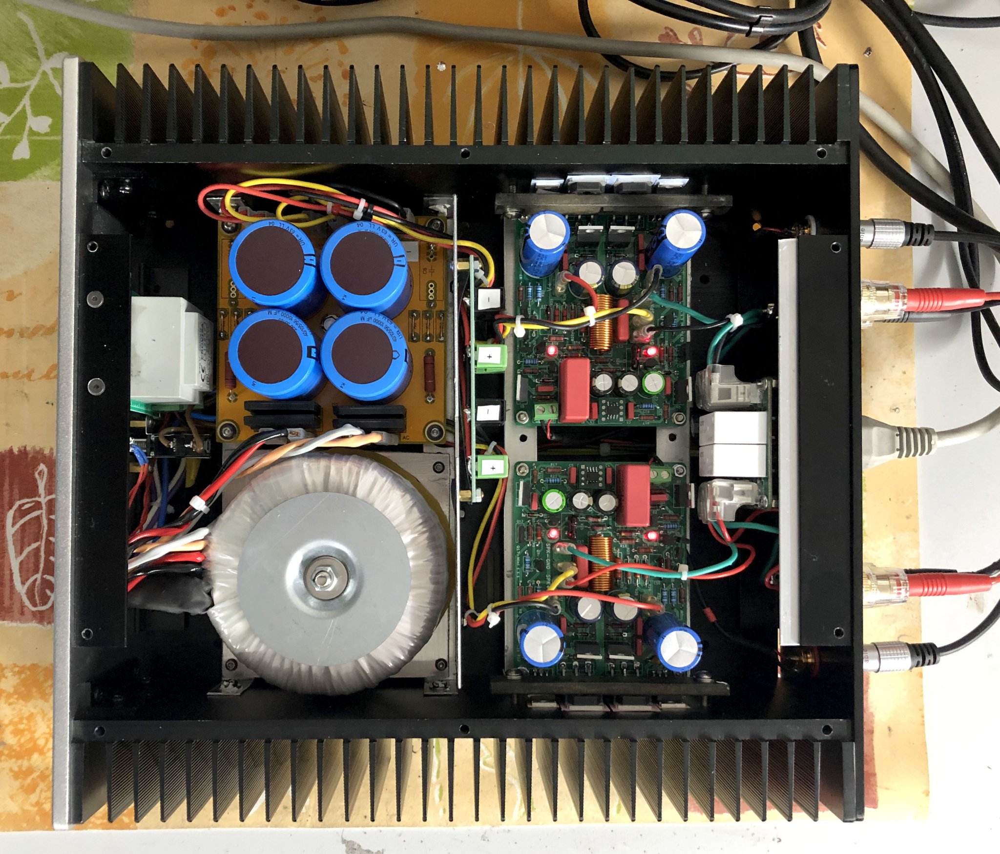

Personally, as I am often dizzy, I preferred to add fuses for the Q17-MIni. ;)

Stephane,
I see you have two diode rectifiers in parallel. This will increase noise and I highly recommend do not do so. Use a sigle pair or diode or make use of synchronous rectifiers.
I know that I already mentioned synchronous rectifiers several times by now, but the effort to use them make a huge difference.
Tibi

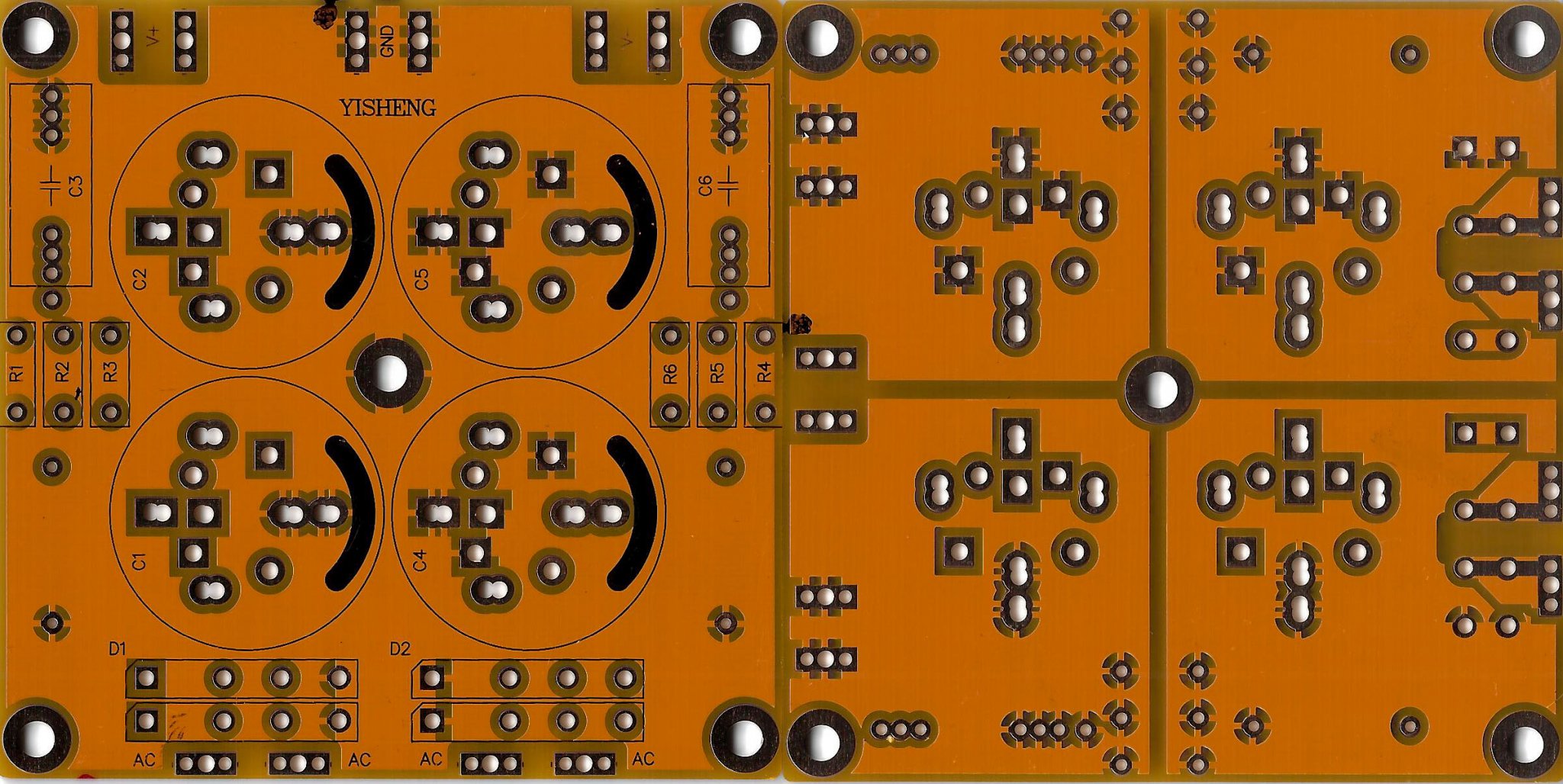

Hello Tibi,
I only have this board that fits in my box. It works well. I have used it for other projects without particular concern. For the noise of the double diode bridge, I do not hear the difference. Maybe with the scope?
I don't know if we can remove one of the bridges for each supply rail. Here is the PCB in close-up front and back.
By ear with my small broadband HP which serves as a "headphone", the background noise (like white noise) is less important with this power supply than with the SMPS power supply. On the other hand, I hear a very slight noise of 50Hz residue that I do not have with the SMPS. It is practically inaudible with speakers (ear glued to the speaker). I have not yet redone the measurements with the final config in the box.

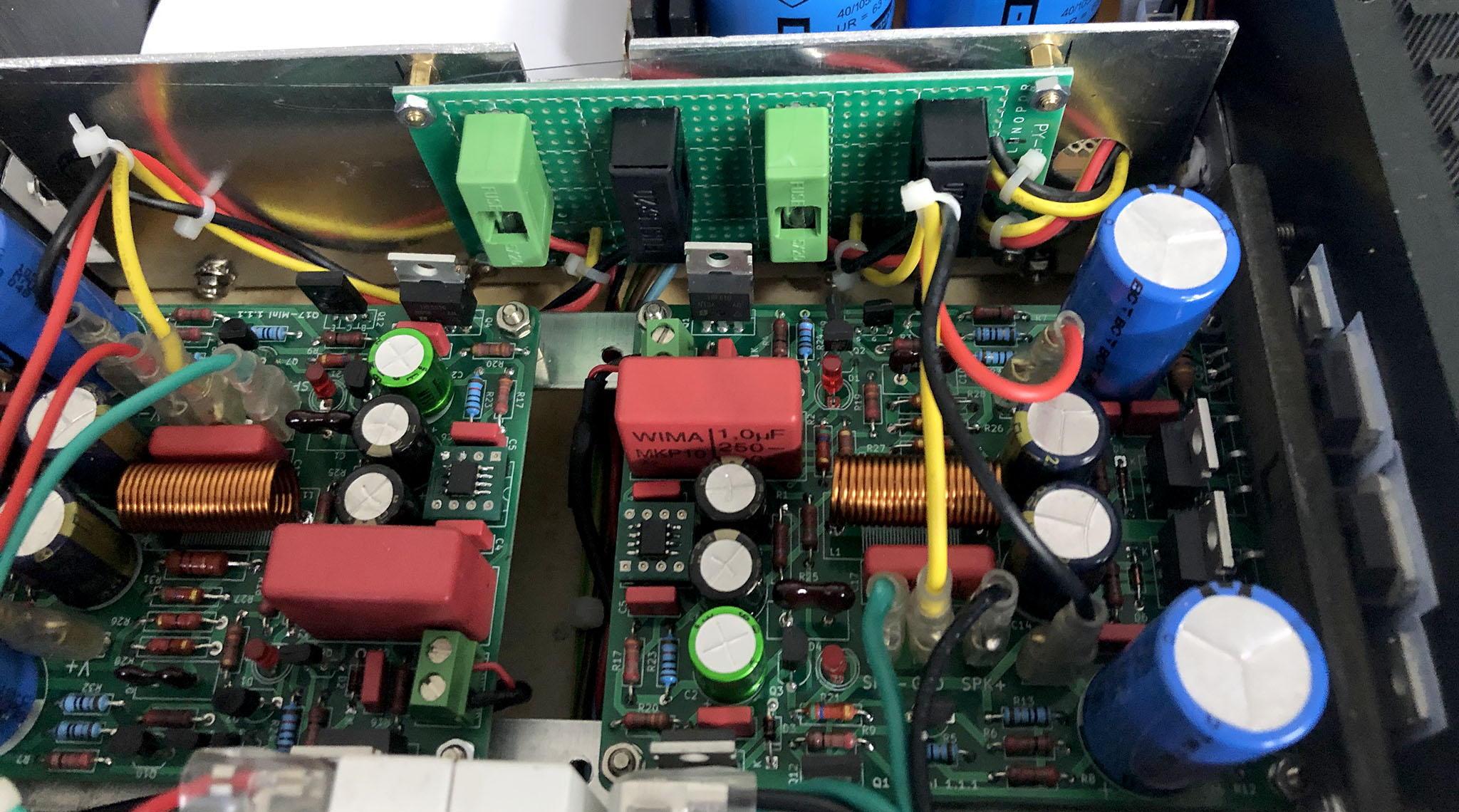

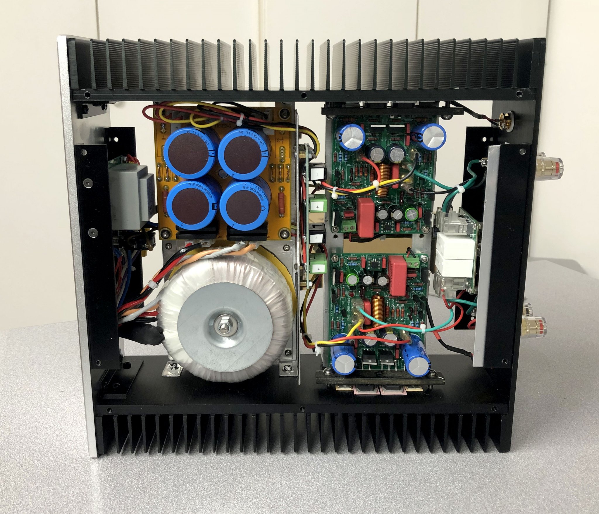

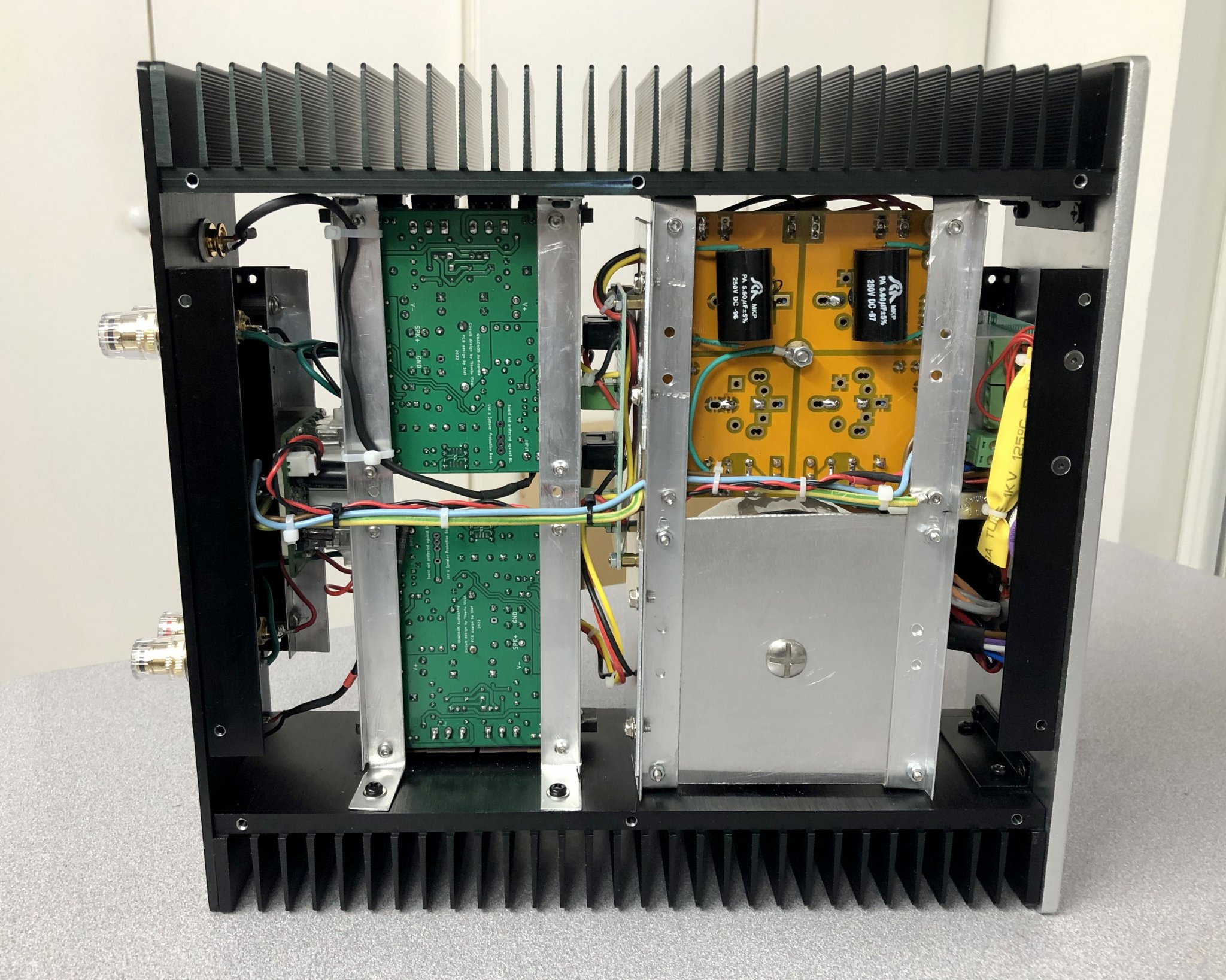

A few more pictures of the amp.
