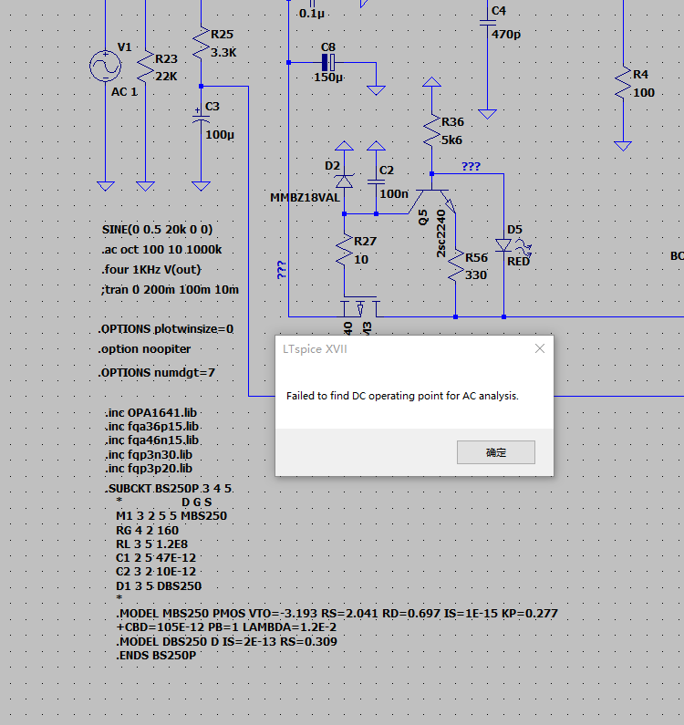

I'm a beginnerTo properly run Q17 simulations, several libraries must be included into project.
These are proprietary, but can be downloaded from:
OPA1641 ->https://www.ti.com/lit/zip/sbom627 unzip and extract OPA1641.LIB
FQA36P15 -> https://www.onsemi.com/pub/collateral/fqa36p15.lib
FQA46N15 -> https://www.onsemi.com/pub/collateral/fqa46n15.lib
FQP3N30 -> onsemi
FQP3P20 -> onsemi
Download these and place in the same directory with Q17 ltspice asc file. Open simulation file with ltspice and include following spice directives:
.inc OPA1641.LIB
.inc fqa36p15.lib
.inc fqa46n15.lib
.inc fqp3n30.lib
.inc fqp3p20.lib
To run transient, uncomment ;.tran 0 200m 100m 10m
Tibi
Failed to find DC operating point for AC analysis.

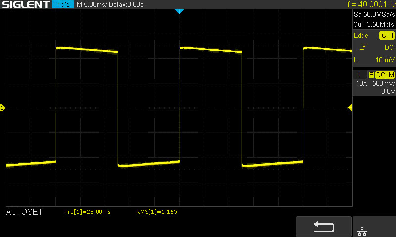

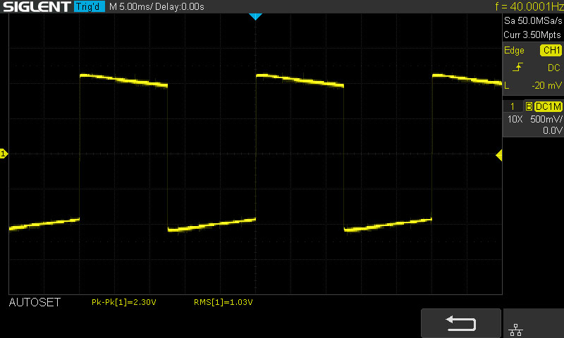

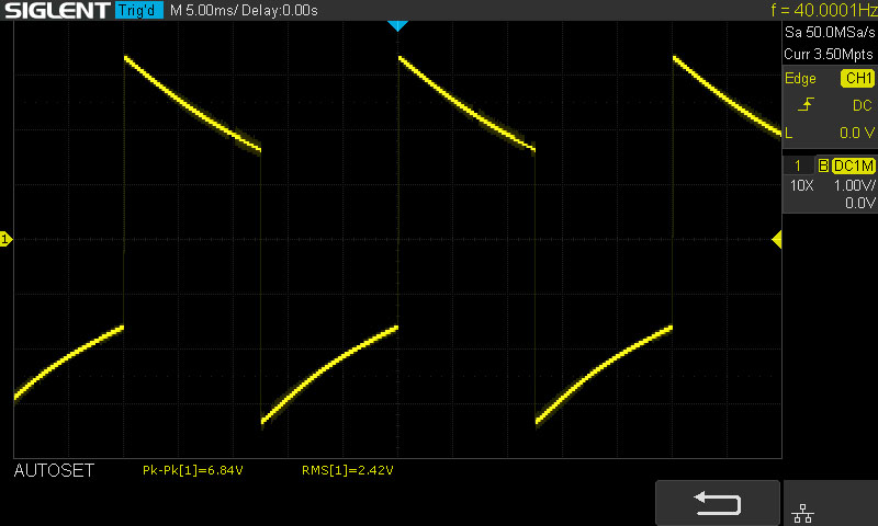

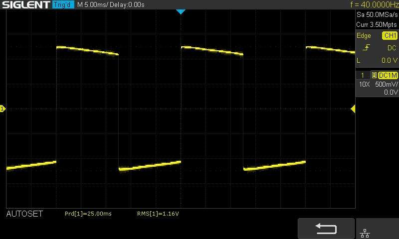

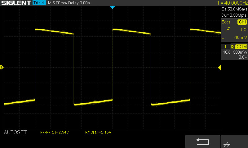

Hello,
Some tests with different capacitors for C2, C3 and C6.
Frequency: 40Hz
Input: 23mVRMS, output: 1.12vRMS
First picture (standard config):
C3, C6 = 100uF/25v, C6 = 100uF / 16v BP Muse:
Offset: 41mV
Second picture:
C3, C6 = RFS 10uF/16v, C6 = 100uF / 16v BP Muse:
Offset: 41mV
Third pictures:
C3, C6 = RFS 10uF/16v, C6 = 2x100uF / 6.3v RFS:
Offset: 42mV
You can easily see the influence on the signal. We can't see very well on the pictures but with 10uF in C3 / C6, there is noise around the square signal.
Stef.

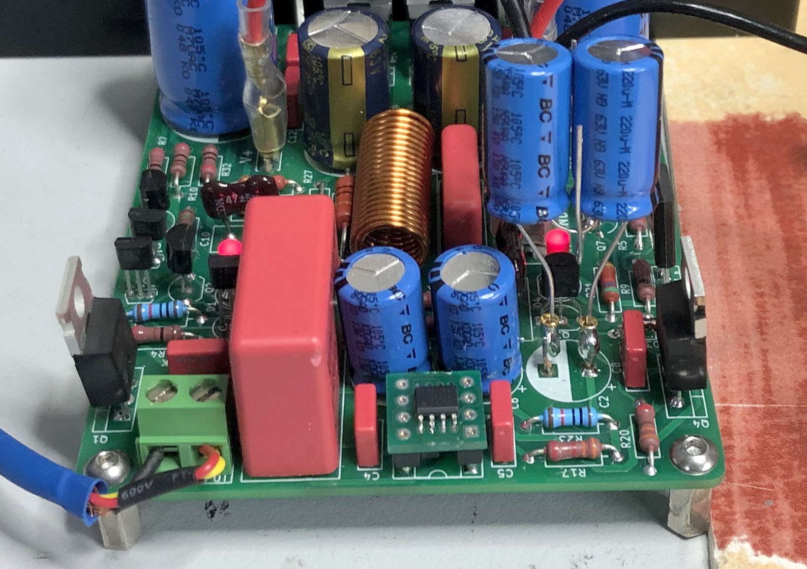

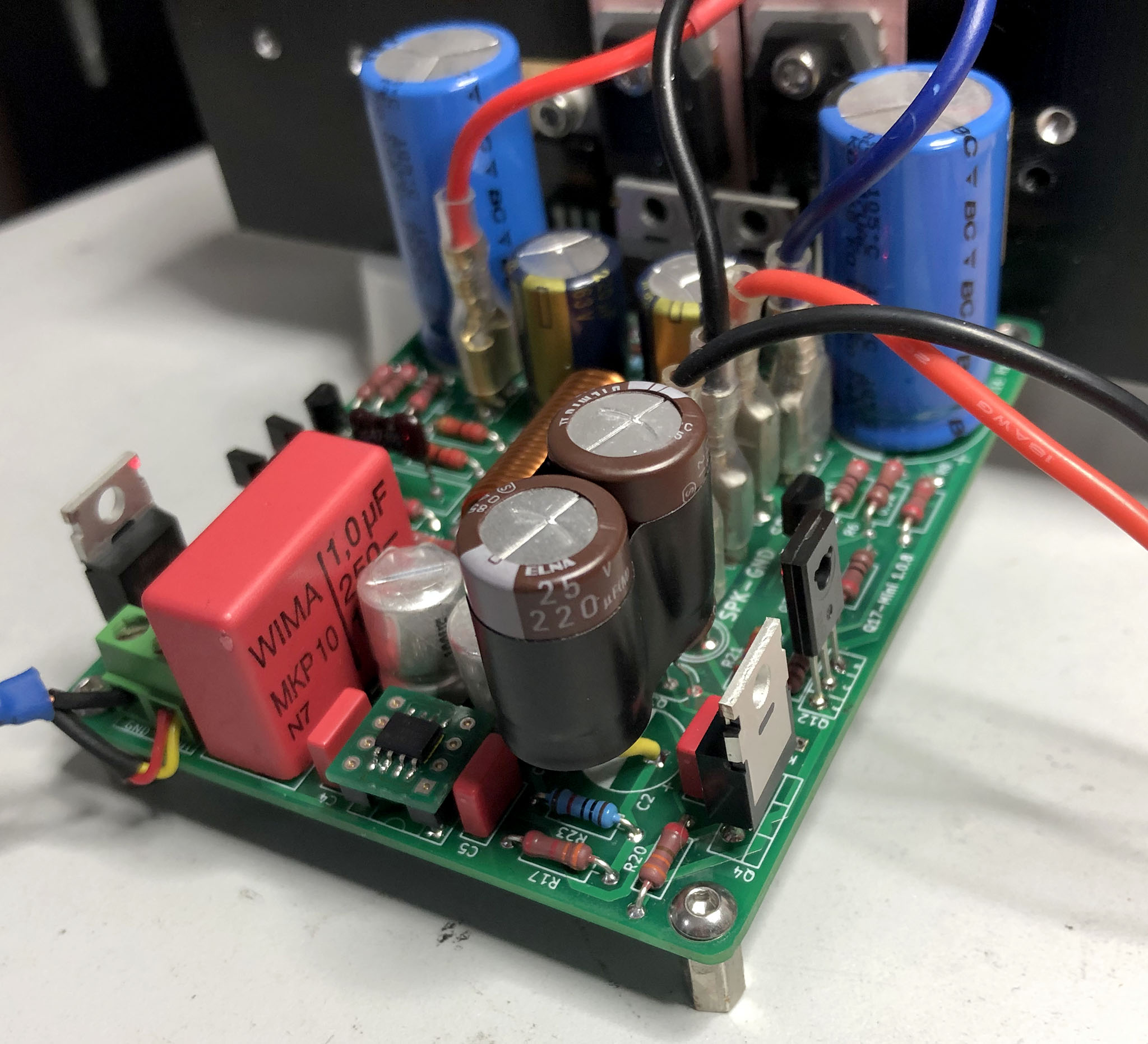

Hello!
More C2 test with 2x220uF.
I mounted C2 on a tulip socket. It is faster.
Tested Panasonic FC, Vishay BC 150 and Elna Silmic II. See name of the picture.
The FC is the worst (on the scope as well).
I have the impression that the bigger the capacitor is physically the better it is.
Stéphane
Stéphane
Is not an impression. Physically bigger electrolytic capacacitors sound better....
Tibi
It is obvious with the Silmic. The 220uF 6.3v (D5) is very very bad and the 25v (D12.5) version is ok.
