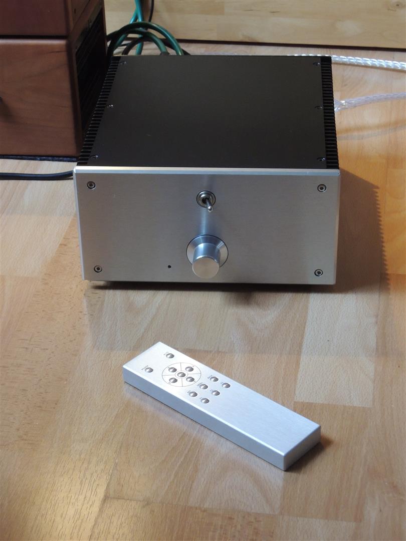

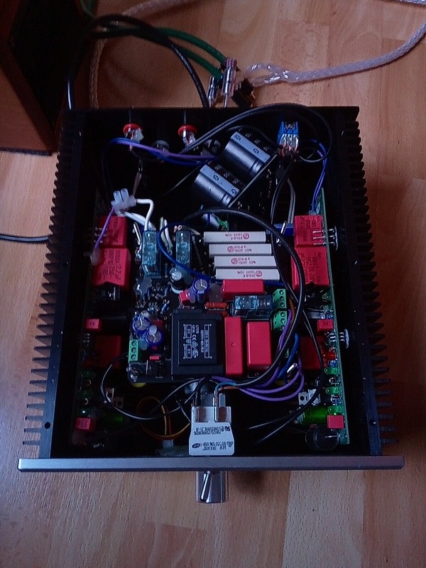

Hello,
I have built another Q17, this time a copy of the flatter one, but with soft start, speaker delay and speaker protection circuit, and radio controlled potentiometer.
Plays great.
Regards Tim

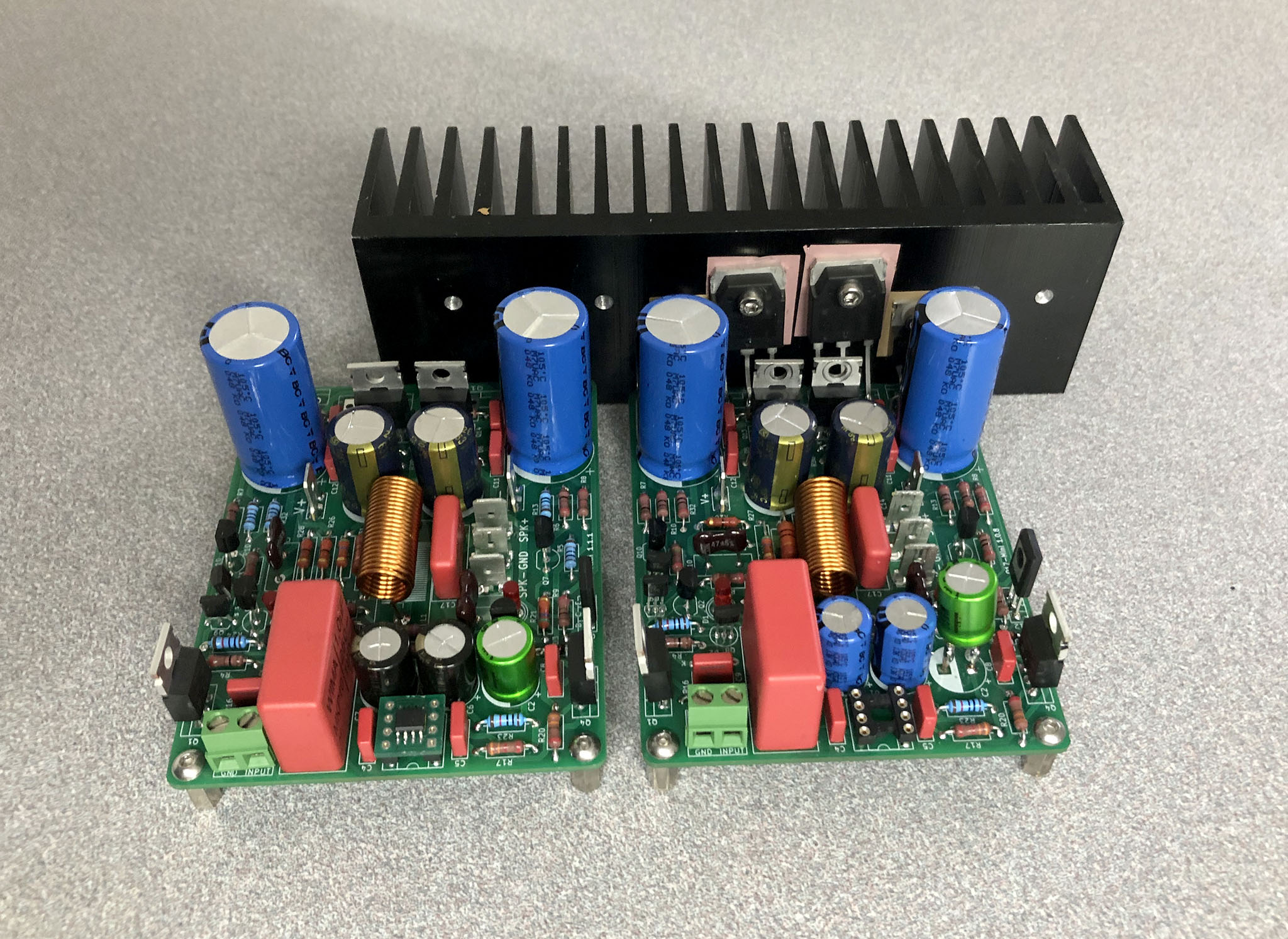

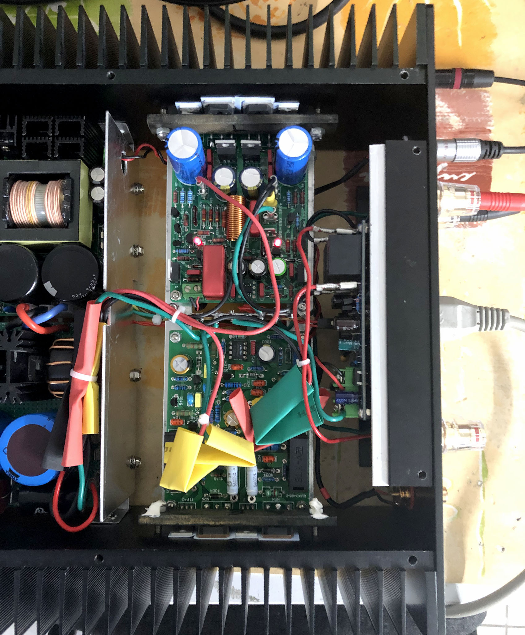

Hello,

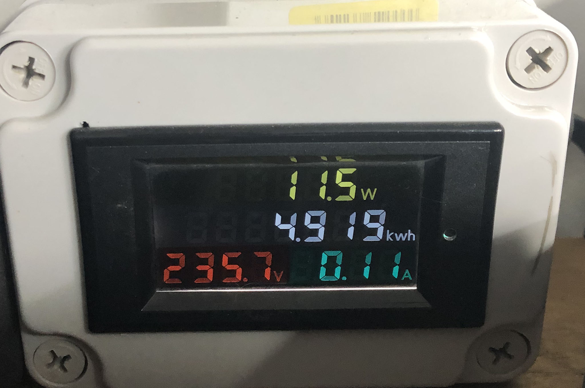

Just to let you know that the Q17-Mini's production PCB 1.1.1 works without a hitch. I built one and installed it in the cabinet.
One board consume 11.5W.
On the other hand, I have to order components for the second card again. With all my tests and burnt components, I am missing some now.
Stef.

No, I would like to keep the prototype to tinker with and assemble a board with the final PCB to put in the cabinet.
I'm still going to tinker to use both cards at the same time to test in stereo.

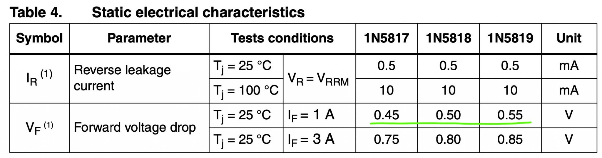

Tibi, could you look on Mouser to find me a suitable Schottky diode? I am a little lost with all these references, the Fv which are given for different consumption and the out of stock problem.
Stef.
Sorry Tibi but there must be something I didn't understand.
The 1N5819 is given for a Fv of 450mV far away from 350mV.
Stef.
And this 1N5819 from ST?
https://www.mouser.fr/datasheet/2/389/cd00001625-1795544.pdf
Or the SB series from Vishay?
https://www.mouser.fr/datasheet/2/427/VISH_S_A0003154141_1-2568705.pdf
Vf is a function of If - forward current. At 1A Schottky diode will have a forward voltage of 0,55V, but under 100mA this will be around 300mV.
Look for datasheet graphs.
In our case If is under 5mA.
Tibi

Hello Tibi,
I built the amp because the first one
https://www.diyaudio.com/community/...approach-to-perfect-sound.374507/post-6776372
has already moved out to an excessive speaker hobbyist and I want to have that as a comparison, also to test the additional comfort functions. It is nearly the same, but with a 120VA 2x 24V Transformer (even less Current).
Currently I am building an amplifier based on the latest PCB creation of mine, which contains additional components and of course I want to know if these modifications somehow make themselves noticeable.
Regards Tim
