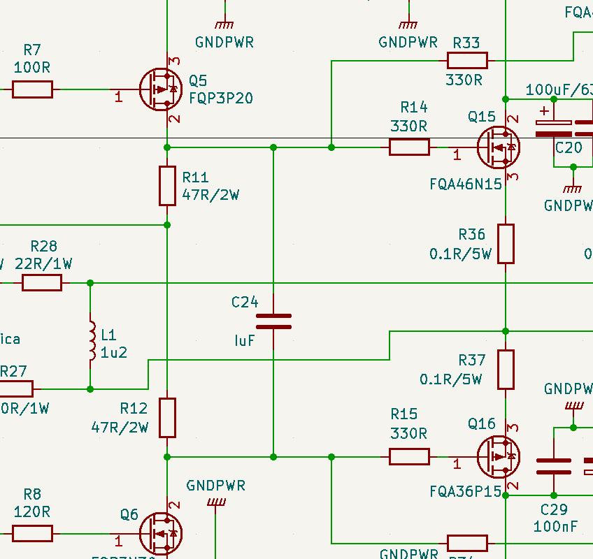

Stef,
Before adding 1uF between Q15/Q16 and Q17/Q18, I suggest you to listen the amplifier in stereo. I mean to give a serious listening session, at least few hours.
Than add that capacitor and listen again.
You may simulate and measure first, but what I suggest is that any modification you made from original Q17 to be based on a serious listen.
Trust your ears.

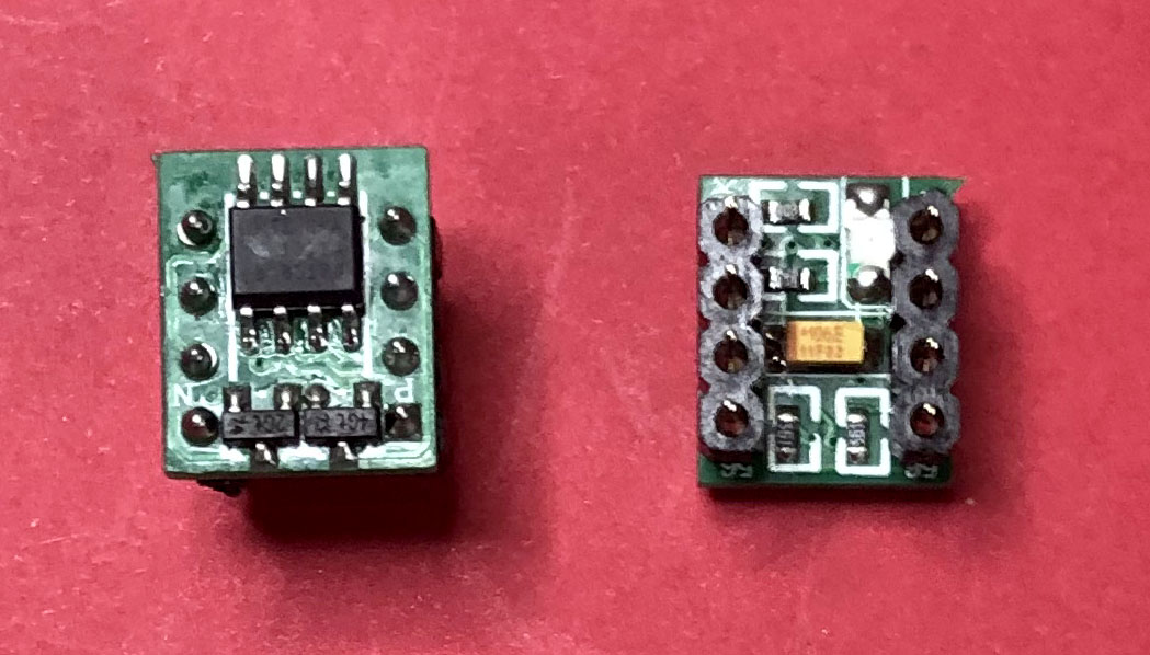

What is the role of that circuit ?...
OPA1611A with a circuit on the socket.
I see no reason that Q17 do not work with a very large number of opamps.
Tibi

The general amplifier NE5532 OPA2604 output current less than 50MA, OPA1611 + A class after the expansion of output up to 200MA, greatly increased the driving force, the circuit has a better match, lower output impedance, high and low level, dynamic So the performance is very good.
This product on the basis of 1611, add 1 pair of NPN PNP complementary symmetrical 500MA current level Philips low noise tube, so that the output capacity increased by 4 times, and run in the state of class A, the sound quality is very full and delicate and warm.
Transparent, analytical power is very good, open sound field, better than OPA604
OPA1611 (Single Channel) Bipolar Input Operational Amplifier achieves very low noise density at 1kHz
(1.1nV/√Hz) and ultra-low distortion (0.000015%). The OPA1611 and OPA1612 are capable of providing rail-to-rail output in the range of 600mV from the supply rail at 16-600 ohms load, which helps to maximize dynamic range.
These devices support a wide supply voltage range of ± 2.25V to ± 18V, with only 3.6mA per channel supply current. The OPA1611 op amp's unity gain is stable and maintains excellent dynamic performance over a wide range of load conditions.

Why with such a large capacity?Just bypass R11 and R12 with only one 1uF capacitor. Connecting the gates of Q15 and Q16
Couldn't 1nF be enough?

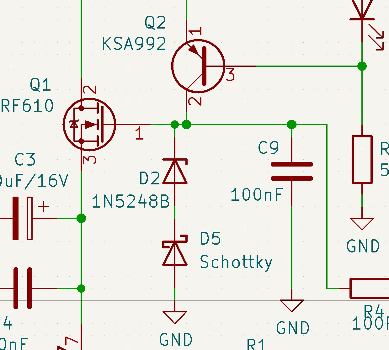

Hi!
Modified on GitHub.
I tried with a 5K trimmer instead of Zener D2 and D3. I preset trimmers to 3K75 and turned on without opamp. I got around 12V on each rail but something it's broken somewhere now. The R27 was hot and I got -43v at speaker output.
I put the zeners back on and I still have -43v now. I have to find what broke.
The joys of testing ...
I have not tried with schottky diodes. I did not find any small schottky diodes in my stock, only large 10A ones.
Have a nice day.
Stef.
Is not a good thing to power the amplifier without opamp, because Q7 base will float. If you want to do so, please add across C1 a resistor - anything between 1K and 100K should be ok. Than remove opamp and make the tests.
Tibi
Tibi
It started with a good feeling. I didn't want to burn U1. 😉
Q4 9610 dead. Soldered a new one.
Controled Q1, Q8, Q5, Q6, Q12. They are OK
D2 and D3 ok.
Still -43v.
Next?

Q7 is OK. The amp is back with an opamp socketed. 40mV at output.
Result of my test: Q4 burnt.
My opinion. This modification is dangerous because it burns without opamp, therefore complicated to adjust the voltages of the opamp. and if you insist, other components will burn too due to heating.
I'm going to search my boxes again for small schottkys. If I can't find what type of schottky would be good for testing?
Stef.
