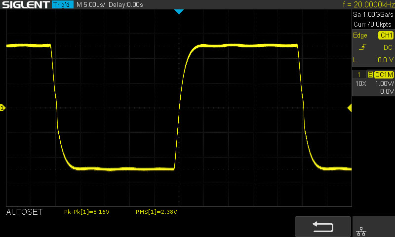

Thanks.
A little too round at 20KHz (IMHO).
Stef.

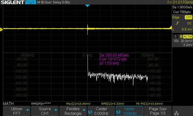

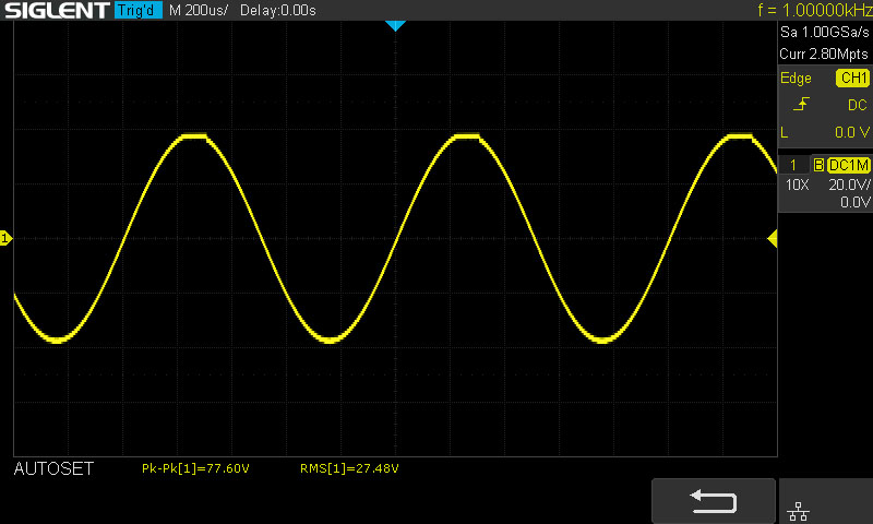

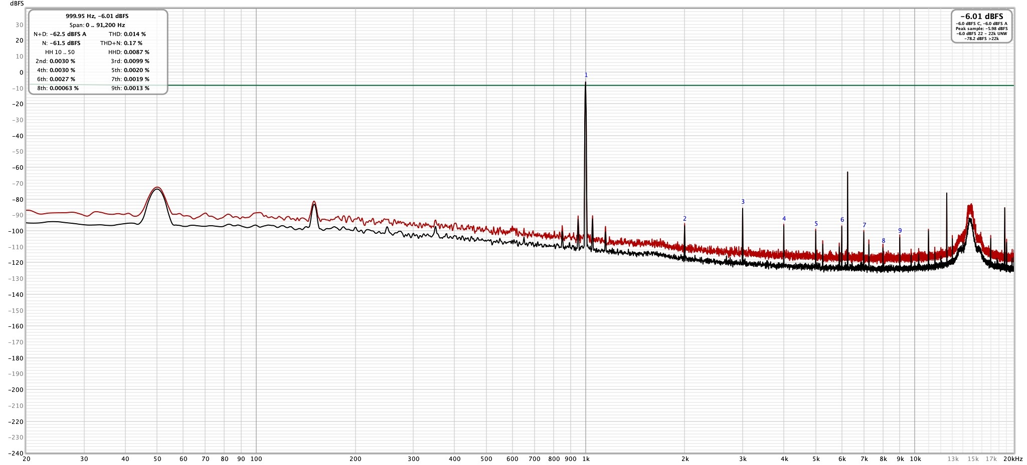

Hello Tiby,
I didn't know about the influence of harmonics on the square signal.
I redid some measurements with REW and the scope. I put the files on the Github repository for those who are interested.
I tortured the amp a bit to see how it behaved with a high signal. No parasitic oscillation, no heating on the PCB tracks, and it clips high enough. With 48V DC and 8R charge, the amplifier clip at 27v for 540mV RMS at the input.
Stef.

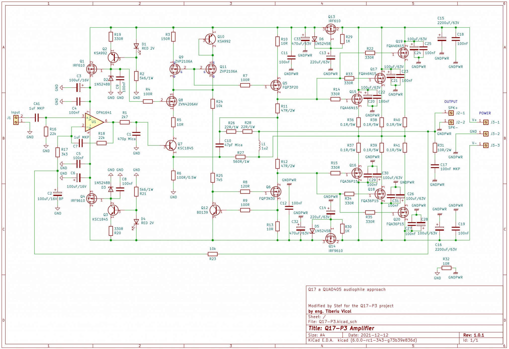

Hi again,
I gave the diagram of the amplifier in 3 pairs version with all the information that I could glean.
Would it be possible to check it especially for the values of resistances and their wattage?
I also added capacitors at the foot of each of the output MOSFETs. I put 220uF/100nF but I didn't know what the minimum value would be.
Stef.
You have a short on the mirror between Q9 and Q11 drains. R29 and R30 must be between 1K and 10K.
Decoupling caps are OK at 220uF, however, larger caps will improve amplifier damping on complex and heavy speakers.
Use a linear power supply with synchronous rectification for good measurements and exceptional sonic performance.
Regrads,
Tibi

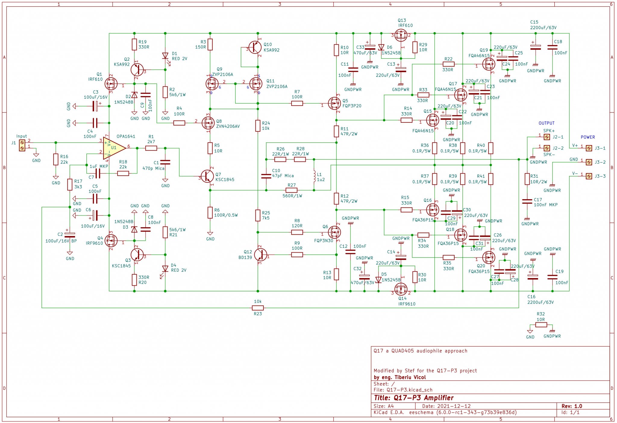

New version.
I changed coupling capacitors for output MOSFET to 100uF (Alex's board use 100uF).
I removed the wrong short on Q9/Q11.
Changed R29 and R30 to 1K (for now).

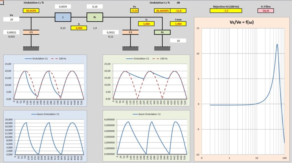

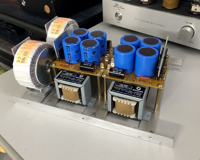

I've more question:
  • What will be the more accurate voltage for a 3 pairs board (and If you know, for a 2 pairs board)?
  • How to have a better management of symmetrical voltage for U1?
  • What about C2 (non polar or double +--+ capacitor)?
  • How to have for sure the less possible level of offset at output?
  • How to calculate the right value for R29/R30?
  • What is the dumping factor of a 3 pairs board?
The goal would be to draw a luxury 3 pairs version (with a compact size, around 75x150 with only 6 holes to drill) if the sound of the one pair pleases me. But if 3 pairs is too difficult, 2 pairs will be nice too.
Stef.
EDIT: what is "D'Agostino monster"?
EDIT 2: I also know how to build good analog power supplies. ;)
The short on Q9 & Q11 drain's is still there and gate and drain on Q11 must be connected.
Q5 gate must be connected to Q8 drain trough R7.
See my schematic here https://www.diyaudio.com/community/...approach-to-perfect-sound.374507/post-6734020
  • For a 3 pairs I'll go for +/-65V. On two pairs still on +/-50-55V
  • As I mentioned, in a previous post, use resistors instead Zenners. Another solution would be to use a schottky in series with zener.
  • I would go for C2 double +--+ capacitor
  • Opamp with jfet input and good C2 and C7
  • R29 and R30, together with C13 and C14 form a low pass RC filter. My calculation was to have a cutoff outside audio band <10Hz. with 1K and 220uF you get ~4.5Hz. This allow smooth amplifier power on and off. No bump in speakers.
  • If you have a good power supply, with one pair is good, with three even better. :)
Tibi
