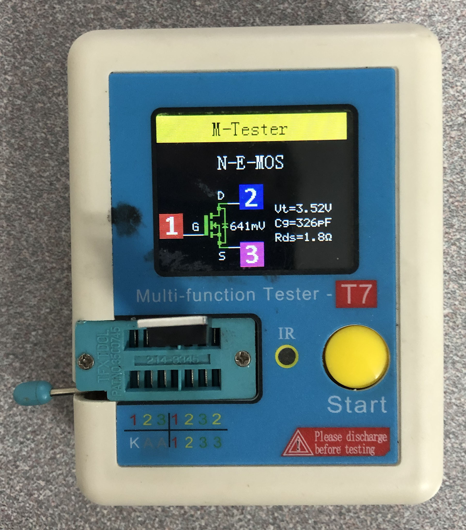

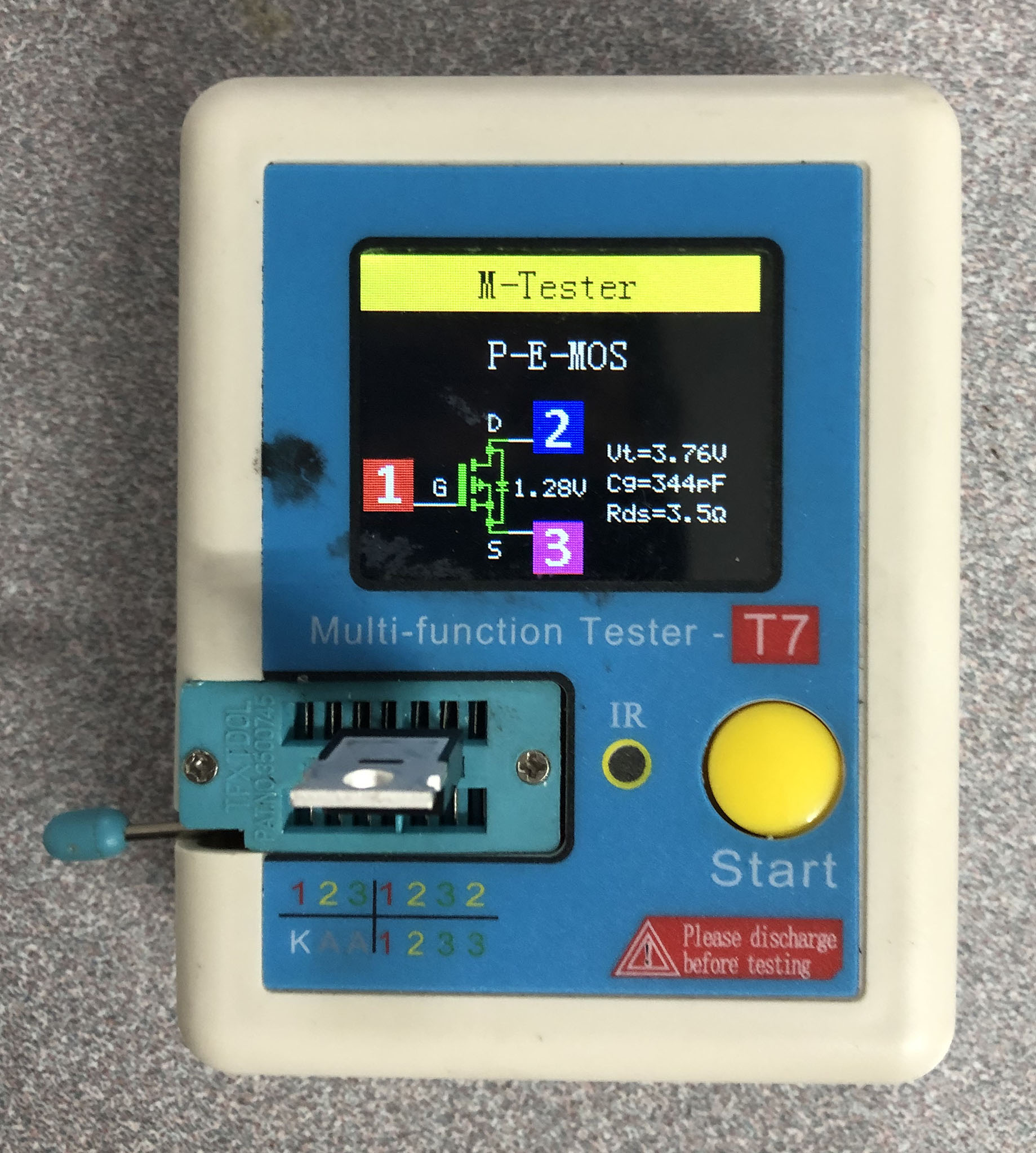

Still on this offset story, another idea.
Can we sort the IRF960 / IRF9610 with the available parameters for the best matched?
Otherwise, we weld a measured P-Chanel and then, we try several N-Chanel in order to try to be as close to the balance. OR we weld only one that we measured and we deduce the best by measuring the others (without welding them).
Stef.

I only have 3 of each left. From experience, it takes about twenty units to make two pairs. Not profitable.
Just to be really sure. The 40mV offset at speaker output come from there at 100%?
We nitpick. 40mV is not death but I like to see the best.
Stef.
Matching mofet is not the best solution. Simplest solution, If you like to have opamp power supply symmetry, is to use resistor instead zener.
Any difference between opamp in+ and in- is reflected at the output in DC offset.
Anyhow, 40mV is low, but can be even lower. :devilish:
Tibi
