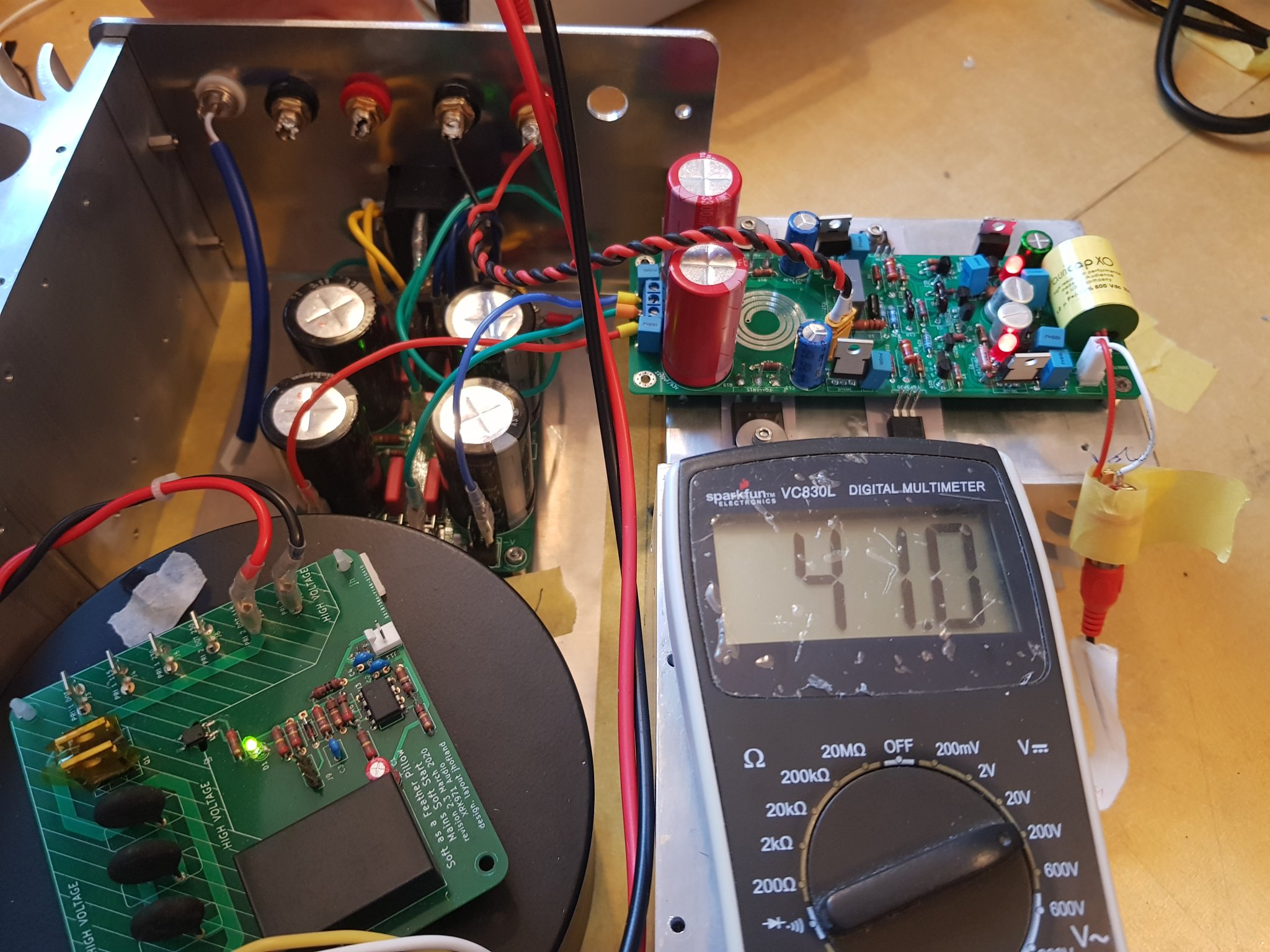

I have desolder the opamp adapter with hot air flow and C6 was inflated for hot air blowing ..so I changed C6 with new cap.
I soldered OPA1641 directly on the pcb and powered it up.
It showed dc offset 41V. It seems that problem becomes more bigger than before.
Hello,
By default R32 = 10R.
R32 is the HBR resistor (Hum Breaking Resistor). Depending on the wiring and ground loops, this resistor can vary from 0R to 10R (the minimum value being 0R1). Without this resistor or a strap, the amp cannot function.
The output offset will vary depending on the resistor value. Less than 1mV with 0R and 37mV with 10R.
Stef.

The direction of trying opamps was opposite direction.
I desoldldered the opamp and soldered the right direction and powered it up.
It showed dc offest over 20V.
Maybe C3, C6 or opamp was demaged
I will try new caps and opamp.

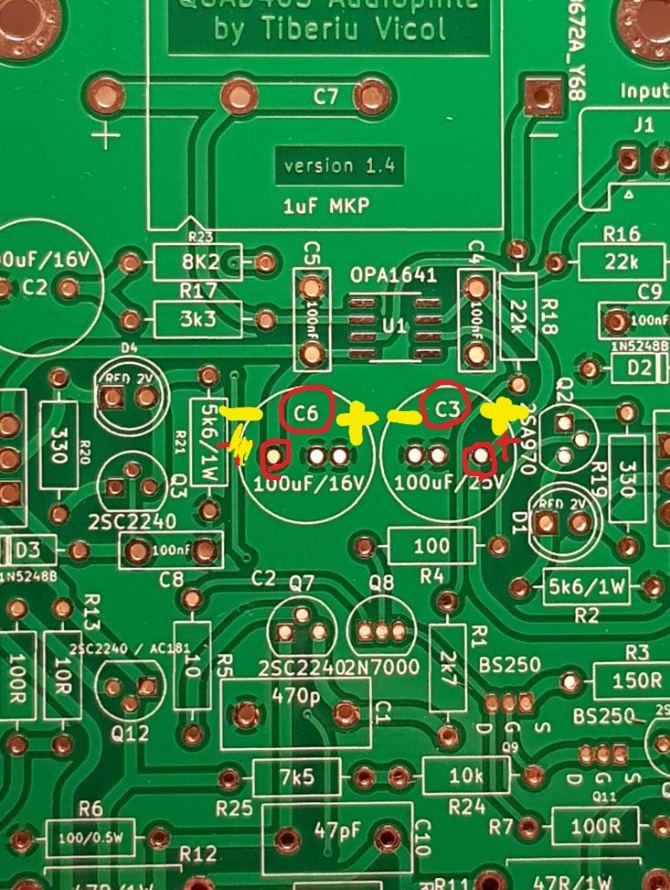

BTW... is polarity of C3 and C6 like this?
