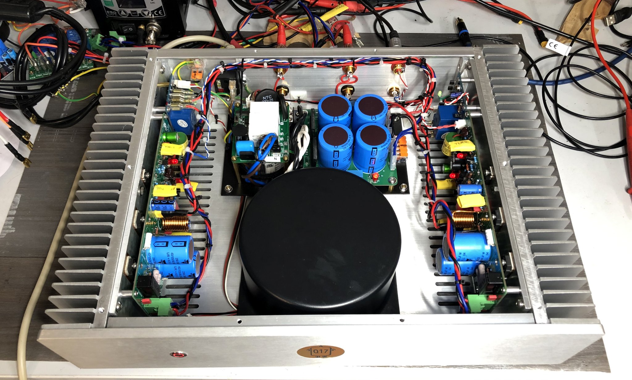

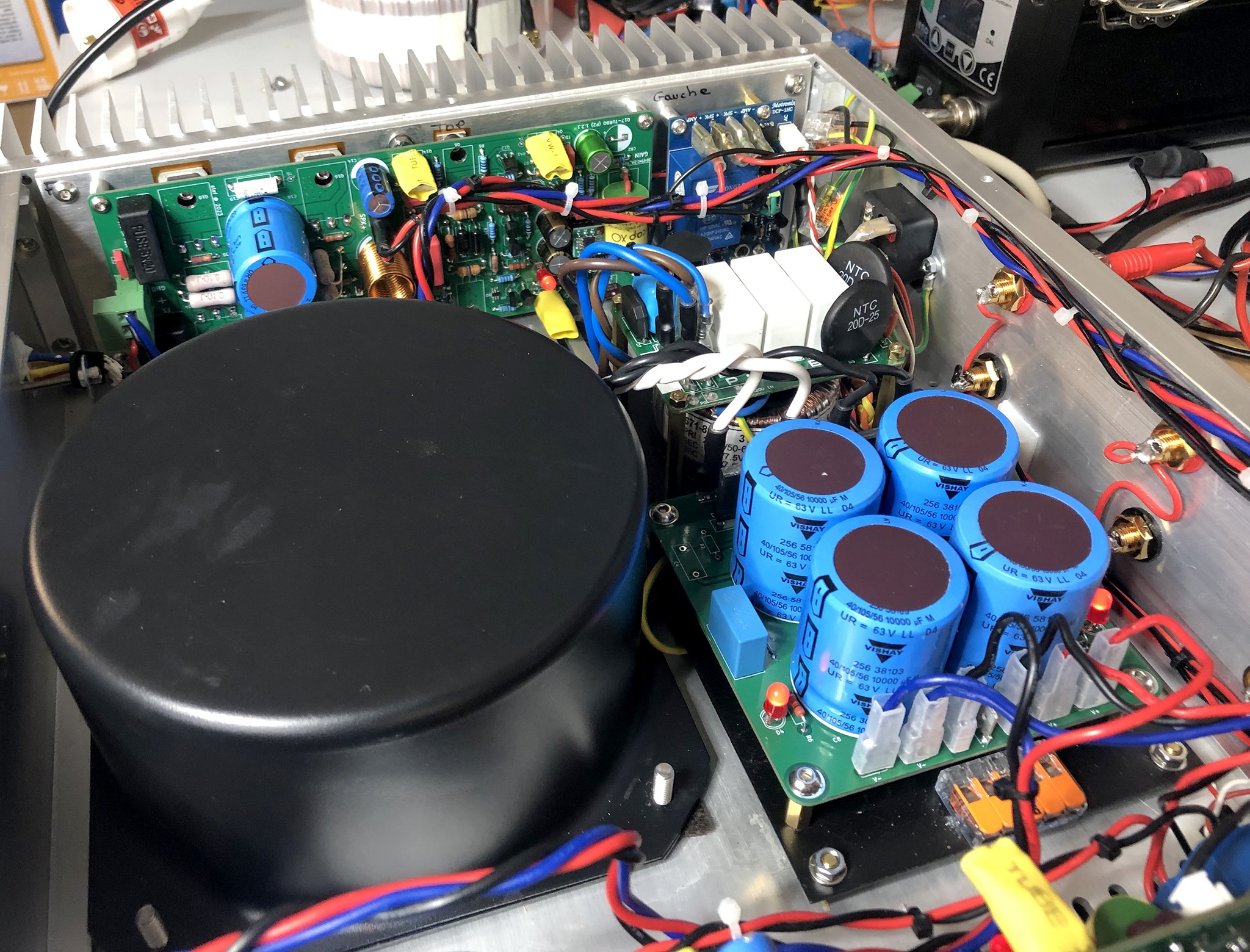

Along the way, I received the new 400VA 244Vac/2x44Vac transformer from TOROIDY. It works. I got 61Vdc with the Saligny PSU and 60Vdc with a regular bridge. I no longer have this enormous 100Hz which spoils the pleasure. I will finally be able to start the endurance tests on the Q17-Turbo in a box.
Stef.
Even after years of amp assembly, we discover new ones every day.

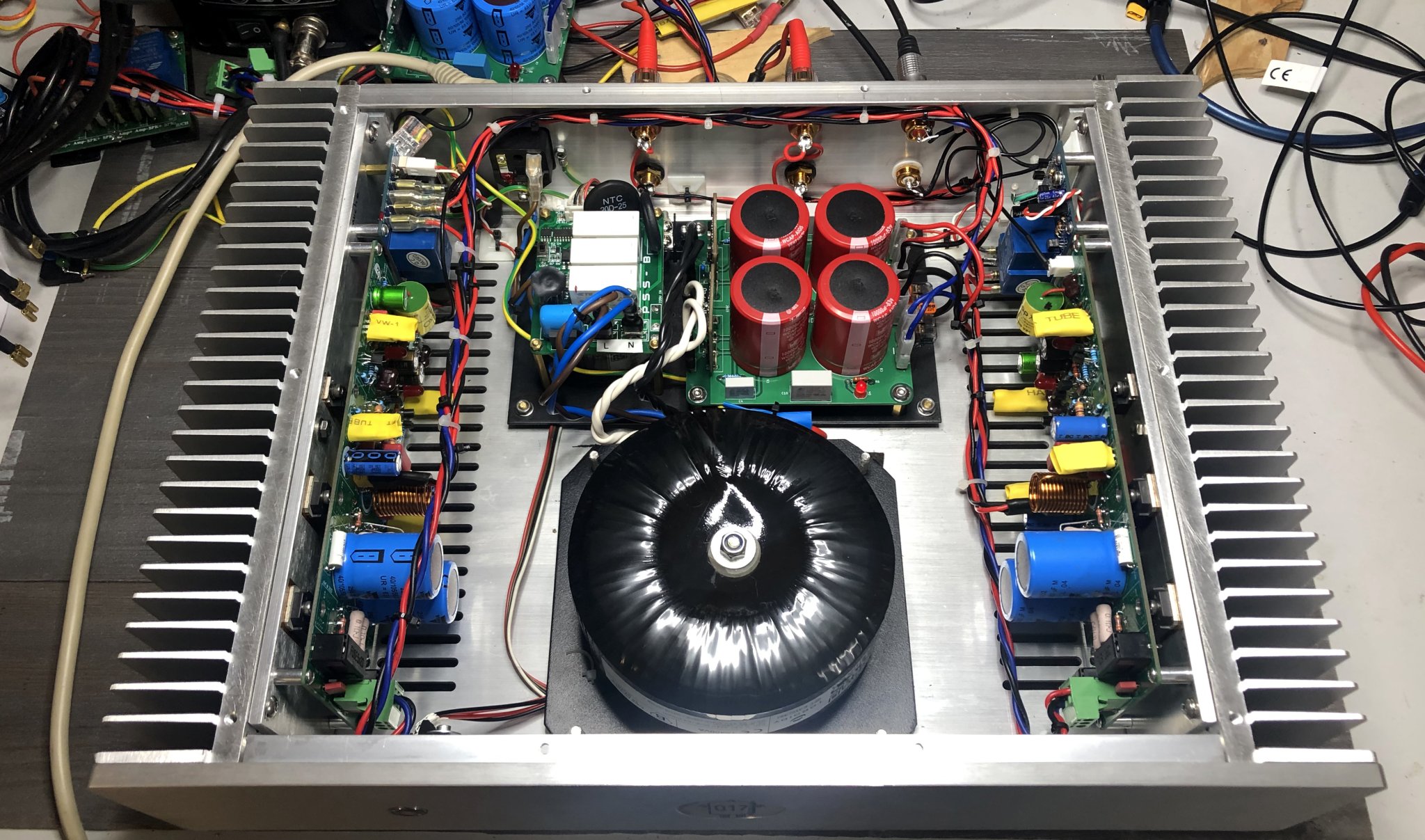

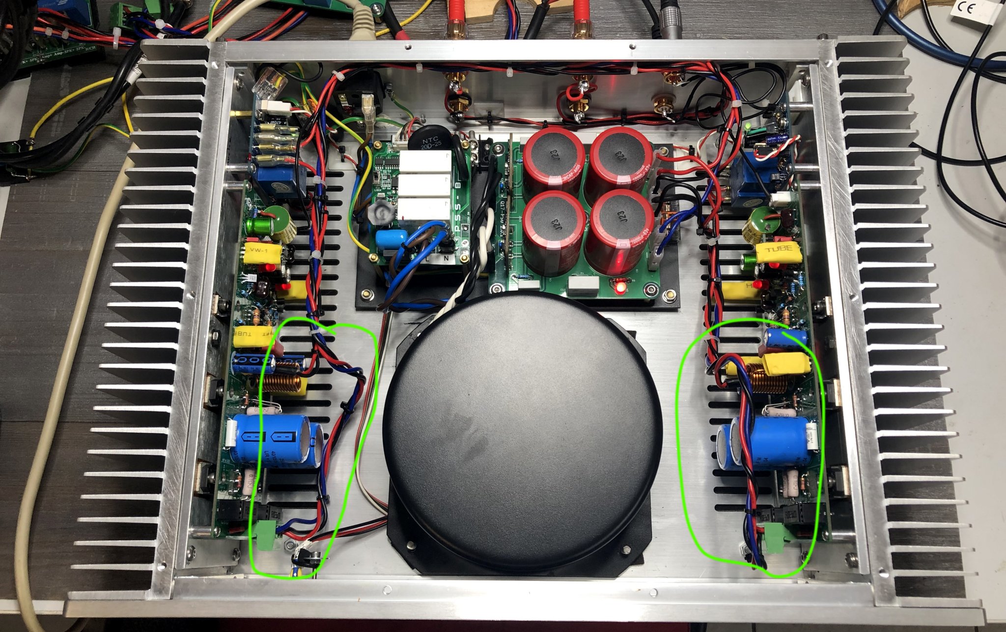

If I wire the power cables on the +60V side of the PCB, ZERO hum. 👍
As in the second pictures.
If I wire in the middle between the blue capacitors, hum, like 10cm from the speakers.
If I wire the cables on the -60V side, big hum.
From theory to practice. If someone who is a math person can explain the phenomenon, it would be great.

Hi Stef,
This is really a very special problem, your hum.
I have the last setup again in the too small housing and the cables simply untwisted stuffed in - because there is simply no more room for cable ties in it - and it hums nothing, it's just completely silent. I find good, my solution.

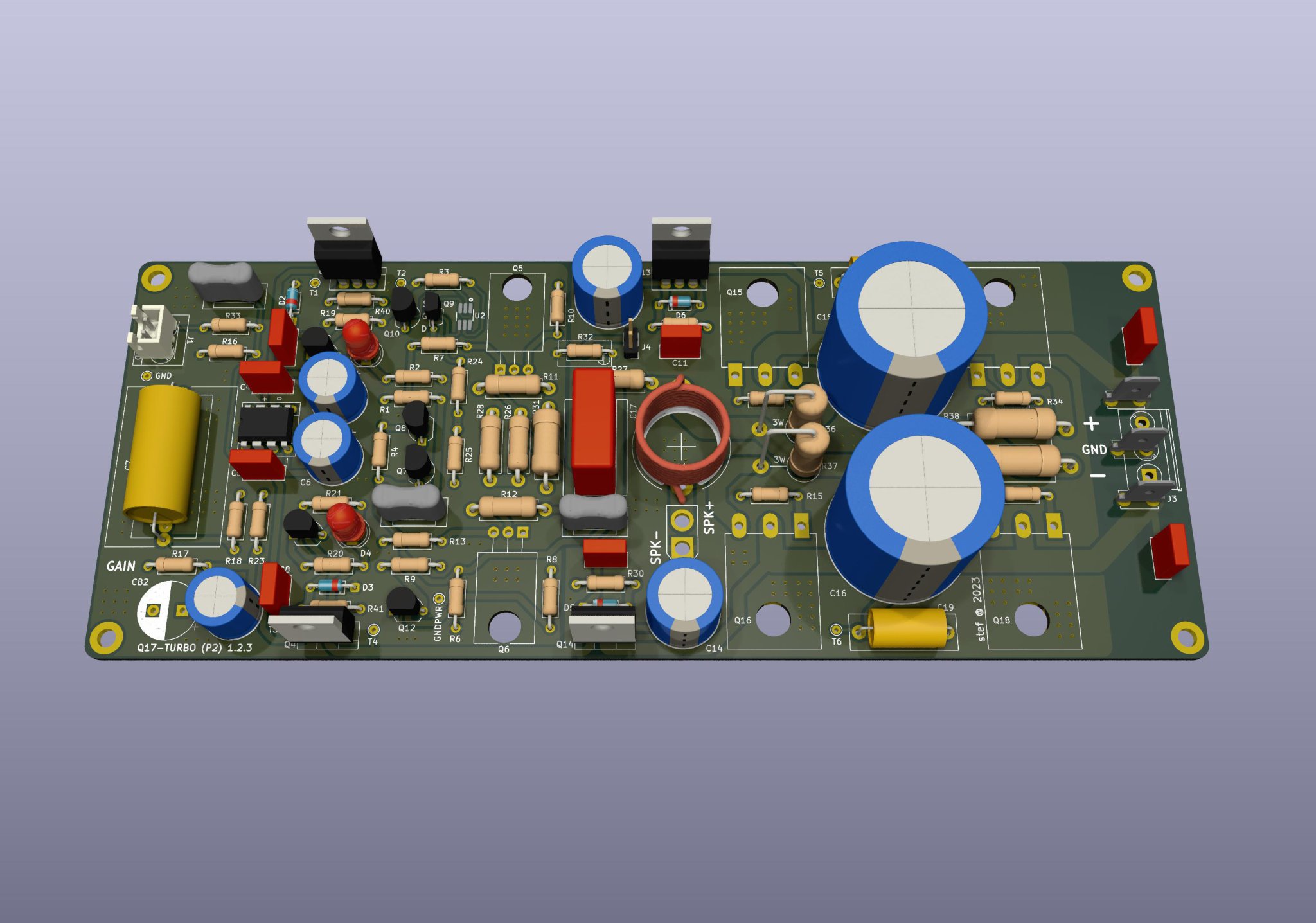

The amp is better with new connectors. I finally only changed the female connector and glued the supports to the PCB so that they no longer move. He's on an endurance test in the background music.

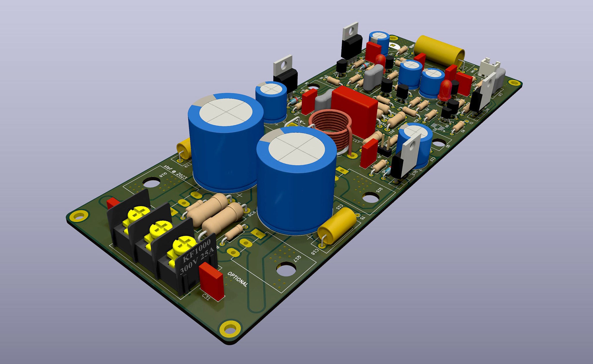

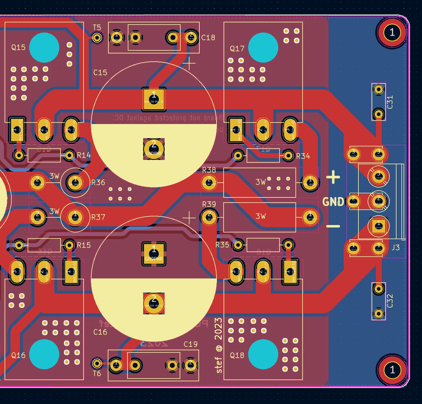

I'm thinking about a next version of the Q17-Turbo PCB with changes to the power connector (and other small changes that I'm working on).
In the current version, I use a 3-pin connector with a pitch of 5mm.
Would you be interested in switching to a 3-pin connector with a 10mm pitch?
This allows for a larger, stronger connector. I took an example with KF1000-3P connectors.
I can also double the input connector with 3 Faston connectors (same as in the Mini) on the same footprint.
If you have any suggestions, I'm interested.
I would take the opportunity to remove the fuse holders which are not of much use in practice once the board has been tested (generally after the tests, I short circuit them from below).

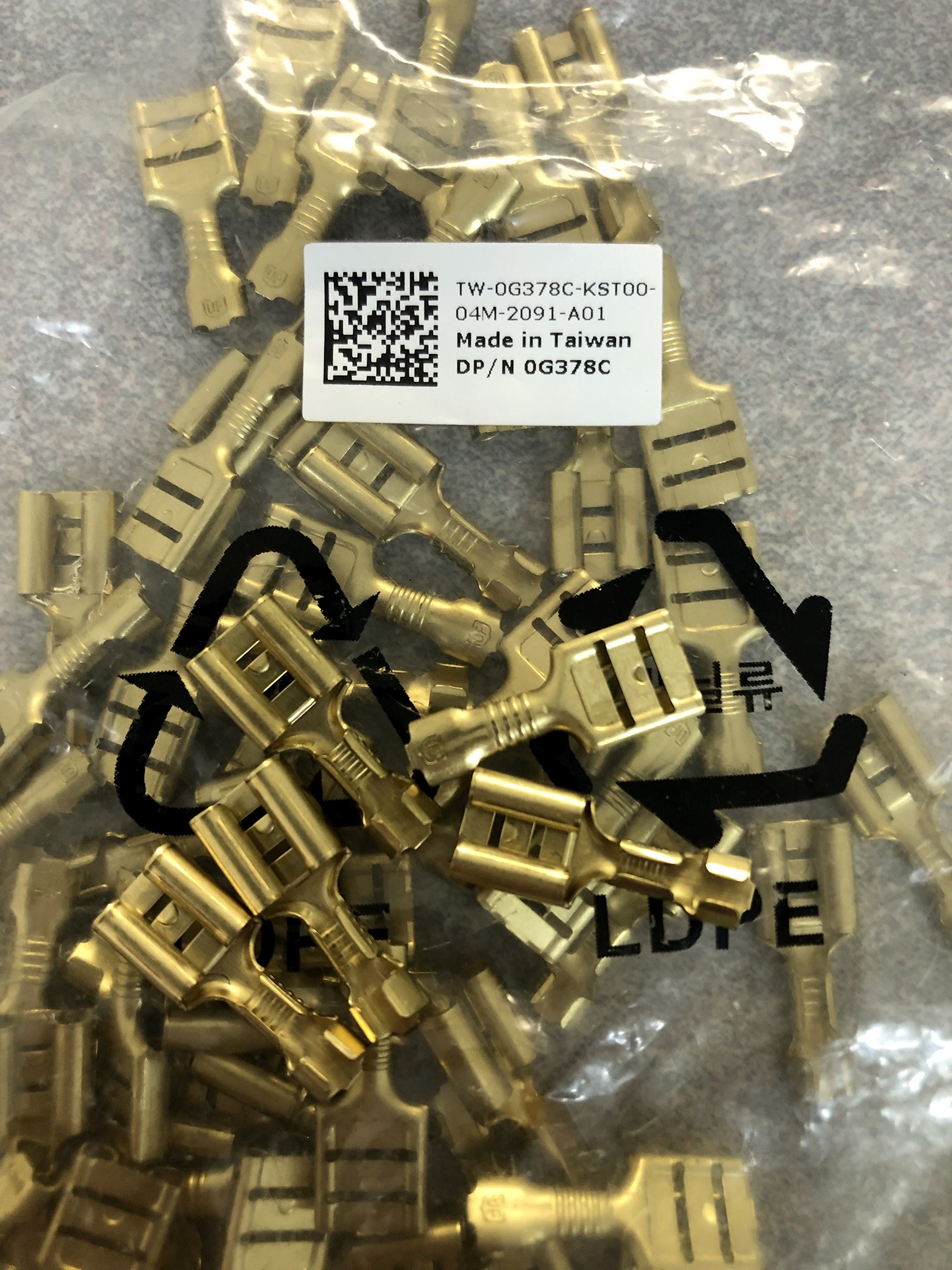

Faston is better, especially if you solder it!
But copper faston are very rare.

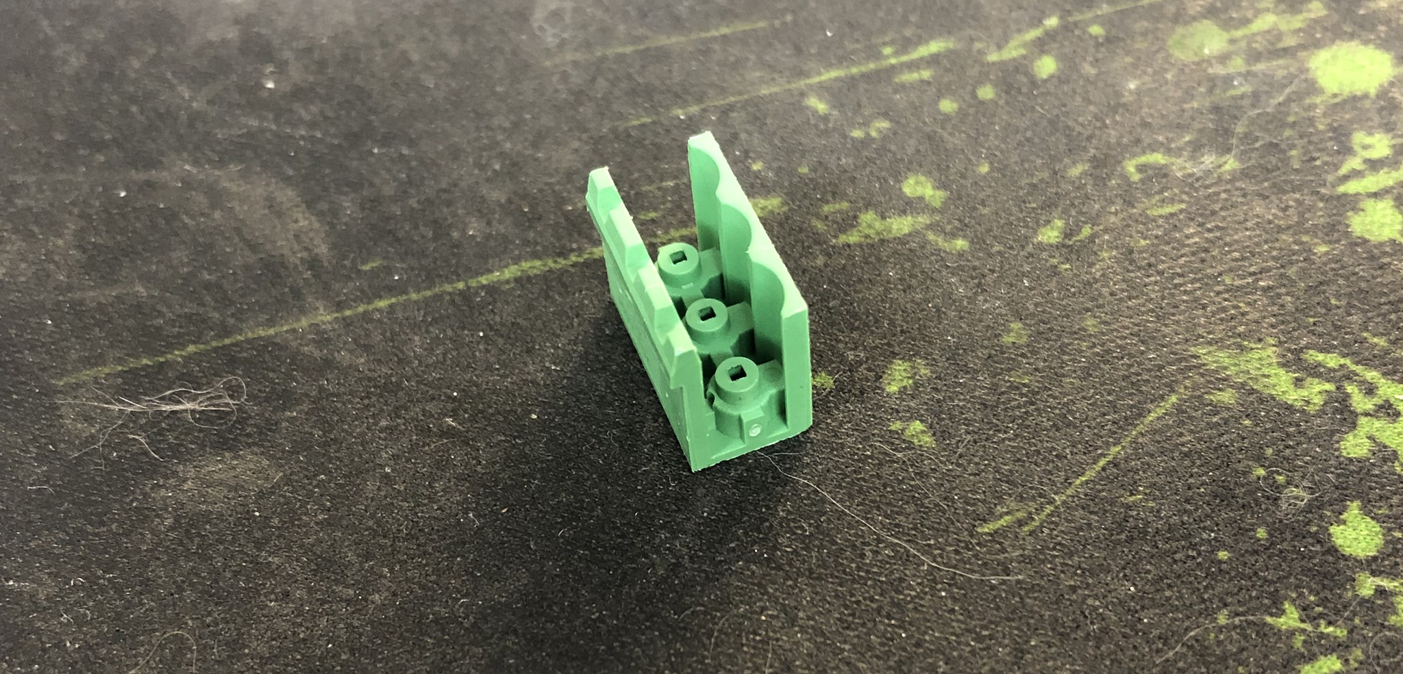

On another subject, I did some research on a 3-pin connector with a 5mm pitch better than those I have in stock.
I found this connectors (male female). The support has a closed shell which does not deform and the pins are 1mm2. They are reasonably priced. They are also found among the Chinese Ali shops.
Series 2EDGK and 2EDGVC (Originally manufactured by PHOENIX CONTACT).
https://www.tme.eu/fr/details/2edgk...ectables/degson-electronics/2edgk-5-0-03p-14/
https://www.tme.eu/fr/details/2edgv...ctables/degson-electronics/2edgvc-5-0-03p-14/
https://fr.aliexpress.com/item/33019472953.html
I ordered a few to see.
