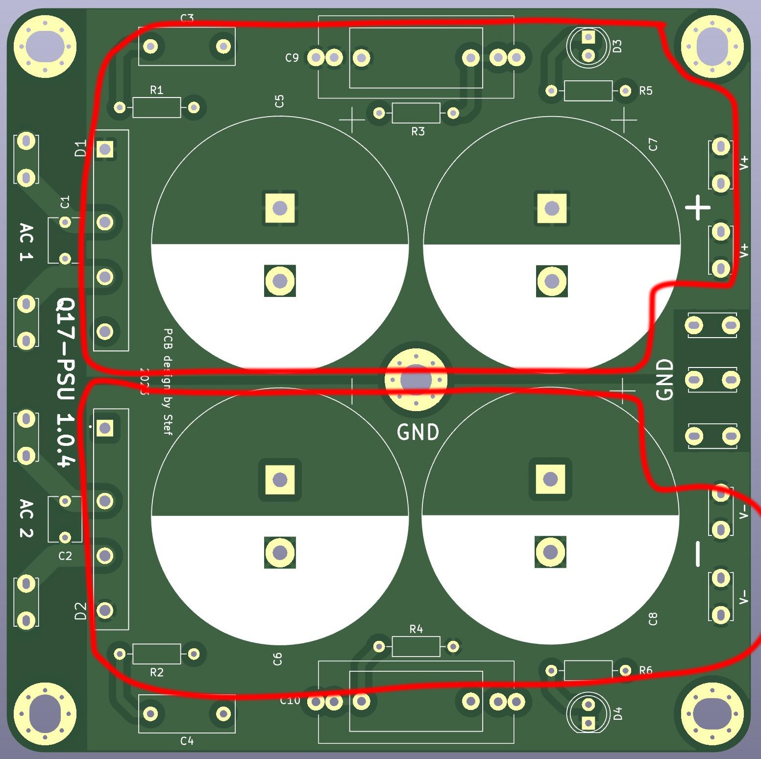

If I read it correctly, we are talking about Tibi's original circuit and it works from +- 36V. I claim that there is no audible difference between 48V and 50V in Tibi's original.
The rectifier PCB can be jumpered, no need to install 0.22 ohms there.
Tim
Tim
Resistors of a CRC rectifier PCB are additional resistors in the current source. This affects the Q17 circuit so that it first sounds softer in the bass and at higher levels muddy to distorted.
Through my current experiments I can determine that the very small internal resistance of the power supply limits the potential of the amplifier in the bass. This is an effect that cannot occur with Tibi's original PCB because the flat coil has too large losses.
Stef recently described this effect when he switched from the switching power supply to the toroidal transformer and achieved an increase in bass performance. This is due to the different internal resistance of the different current sources.
Tim
Tim
Tim
I did a comparison between a shunted CRC PCB and a PCB with only a single backplane, I heard a difference. Apparently, the current is more important and optimized with a single backplane. This is reflected in the dynamics.
Stef.

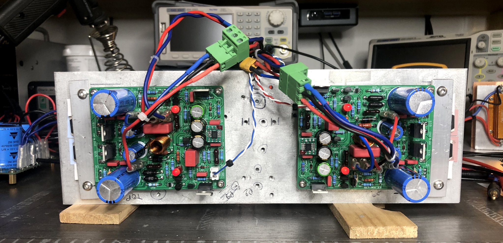

Hello,

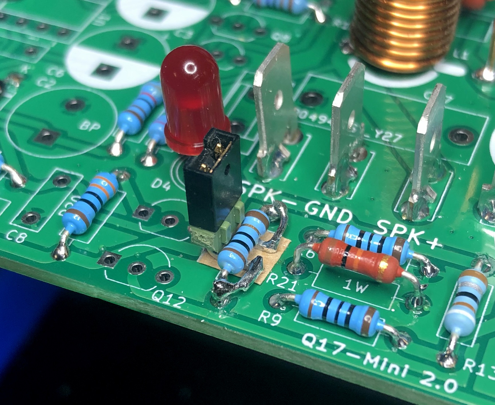

I finished the second Q17-Mini 2.0 board. It works. 😎
This consumes 21W @ 230V with two boards and the power supply à 49Vdc (Vishay bridge).
They currently work with R32 shunted without problem. The residual noise floor (DC offset) is 12mVPkPk and less than 1mvRMS without signal.
I still have several checks to do to verify that everything is ok with two boards.
Stef.
EDIT: I added the photo of the R32 jumper that I installed for testing.
Stef.

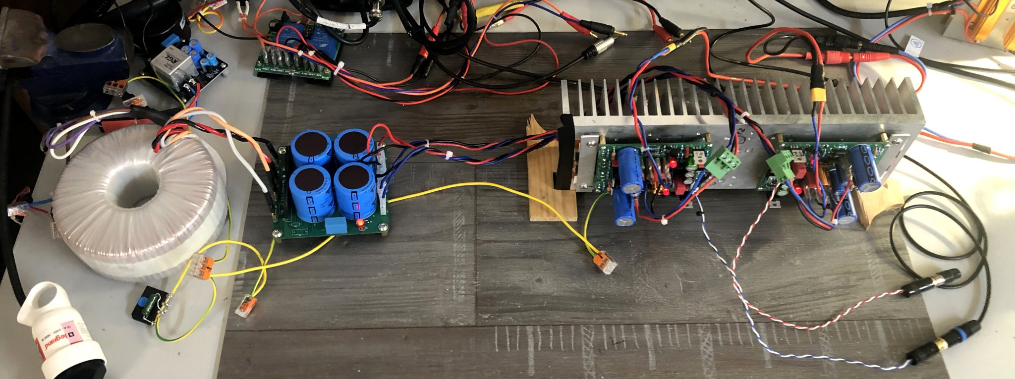

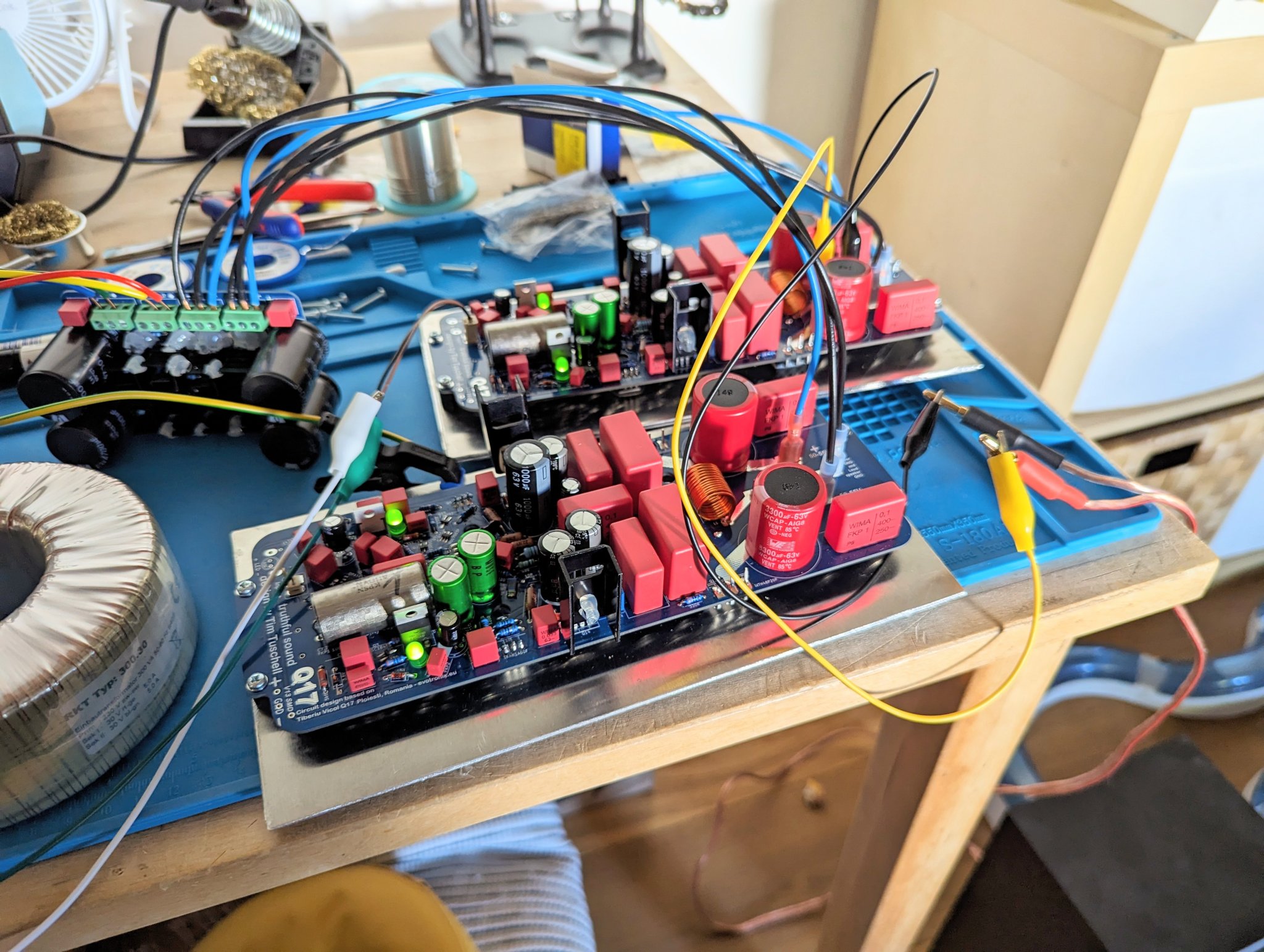

Hello,
I didn't find any problem with 2 boards in stereo. The background noise is even better (7.5mVpkpk) once the configuration is complete with all the cables, HP protections and even a bridge/resistor/capacitor to filter the GNDPWD to earth.
The tests I did on speakers with my usual pieces are very good or rather I didn't have the syndrome, "It was better before". 😉
Have a nice week end,
Stef.
Stef.

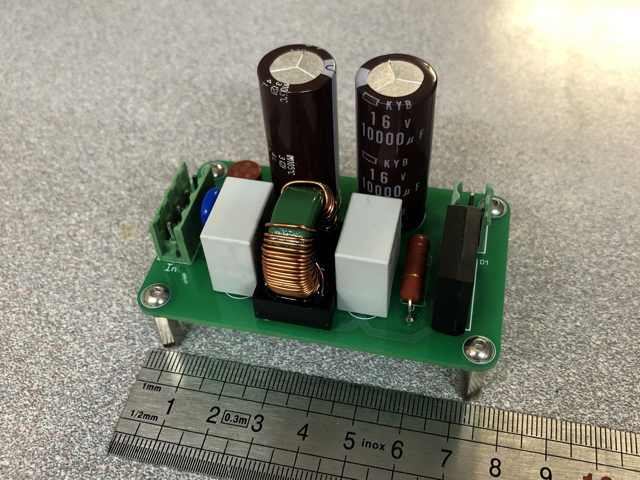

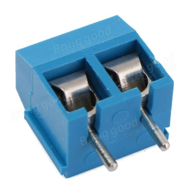

I had fun mounting one of the filter PCBs. I just bought the choke and the two chemical capacitors. The rest of the components is recovery on boards. It works correctly.
On the other hand, the PCB deserves to be improved. The holes for the connectors are too small. You can't even solder 0.75mm2 230V wire to it. I had to file the pins of the connectors so that they fit. The 4 holes of the choke are also not quite up to standard. There is also 2mm of space missing between the two-pin connector and the bridge on the right.
Stef.
Stef.

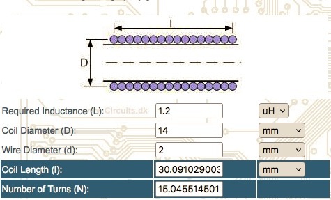

Alternatively, 1mm larger diameter needs only 15 turns and 30mm height.Hello,
A bit thick. You will have a beautiful tower 35mm high. 😉
http://www.circuits.dk/calculator_single_layer_aircore.htm
The tool gives an estimate. It would be necessary to check with a device.
You will also need to file the wire. The holes are 1.7mm in diameter.
Good night.
Stef.
Hole size shouldn't be an issue: I can extend them with a 2.0mm drill and solder the wire from both sides of the PCB. If the pads are large enough of course...
