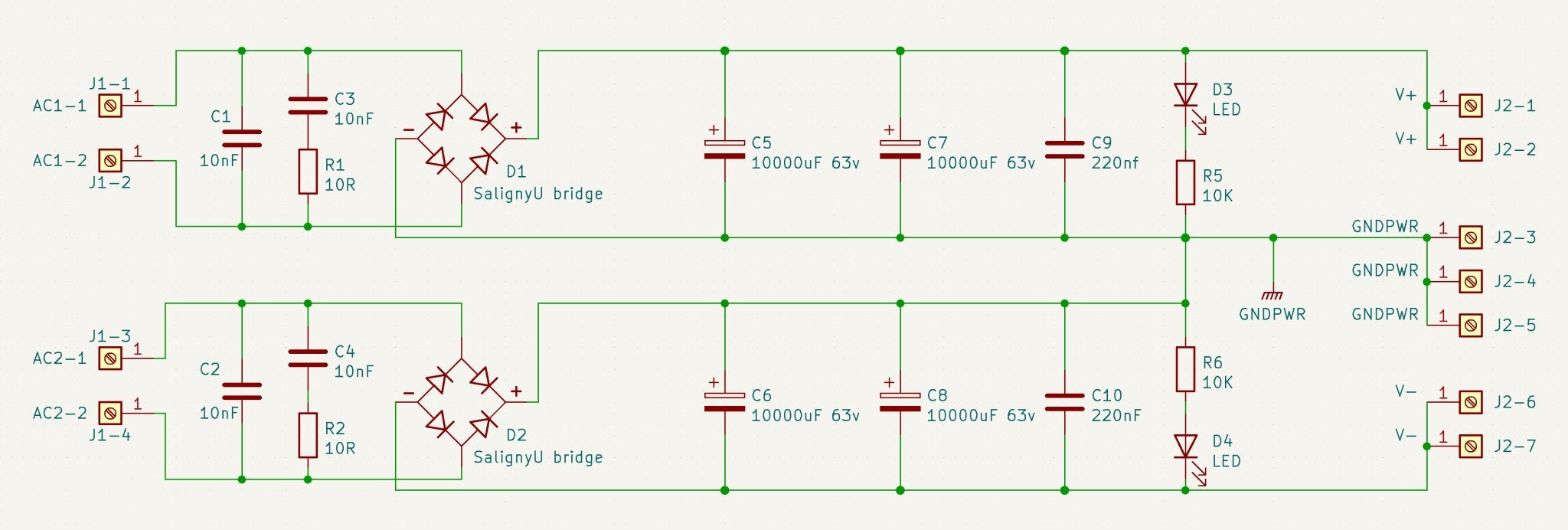

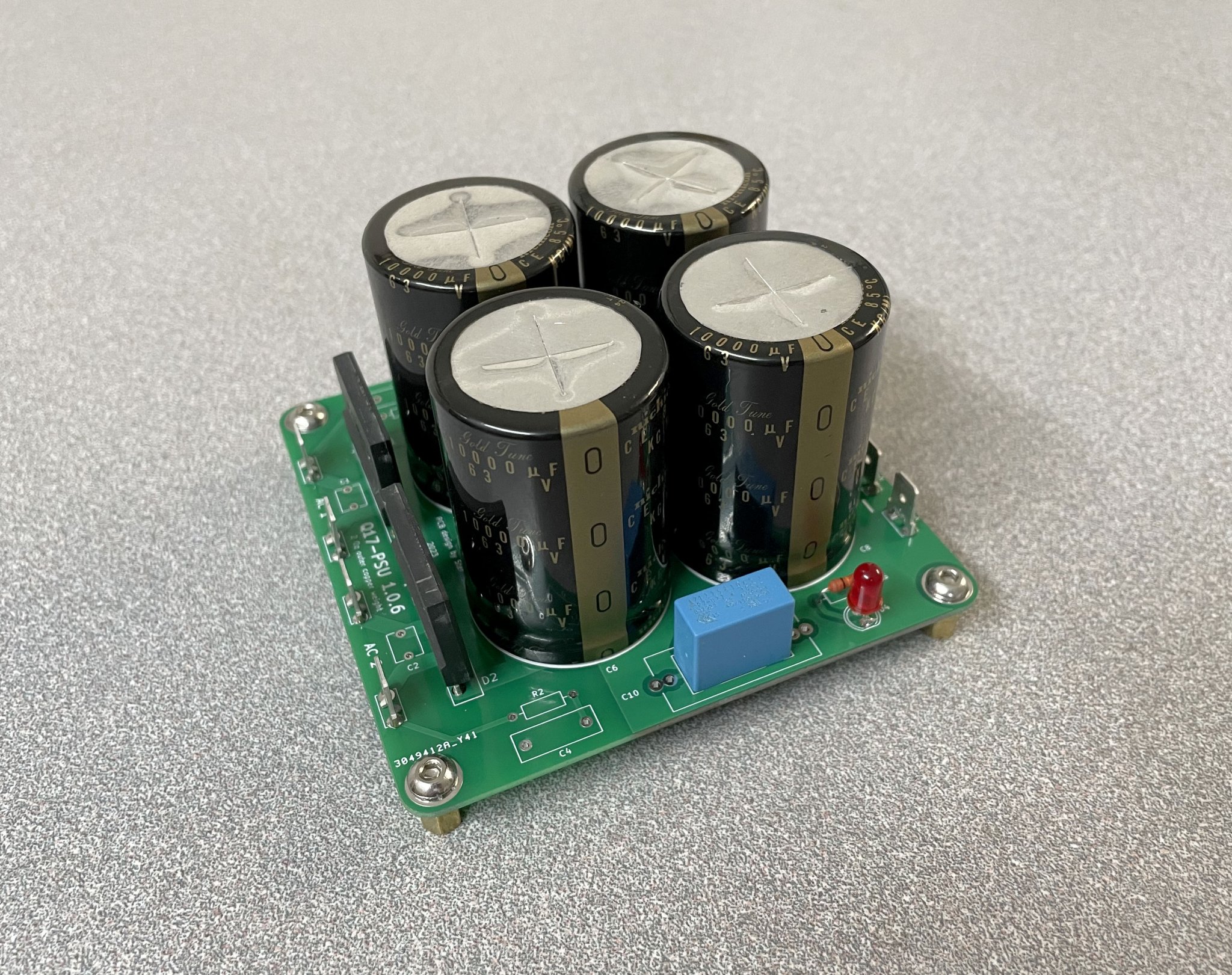

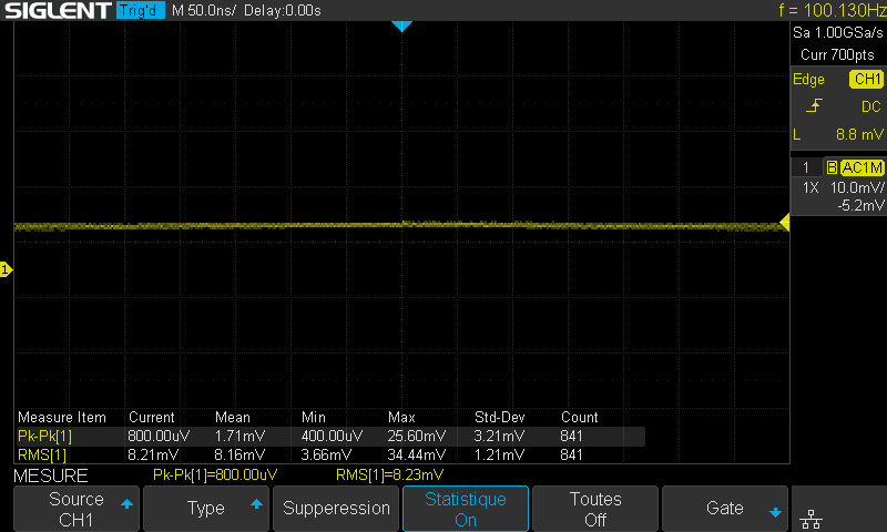

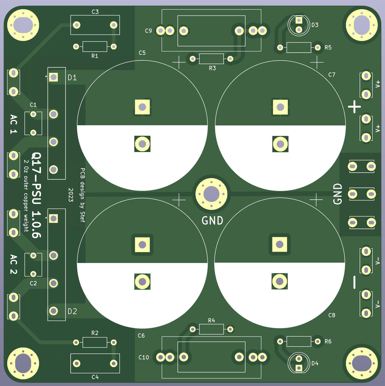

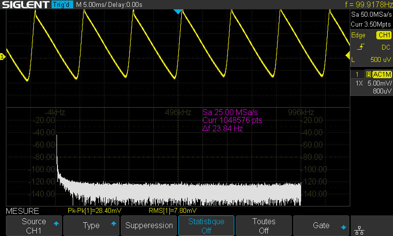

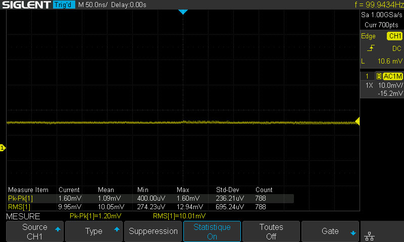

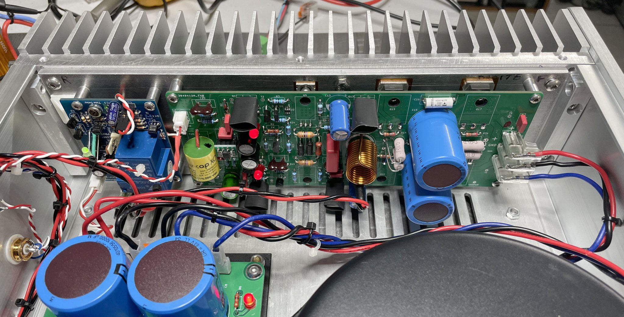

I worked on an optimized PCB version of the Q17-PSU. I especially worked on the part around the bridges and the ground plan. I still have to test it in real life but at the scope, it's very clean (1.2mVpk, 10mVrms). Even better than before. 100Hz is really very low now. I tested it at 48Vdc with a load of 1K5 per channel.
I should put the files online in a few days.
Good evening,
Stef.

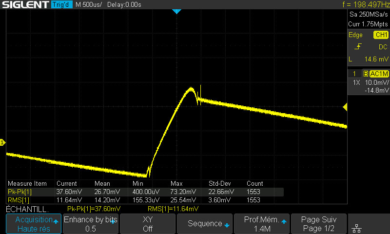

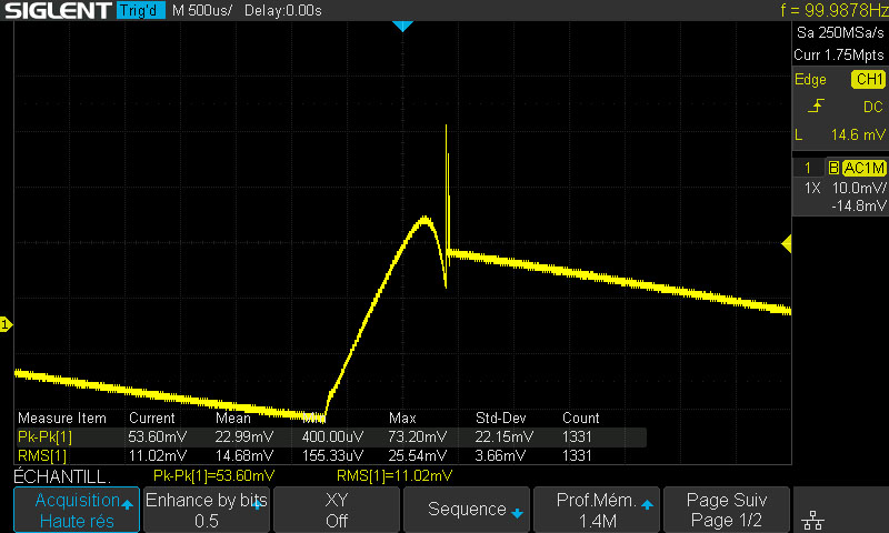

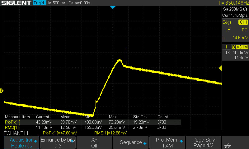

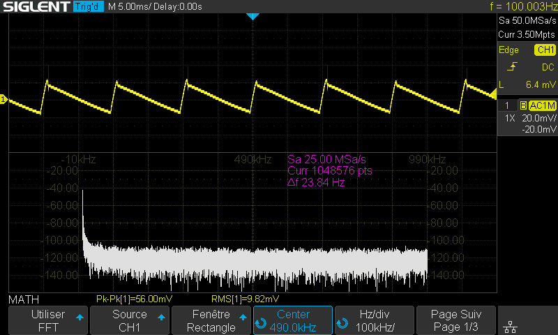

Hello,
To complete the measurements of the 1.0.6 power supply, here are the measurements with Saligny Universal bridges that you can compare with those of yesterday with classic Vishay bridges.
The test was carried out with almost the same components and with a load of 1K5. The output voltage with the same transformer is 50.1Vdc.
Stef.

Hi Tim,
These are the same values between the two boards but not the same component brand.
The measurements are not always obvious even if the scope probe is stuck to the power supply terminals like in the books. Just taking the measurements in the evening or during the day changes the results.
I think the big CDEs are better than the Wurths.
Stef.
Vishay board
D1, D2 : 625-GSIB2580-E3
C5, C6, C7, C8 : 598-SLP103M063H9P3
C9, C10 : B32922J3224K000
Saligny board
D1, D2 : Saligny Universal 55V
C5, C6, C7, C8 : C710-861020786030
C1, C2 : 810-FG28C0G2A103JRT6
C3, C4 : 598-MPX103K305D
C9, C10 : 598-MPX224K305E

Hello Stef,
I am trying to understand your results.
The needle pulses from the active rectifiers is of course poison to the Q17, so normally the active rectifiers also call for pulse capacitors in the output to neutralize such things, according to the datasheet.
I bought four of the CDE 380LX123M063A052 and soldered them to the amplifier boards. According to the measurement of the component tester, the ESR of the CDE is rather higher and the bass is o.k. but not more. The CDE of you, the SLP103M063H9P3 are described with even higher ESR in the datasheet. Therefore, I would expect that if you compare the rectifier boards in the amplifier, so if you connect your big speakers to the amplifier and listen to music, then I would expect your CDE only on the basis of the information in the data sheet, that the rather restrained in the bass perform.
Tim

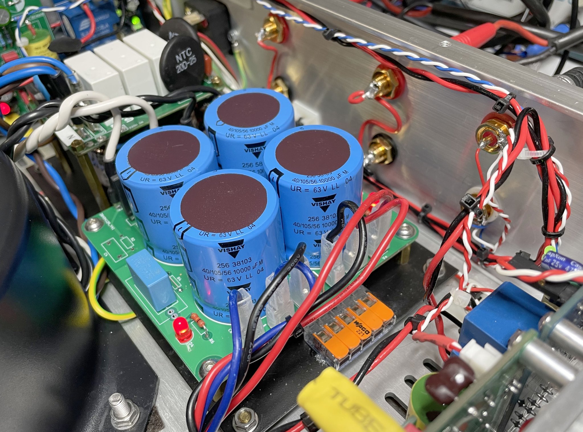

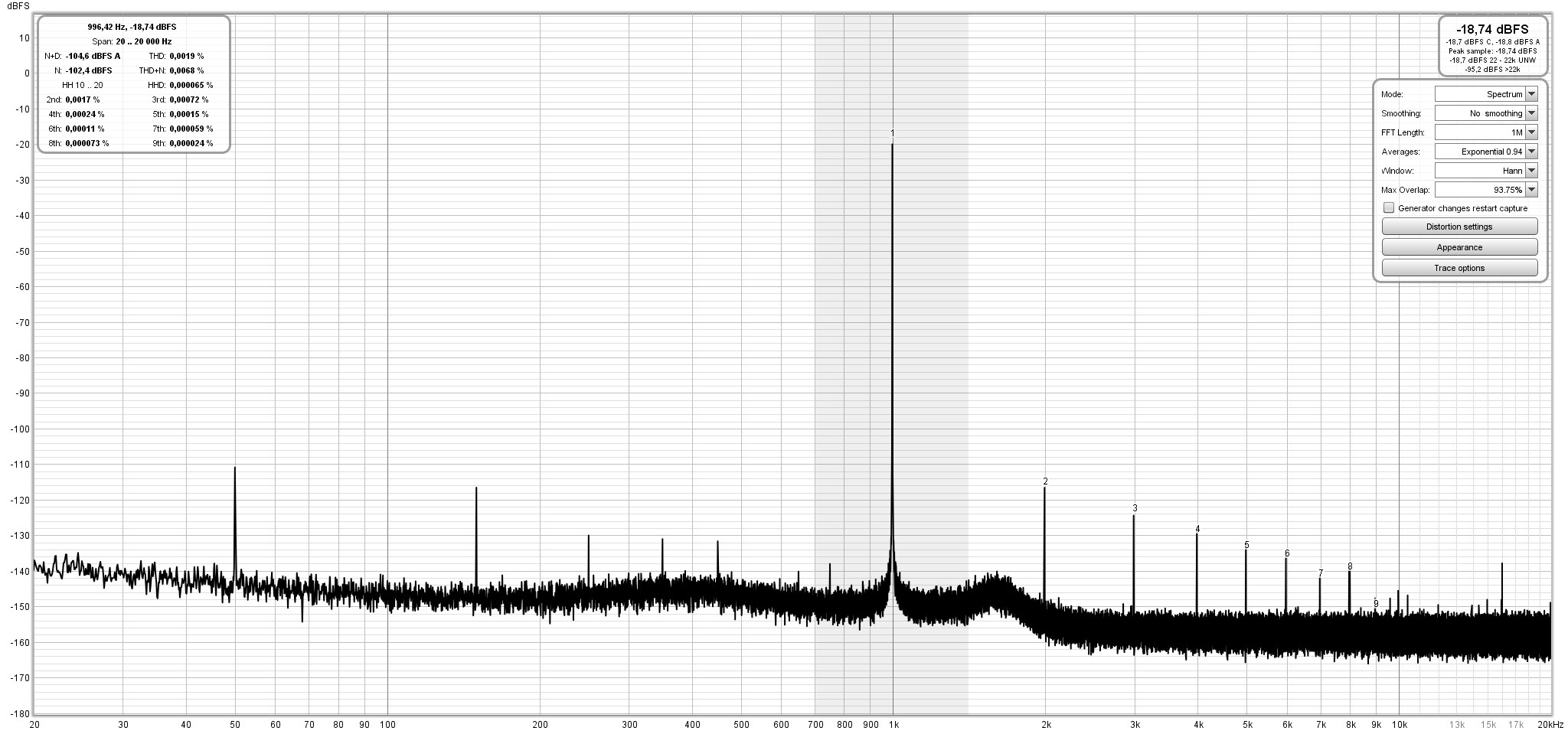

Hi Tim,

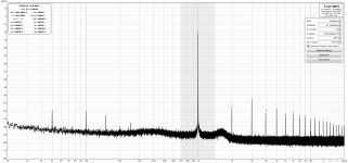

I'm planning to compare the different PSUs but I'm not ready yet. I need to upgrade them all to 1.0.6 first.

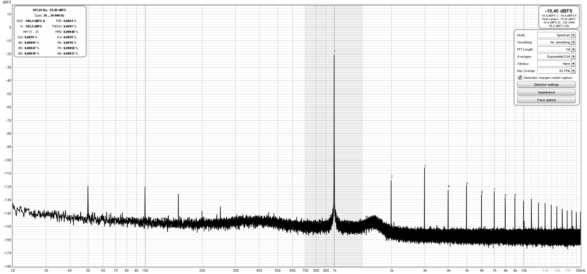

I put the Q17-Mini 2.0 boxed through the REW reel again. With the new power supply 1.0.6. PCB, I lowered the 50Hz from -85dB to -120dB. 😉
This is the Vishay bridge + CDE SLP power supply which is in the Mini box now.
Stef.

Am really qurious about what make these spikes? Mosfet noise?
Mosfet noise is the wrong term. It is about the capacitance of the Mosfet. With the bridge, I don't see a film capacitor damping the needle pulse. Such a capacitance should therefore be placed on the PCB of the active rectifier to be optimally effective.
Without the capacitance of the Mosfet, the Q17 would be able to work ideally, since there is this capacitance, one sees the needle pulses also with the Q17 in the output signal - provided that it is not superimposed, as when increasing the supply voltage.

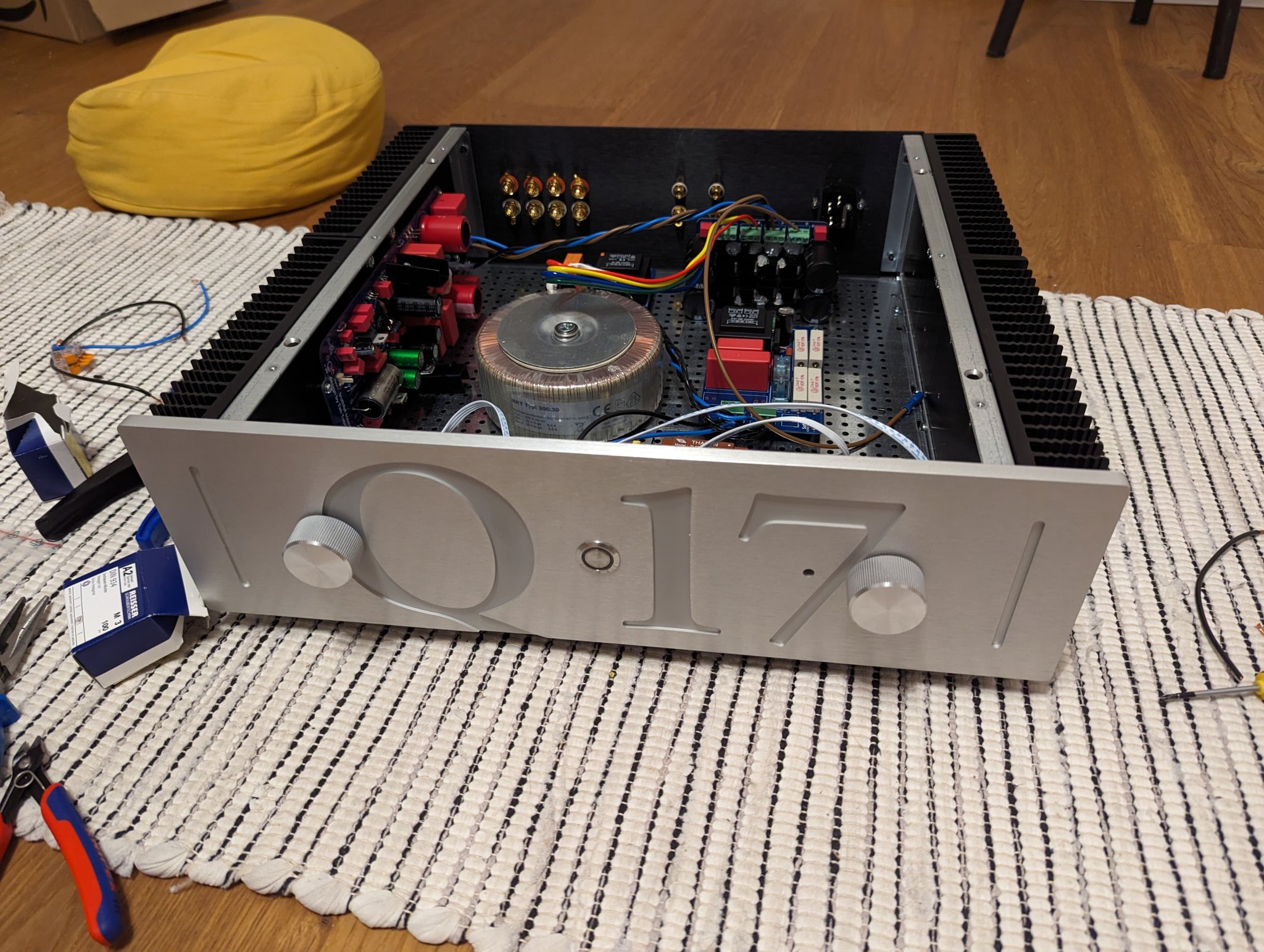

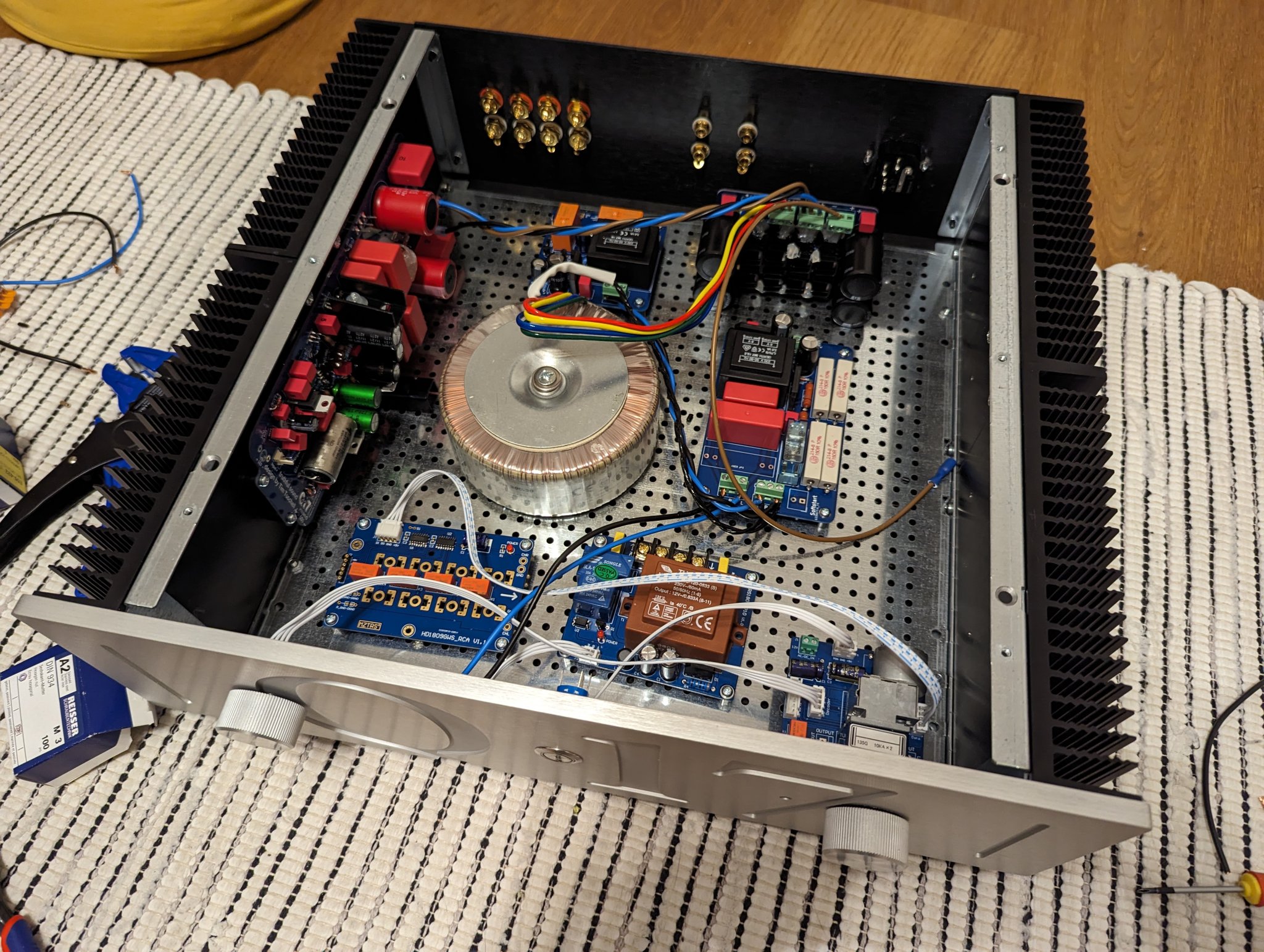

My build is finally coming along...
Im not completely happy with how the frontplate turned out, though. In the CAD it looked better with the knobs overlapping the text. I just thought, if I have to have it customized, why not make something a little special.
Now, if I only could produce a fully working second board... I'm going into my third try now.

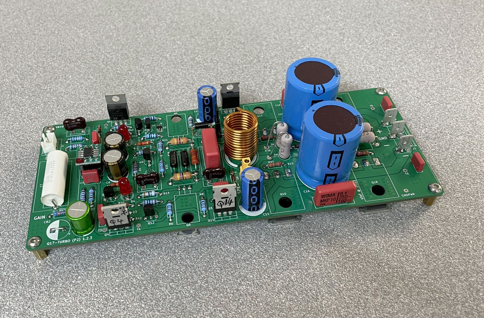

Hi Folks,
I released a maintenance version 1.2.3 of Q17-Turbo. The main modification is the addition of Faston connector for the power supply. I tested it in real life and found no problem. I took the opportunity to update some of the measurements.
The files are available as usual on my Github repository.
Stef.
Version [1.2.3] (27-10-2023)
  • Modified R32 footprint to support potentiometer type T93YA100KT20 (for testing).
  • Added zener D7 and D5 (1N5245B) to protect output.
  • Added Faston connector footprint on J3 input power connector.
  • Removed useless fuse sockets to fit new Faston footprint.
  • Optimized some tracks on GNDPWD parts.
  • Moved T5 and T6 to a better location.
  • Various adds on schematic.
  • New measures with a better measurement device.
