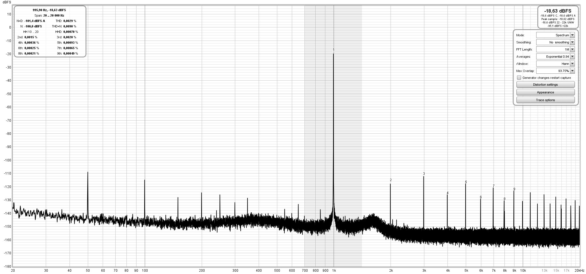

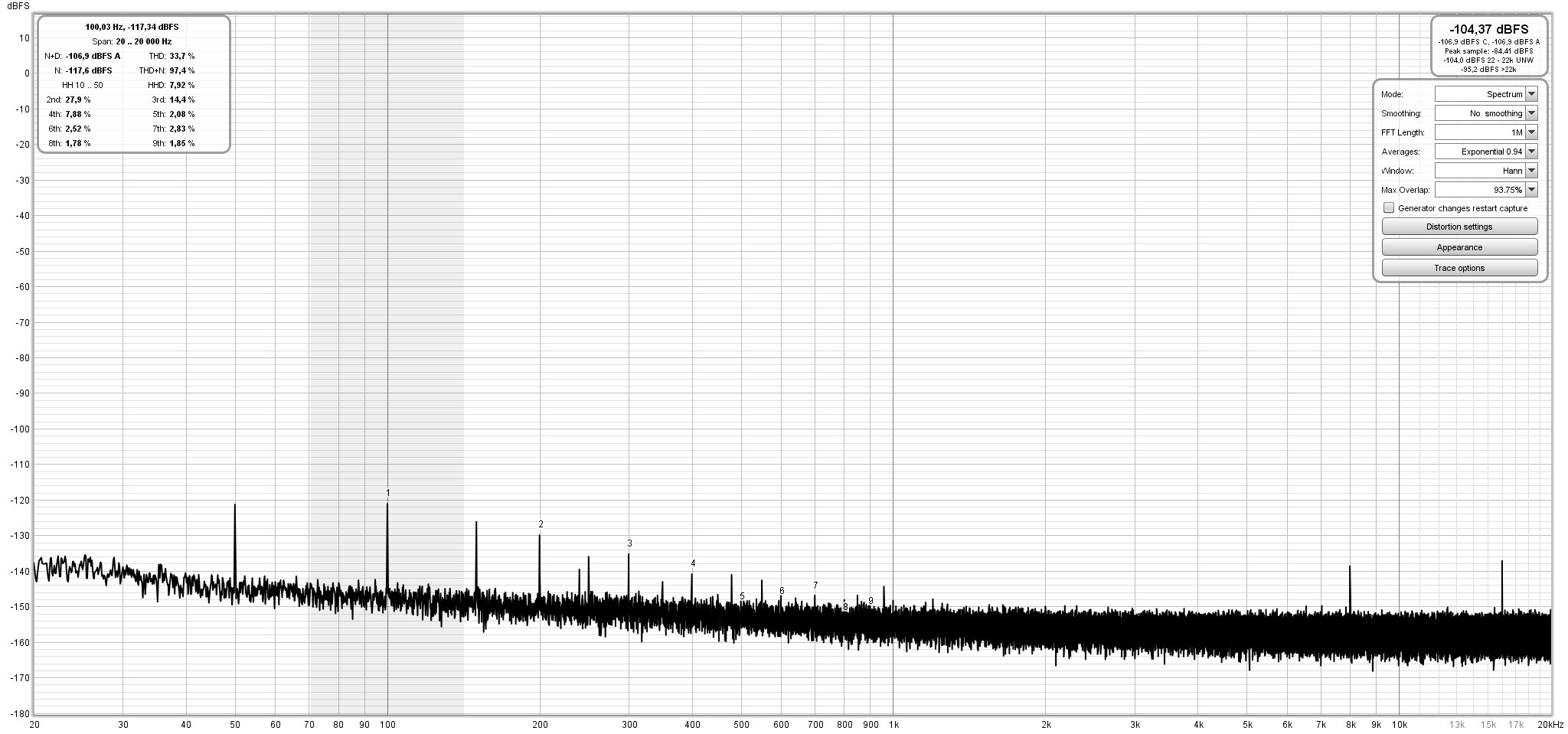

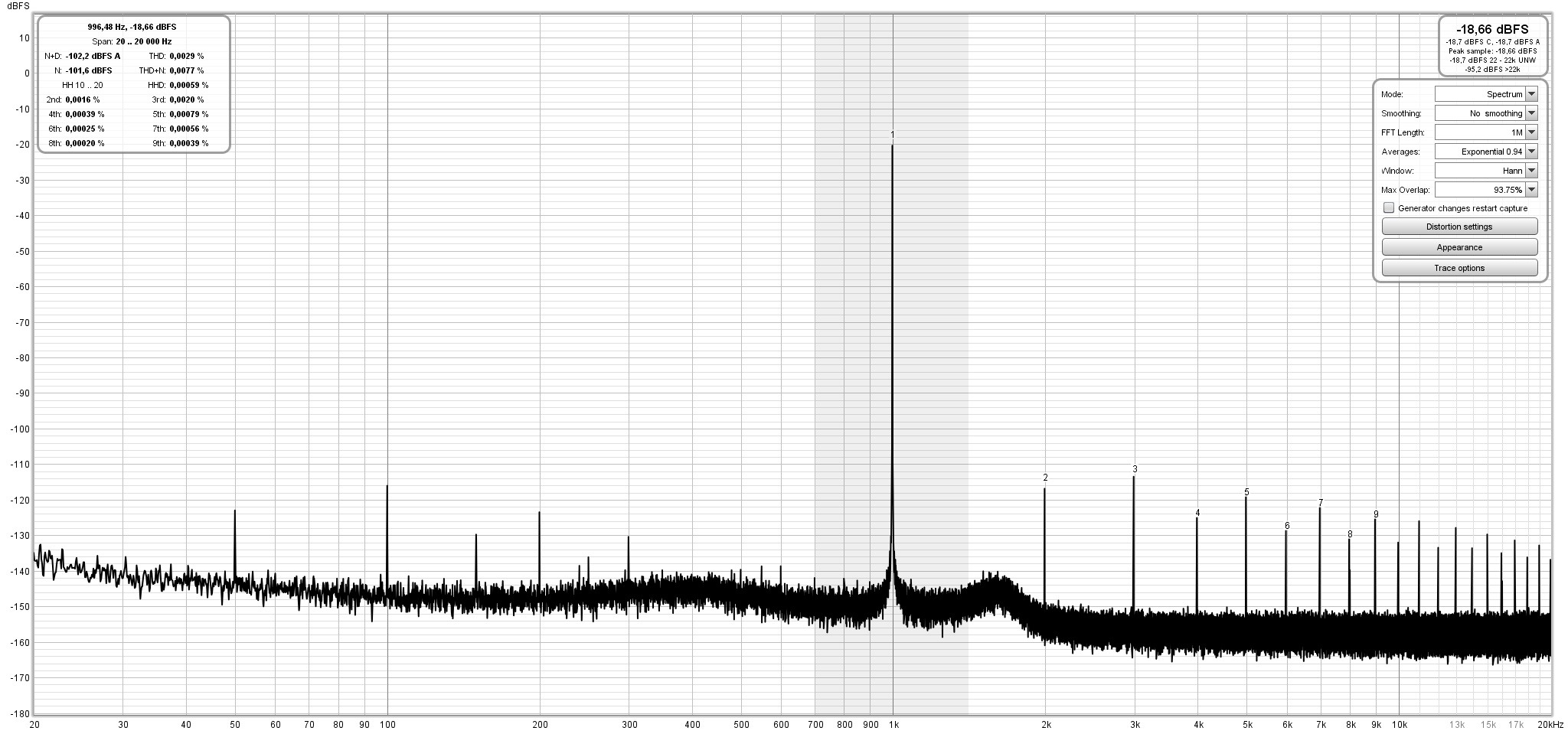

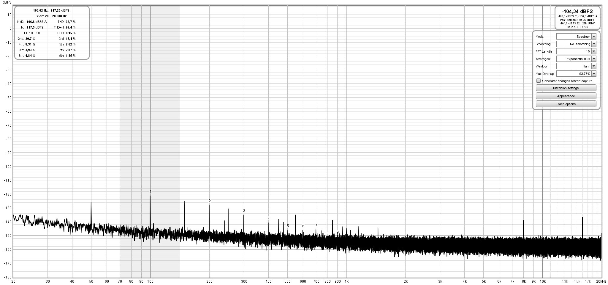

To complete, here are the spectrums of the two voices of the boxed Turbo 1.2.3.
The left voice keeps a greater trace of the hum. It's the one next to the power outlet. I'll have to see if I can improve this but it's inaudible with regular sensitivity speakers.

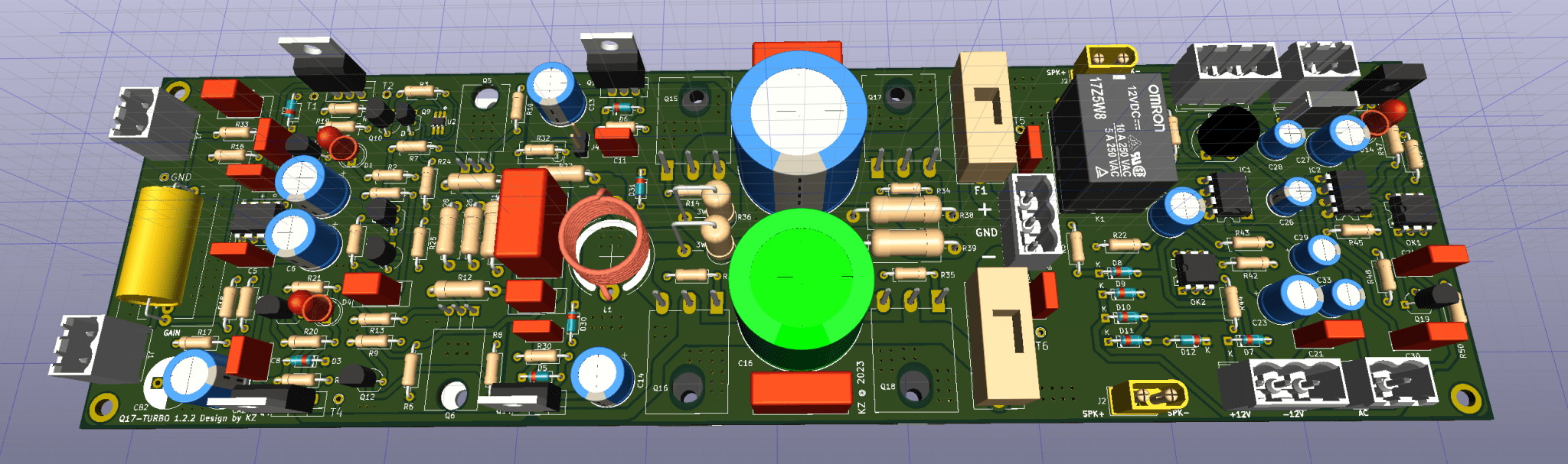

My last project was that I put together the Q17 turbo with a speaker protection circuit.

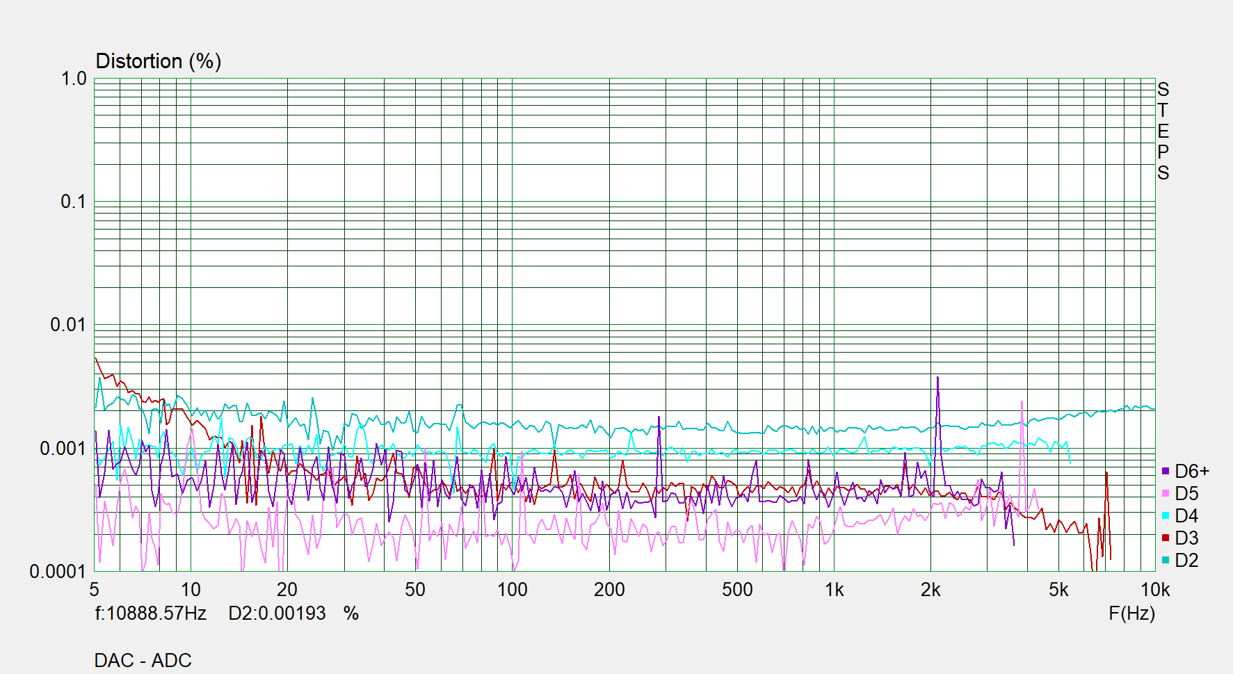

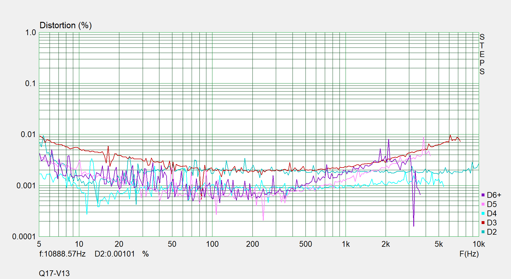

Hello everyone,
Today, I received a used Tecam USB Interface, and I conducted a distortion analysis for the amplifier at room volume using Arta Steps. I created two diagrams: one without the amplifier and another with the amplifier. I made sure that the levels at the DAC and the ADC were equally high and tested them first to capture their minimal distortions.
Best regards,
Tim
Best regards,
Tim
Gentlemen!
I've been following this conversation for a long time and have already recreated some of it.
Thank you for the professional contributions
Hello,
Nice idea.
You can probably update the PCB to Turbo version 1.2.3 and remove the fuses. Also try to reduce the length of the board. The board seems really long to fit into standard boxes.
Why are there two connectors on the Input side?
Good luck.
Stef.

When the board is mounted vertically on the heat sink. Normally the connections are at the top or bottom.
I don't like that, I like symmetry
Of course you can still optimize the board and make it shorter.
I have a device depth of 350mm, so it fits
