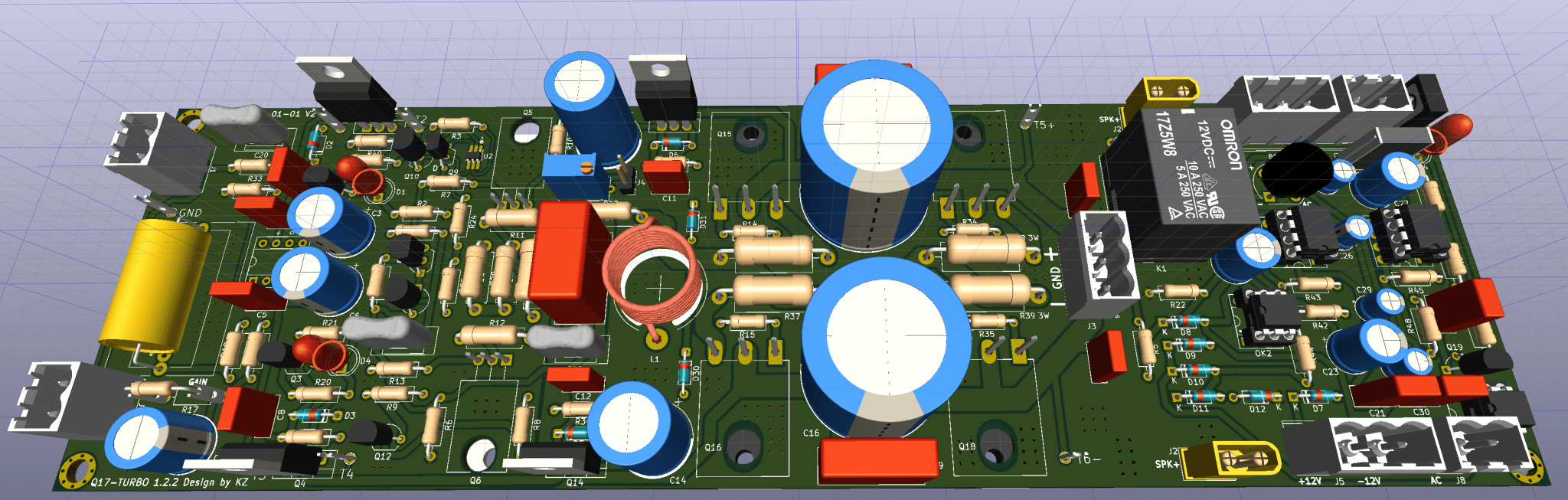

I would like to discuss the recent changes to the Q17 and derive ideas for optimization. Originally, a current mirror was formed with Q9 and Q11, with its input current depending on Q12 and R24+R25, regulating the current for the cascode. Thus, it was a feedback correction. The variant from this summer (by Tibi), accurately reproduced by Stef, changed this by replacing the simple current mirror with a Wilson current mirror.
So far, nothing new.
Now, this Wilson current mirror has an impact on the current for the cascode and the currents in the circuit of Q5+Q6. Therefore, it is understandable that Tibi reduced the resistors R10 and R13 to 9.1 ohms. However, the adjustment of R3 is missing. In the original concept with a simple current mirror, R3 was chosen quite ideally at 150 ohms. In the concept with the Wilson current mirror, this value needs to be reduced to the order of 100 ohms for the circuit to work well-balanced again.
Since the circuit is a Class A feedback correction with Q5 and Q6, generating higher impulses when driving two pairs of Mosfets (Q15, Q16, Q17, and Q18 - in Stef's Turbo), there is increased instability in terms of oscillation behavior. I've dampened the oscillation behavior a bit by adding a resistor (R34) to C10 – this suggests that the mica capacitor without a resistor is not perfect (I can demonstrate this in the Spice simulation) and that a high-frequency capacitor with high ESR – like the cheap ceramic capacitors – would be more suitable in this position.
Additionally, I'm damping high-frequency oscillations of the feedback path (Q12 – R24+R25) by adding an additional damping element (R35 + C20) compared to the central feedback (through R27).
Now, in this context, I have determined that R3 is still too high in my latest version (#2,204) and should be adjusted.
During these investigations, I explored the question of which alternatives to Q12 can have a positive influence. In the simulation, I picked up the possibility of 2N5551 and found a solution with a high base resistor (R9). Since I want to keep the quality of the components as high as possible, I chose the ZTX458 as an alternative to 2N5551 (as Q12). As the simulation of the Wilson current mirror behaves little positively compared to the simple current mirror, I also simulated a double current mirror with P-MosFET. Now there is the idea of building all components of the Wilson current mirror, including Q10, with ZTX558. This results in a simulation result that is even more precise than with P-Mosfets.
This adjustment allows a lowering of resistors R11 and R12, making the power stage in Class B almost error-free at the zero crossing.
The reason for this investigation is provided by the Hafer interpretation: https://www.diyaudio.com/community/threads/unusual-amp-from-1987.357369/post-7493521
In this amplifier, the Class B power stage also works very precisely, which the Q17 in its current form does not. However, the described circuit works with extremely small signals, which reduces my enthusiasm. Therefore, I consider it more promising to further optimize the Q17 circuit.
What do you think?
Best regards, Tim

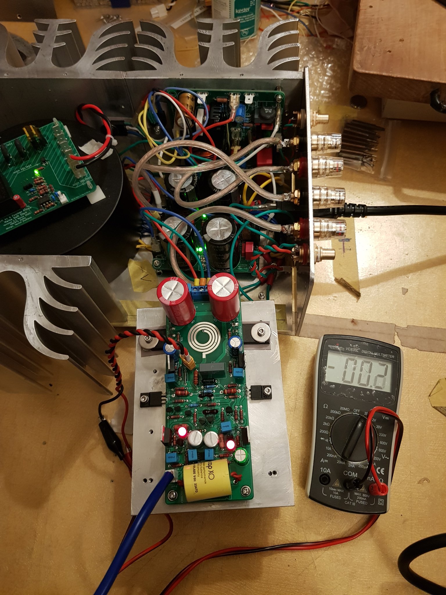

I've desoldered almost all parts and soldered those at a new pcb.
Indeed, it works. I hooked it up with a test sepaker and it sounded as well.
The dc offset is -0.2mV.
But it arises to -3.5V in about 10sec after turning off.
Is this normal and acceptable?

try the same procedure with RCA input shorted.I've desoldered almost all parts and soldered those at a new pcb.

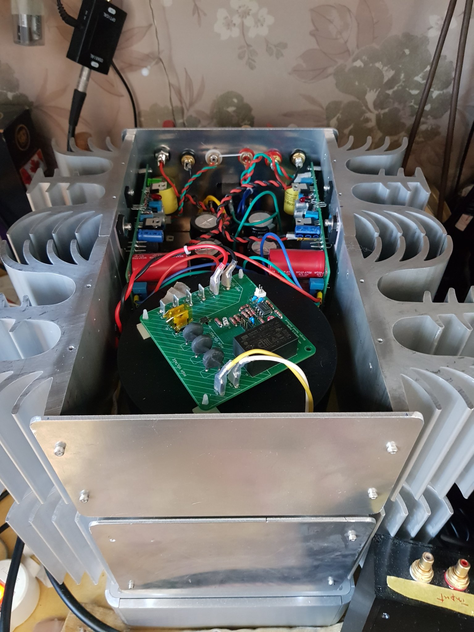

I have an issue of cross channel ground loop.
It has made so BIG hum.
I've changed 0R0 to 10R0 of R32 (HBR).
It made hum smaller but hum still has been remained.
I've made closer RCA connectors and connected RCA grounds.
The hum is gone!!

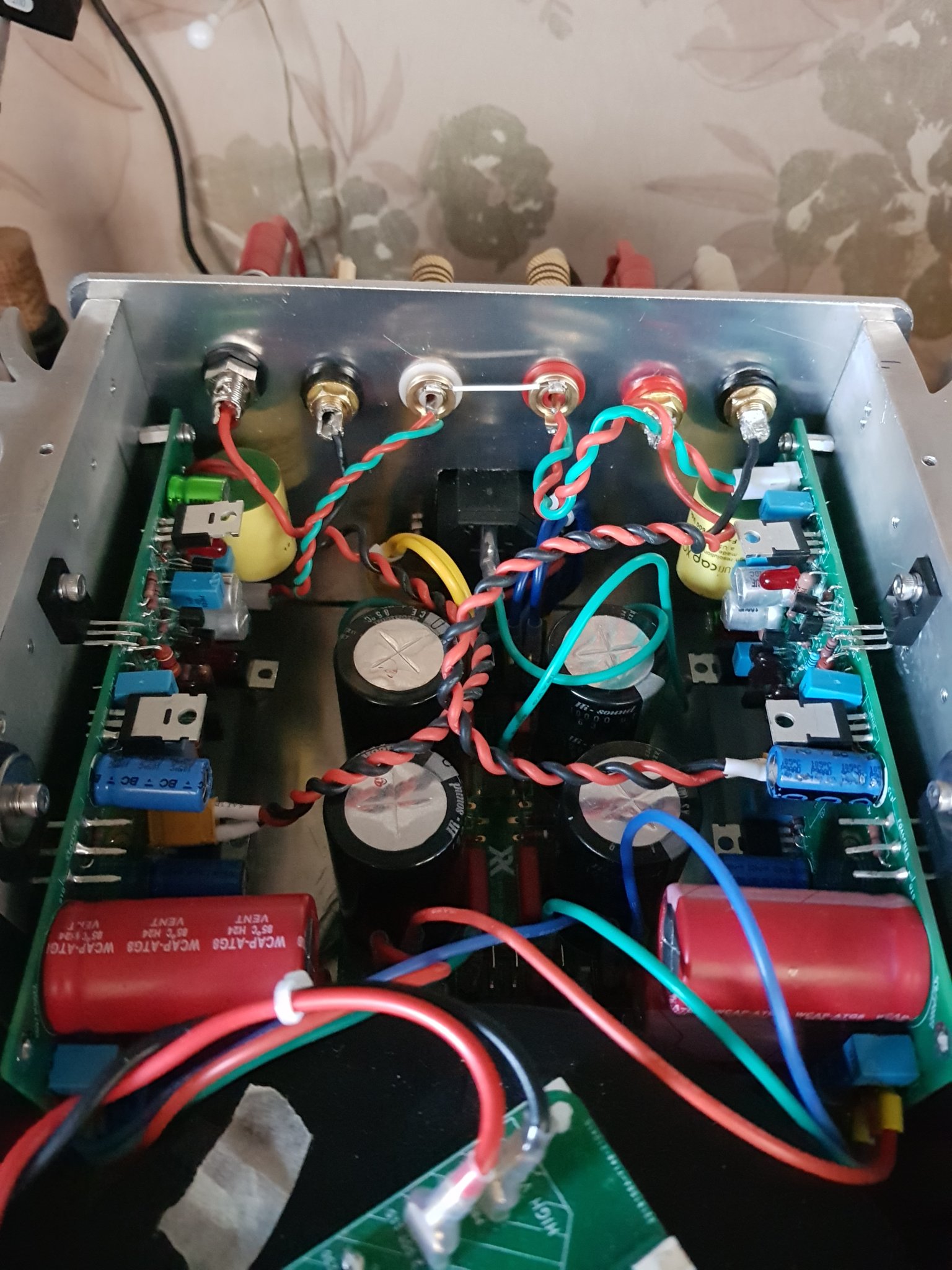

at post 2223 where goes the RCA input? the GND from the RCA goes...cant see it
edit:
the other pics are clear. check if you have tight contact with all earth connections...check solders and crimp connection

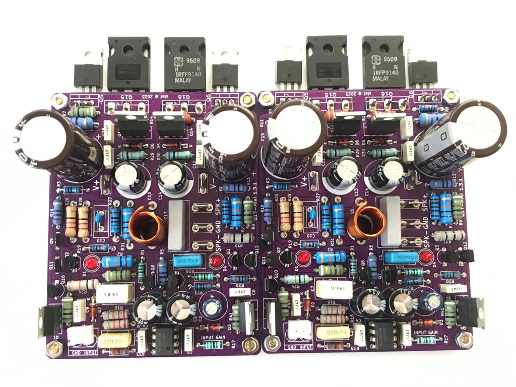

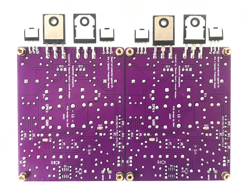

A small contribution to this project. PCB is not tested, maybe there are errors, maybe someone will check. If all goes well, I'll make the Gerber file available. I have always liked Quad and I made some copies. I'm posting some pictures.
I like your project very much. You said that if it works then you'll make the Gerber files available. Did you tested ? Can you send me the files or just the simple converted versions of the front and back PCB ? preferably without non copper layers, as I can see them in your post
Is there any problem of connecting grounds of L / R signal ?Hi Nam,
You should take away the earth connection between Signal-input L and R. (the two RCA's)
Start enjoying your music!
I have just followed the guide of the doc and it made hum gone.

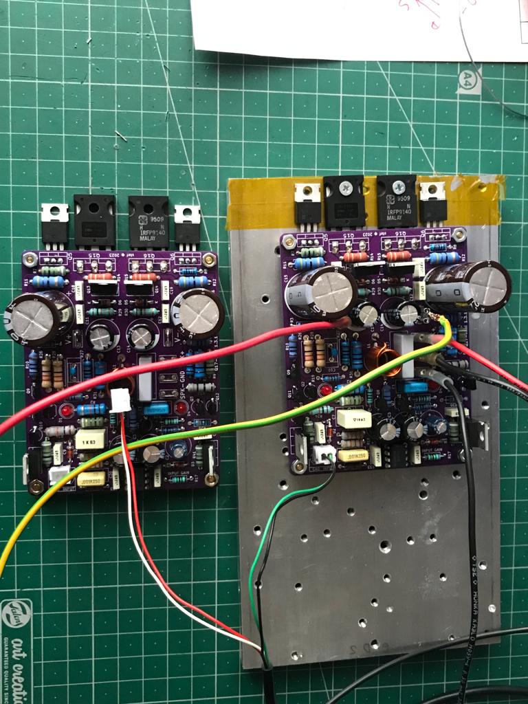

I couldn't get the circuit to work. The LEDs do not light up. IRFP240-9140 overheats in a short time. Can you help me where am I making a mistake?
Hi, fazildiken
Try open the archives again at https://github.com/stefaweb/Q17-Amplifier/tree/main/Q17-Mini-Multisim. There you can see the voltages on each important components. Compare them with your own and seek for differences. Your motherboards are very carefully assembled. However, if you see the schematic from the link, in your case (zooming on the photos) R29 and R30 are 100 Ohms but on the schematic, they are 10k. Maybe is not relevant, but this is what I have observed. I have the intention to build Q 2.0 mini, so I am reading a lot of discussions here.
