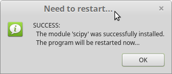

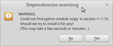

Firstly - I get this error msg
I click yes then get this message
I click OK and get the first message again
so should I uninstall and re-install again?You don't have the latest version yet.
Great! thanks for your time and patience with this. I will have a play later and check all is OKNo wonder with such a number of releases lately But yes, it is the lastest version.
