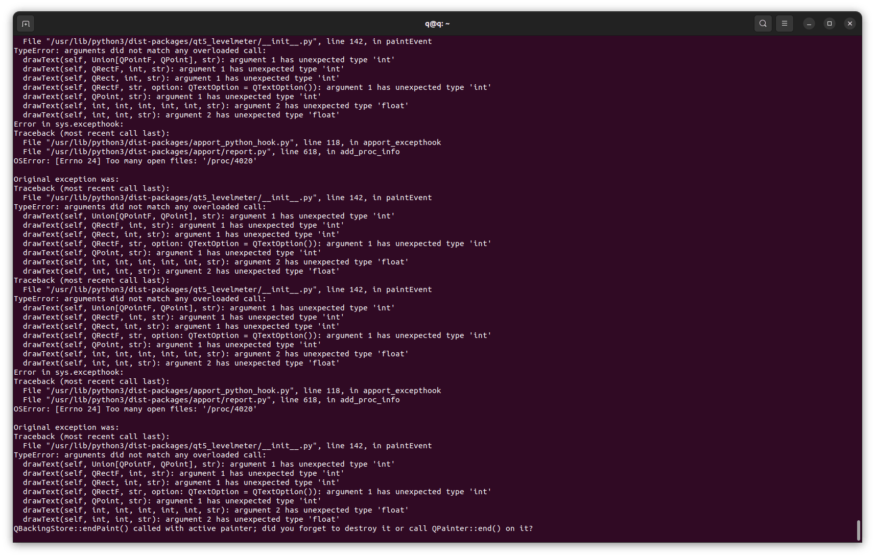

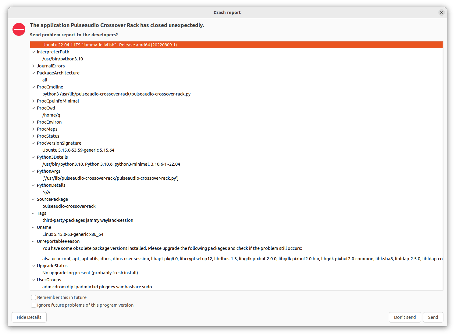

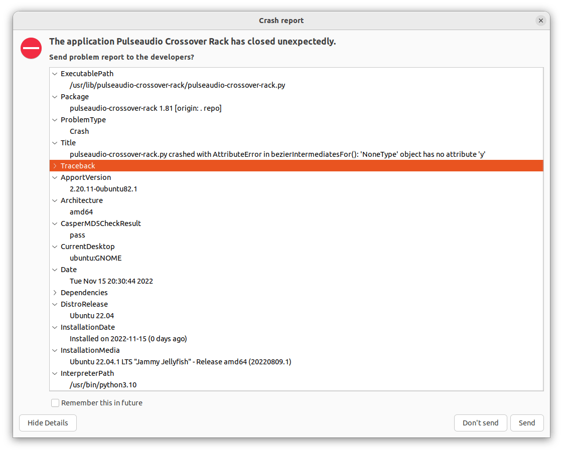

OK, many thanks for getting back to me. I have just done a fresh install of Ubuntu 22.04.1 - without paxor installed the audio worked fine, with no delay or distortion.Actually I recently upgraded to linux mint 21 which also uses pulseaudio 15.99.1 and this ist the first version of pulseaudio shipped with recent versions of ubuntu (und its derivates) which seems to work out of the box without any need for patches. So maybe applying the 13.99.1 sink fixes to 15.99.1 could have caused problems?
If your problems persist, please describe in more detail, and maybe start paxor from the console and post it's console output here.
I installed paxor with no problems and then as I created a crossover to test I got the following error -
(It wouldn't let me copy or take it all in one screenshot so it is in two parts)
I created a basic two way crossover anyway and inserted it.
The problem that I am having is that when playing music the sound is distorted and out of sync - the woofer of my two way is second or so behind the tweeter, when I stop playback the woofer continues for a second or so.
I am using a xonar U7 so I disabled tsched on the default.pa but this has made no difference.
I have also changed the following in the daemon.conf but this had no effect.
I hope that can give you some pointers? Cheers!resample-method = speex-float-1
avoid-resampling = false
this is what I get when run from terminalActually I recently upgraded to linux mint 21 which also uses pulseaudio 15.99.1 and this ist the first version of pulseaudio shipped with recent versions of ubuntu (und its derivates) which seems to work out of the box without any need for patches. So maybe applying the 13.99.1 sink fixes to 15.99.1 could have caused problems?
Here is a screen shot of the end of the very long terminal window when its sends the crashreport~$ pulseaudio-crossover-rack
