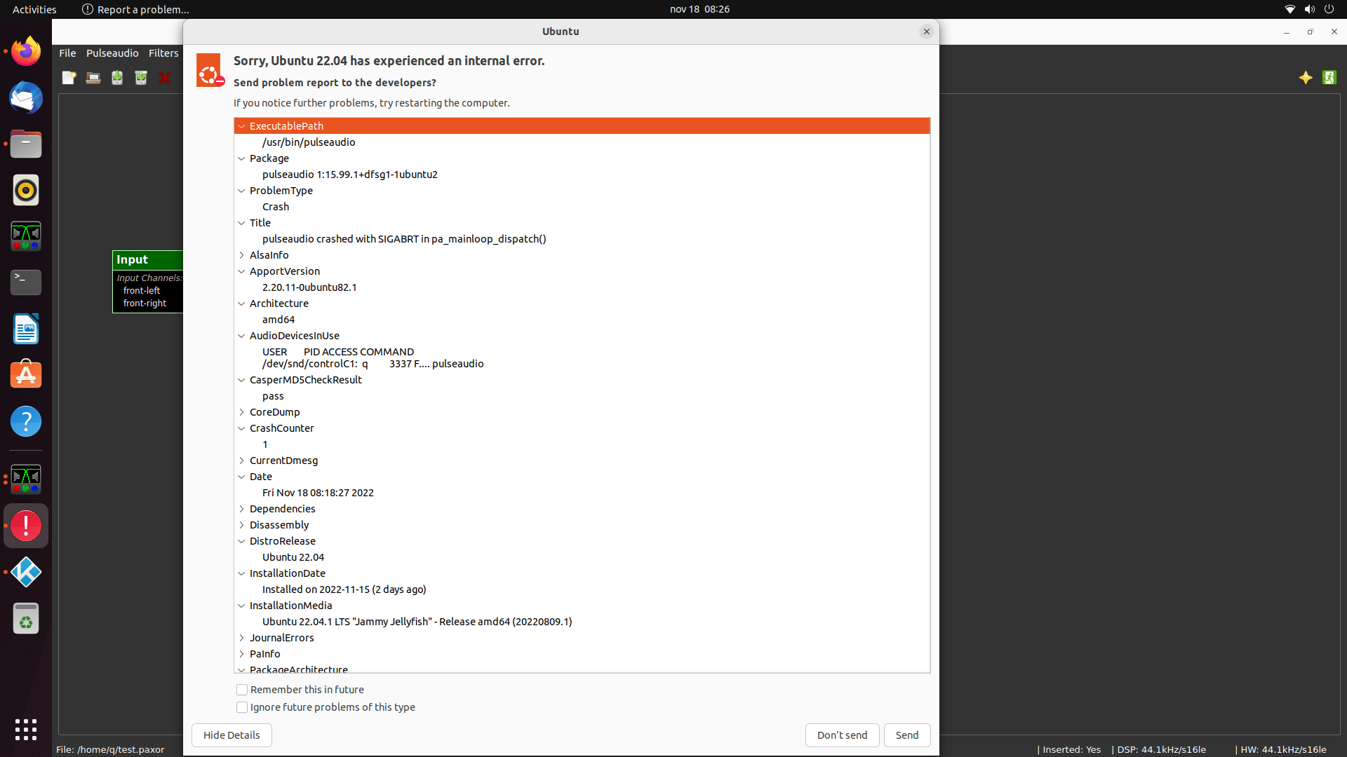

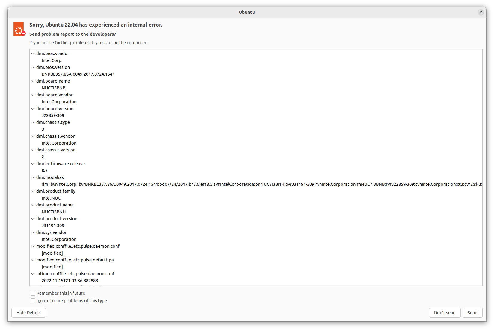

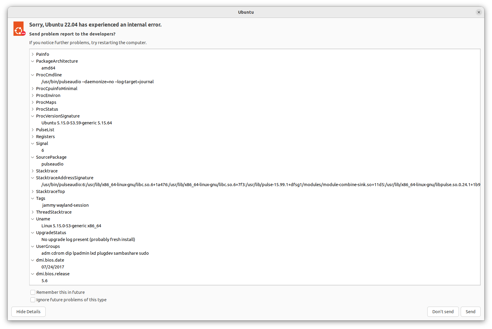

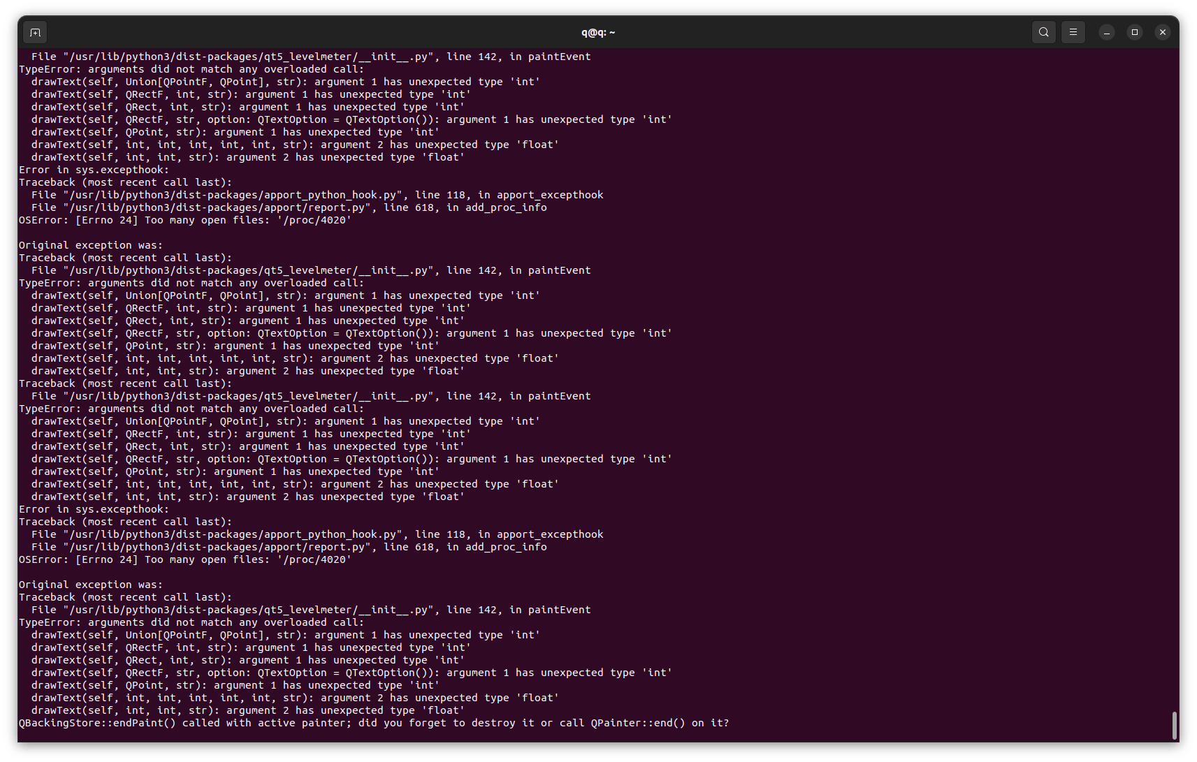

this is what I get when run from terminal
Here is a screen shot of the end of the very long terminal window when its sends the crashreport
I just released version 1.12 of python3-qt5-qlevelmeter, the package that caused the error. Hope that will fix it for you.
Thanks for the report. just released another version which fixes another (probably rarely occuring) bug.
