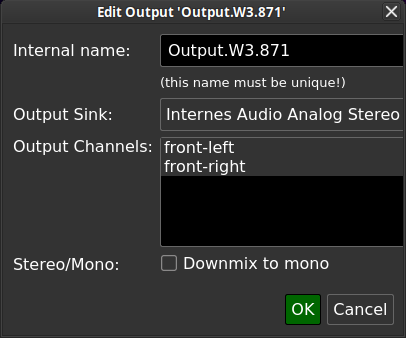

Here's the obligatory screenshot:

Sorry, my laptop at home, which is serving the website for cost reasons, is currently down. I will try to have it rebooted ASAP. I will try to move it to a more stable virtual root server by (not the most stable machine) the end of the year.
Could you elaborate on the coloring thing? Do you mean the multi select fields in the edit dialog for outputs or the background of the output widgets after you selected the channels?
The standard colors (if colored at all!) for 3.5 mm output jacks on both onboard soundcards and many PCI cards are: Green: Front speakers out. Black (or dark Blue on some older boards): Rear speakers out. Orange: Center/subwoofer out. Gray: Middle speakers out.
So, to take your own screenshot: Woofer: --- Output channels: Front Left Front Right (Green Jack) Tweeter: --- Output Channels Rear Left Rear Right (Black/Dark Blue Jack)
Adding the relevant color code would simply save me having to look up the color code, that’s all..

A question...my soundcard has 5.1 output.. front,rear,centre, and sub.
When I select an output in Pulseaudio Crossover Rack for the subwoofer I can choose summing of inputs to mono but cannot select output to be sub out only.
A pop-up notification asks for 2 output channels to be configured so I need to choose centre and sub then get the option to mono.
Thus only one physical output is used but the centre output becomes redundant and unable to be used.
Is this immutable ?

Yes, as far as I can see there is only one trick which involves remap-sink and this can only be used in two channel mode. So yes, this way you are losing one output of your soundcard. This was a surprise to me also that this hack worked with literally 10 lines of code changes. As long as there is no n-channel downmix plugin for pulseaudio available which takes two channels as input and has one output I can see no way to get around this limitation of pulseaudio at the moment.
