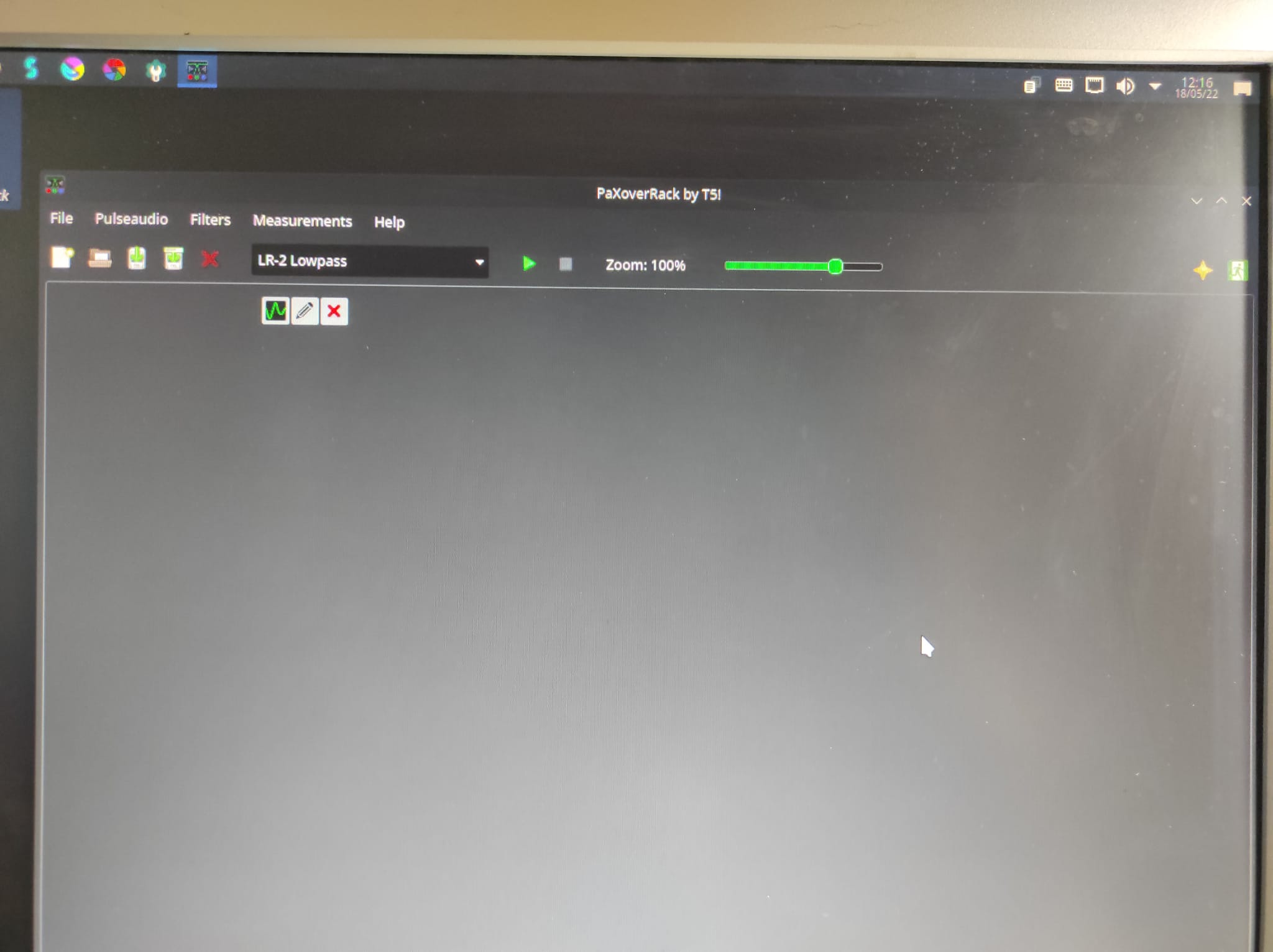

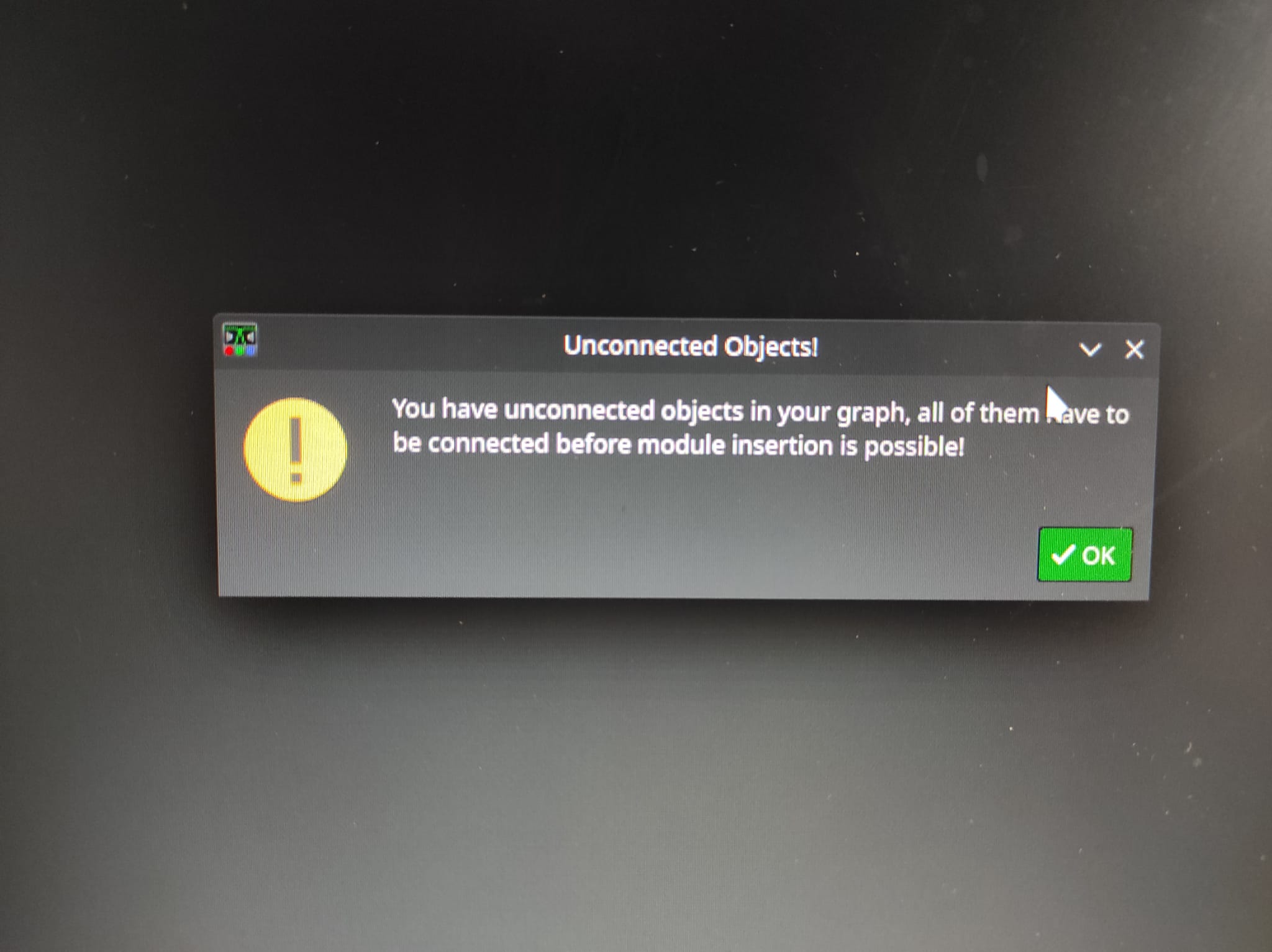

Hi @Tfive, I'm think I have found a bug -
When I try to choose "Second Order Butterworth Lowpass" from the Add menu it does nothing.
Also the menu option is misspelt it actually says "Second Order Butterworth Lowpassk" (Which may be the problem?)
Sorry for being the annoying man who keeps finding problems
Just released version 1.80 that fixes the typo. Thanks for reporting.

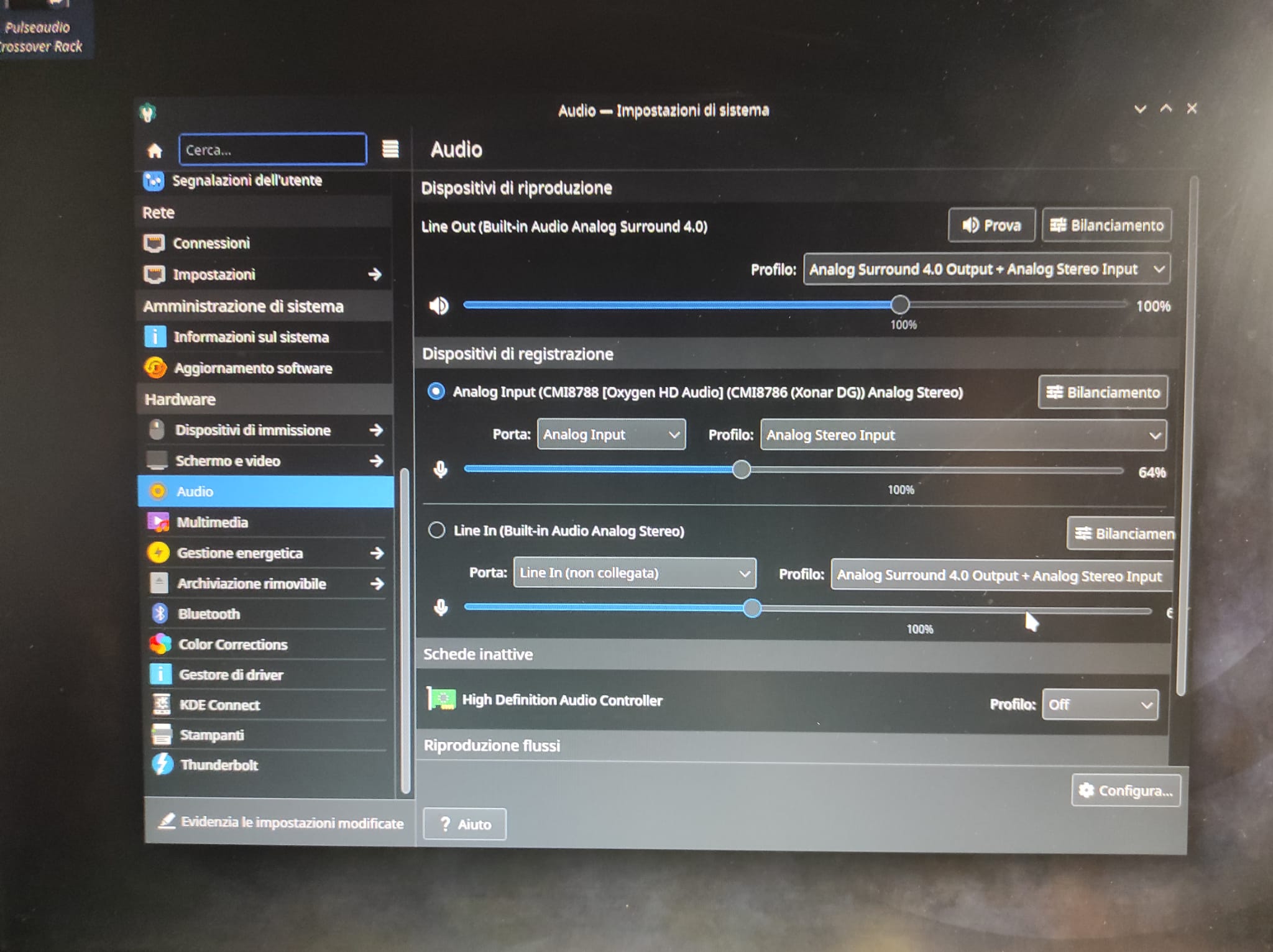

Hello, I have problem using this program, I have an old pc (ALC882 audio card and asus xonar). My cards seems to work with Ubuntu studio. When I start the program, I click on new file, but I can not find the input interface, then If I add new output I see only the 3 icon (image 1), if I add a filter see image 2. I am going crazy, please can someone help me?
No error, but when I create a new file thi is the output. Thank you

Never have seen this one before - seems to me that PyQt5 sometimes does conversion from float to int by itself, and in your case it doesn't. Are you able to download this file: https://gitlab.com/t-5/paxoverrack/.../CustomWidgets/AbstractWidget.py?inline=false and put it into the directory /usr/lib/pulseaudio-crossover-rack/CustomWidgets (have to do that as root!)? There might be other bugs like this one lurking around and I don't want to spam everybody with a load of new releases...
Ok @Tfive thank you, now it works, I can see the input, but...... I can not use any filters, I have this error
Then with another type of filter I have this one
Really nice work, I think that I am unfortunatly, or my machine has got tough hardware... I see that you are working with another version, if my errors require too time, for me is not a problem... I don't want that you loose too many times. However congratulations for the work :-D

BTW: Which linux distro/version are you on?
