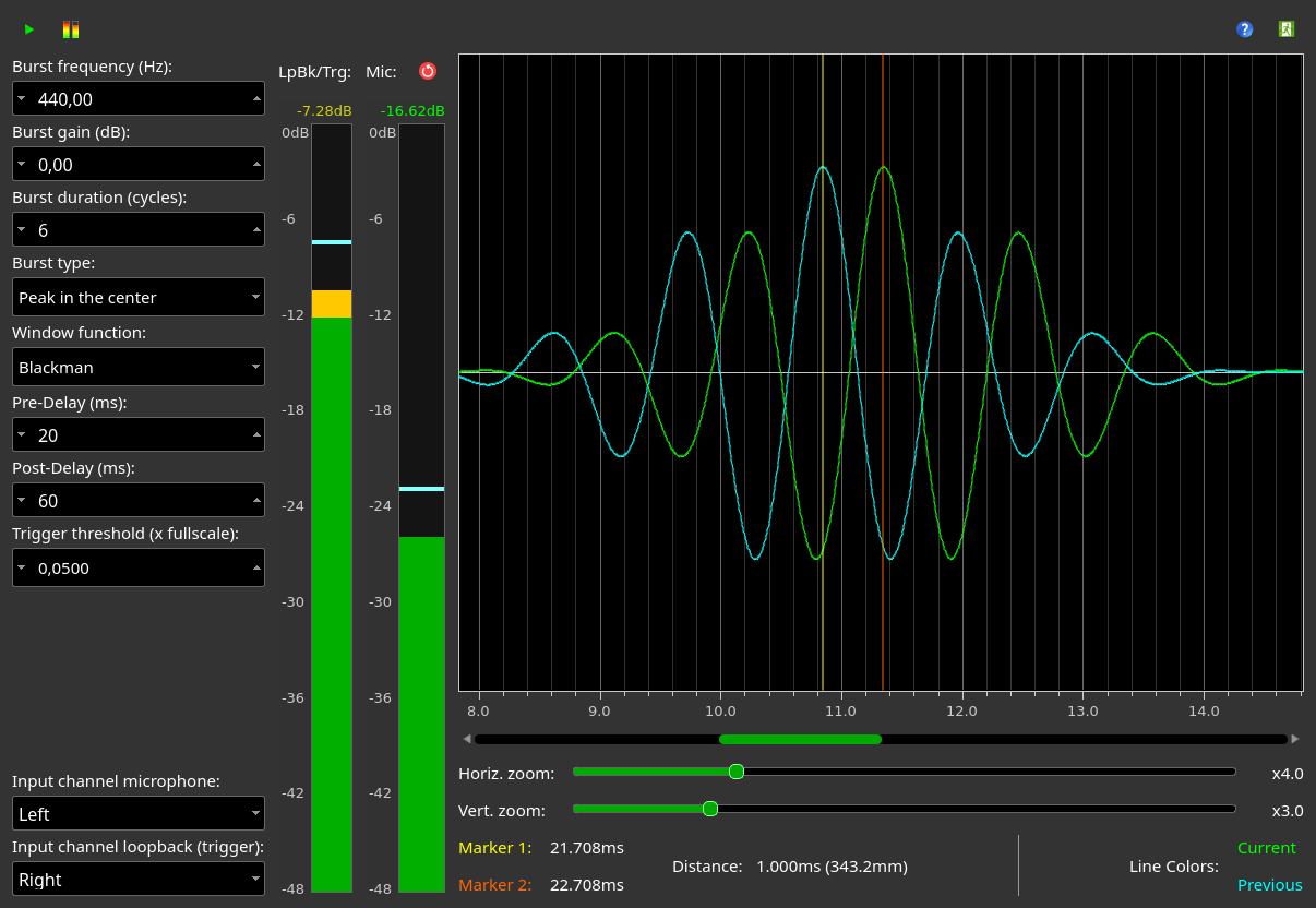

I just made a new release (v1.65). Here's the changelog:
The bug was mentioned in one of the recent posts.
The newly added time alignment measurement window is described here:
https://t-5.eu/hp/Software/Pulseaudio Crossover Rack/OnlineHelp/#time_alignment
More infos on that can be found in these posts:
https://www.diyaudio.com/community/...ind-delay-phase-and-polarity-at-xover.370287/
https://www.diyaudio.com/community/...s-and-phase-measurements.384660/#post-6982946

- added time alignment measurement dialog
