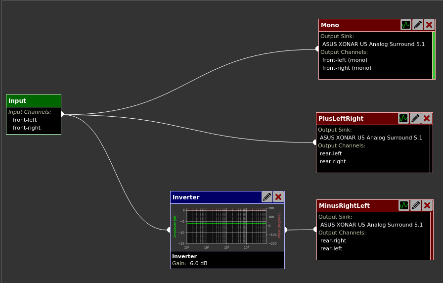

@Tfive Yes, this is the post I was referring to (the SSS matrix with adjustable coefficient). Now I have a stereo sound card and would like to have L+R on left and L-R (or R-L) on right channel for the M-S matrix. I did not find out a way to do it.
Actually a stereo sound card will no suffice, you will need at least four channels as pulseaudio has some serious limitations when using LADSPA plugins. They can always only be applied to a pair of stereo channels.
