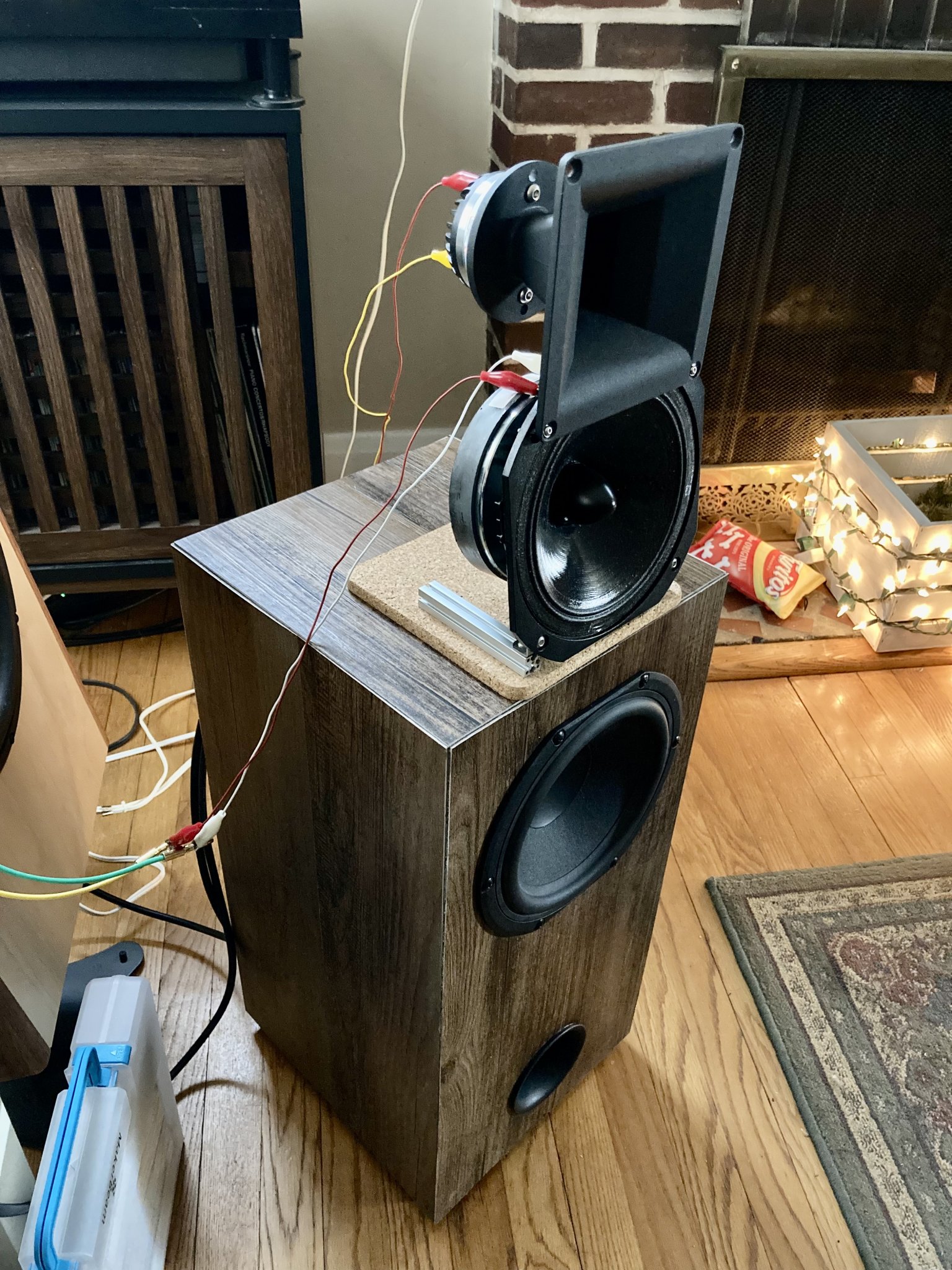

So I've wanted to port my Pax crossover setup to a Raspberry Pi for a while. I have it working on a desktop with output going to the same HDMI 7.1 LPCM DeEmbeder that DarpMalone is using (see his post #1003, which includes a link to the product) and Raspbian Linux. BUT this is where my attempt is gonna be more challenging, so time for some confession. If you don't already know it, it is VERY hard (impossible?) to get a Raspberry Pi during this chip shortage. So i had a Pi B+ (32 bit, 512meg, and pretty old). Ok, Guilty! Yes i have seen CPU hit 97.4% during the install! Quite surprised it all runs. BUT, i can't get a browser to run because of not enough memory, so tough to post things from that machine, here so bear with me as I might have trouble posting configuration information.
My goal is just to get a 2-way crossover working and evaluate next steps (like keep trying to get a Pi 4).
So far, i have Pax running and making the right sounds out all 4 speakers when i just create an input and 2 outputs. But when i insert an LR4Highpass and LR4Lowpass between input and outputs;
- the Pax Config of input, thru my highpass, to Output1 on front 2 channels works. Pax also reports that the Input, thru LR4lowpass works, but fails when it tries to implement the LRLowpass to Output 2 on ANY of the other 7.1 outputs with "ERROR inserting module OutputLow".
Of course, i can provide more info but figured I would start with this in case the solution (or dead end) is obvious.
Appreciate any help and a big Thanks to T5 and lots of others who got me this far!!

I'm watching Top the whole time. Thinking it might get strange when if it starts to run out of memory, but while there is very little left once i have everything running, there isn't any spike or ??. Pax runs 60-80% max when inserting the modules. High but nothing "over the cliff". where else should i be looking?
btw. i noticed you ref'd some patching in the last couple days. I probably built it a week ago, so if there is a recent patch maybe i need to build again???
