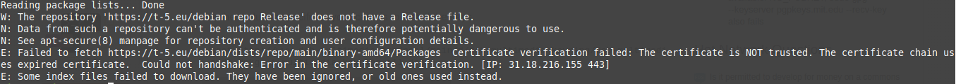

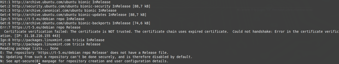

Hello @Tfive - today I tried to install crossove on another machine and expariance unexpacted problem (please see 1st screenshot). When I try command {sudo apt-get update --allow-insecure-repositories} doesnt help much (please see 2nd screenshot) ANy help here, please.
General problem the repo is considered as insecure
Are you sure your system date is set correctly? The certificate of my webserver is not expired. That's a lie 😀
It is. To my even bigger surprise all went well when I try to install on Ununtu 20.04 last night. But with the Ubuntu soft is not stabile. Even I applied "Pulseaudio 13.99.x from sources with fix for #1015" very carefully and all installed properly system freeze when I try to execute even simple crossover setup. I don't know why.Are you sure your system date is set correctly? The certificate of my webserver is not expired. That's a lie 😀
