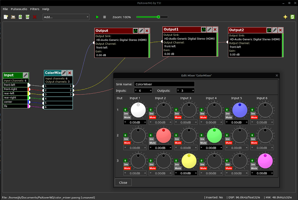

Sometimes I really am way too much of a nerd to keep my hands off the small but visually appealing details... 😎
attachment.php
