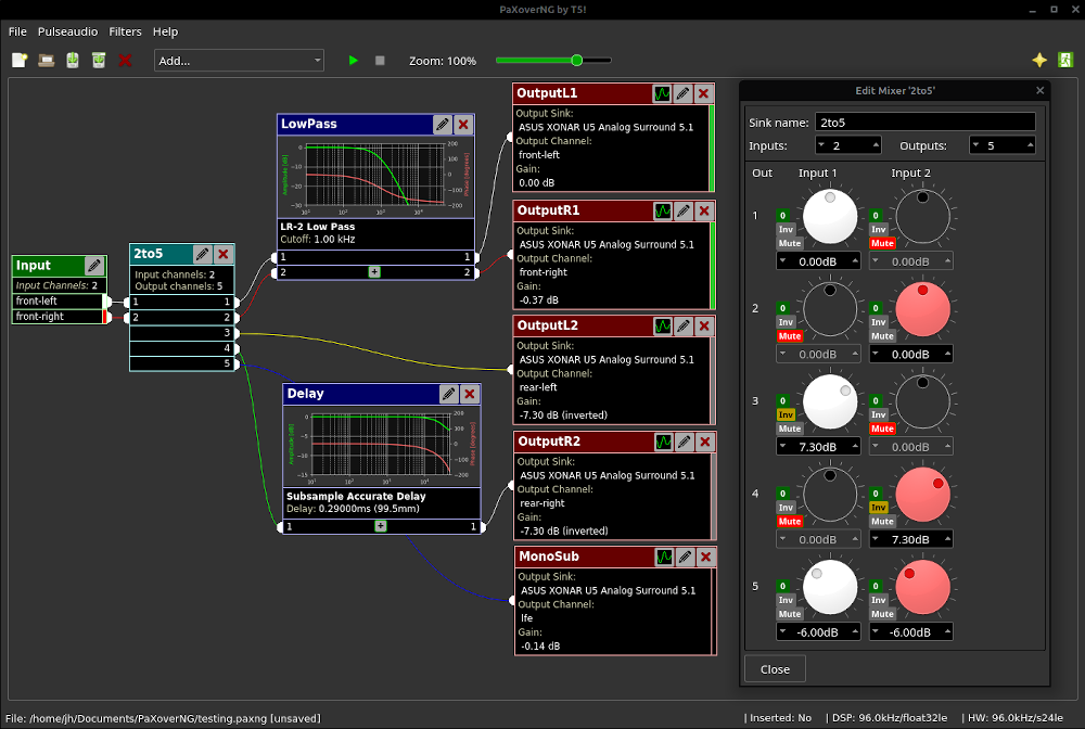

Just a small teaser of the upcoming version with camilladsp backend... I'm currently in the process of rewriting the GUI widgets to support routing and mixing of individual channels, which up to now was a huge undertaking. That should be done in a few days of work. After that the actual DSP backend shoul not be too complicated. Fingers crossed 🙂

Is it fair to say that camilladsp replaces your previous LADSPA plugins and adds FIR capabililty?
Yes and yes.
I will first reimplement all the existing filters though, try to make config file creation and realtime parameter updates via websocket work reliably and then add FIR filters as one of the last steps.
There's still a lot to be gained besides FIR filters, namely more reliablility vs. the LADSPA plugins and arbitrary number of channels and mixing/routing capability. This would f.ex. also enable home theater setups with more than 2 channel stereo.

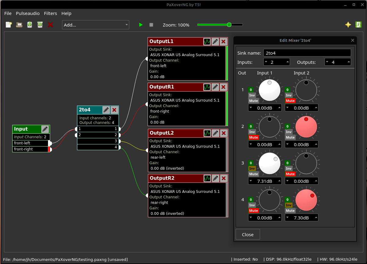

One more teaser... The graphical work is done, except maybe i'd like to make spline (connector) curves to have colors derived from input and output channels of a mixer... For example white/red in => mix to mono => pink. But that's a minor thing and in category nice to have, so I will leave it for now.
As I said, the UI stuff is done as far as I can see. That I think was the most challenging part. Now off to generate the damilladsp config, start/stop the process and a first version could be released to the public - albeit without realtime parameter changes. I will see how complicated that is - shouldn't be at all, so likely v1.0 also will have that in it.

PS: I'm aware that the shown filter configuration makes no sense at all, it's just for testing 😀
