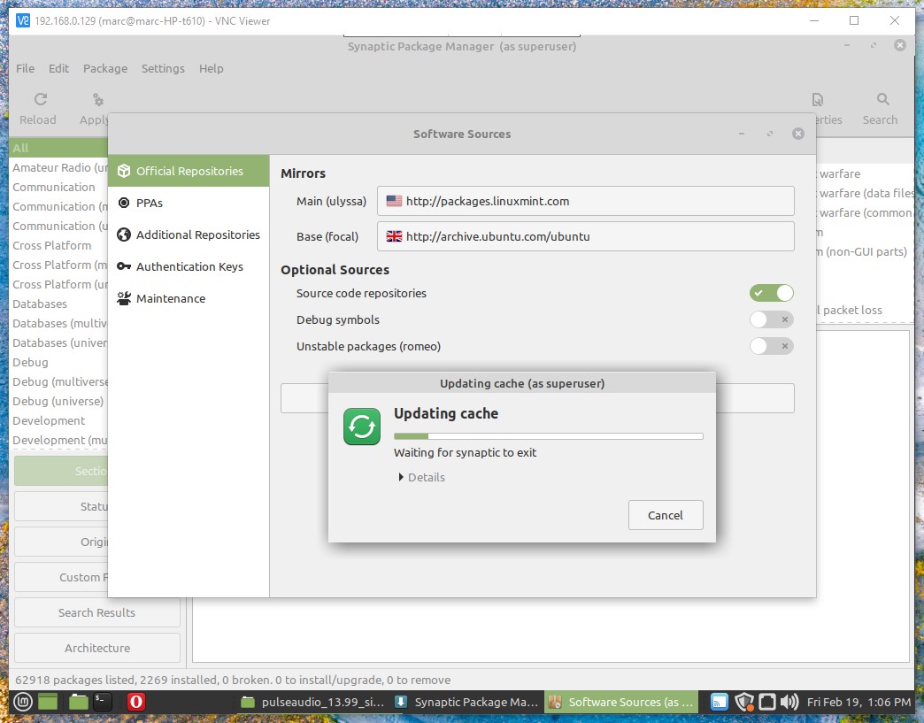

Geez, Mint is giving me trouble.
I tried allowing source code repositories, and Synaptic just hangs when it's 'Updating cache'

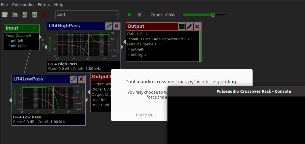

Hi all,
First of all, many thanks to Jürgen for this amazing project!
Nice looking, very simple to understand and convenient.
Did anyone install it on Ubuntu 20.04?
I have a problem.
I installed crossover, I can create filters in design mode but as soon as I click run button in crossover window, it opens empty console which immediately gets frozen. Problem affects other windows as well, for example firefox also gets frozen.
I've updated pulse daemon.conf file with recommended settings.
Xonar U7 is configured as 7.1 in ubuntu audio settings
Also added following to pulse daemon.conf:
default-sample-channels = 8
Any suggestions?
My hardware:
Thinkpad x230 + Asus Xonar U7, connected to USB3 socket
I tried two different PCs, both Thinkpad x230
