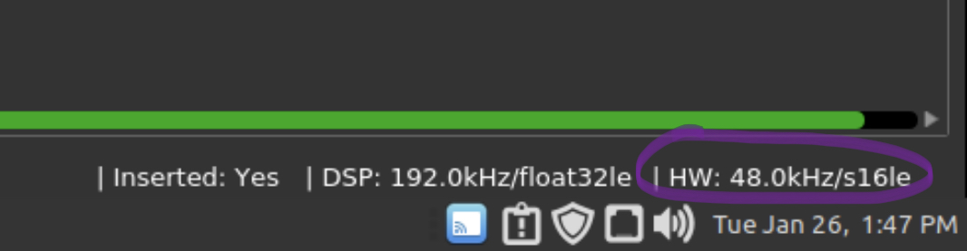

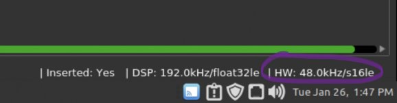

One thing I haven’t figured out is if I should change something in the alsa/pulse/PaXoR settings for the output to be as HQ as possible.
For example, the GUI shows that the DSP is running at 192k and float32le as desired, but the output (“HW”) is operating at 48k/s16le. Can I change that? Or is that the limitation of my budget UCA202 DACs?
Thanks for any insight.

I just installed a Motu M4 and set the outputs to channels 1/2 and 3/4. Wow! Fabulous and trouble free sound!
The synchronization errors to my other squeeze clients are also gone!
The Motu is an exceptional product. I’ll even be able to do measurements now!

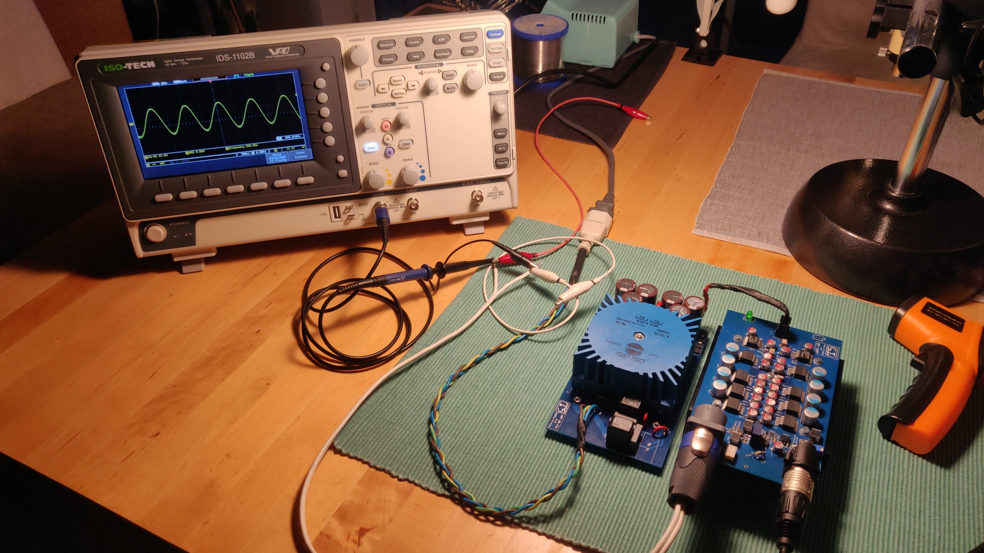

Using good hardware always helps 😀
Had to learn that today again when we tried to measure our newly built LPUHP clones with an emu404. Shitty device IMHO, very inconsistent results. Still - it's aaaallliivvvee 🙂

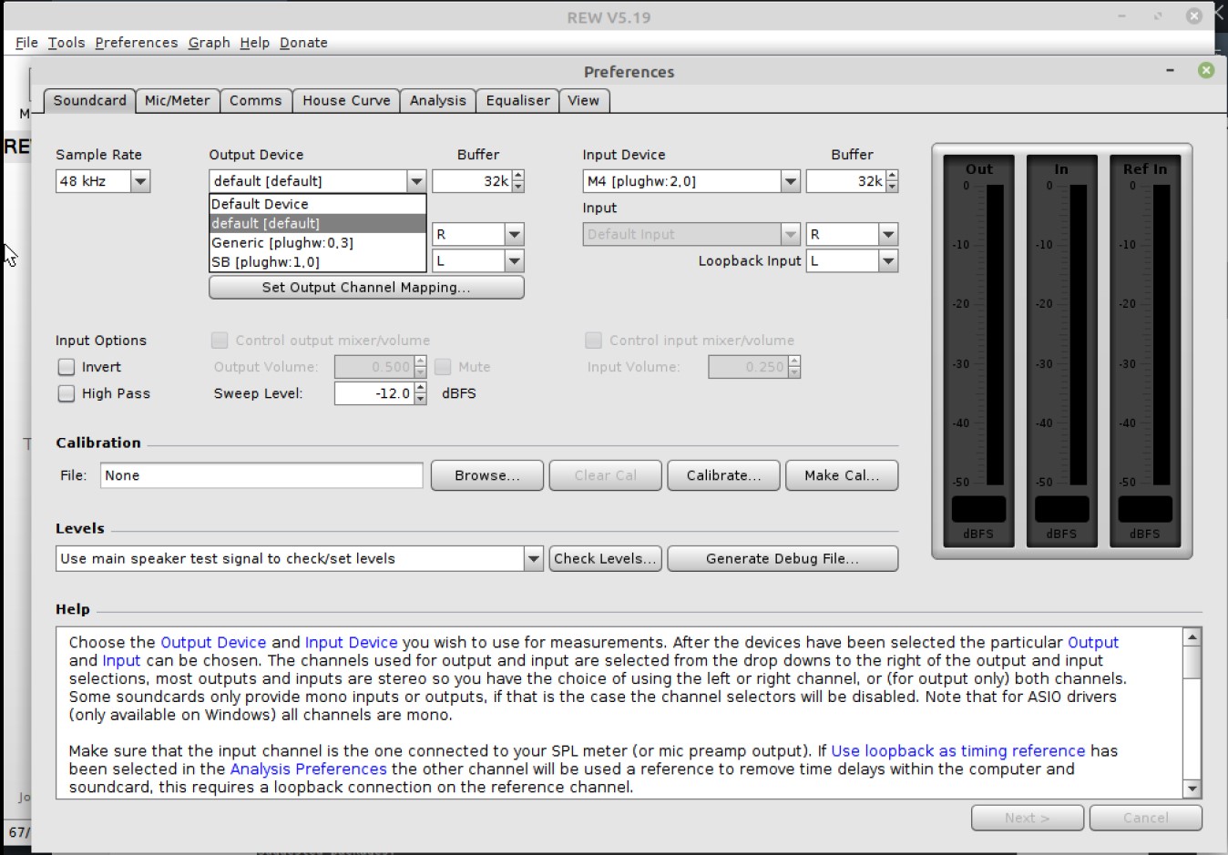

Since I can use my Motu M4 for measurements, is it feasible to surmise that I can measure the output AFTER paxor using REW?
Would I have to direct the paxor input to be from REW, which would be sending the sweep signal, and then measuring the response after paxor divides up the signal?
Or, am I limited in only separately measuring each filter (I'm using a two way, crossed at 250Hz)?

FWIW, REW can either run the sweeps directly, or you can play the sweeps from audio files on another device. I used to attach a laptop to my AVR through a loooong HDMI cable, but now I simply have exported the measurement sweeps as audio files, put them on my NAS and play them through DLNA, or with a media player, on the device that drives the loudspeakers. The USB measurement microphone and REW are running on the laptop. It's a very flexible solution for full system measurements like paxor and loudspeaker response together.
Good idea, thank you. My complications include that the M4 usb interface is also used for playback. I was able to get REW to output the sweep through my speakers, but my mic connected to the M4 showed up in REW as ‘ref in’ instead of the input... The measurement kept giving an error that the input was too low. I gave up for the evening on figuring that out.
I’ll do some more digging. More ones and zeros to decode.
