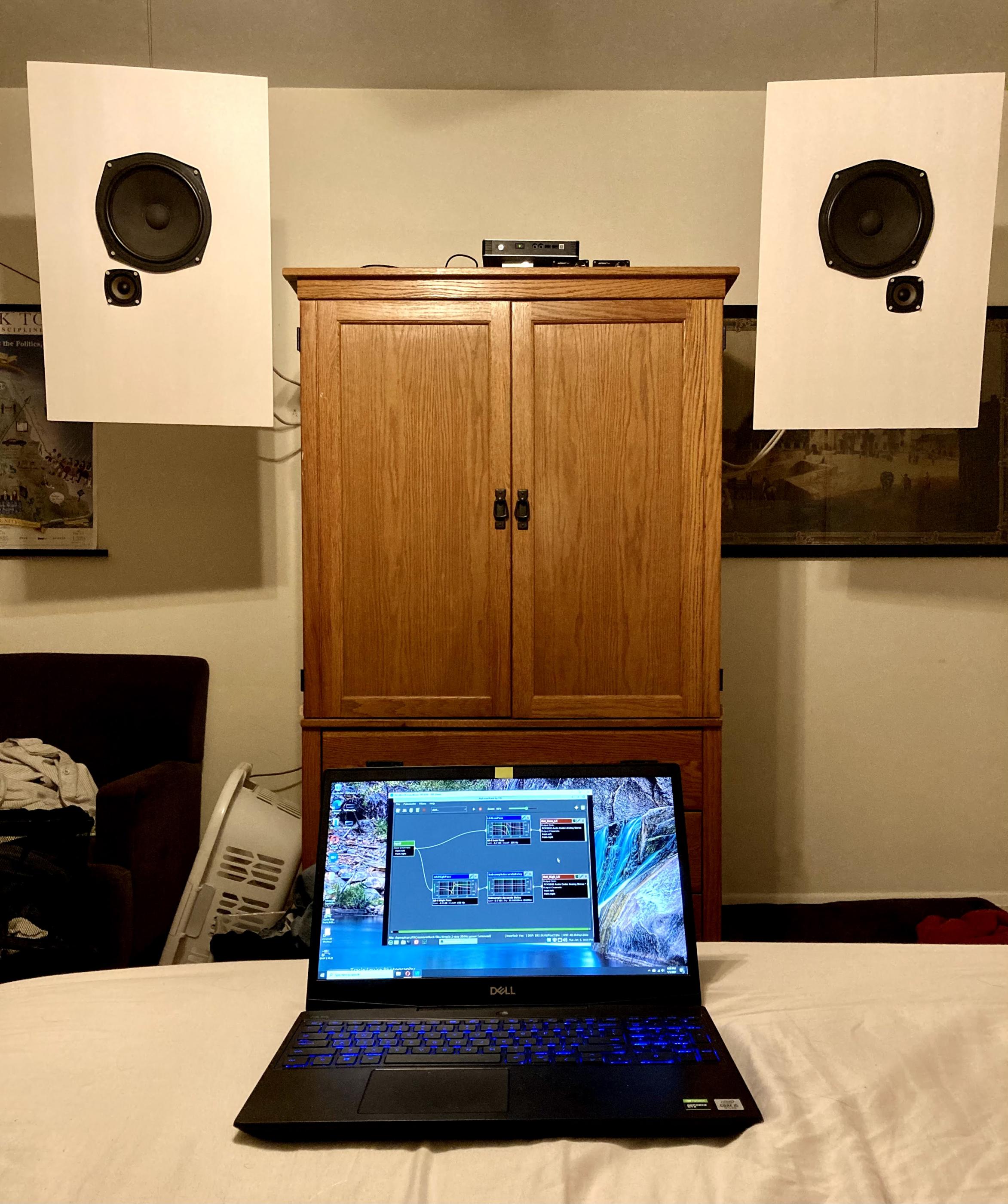

I got it working with two Behringer UCA202s for my open baffle two-way speakers! Squeezelite is feeding pulseaudio's input and automatically starts after user login into Mint. I also got remote access to the mint machine working well.
It sounds pretty darn good -- a definite upgrade from the active crossover I was using before (also Behringer).
I'm thrilled! Every once in a while there is a slight audible pop, but I'm not overly concerned with that. This is great until I decide to splurge on a Xonar U7 or a diyinhk multi-channel usb dac.

Yep, thanks xorcz for doing support work

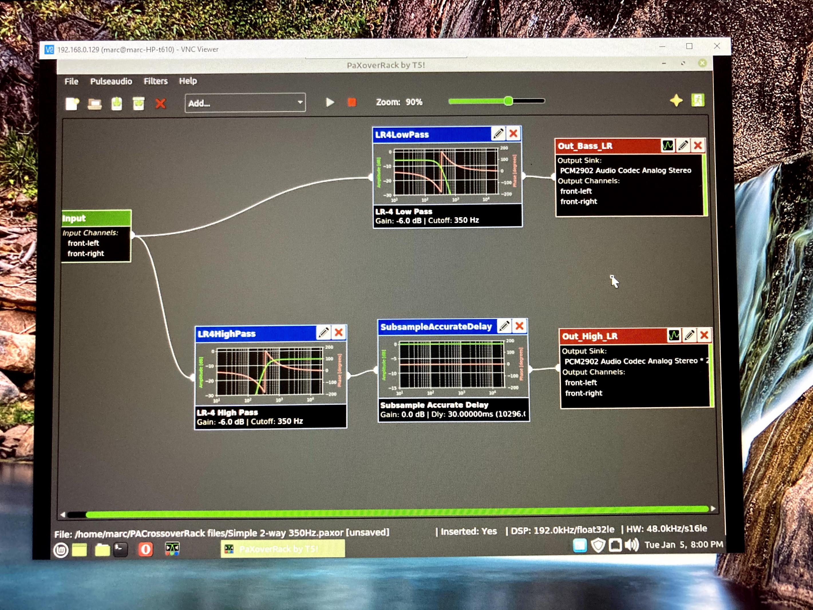

Some notes: I'm pretty sure you don't want that 30ms delay... That is equivalent to an acoustical offset of 10 m (metres!)...
I'm also amazed how little (none) eq you apply
Ha! Thanks! I added that based on recollection of another thread... Maybe it's supposed to be .30ms... Gotta track that down.
No EQ yet. I'm just enjoying OB benefits for now. And these drivers are pretty great for this layman's application. I also don't have a measurement system currently.

Id suggest it's more in the us range than in the ms range. But to a take advantage of that to bring the crossover region into phase will most definitely require measurements. I'd suggest either setting it to 0 or use a value that is equal to the offset of your drivers centres from the front baffle (something like 5cm, around 150us).
It should at least be better than 30ms, which was way out and to our ears should sound like a noticeable delay, if not masked by other stuff going on.
In the end this at least shows how forgiving our ears can be sometimes. If listening really carefully you'd be able to hear this might make a cool experiment.
From my own experience it can take a lot of fiddling to make things "fall into place", especially in the lower frequencies. If that happens though, it's totally audible, the bass feels tighter and more on point timing wise. Doing this by ear and without measurements is certainly very difficult. My own measurement setup is coming along nicely, together with new soundcard and amps for my two way f.a.s.t. monitors. I will be able to perform tweaks to my living room setup based in measurements pretty soon, reporting back on the progress probably in a new thread.

One more thing you could try without a measurement setup: invert either high or low passed signal, play a pure sine at the xo frequency and adjust for LOWEST audible tone level. This way you make sure the two signals are in phase, cancelling out each other as good as possible if one of them was inverted. Removing the inverter will make them sum correctly then. If you actually perform that experiment let me know your findings, I never tried that personally.
