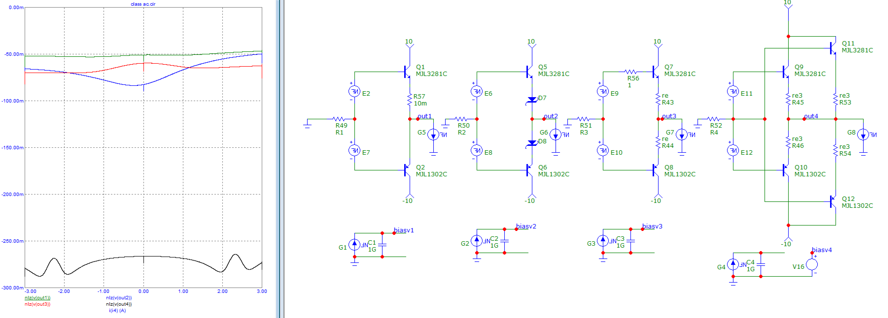

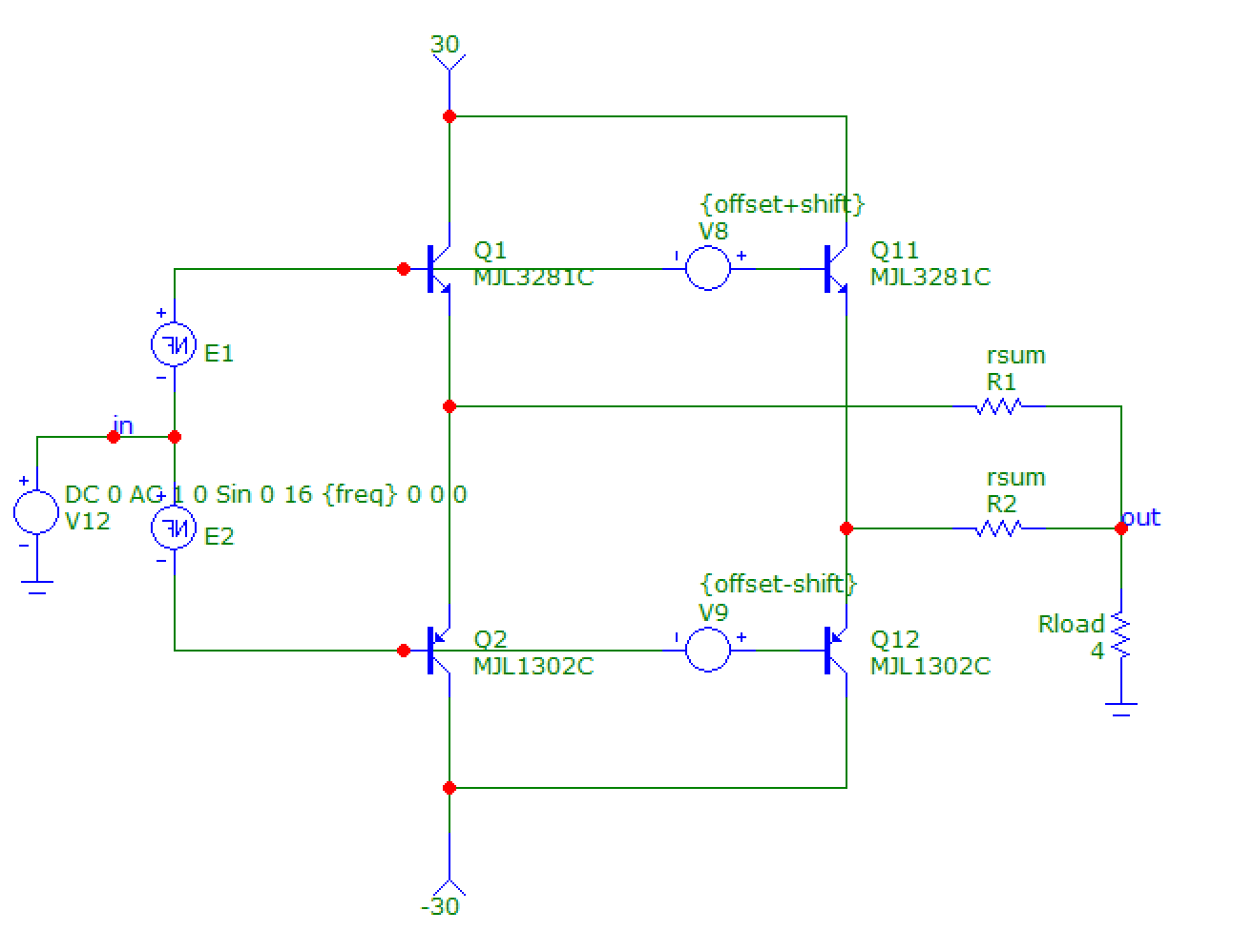

I've simulated two identical resistor-free BJT output stages joined to the output via 0.1R resistors. I added voltage sources in series with the bases to simulate a bit of Vbe mismatch between the devices.
1) If the PNP and NPN BJTs that have the lowest Vbe are paired together, this pair will have higher bias than the other. So it will have a wider crossover and turn off at higher current, but the other pair with lower bias will get the short end of the stick and turn off sooner. So the nice wide crossover without switching is lost. If all pairs share output current equally, which is the goal, the class-A zone will be determined by the pair with smallest bias.
Plus you get one set of turn-off spikes per pair for the same price 😀 since they won't happen exactly at the same place.
2) If the transistors are sorted so the PNP with the high Vbe goes with the NPN with the low Vbe, so total Vbe per pair is constant, then each pair will have the same bias. That would be better. In this case, the simulator says it works perfectly if Vbe mismatch is reasonable between pairs, ie up to 40mV. The mismatch means some transistors will turn off earlier than others, but the di/dt will be divided by the number of pairs, and that is the cause of the crossover spikes, so that should more than compensate.
If the offset is much higher, like 0.2-0.3V it behaves just like Cordell's DoubleCross (a topology invented by many others too) and it produces a smoother crossover, but they will turn off at much lower current, so the non-switching feature is no longer available.
So yeah, it should be possible to parallel them, with a bit of matching, with an emphasis on equal bias current for each pair. If base resistors are replaced with ferrites, hFe matching should be unnecessary.

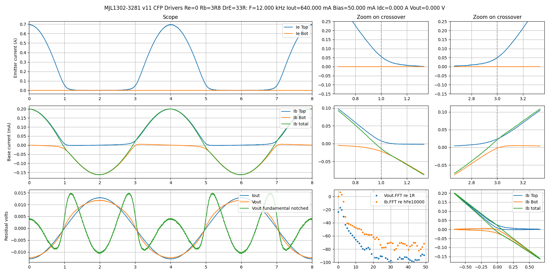

I've given another look at the last measurement I made before it blew up.
If resistor-free output stages are paralleled, but the total bias is the same, does this improve turn-off spikes?
For: di/dt per transistor pair is halved.
Against: two pairs have 2x the capacitance and potentially 2x the stored charge, unless stored charge is exactly proportional to current, or something.
Neutral: at half the total bias each will have a narrower crossover per pair than one pair at full bias, which shouldn't matter since each handles one half of the current.
Does one compensate for the other? Unfortunately the answer is no: at the same frequency, the half bias output stage with half the output current is worse than the full bias stage with the full output current.
Therefore, paralleling loses some of its glitter... it increases current handling capability, but it worsens turn-off spikes.
(Assuming bias currents were accurate)
Meanwhile, the MOSFETs still don't have turn-off spikes.

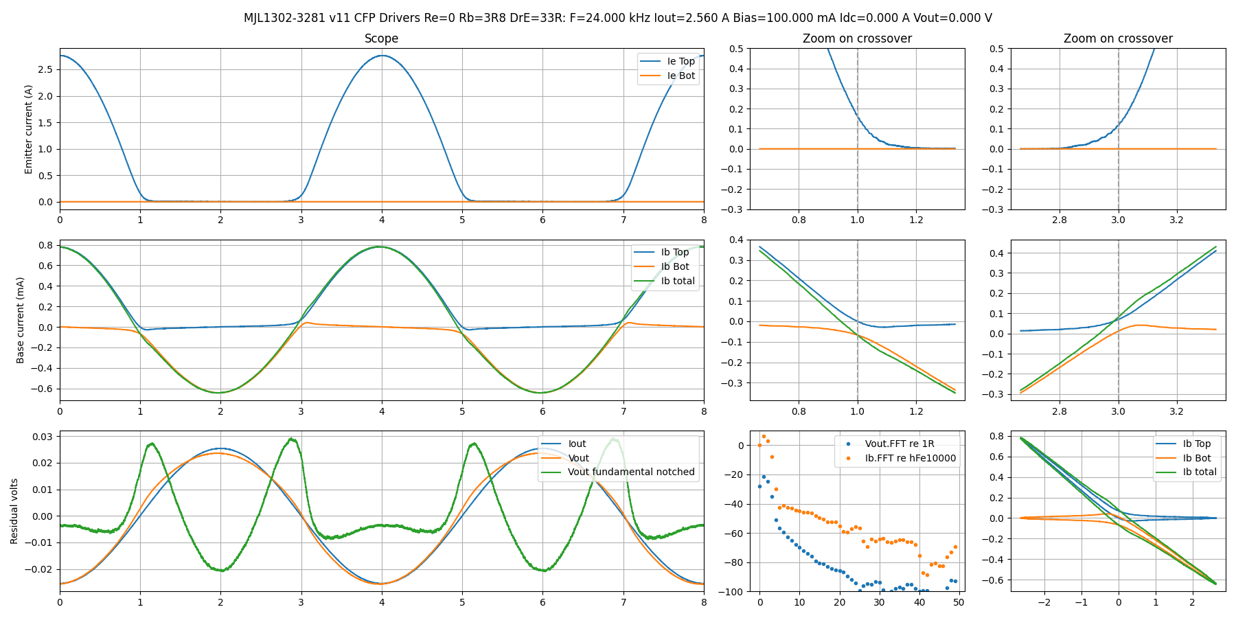

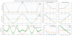

scope-Bias=50.000 mA Iout=1.280 A F=24.000 kHz MJL1302-3281 v11 CFP Drivers Re=0 Rb=3R8 DrE=33R-.png263.3 KB · Views: 280
scope-Bias=100.000 mA Iout=2.560 A F=24.000 kHz MJL1302-3281 v11 CFP Drivers Re=0 Rb=3R8 DrE=33R.png256.1 KB · Views: 241

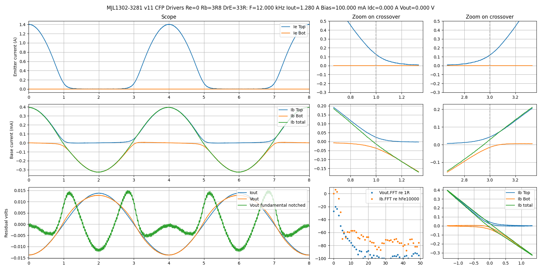

scope-Bias=50.000 mA Iout=640.000 mA F=12.000 kHz MJL1302-3281 v11 CFP Drivers Re=0 Rb=3R8 DrE=3.png261.8 KB · Views: 239
scope-Bias=100.000 mA Iout=1.280 A F=12.000 kHz MJL1302-3281 v11 CFP Drivers Re=0 Rb=3R8 DrE=33R.png257.5 KB · Views: 240
The replacement smoked chips have been shipped and should arrive tomorrow.
I will redo the above measurement to make sure the bias currents were exact. If that is confirmed, then the last two simple candidates (without fancy non-switching autobias) will be

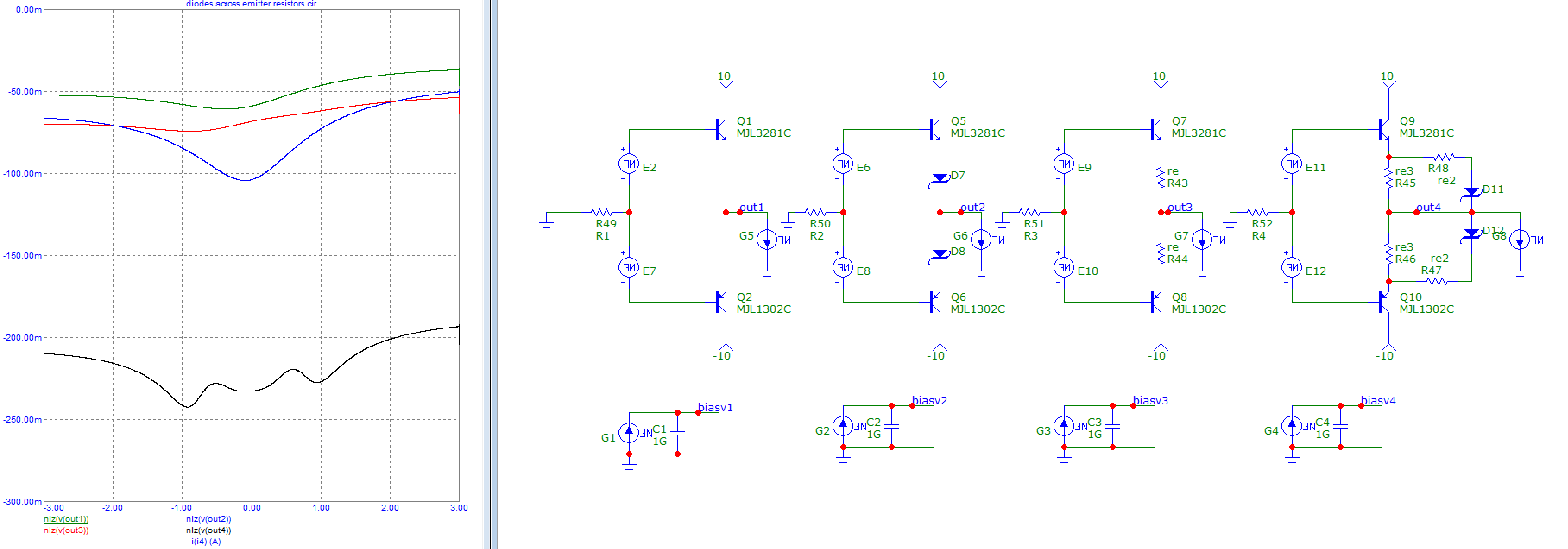

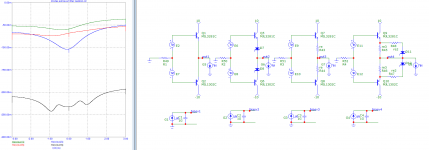

Diodes across the emitter resistors, as in Class-AC, per suggestion of OldDIY.
The idea is to make an output stage with highish emitter resistors and high bias, to get gm-doubling. Then, diodes+resistors are placed in parallel with the emitter resistors to also double gm with one transistor turn off, in the hope of having a constant gm across current.
This scheme requires that bias current * emitter resistor = diode turn on voltage, so with realistic (low) emitter resistor values this means a rather high bias.
Graph is nonlinear output impedance, which is the error voltage (ie, distortion) added by this output stage. That's 1/gm, so I put it upside down, and it looks just like gm...
Basically there is no way to make it flat, the parts don't stick together. And the transistors turn off early because of the high value resistors, which means turn-off spikes. I selected the least messy setting between bias and resistor values for presentation, but...
If it needs 300mA bias to work, then BJTs or MOSFETs without resistors (and thus without gm-doubling) have already won.

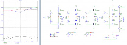

Now, class AC
I picked the best performing bias according to schematic values in the link. It needs a ridiculous 1.2A of bias current to work, and still does not deliver what it says: there is no gm-doubling, but when the class-C boosters turn on, they make a mess.
The other three output stages are simulated at 0.4A bias, so they waste 3x less power, and the resisto-free BJTs deliver much better performance. There really is no comparison. Besides, at this bias, it will run into hFe droop before it runs out of class A, so it can even get a class A sticker.
