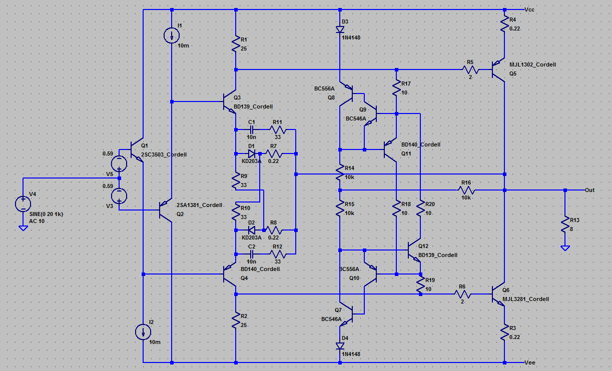

Problems with CFP occur when the power transistor turns off but the driver is still on, and that's still the case... gm doesn't look good.
Clearly!
This straightly loads the VAS output asking for some kind of buffer or "nonswitching" circuitry like this:

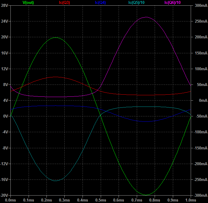

And it will work like this:
