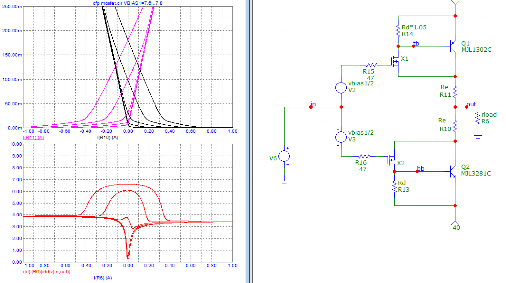

If you used mosfet driver, I assume most of the CFP problems go away. This would be because the VAS stage would see much lower change in drive current.
Problems with CFP occur when the power transistor turns off but the driver is still on, and that's still the case... gm doesn't look good.
I believe the problem with CFPs is class AB operation in general. Once either transistor turns off, the CFP goes mad.
Yes. It's nice for class A, but the simple push pull without emitter resistors provides a lot more class A for the same bias...
